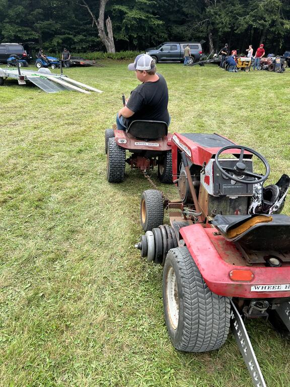

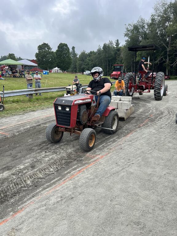

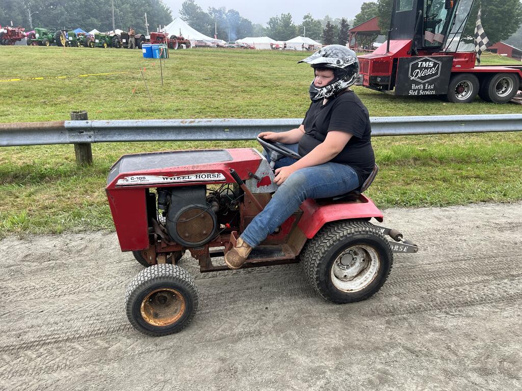

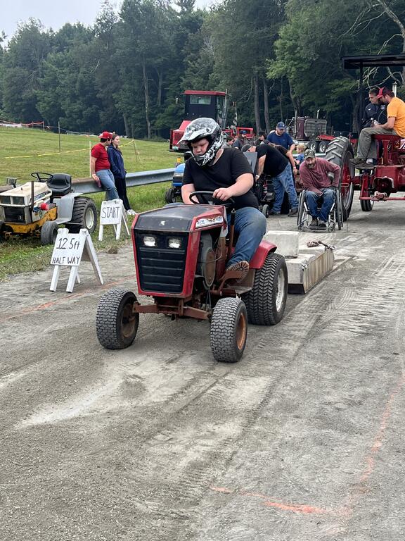

WHGuy413 2,859 #1 Posted August 18, 2024 @WheelHorse_Kid has been wanting to build a puller. Summer has been busy but even with my bum knee this past week we managed to get a puller built. From my dad machining parts for a hitch to my friend helping weld when I couldn’t and a weight bar that I designed that actually worked (I’m shocked). He pulled in the 900lb class first finishing his last full pull being 1600lbs of weight and battled to the end with a tricked out wheel horse but ending with second. In the 1000lb class he took third pulling 2000lbs as his last full pull. He had a belt slipping issue at 2050lbs that knocked him out but he took third. We took a shot and weighted up for the 1200lb class and I added another spring to give us more pull on the idler and tension on the belt. First hook he took off the line great but the engine problems we battled all day finally decided to rear their head right in the middle of his pull. He moved 2100lbs 6 feet this time before the engine problems. The C-105 was a beast still. Successful day and he’s hooked. Already talking about building it better. Now to drain the gas check for stuff in it and water and redo the full fuel system to see if we can get it running right again. not a bad day for never pulling anything other than stock class. 4 5 4 Share this post Link to post Share on other sites

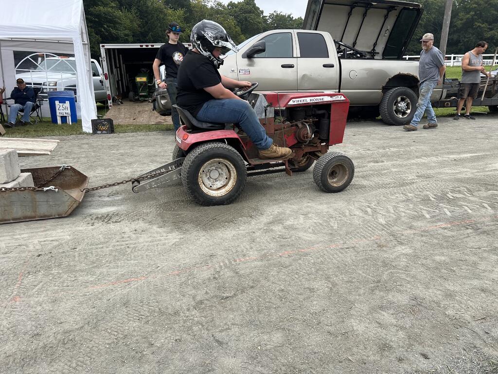

squonk 48,427 #9 Posted August 18, 2024 Not to be a downer but is that all that's hooked to the sled a Clevis? No safety's? If that let's loose the driver is going to get hurt! 3 Share this post Link to post Share on other sites
WHGuy413 2,859 #10 Posted August 18, 2024 40 minutes ago, squonk said: Not to be a downer but is that all that's hooked to the sled a Clevis? No safety's? If that let's loose the driver is going to get hurt! Good call. I will point that out on on the ones who run the pulls. 2 Share this post Link to post Share on other sites
ebinmaine 81,282 #11 Posted August 18, 2024 15 minutes ago, WHGuy413 said: Good call. I will point that out on on the ones who run the pulls. I agree with @squonk. That's a very weak connection between a 1000+ lb tractor and twice that in dragged weight. If the officials try to say the chain is super heavy duty or whatever remind them that there's a HUGE difference between STATIC weight DYNAMIC weight. 3 Share this post Link to post Share on other sites
