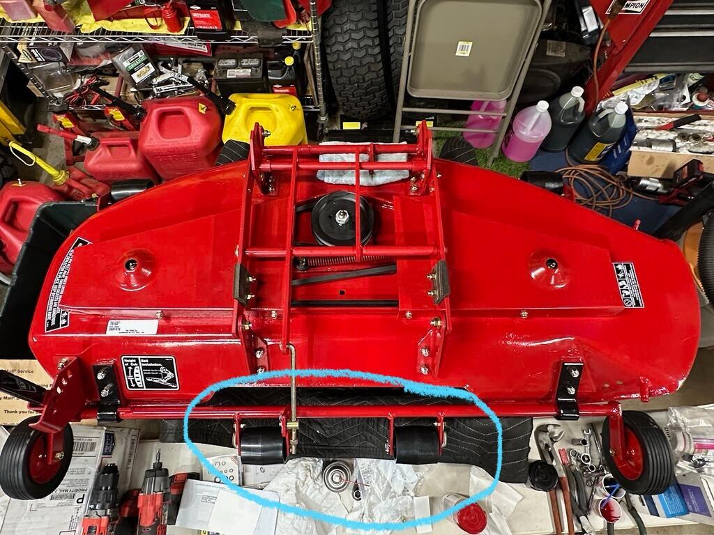

EasternOT 4 #1 Posted August 8, 2024 Hello guys, I recently picked up this 48” deck and need to order some parts including a new drive pulley for one of the outer spindles. I can’t figure out the model number for this deck but I know it’s not a 78360/78361 due to It having the older design of the trailing wheels and how they’re mounted. Does anyone have an idea on the model It could be? Also I noticed that there seems to be two different part numbers for the outer drive pulleys depending on the year of the 48” deck. One part number is 106074 & the other is 110146. Do these pulleys interchange with each other? The 106074 is twice the price hence why I’m asking. Thanks! Share this post Link to post Share on other sites

EasternOT 4 #9 Posted August 8, 2024 The 1977-1984 decks (42" & 48") had different drive pulley part numbers than the 1985+ decks; This correlates to when they switched from the nylon insert locknut to the lock washer & nut design. From what I've gathered by studying the part numbers in the schematics... - The 1977 - 1984 Decks used drive pulleys 106072 (42") & 106074 (48") - The 1985+ Decks used drive pulleys 109967 (42") & 110146 (48") - 1989+ Decks used 2 separate mount brackets for each of the 2 rearward rollers Therefore 110146 should be the correct part number for my drive pulley as my deck appears to be in the year range of 1985-1988. Thank you @gwest_ca this was a fun little research project. Share this post Link to post Share on other sites
