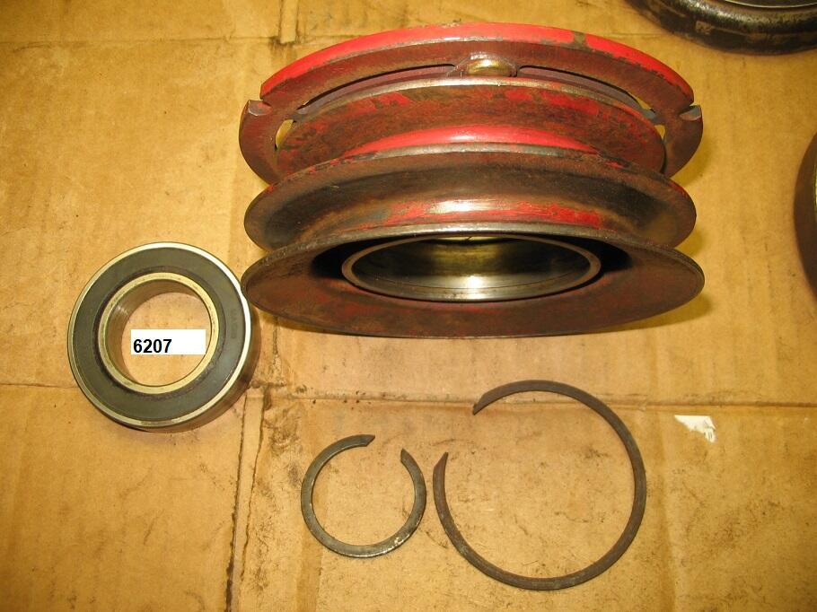

Ricks 520 6 #1 Posted August 4, 2024 (edited) I was going to replace the bearing in the electric clutch on my GT-14 but not having any luck finding that size. 1.575 [40mm] inside , 2.835 [72.9mm]. It's a 6207 but the sizes are different on today's 6207. Edited August 4, 2024 by Ricks 520 Share this post Link to post Share on other sites

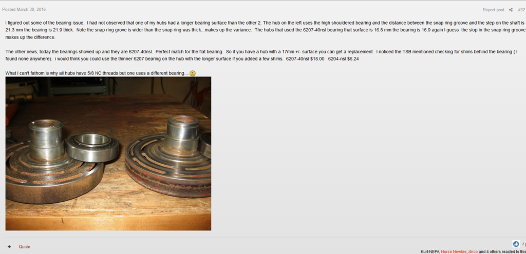

pfrederi 20,992 #2 Posted August 4, 2024 (edited) 18 hours ago, Ricks 520 said: I was going to replace the bearing in the electric clutch on my GT-14 but not having any luck finding that size. 1.575 [40mm] inside , 2.835 [72.9mm]. It's a 6207 but the sizes are different on today's 6207. Inner bearing or outer bearing. The inner bearing changed at some point but I think I had figured out how to shim what is available now. Sorry I am old and forgetful. Link below shows some of the differences. Give me a day or two I think I can find what you need Edited August 5, 2024 by pfrederi Share this post Link to post Share on other sites

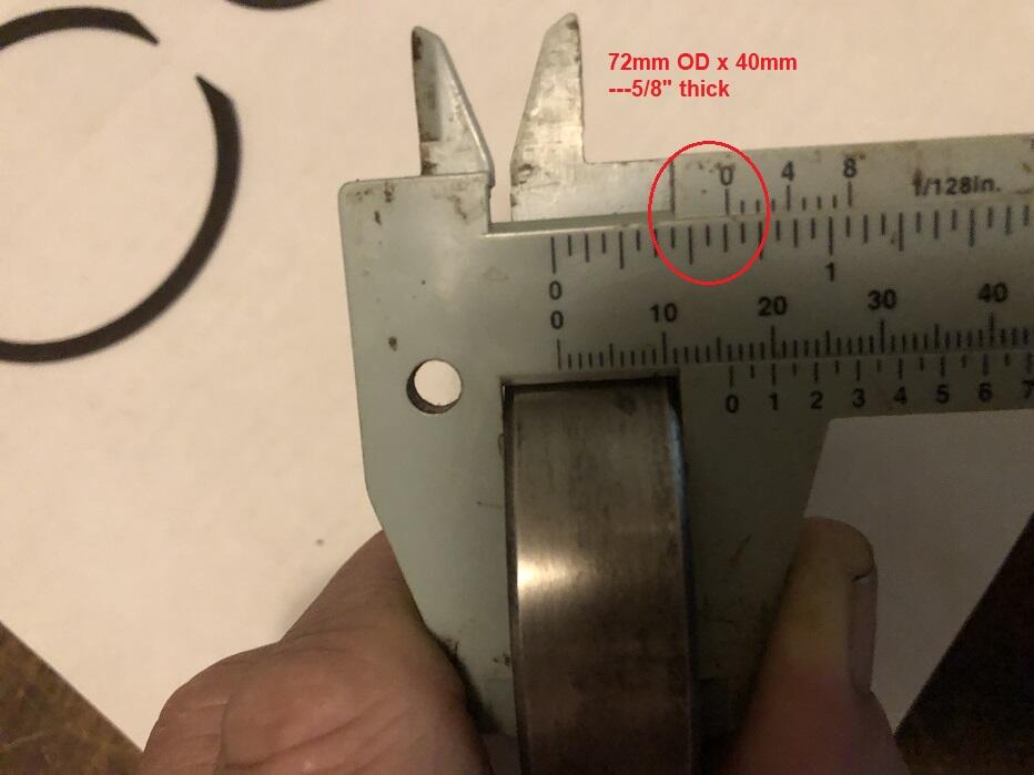

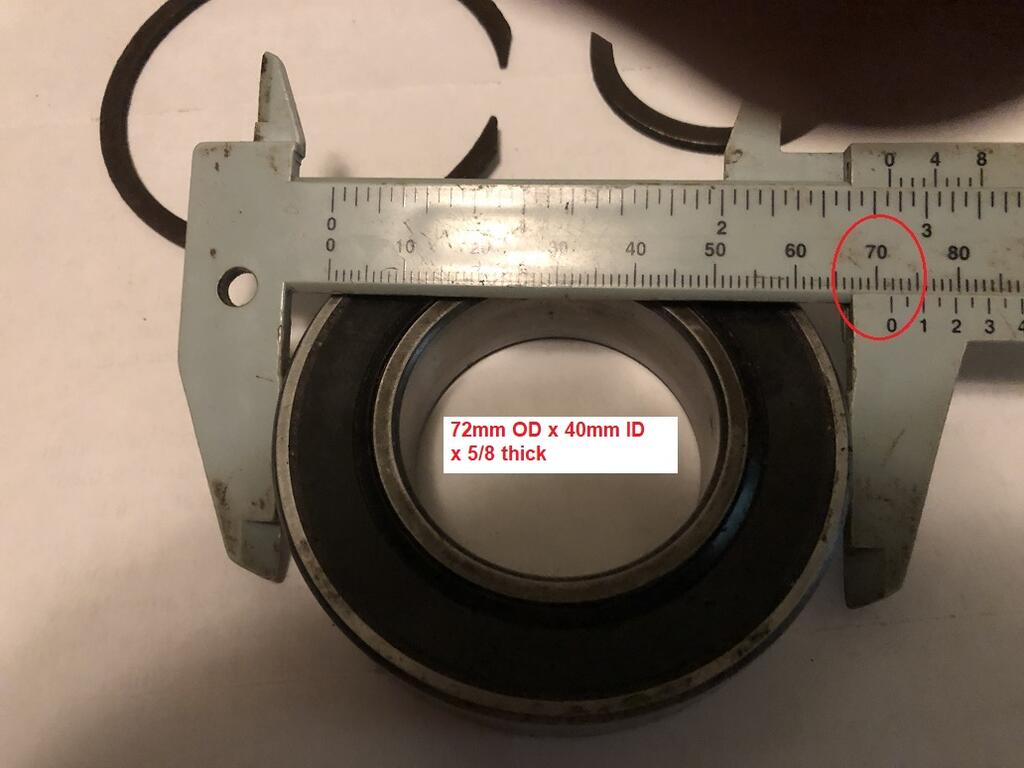

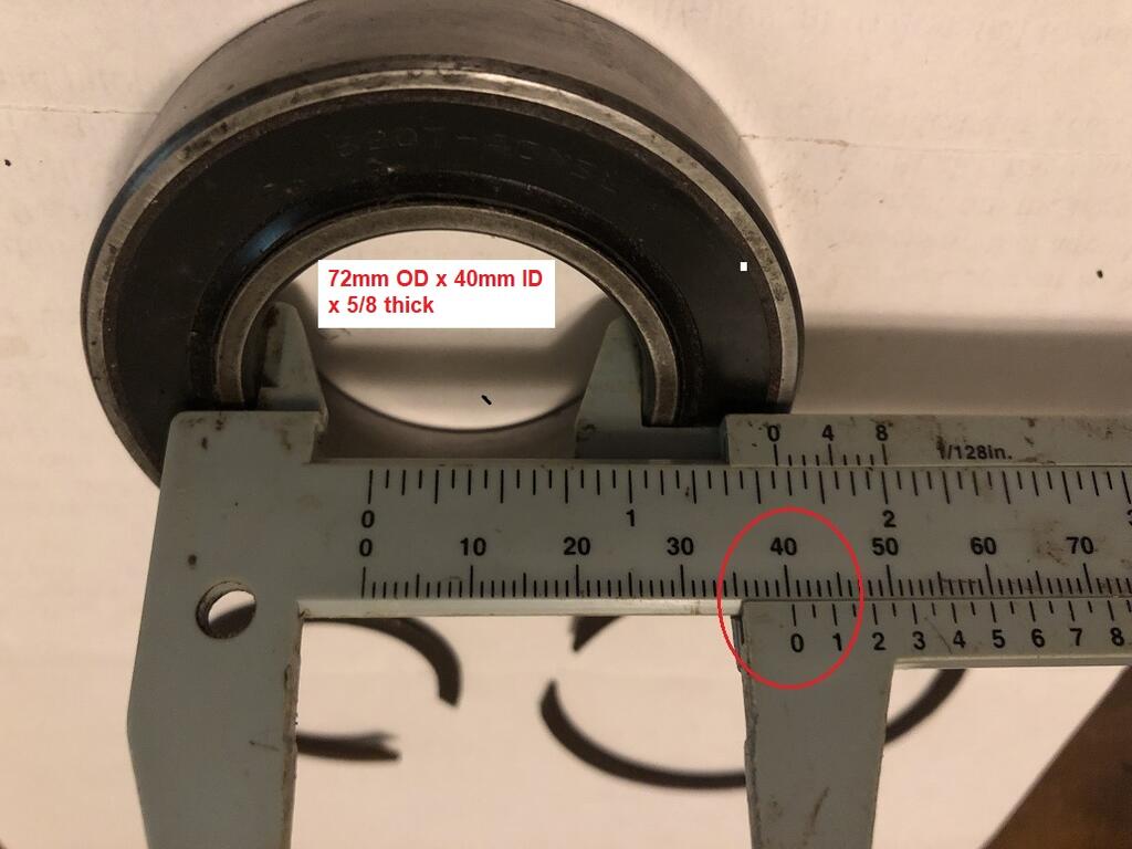

daveoman1966 3,884 #5 Posted August 5, 2024 I have that bearing #6207-4DNSL NACHI: 72mm OD x 40mm ID x 5/8 thick. It is from an E-PTO that had a bad field wiring. Here it is...can be in your mailbox for $65. It has NO DRAG or wobble...very smooth to turn---slight resistance, as if new. ps---the closest I could find (35M X 72MM) new was from McMaster Carr--- about $140 new. Share this post Link to post Share on other sites

pfrederi 20,992 #8 Posted August 5, 2024 (edited) If your PTO has the older longer shaft you will need shims if yo use daveoman's bearing This pic is from the thread i liked in and earlier post. Edited August 5, 2024 by pfrederi Share this post Link to post Share on other sites

pfrederi 20,992 #12 Posted August 6, 2024 4 hours ago, Ricks 520 said: I have a bearing supplier who found some. He said they have 140 left and that's about all there are. Cost me about $35. If you have the longer hub shaft you will need some spacers. If you do let me know i may have some .. Share this post Link to post Share on other sites
