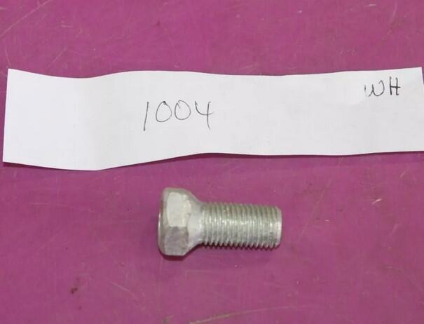

Donavon1 17 #1 Posted August 4, 2024 Need help finding the lug conversion kit for my b-80 Share this post Link to post Share on other sites
pfrederi 19,120 #2 Posted August 4, 2024 (edited) Welcome 1004 is the wheel bolt (7/16 NF) are you looking to put in studs and use lug nuts??? Edited August 4, 2024 by pfrederi 1 Share this post Link to post Share on other sites
ebinmaine 75,206 #3 Posted August 4, 2024 2 hours ago, Donavon1 said: lug conversion kit @rmaynard sells kits Share this post Link to post Share on other sites
Pullstart 68,413 #4 Posted August 4, 2024 You can use 7/16”-20 x 1.5” long bolts, and 7/16” automotive lug nuts of your choice too. 2 Share this post Link to post Share on other sites

953 nut 62,710 #12 Posted August 5, 2024 17 hours ago, Pullstart said: You can use 7/16”-20 x 1.5” long bolts, and 7/16” automotive lug nuts of your choice too. Those bolts would need to be full thread rather than the type you can find at the big box store. A box of 25 at McMaster-Carr will cost less than buying ten at a hardware store. https://www.mcmaster.com/products/screws/hex-head-screws~/medium-strength-grade-5-steel-hex-head-screws/thread-size~7-16-20/length~1-1-2/ 1 Share this post Link to post Share on other sites
