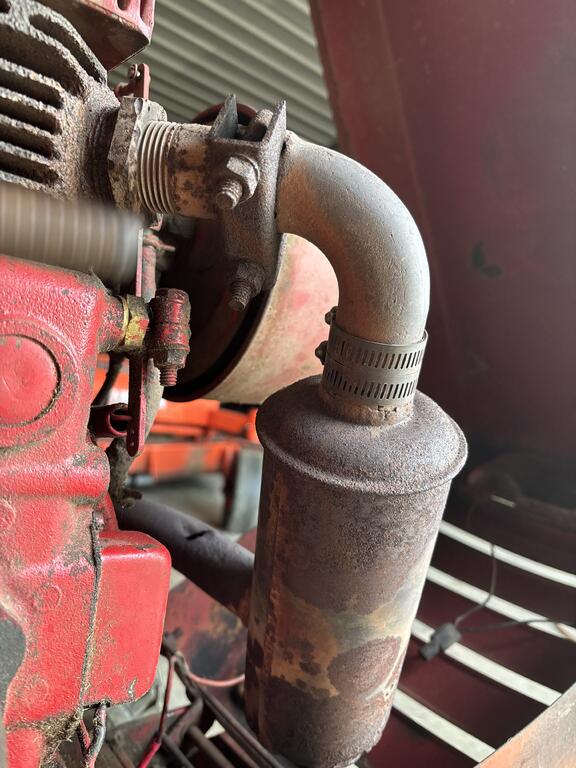

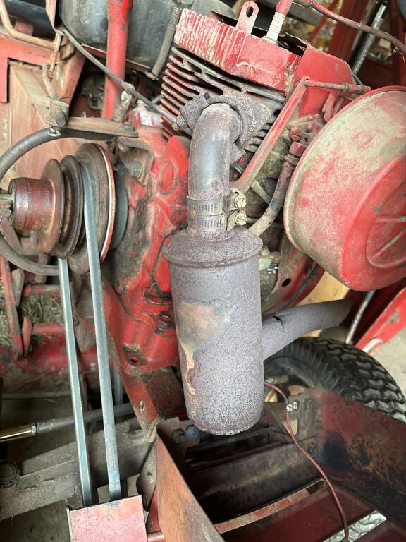

fourwheelhorseman 362 #1 Posted August 2, 2024 Does anyone here remanufacture these? I’m looking for 2 of these mufflers. I done a google search and can’t seem to find any real concrete information. I did see an older thread on this subject, on this site from 2017. here’s what I need. I’d take new or good used. 1 Share this post Link to post Share on other sites

ebinmaine 80,279 #5 Posted August 2, 2024 1 hour ago, ri702bill said: I believe @ebinmaine has dealt with this same issue and uses a "similar", but different muffler........ I've done some different types over the years. I have a nice tall stack on my C160-8 Cinnamon Horse. My 1975 C160 Automatic has a Gravely Style muffler. I've also used IHC Cub mufflers which make an interesting little stack because they have an inlet at the bottom that is 90° from the outlet. That's what's on my C160-8 Tecumseh Horse project I'm working on right now. 5 hours ago, fourwheelhorseman said: mufflers The biggest thing to watch out for is that the early ones such as you are showing have a can diameter that is less than 3"... and the later ones which start around 1978 have a can diameter that is about 3.25". Some folks mount them and do okay but we have had several horses come through our shop that have burnt paint because of clearance issues on the larger can diameter. You wouldn't think that extra half inch makes a big difference but it sure as heck does. I do have a smaller can diameter style Muffler that I would be willing to part with but it needs welding work on the inlet side. 1 Share this post Link to post Share on other sites
JPWH 6,544 #6 Posted August 2, 2024 4 hours ago, ebinmaine said: do have a smaller can diameter style Muffler that I would be willing to part with but it needs welding work on the inlet side. Eric, @ebinmaine I would be interested in one of the smaller can mufflerslike a rusted out one. I would like to have one to see if I could maybe make one similar. 1 Share this post Link to post Share on other sites
ebinmaine 80,279 #7 Posted August 2, 2024 3 minutes ago, JPWH said: Eric, @ebinmaine I would be interested in one of the smaller can mufflerslike a rusted out one. I would like to have one to see if I could maybe make one similar. You're in luck! I have one with a rusted shell. PM me your address and I'll send it down. 1 Share this post Link to post Share on other sites
