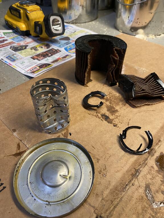

DanM0919 1 #1 Posted August 1, 2024 Good Evening, just purchased a 520-H and am doing all the fluids, filters, belts, and stuff like that. It is a model# 4120OE03 SN# 2000425 but I have no idea on the year. After downloading the parts manual from the Toro website, I see the Hydro filter part number is 79-5670 (excerpt attached). Unfortunately I find nothing about this filter part number on the internet; this is odd. There is a NAPA filter # 1410 that I removed but it has sustained significant internal damage. Not sure I want to put a new filter with that same number back on there if it is incorrect. Any advice from more experienced and knowledgeable folks would be appreciated. Thank You. 3836 Parts Excerpt.pdf Share this post Link to post Share on other sites

squonk 47,419 #5 Posted August 1, 2024 What do you mean the filter had internal damage. 1410 filters are way more stout than the older Toro/ Wheel horse filters in both the media and the steel casing. The more recently made Toro filters are made much better. To damage a 1410 a gorilla must have installed it or the high pressure relief in the transmission failed and the lift lever was held at its limit. 1 Share this post Link to post Share on other sites

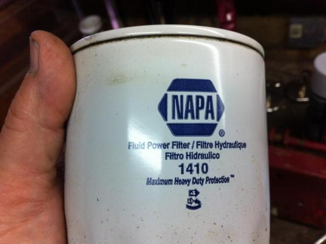

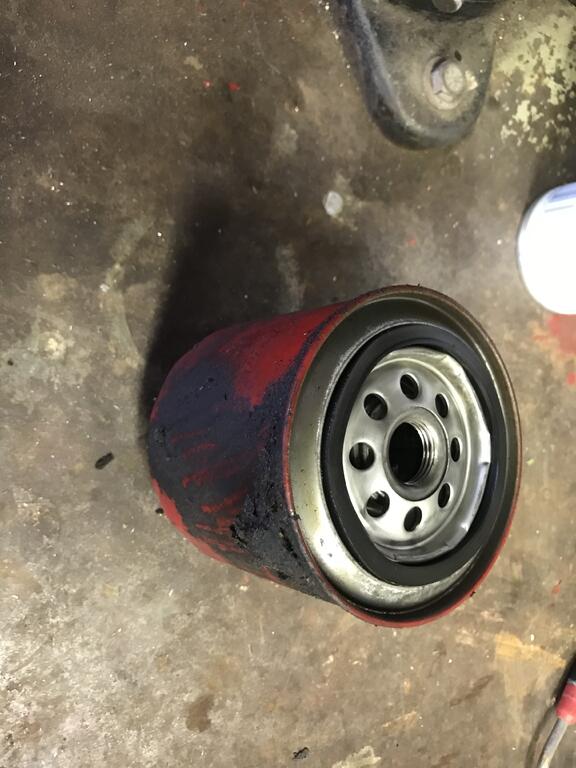

squonk 47,419 #6 Posted August 1, 2024 1410 cut open: Older Wheel Horse filter. The modern WH filter is made more like the Wix filter 2 1 Share this post Link to post Share on other sites

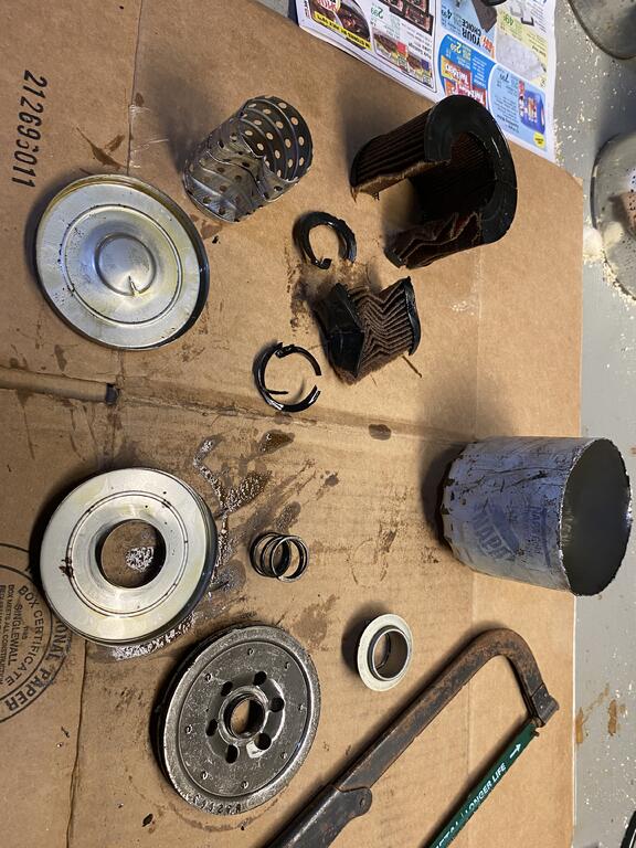

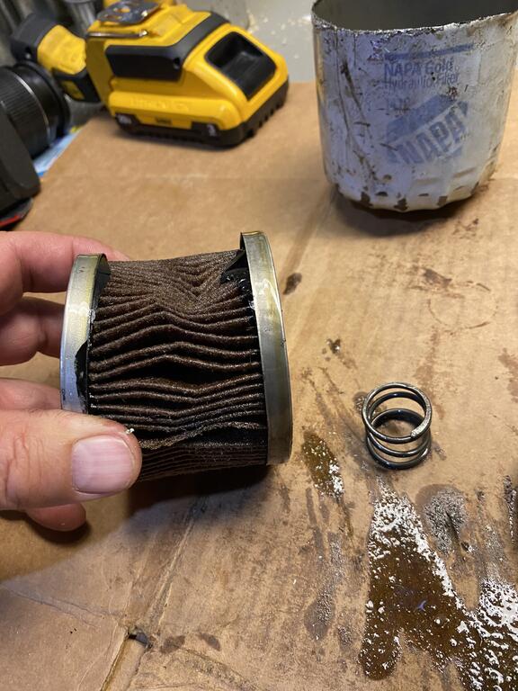

DanM0919 1 #8 Posted August 1, 2024 Thank You all. I will attribute the erroneous part number to being a "typo" from Toro. All I could find on the subject was the part number you all referenced, being 79-5270. So it appears I should be safe to reinstall a NAPA 1410 (next time I am near a NAPA parts store). There appears to be no nearby Toro dealerships for me to get the OEM part(s). Out of curiosity (my own and several of you), I did inspect the NAPA filter (see photos attached). There appeared to be no external indications of damage and what i saw internally suggested that overpressure was the issue ( per squonk). Hopefully it is not a latent problem that will re-occur. Everything else with the transmission and hydraulic lift (snowblower) seemed functionally fine. Though the unit is not pretty to look at right now it does run and drive fine. ... hopefully this new task of reviving this old tractor doesn't turn into obsession. Share this post Link to post Share on other sites
squonk 47,419 #9 Posted August 1, 2024 27 minutes ago, DanM0919 said: I can tell by the label alone that filter was VERY OLD! This picture is from around 2013. Your filter's " NAPA " label is much older than that. 1 Share this post Link to post Share on other sites
Handy Don 16,961 #10 Posted August 1, 2024 (edited) 1 hour ago, DanM0919 said: i saw internally suggested that overpressure was the issue Yikes, that did suffer! The fluid circulation from the Eaton 1100 charge pump is constant through the lift control valve and the filter and then into the motion pump inlet. Operating the lift diverts fluid into the lift cylinder but even it the cylinder stalls while holding the valve and thereby raising the pressure, the pressure relief opens at about 700 psi to let the fluid continue circulating (fluid flowing through that open valve emits a distinct “squeal”). Generally there will very low pressure as the fluid reaches the filter. The only impediments to fluid flow after the relief valve would e damaged hose or tube or else clogged filter media. The latter is what I’m seeing here--it allowed the pressure to build up and eventually crush the filter inward regardless of the lift valve operations. Given this impediment to fluid flow probably developed over time, I suspect that the motion pump/motor “pulling” fluid may have created a further pressure differential across the filter media. If the flow was insufficient to the motion pump, it may have damage as well. Lastly, since the lift cylinder operates on the difference between the high charge pump pressure and the low filter inlet pressure, your lifting capacity was likely also reduced somewhat--did you notice? Edited August 1, 2024 by Handy Don 1 Share this post Link to post Share on other sites

DanM0919 1 #12 Posted August 1, 2024 4 hours ago, Handy Don said: Yikes, that did suffer! The fluid circulation from the Eaton 1100 charge pump is constant through the lift control valve and the filter and then into the motion pump inlet. Operating the lift diverts fluid into the lift cylinder but even it the cylinder stalls while holding the valve and thereby raising the pressure, the pressure relief opens at about 700 psi to let the fluid continue circulating (fluid flowing through that open valve emits a distinct “squeal”). Generally there will very low pressure as the fluid reaches the filter. The only impediments to fluid flow after the relief valve would e damaged hose or tube or else clogged filter media. The latter is what I’m seeing here--it allowed the pressure to build up and eventually crush the filter inward regardless of the lift valve operations. Given this impediment to fluid flow probably developed over time, I suspect that the motion pump/motor “pulling” fluid may have created a further pressure differential across the filter media. If the flow was insufficient to the motion pump, it may have damage as well. Lastly, since the lift cylinder operates on the difference between the high charge pump pressure and the low filter inlet pressure, your lifting capacity was likely also reduced somewhat--did you notice? Thank You. Because I just purchased this tractor I really cant answer. It did seem to raise and maintain the two-stage blower (quite heavy) just fine. And Yes the filter was pretty grody looking so hopefully the new filter will be just fine. 1 Share this post Link to post Share on other sites
