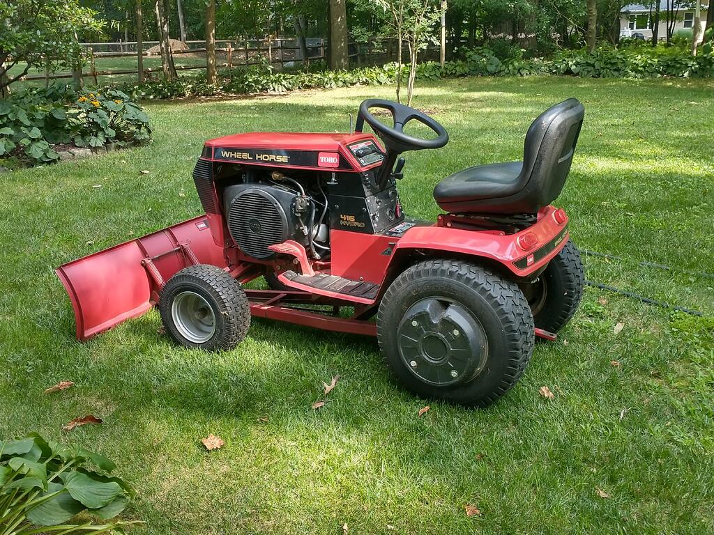

rmaynard 17,659 #17 Posted August 2, 2024 My 1996 416-H has over 1600 hours. It runs great. The hydro is tough as nails. The only modification that I added was a foot pedal motion control. My primary use is plowing snow, moving gravel and dirt, and hauling things around in my Wheel Horse tub cart. No matter the weather, it starts and goes immediately with no warm up. I have a 42" side discharge deck that cuts beautifully, however I defer to my John Deere x300 for that chore only because it fits my wife (short) better. Share this post Link to post Share on other sites
