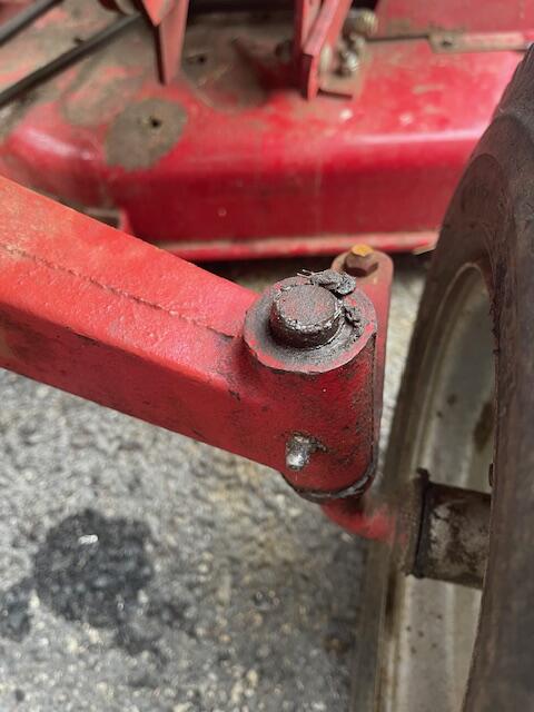

Dreamcatcher 102 #1 Posted July 26, 2024 Hi All, I'm hoping someone can help me with identifying the parts needed to fix the steering on my Wheel Horse 417-A. Due to a mishap I'd rather not explain, I broke the steering link (I have and extra one) and the spindle came out of the mounting point. I would like some help figuring out what I need to purchase to retain the spindle in the frame/support. Thanks in advance. 1 Share this post Link to post Share on other sites

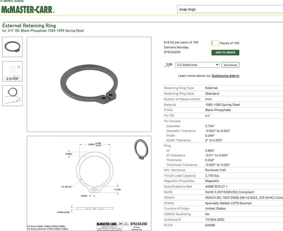

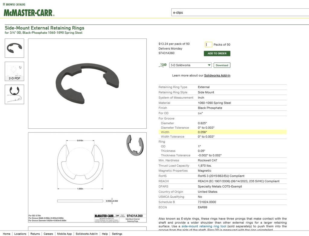

pfrederi 21,342 #2 Posted July 26, 2024 There should be a snapring 3/4" External on the end of the spindle You could also use an E clip 1 Share this post Link to post Share on other sites

ri702bill 13,394 #4 Posted July 26, 2024 IMHO - I would suggest using what type the opposite side has. Why?? Not all snapring and E clip grooves are the same diameter and/or width... Share this post Link to post Share on other sites
pfrederi 21,342 #5 Posted July 26, 2024 The spindles on WHs used regular not Heavy Duty snap rings. 1 Share this post Link to post Share on other sites
Dreamcatcher 102 #6 Posted July 26, 2024 I just ordered one from HD. Hopefully it will work well. Share this post Link to post Share on other sites
peter lena 10,125 #7 Posted July 26, 2024 @Dreamcatcher like a black vinyl grease cap , on those top areas , enhances lubrication / holding , stops moisture entry, 2 other areas , looking at me , no flat washer under that , steering bolt / nut , and possible wheel shucking , side to side , sloppy slamming , have regularly , gone over to HEIM joint ends , threaded rod , on related movement connections , that wheel shuck is easily corrected , with shimming washers , from local H/W store , pull out drawer section . also like lucas , hi temp / stress lubricant , for any moveable connection , bearing clean out / refill . pete Share this post Link to post Share on other sites
Dreamcatcher 102 #8 Posted July 26, 2024 @peter lena any suggestion where I get the cap? Share this post Link to post Share on other sites
peter lena 10,125 #9 Posted July 26, 2024 @Dreamcatcher https://wheelhorsepartsandmore.com/product/black-dust-caps-wh-109154-or-2816-qty-2/ , you might shop around for similar , what ever is handy for you , think its a good finish for that busy movement spot . like to get after REPEDITIVE ISSUES , pete 1 Share this post Link to post Share on other sites

Dreamcatcher 102 #11 Posted July 26, 2024 9 minutes ago, peter lena said: @Dreamcatcher https://wheelhorsepartsandmore.com/product/black-dust-caps-wh-109154-or-2816-qty-2/ , you might shop around for similar , what ever is handy for you , think its a good finish for that busy movement spot . like to get after REPEDITIVE ISSUES , pete The link appears to be the caps for the wheel hub not the spindle that I show in my initial post. 1 Share this post Link to post Share on other sites
ebinmaine 81,282 #12 Posted July 26, 2024 1 minute ago, Dreamcatcher said: The link appears to be the caps for the wheel hub not the spindle that I show in my initial post. They might be a hair loose but they still work Share this post Link to post Share on other sites
