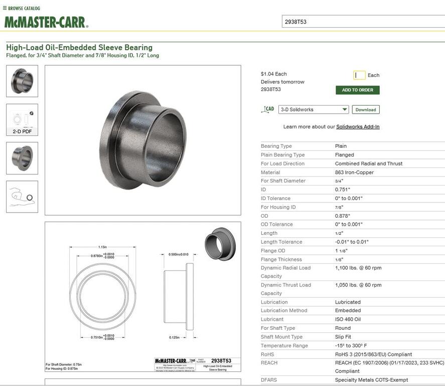

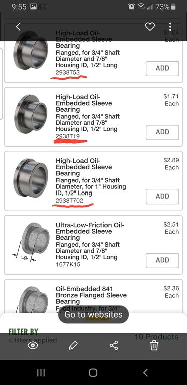

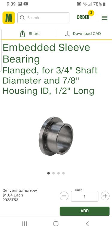

gt14rider 1,119 #6 Posted July 24, 2024 Mcmaster carr, thay have other material to choose from. You can grind to width. At 1.04 ea I'd make it work 1 Share this post Link to post Share on other sites
ebinmaine 78,020 #7 Posted July 24, 2024 3 minutes ago, gt14rider said: Mcmaster carr, thay have other material to choose from. You can grind to width. At 1.04 ea I'd make it work Now that's what I'm talking about! Do you have an item number? 1 Share this post Link to post Share on other sites
pfrederi 20,147 #8 Posted July 24, 2024 2938T53 1 1 Share this post Link to post Share on other sites
gt14rider 1,119 #9 Posted July 24, 2024 Paul beat me to it. 1 1 Share this post Link to post Share on other sites
peter lena 9,815 #10 Posted July 24, 2024 @ebinmaine glad a collective view , has given you an answer , pete 1 Share this post Link to post Share on other sites
ebinmaine 78,020 #11 Posted July 24, 2024 4 hours ago, pfrederi said: 2938T53 4 hours ago, gt14rider said: Paul beat me to it. That's awesome! Thanks guys. I looked yesterday but I was using a different flange thickness because that's what I took off. No way an extra thick flange is a negative issue in this situation! 1 Share this post Link to post Share on other sites

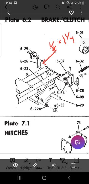

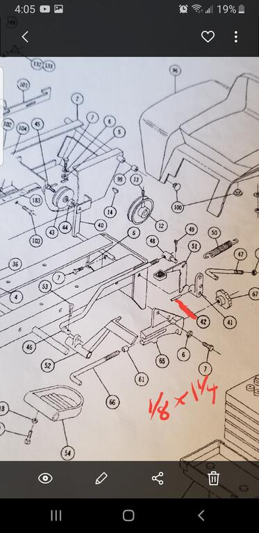

ebinmaine 78,020 #12 Posted July 24, 2024 Since you guys are on such a wicked roll... Any idea what the diameter is on the roll pins used in the clutch pulley idler shaft on the old eight speeds? I couldn't decide if it was 9/64 or 5/32. Or should I just get the 5/32 and expand the shaft bore hole with the right drill bit if needed??? Share this post Link to post Share on other sites
Handy Don 16,134 #13 Posted July 24, 2024 Believe it or not, I saw these in packs of two in the Hillman bins at a Lowes in different sizes for about $2 each 2 Share this post Link to post Share on other sites
gt14rider 1,119 #14 Posted July 24, 2024 Pic of a 73 no name 1 Share this post Link to post Share on other sites
gt14rider 1,119 #15 Posted July 24, 2024 Pic of 856 1 Share this post Link to post Share on other sites
peter lena 9,815 #16 Posted July 24, 2024 @gt14rider @ebinmaine another brain fart on that , why not get that 1/8x 1, 1/4 in a longer length , possible $ saving , and use a cutting wheel to make what you want ? https://www.amazon.com/Spring-Pins-1-8-Hardware/s?rh=n%3A16410401%2Cp_n_feature_ten_browse-bin%3A19044679011, regularly look at a problem , for related , similar issue . BTW that schematic lay out , also makes me think of detail tweaking for effortless function, done a lot of that , good talkin , pete 1 Share this post Link to post Share on other sites

ebinmaine 78,020 #21 Posted August 6, 2024 (edited) On 7/24/2024 at 2:52 PM, ebinmaine said: Since you guys are on such a wicked roll... Any idea what the diameter is on the roll pins used in the clutch pulley idler shaft on the old eight speeds? I couldn't decide if it was 9/64 or 5/32. Or should I just get the 5/32 and expand the shaft bore hole with the right drill bit if needed??? @gt14rider You were correct on the 1/8 pins. Thanks! I ordered a bag of 1/8 and knowing there was a broken pin with a worn oval shaped hole I also ordered a bag of 5/32 and two good drill bits. Turns out a Previous Owner had already done the oversized bore to the clutch pedal lever/rod connection!! Edited August 6, 2024 by ebinmaine Correct autocorrect 1 Share this post Link to post Share on other sites
