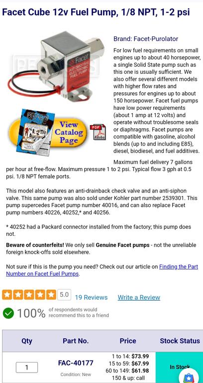

squonk 48,427 #4 Posted July 23, 2024 Facet low pressure pump. Carbole or Mr. Gasket are the exact same pump. Napa # is 610-1051 6 Share this post Link to post Share on other sites

Goldnboy 1,156 #6 Posted July 23, 2024 I recommend the faucett 40177 electric fuel pump, very low psi usa made and not plastic. 4 Share this post Link to post Share on other sites

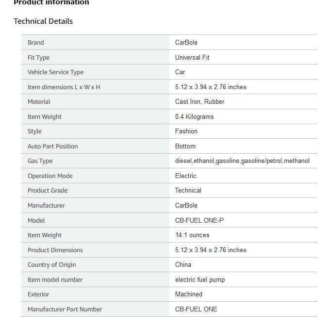

squonk 48,427 #17 Posted July 25, 2024 Carbole, Mr.Gasket, Facet, they are all the exact same pump with a different brand name attached. 2 Share this post Link to post Share on other sites

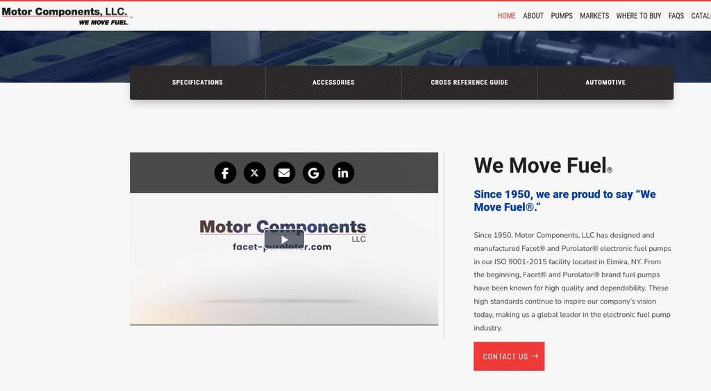

pfrederi 21,342 #21 Posted July 25, 2024 1 hour ago, squonk said: Carbole, Mr.Gasket, Facet, they are all the exact same pump with a different brand name attached. Carbole pumps are made in China..Facet are made in USA 2 Share this post Link to post Share on other sites
squonk 48,427 #22 Posted July 25, 2024 (edited) 2 hours ago, pfrederi said: Carbole pumps are made in China..Facet are made in USA I stand corrected. Same body and look though. Edited July 25, 2024 by squonk 1 Share this post Link to post Share on other sites
pfrederi 21,342 #23 Posted July 25, 2024 I would guess Chinese clone like the Honda small engine knock offs... 1 Share this post Link to post Share on other sites
