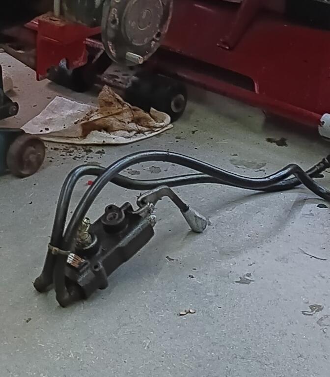

ebinmaine 79,012 #1 Posted July 22, 2024 1984 Workhorse GT1800 hydro lift valve needs O-rings. Anything we need to know about disassembly? How to? What NOT to do? Thanks! Share this post Link to post Share on other sites
lynnmor 8,831 #2 Posted July 22, 2024 (edited) There is a screw in the back, remove it and out comes the spool, simple as it gets. Replace the o-rings on the hose connections, if it has them, while it is out. Edited July 22, 2024 by lynnmor 1 1 Share this post Link to post Share on other sites
Handy Don 16,682 #3 Posted July 22, 2024 (edited) Under the acorn nut is the pressure relief valve. No need to mess with that unless there’s a known issue. Recalibrating it requires a hydro pressure gauge and some plumbing bits! Edited July 22, 2024 by Handy Don 1 1 Share this post Link to post Share on other sites
ebinmaine 79,012 #4 Posted July 22, 2024 26 minutes ago, lynnmor said: . Replace the o-rings on the hose connections, if it has them, while it is out. Getting 4 new hoses installed. All have new Orings. 1 1 Share this post Link to post Share on other sites
