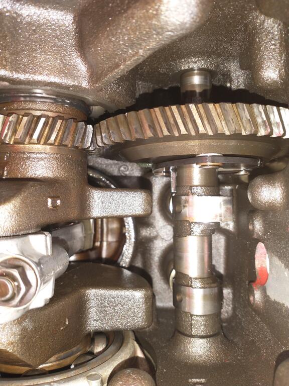

squonk 47,419 #30 Posted July 22, 2024 Kohler says Detergent oil. That's what I use. Use what you like. Results may vary. I use Rotella 30W year round. I bought my C-160 with 700 hrs. on it. It smoked like crazy. Oil was as black as I ever saw it. I put some kero in the crankcase and spun the engine by hand to swish it around then drained it. Chunks of sludge came out. I theorized it had non detergent in it for a long time. Put in the Rotella and 300 hrs. later the piston broke. The inside looked like this. Again run whatever the hell you want. 4 1 Share this post Link to post Share on other sites

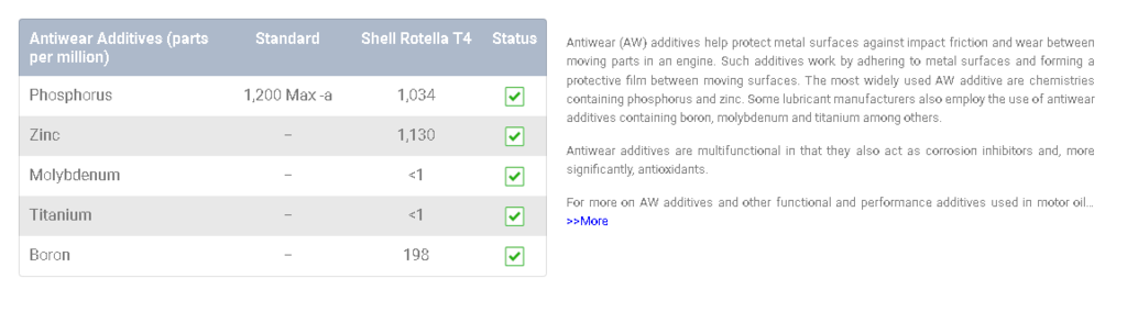

JoeM 10,099 #41 Posted July 23, 2024 I seen this website for oil testing, it list the diesel and passenger car oils tested along with transmission oils, lots of info. https://pqia.org/heavy-duty-diesel-engine-oil/ sample info 1 Share this post Link to post Share on other sites
