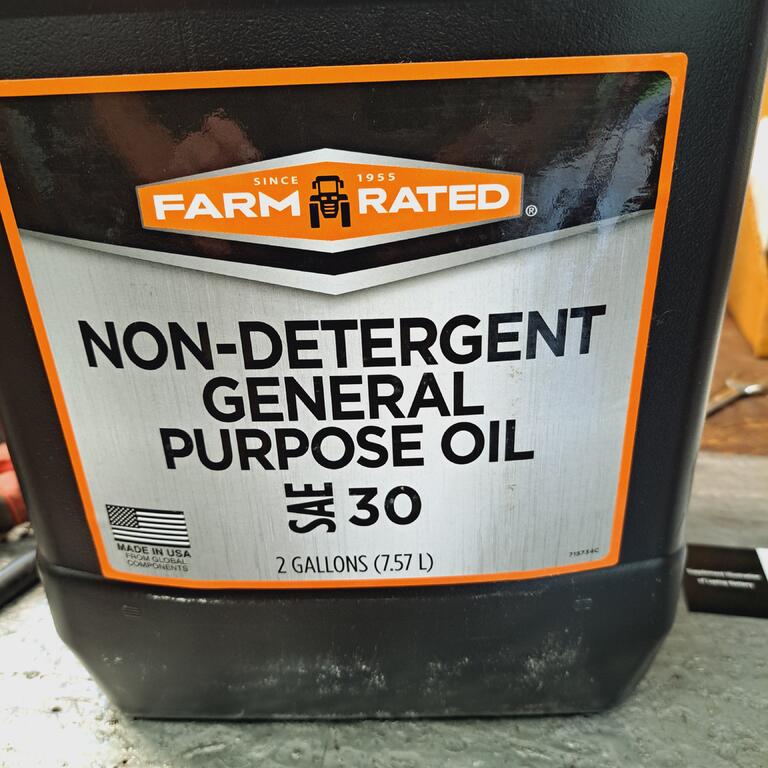

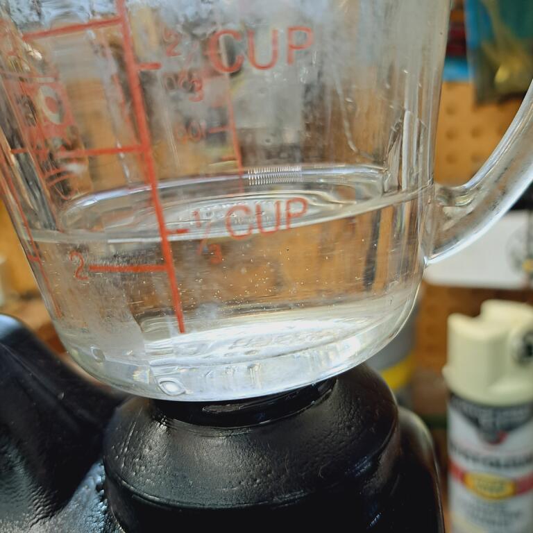

WHX?? 57,462 #1 Posted July 22, 2024 Bought this a while back for use in the herd. Thought is was just regular 30 weight but went to dump some in a push mower oil change for a customer & noticed it was clear. Never saw this before but got me wondering if it's suitable for use in our engines. Might have to zoom in on the fine print. Note it says nothing about being used as an engine oil. 2 3 Share this post Link to post Share on other sites
kpinnc 18,756 #2 Posted July 22, 2024 Wow. SAE 30 should be well, SAE 30! ...But that's just strange. 2 Share this post Link to post Share on other sites
ebinmaine 79,725 #3 Posted July 22, 2024 I've been given something similar when hunting Compressor oil. Share this post Link to post Share on other sites
rmaynard 17,433 #4 Posted July 22, 2024 I have been using SAE 30W, non-detergent oil in all of my non-filtered Kohler's since 1993. 3 Share this post Link to post Share on other sites
squonk 47,421 #5 Posted July 22, 2024 SAE 30 just means it's weight (viscosity) at 32° or higher. Got to look at the API rating on the bottle if any. I wouldn't use it. Kohler says to use Detergent oil in all of their engines. I bet Briggs does too. Non detergent oil should be used in non combustion applications like compressors and pumps. 7 1 1 Share this post Link to post Share on other sites
Bill D 2,997 #6 Posted July 22, 2024 That's air compressor oil. Don't use it in an engine. 5 1 Share this post Link to post Share on other sites
ri702bill 12,501 #7 Posted July 22, 2024 21 minutes ago, Bill D said: That's air compressor oil. Don't use it in an engine. Bill D is correct - what you have there is NOT suitable for use in gasoline engines - it is mineral oil base. It is a hydraulic oil. Note that it does NOT list an API rating found on motor oil (API SL for instance) 4 Share this post Link to post Share on other sites
Pullstart 70,752 #8 Posted July 22, 2024 9 hours ago, rmaynard said: I have been using SAE 30W, non-detergent oil in all of my non-filtered Kohler's since 1993. Right, wrong or indifferent, I’ve used it too. Not all the time, but I’ve made the executive decision that most likely I’ll live to talk about it. 2 2 Share this post Link to post Share on other sites
Wild Bill 633 936 #9 Posted July 22, 2024 (edited) @WHX??That oil is a special formula exclusively for Tecumseh engines only. Because they all end up being air compressors. LOL. Edited July 22, 2024 by Wild Bill 633 14 Share this post Link to post Share on other sites
ebinmaine 79,725 #10 Posted July 22, 2024 4 minutes ago, Wild Bill 633 said: @WHX??That oil is a special formula exclusively for Tecumseh engines only. Because they all end up being an air compressors. LOL. @Wild Bill 633 has now put that on the interwebs and we all know whatever's on the interwebs is true. 2 Share this post Link to post Share on other sites
squonk 47,421 #11 Posted July 22, 2024 25 minutes ago, Wild Bill 633 said: @WHX??That oil is a special formula exclusively for Tecumseh engines only. Because they all end up being air compressors. LOL. Couldn't have said it any better! 4 2 Share this post Link to post Share on other sites
953 nut 67,468 #12 Posted July 22, 2024 This chart gives a quick glance at oil ratings done by the API. Anything above SA would be fine for our splash lubricated engines but I don't think I would use anyt5hing without a "S" or "C" rating. The American Petroleum Institute (API) is the authority when it comes to setting standards for motor oils used in gasoline and diesel engines. Gasoline engines are classified under Category S, indicating "Spark Ignition", while diesel engines fall under Category C, indicating "Compression Ignition". Each category is followed by a letter, reflecting the oil's technological advancements. For gasoline engines, API specifications range from SA to SH, with higher letters representing newer technologies. Oils with specifications from SA to SH are typically suitable for engines manufactured before 1995. However, it's important to note that higher specification oils can be used in place of lower ones. For example, an oil with specification SP can be used for engines requiring API SN, SM, SL, and SJ. 5 1 Share this post Link to post Share on other sites

ebinmaine 79,725 #14 Posted July 22, 2024 9 minutes ago, 953 nut said: This chart gives a quick glance at oil ratings done by the API. ANYTHING ABOVE SA would be fine for our splash lubricated engines but I don't think I would use anyt5hing without a "S" or "C" rating. Also of note, SJ rating should be considered the upper limit on usable oil in flat tappet engines like most of ours are. Anything with a Letter higher than "J" will have reduced ZDDP. Does it really matter when we're changing the oil every 25 to 50 hours? Probably not.... But the small engine rated oils are readily available and often less expensive than modern gasoline rated oils so why not? 2 Share this post Link to post Share on other sites
ri702bill 12,501 #15 Posted July 22, 2024 47 minutes ago, ebinmaine said: Also of note, SJ rating should be considered the upper limit on usable oil in flat tappet engines like most of ours are. Anything with a Letter higher than "J" will have reduced ZDDP. And that is why I use Shell Rotella in all my outdoor 4 cycle engines.... 5 Share this post Link to post Share on other sites
ebinmaine 79,725 #16 Posted July 22, 2024 1 minute ago, ri702bill said: And that is why I use Shell Rotella in all my outdoor 4 cycle engines.... A good oil but overpriced around here. The Kinetix I use is $2 per Qt less and shipped to my door. Like RV Antifreeze or windshield washer fluid. Regional prices vary a lot. 2 Share this post Link to post Share on other sites
WHX?? 57,462 #17 Posted July 22, 2024 (edited) 12 hours ago, kpinnc said: ...But that's just strange. That's what I thought KP 11 hours ago, squonk said: API rating on the bottle 5 hours ago, ri702bill said: Note that it does NOT list an API rating found on motor oil (API SL for instance) No it does not... no wonder it was cheaper. 1 hour ago, Wild Bill 633 said: @WHX??That oil is a special formula exclusively for Tecumseh engines only. Because they all end up being air compressors. LOL. How did you know it is a tecky.... If it was my motor and an old smoker I might use it. Not in a customers returned with a snapped rod... out it comes and use it in the log splitter or compressors or Squeaky Pete door hinges. . Edited July 22, 2024 by WHX?? 1 Share this post Link to post Share on other sites

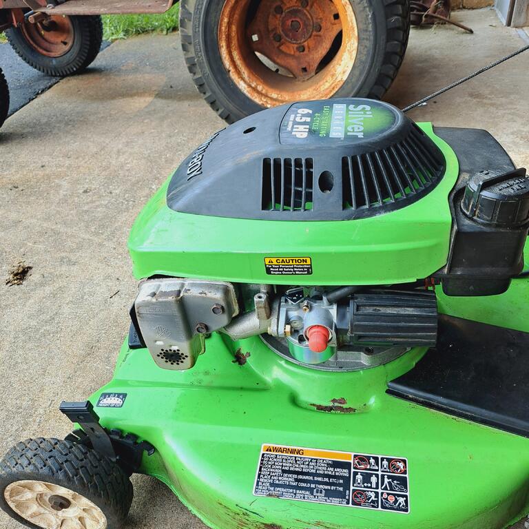

WHX?? 57,462 #18 Posted July 22, 2024 Say what you want about techys but this runs pretty good for a big box Carb bowl nut holes plugged and for 14 clams on fleabay for a new one wasn't even gonna get cleaned. 1 Share this post Link to post Share on other sites

oliver2-44 11,632 #22 Posted July 22, 2024 In the mid-late 90's the ISO 64 oil we used in Hydro Turbine and Generator Bearings changed to a Base II oil. That was the first I learned of Base I,II,II and IIII oil. Base refers to how the crude oil feedstock is processed at the refinery. I used this Machinery Lubrication website a lot back in my work days. https://www.machinerylubrication.com/Read/29113/base-oil-groups Base II oil is clearer, so it has less "Dino" dandruff left in it. But as other have said that oil if for hydraulics' or a compressor. 1 Share this post Link to post Share on other sites

Skwerl58 831 #24 Posted July 22, 2024 I picked up some of the Walmart branded Super Tech ND sae 30 oil a few of years ago. It stated it was sae ND lubricating oil, and in fine print stated " not for use in automotive gasoline engines". I filled my old oil cans with it for lubing squeaks and wear areas on my mowers and stuff. I was going to use it in an oil change but went with Rotella T1 30w and have been using Rotella since. 3 Share this post Link to post Share on other sites
