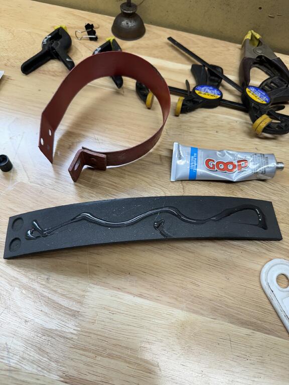

squonk 48,207 #5 Posted July 21, 2024 Scuff up the band where the lining attaches. Gives the glue something to bite on. Share this post Link to post Share on other sites
ebinmaine 80,883 #6 Posted July 21, 2024 51 minutes ago, squonk said: Scuff up the band where the lining attaches. Gives the glue something to bite on. Ours are always down to bare metal. I like the Goop idea. We may have some Gorilla glue around. Share this post Link to post Share on other sites

wallfish 20,652 #9 Posted July 22, 2024 1 hour ago, ebinmaine said: Ours are always down to bare metal. File sand or grind some on it to roughen the surface which will give a better grip than a completely smooth surface 1 Share this post Link to post Share on other sites
