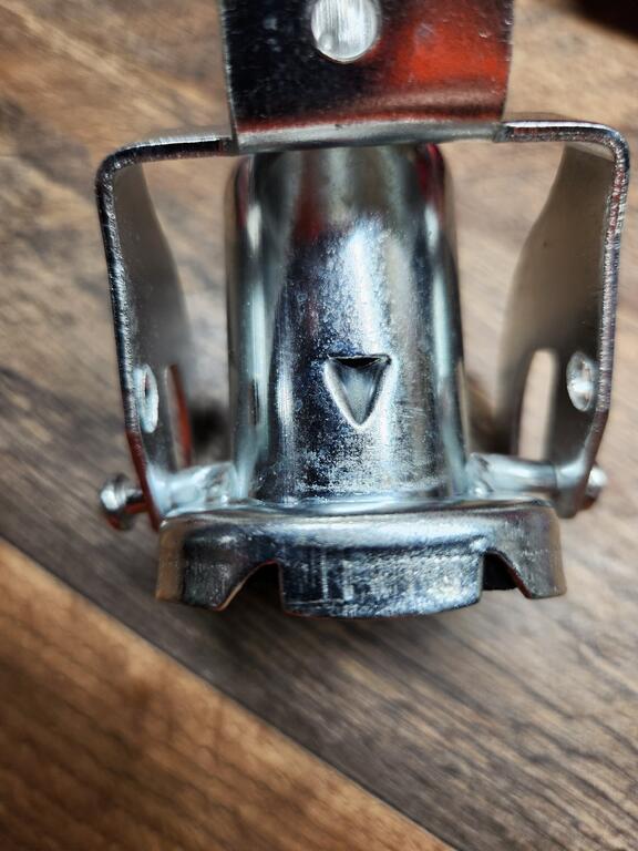

Racinbob 13,053 #2 Posted July 21, 2024 I may have you covered here. Are the two that leak newer models? I've tried about every type of gas can on the market today. They all are 100% junk. Finding older, pre 'safety' cans is nearly impossible. I bought a Jerry can about a year ago. I was pi@$# when it leaked gas all over my shoe. Here is the culprit. That triangular shaped hole is an engineers way of turning a great can to 100% junk. It the 'safety' vent. It leaks. But it's an easy fix. I cut and rounded a small piece of metal and affixed it with JBWeld. Another coat of JB and that's done. You MUST put one of those little flip up vents on the top of the can. Bingo! A good old fashioned Jerry can. Some of the newer cans can be improved by installing a flip vent and I've done that to five cans. But the nozzles suck. It almost makes it a 2 person job to fill a tank without spillage. I use those cans (just filled 4 with booze free) but only to transfer the gas to the Jerry can under ideal conditions. Only then does the tractors get filled. The Jerry can nozzle flexes where I want it and actually stays there. 🙂 1 2 1 Share this post Link to post Share on other sites

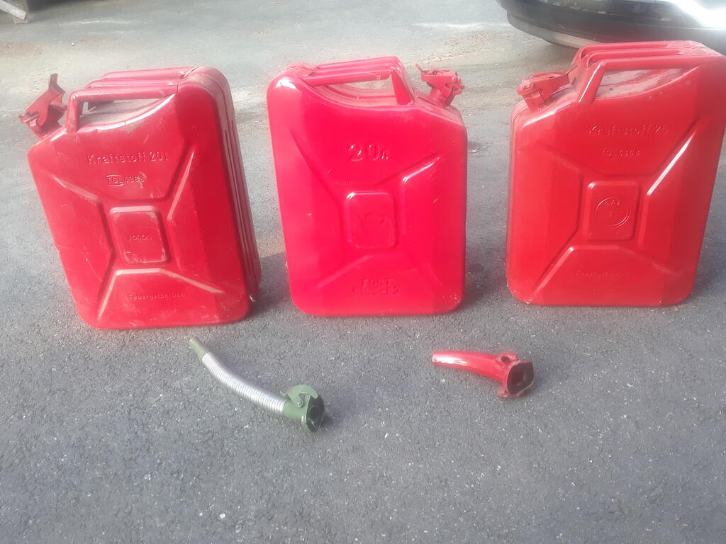

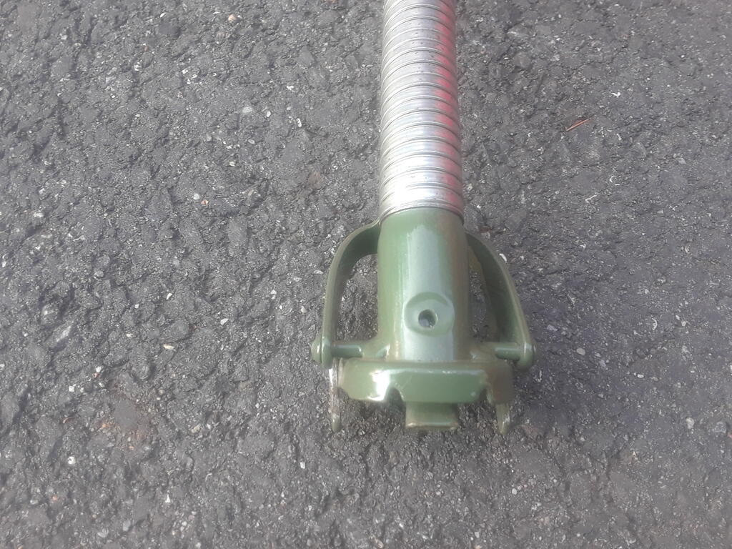

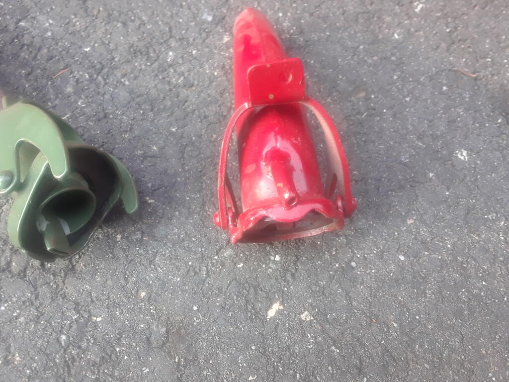

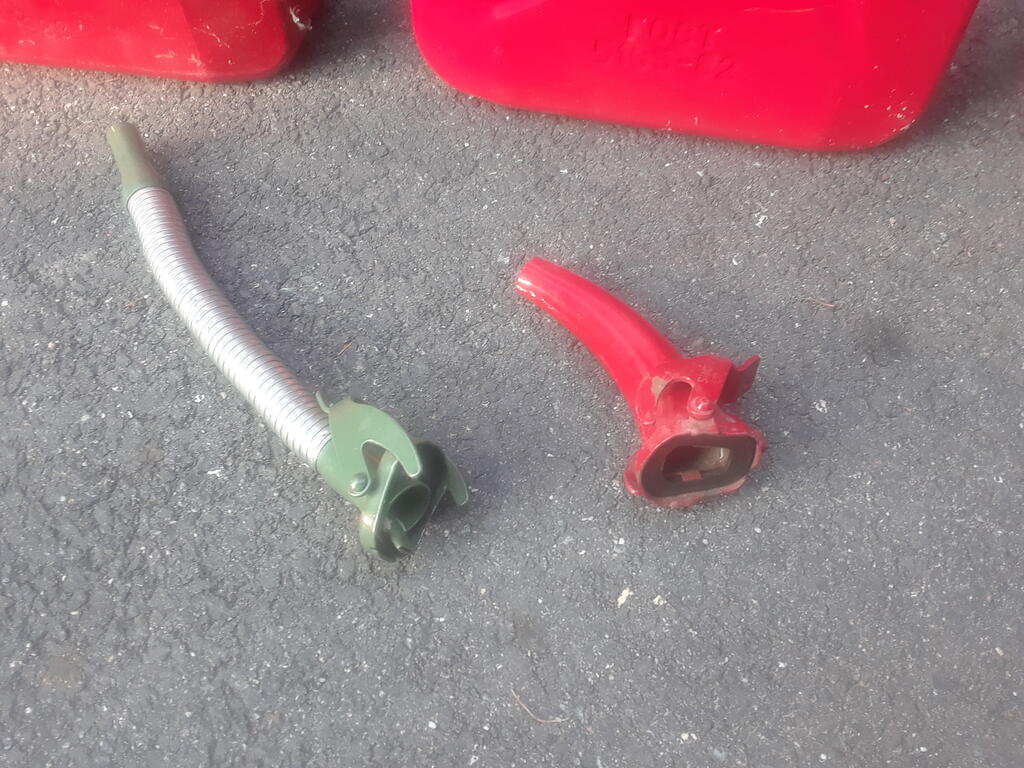

cod 135 #5 Posted July 28, 2024 Thanks for the responses and while I meant to reply before, I've been distracted. Here are the three amigos. The one on the left works best with the spouts in the other photos. For the other two cans, I get a large funnel and empty them into the 418. It works so I'll stick with it, although I continue to haunt yard sales and flea markets. I'll also check to see if the leak is from the vent and look into Racinbob's suggestion. Share this post Link to post Share on other sites
