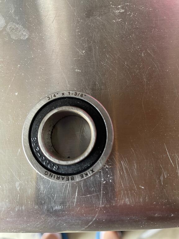

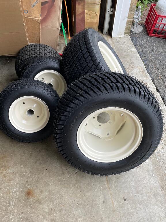

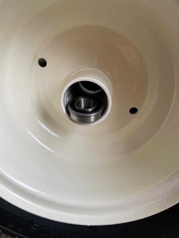

Sodaking27 1,435 #1 Posted July 20, 2024 Rims were finally dry enough to have the new tires mounted. Was all excited to be finally putting the C175 back together. Opened up the box of new wheel bearings and Houston we have a problem. Looks like the ID of these wheels are 1 3/4”? Of course I knocked the old bearings out and threw them away when I was painting the rims. C175 calls for Toro 4999 which is the standard 3/4 x 1 3/8. Guessing someone switched rims or did WH have different sizes? Any recommendations where I can get the correct size? Thanks. Share this post Link to post Share on other sites

pfrederi 21,342 #3 Posted July 20, 2024 (edited) What is the OD of the hub Standard WH is 1-9/16" 4999 the old number supersedes to the two Squonk showed. 418C and 520HC used a different front wheel and bearing wonder if it came from one of them... Edited July 20, 2024 by pfrederi 1 Share this post Link to post Share on other sites

Sodaking27 1,435 #5 Posted July 20, 2024 (edited) 53 minutes ago, pfrederi said: What is the OD of the hub Standard WH is 1-9/16" 4999 the old number supersedes to the two Squonk showed. 418C and 520HC used a different front wheel and bearing wonder if it came from one of them... OD of the hub is 2”. Remeasured the ID of the hub and it looks to be 1 11/16. 418C shows the regular bearing 110513. 520HC shows cone bearing. Edited July 20, 2024 by Sodaking27 1 Share this post Link to post Share on other sites

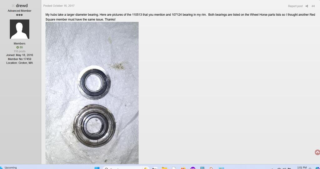

pfrederi 21,342 #7 Posted July 20, 2024 From an old post here...Note it is still a Wheel Barrow style just bigger. OP goes on to say he finally found some but never mentioned the non WH Bearing # Used on some 400 HC series and also the electro trac 1 Share this post Link to post Share on other sites
gwest_ca-(File Mod) 12,557 #8 Posted July 20, 2024 Anyone know what the bearing size is for the HD spindle kits available as an option? 80493 @ Toro Replaces 8-0490 80490, 8-0491 80491, 8-0492 80492 Replaced by 8-0494 80494 1 Share this post Link to post Share on other sites
Sodaking27 1,435 #9 Posted July 20, 2024 17 minutes ago, pfrederi said: From an old post here...Note it is still a Wheel Barrow style just bigger. OP goes on to say he finally found some but never mentioned the non WH Bearing # Used on some 400 HC series and also the electro trac @pfrederi That looks to be it. I read the post and he had a machine shop make bushings so he could use the cheaper 110513 standard bearings. I googled the 107124 and did not find any non WH bearings. Guess that teaches me to not be so quick to throw things away. 1 Share this post Link to post Share on other sites

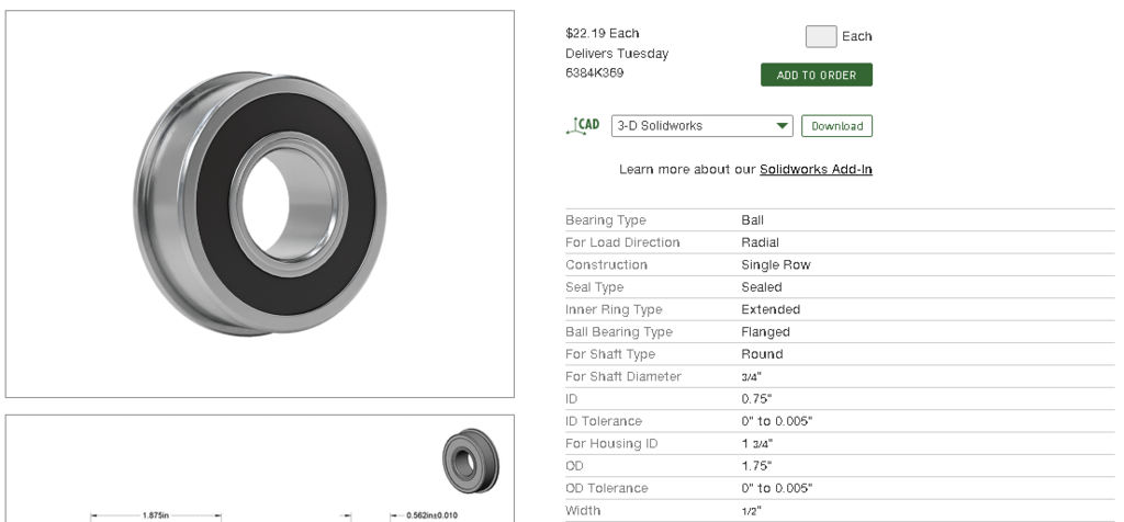

squonk 48,427 #13 Posted July 20, 2024 (edited) How bout looking up a flanged bearing by the dimensions? We have the OD of the spindle and the ID of the wheel hub. Edited July 20, 2024 by squonk 2 Share this post Link to post Share on other sites

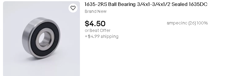

JoeM 10,318 #15 Posted July 20, 2024 If your hubs have an internal shoulder or a indent for the outer bearing race to reside against, might consider using a standard roller bearing. 1635-2rs I see mmc has the flanged ones but they are big bucks 2 Share this post Link to post Share on other sites
Sodaking27 1,435 #16 Posted July 20, 2024 23 minutes ago, JoeM said: If your hubs have an internal shoulder or a indent for the outer bearing race to reside against, might consider using a standard roller bearing. 1635-2rs I see mmc has the flanged ones but they are big bucks No internal shoulder and a 1 3/4 is to big. 1 Share this post Link to post Share on other sites
JoeM 10,318 #17 Posted July 20, 2024 42 minutes ago, Sodaking27 said: No internal shoulder and a 1 3/4 is to big must be metric?? 1 Share this post Link to post Share on other sites

wallfish 20,744 #21 Posted July 21, 2024 17 hours ago, pfrederi said: some one with an eclectro track or 418c could look I have both, 418-C and a 520-HC. 418-C just has normal bearings but the HD spindles and the 520-HC just has the normal 1" roller bearings. Nothing special on either one. Probably the easiest way is to just find new rims. The OD of a 3/4" roller trailer bearing is close to 1 3/4". What about machining that race down to fit the ID of the wheel? It would need a couple of dimples in the wheel to keep them or a piece of pipe between them. https://www.amazon.com/Trailer-Agricultural-WPS-LM11949-LM11910/dp/B01EBKYSWA/ref=asc_df_B01EBKYSWA?tag=bingshoppinga-20&linkCode=df0&hvadid=80607997944711&hvnetw=o&hvqmt=e&hvbmt=be&hvdev=c&hvlocint=&hvlocphy=&hvtargid=pla-4584207577350339&psc=1 A piece of DOM tube to fit through the wheel hub with a 1 3/8 ID for regular bearings. BUT the tube will need to be machined down to fit 1 11/16". It's carbon steel so much easier to machine than a hardened race would be. https://www.onlinemetals.com/en/buy/carbon-steel-round-tube?q=%3Aprice-asc%3AMaterial%3ACarbon%2BSteel%3AShape%3ATube-Round%3AInnerDiameter%3A1.375%22%3AOuterDiameter%3A1.75%22 3/4 ID by 1" OD DOM tube to covert the spindle from 3/4" to 1" then use 520 rims, or convert to 1" trailer hubs and wheels. Just kinda throwing different ideas against the wall to see what sticks. 3 Share this post Link to post Share on other sites

Sodaking27 1,435 #23 Posted July 21, 2024 As mentioned, I’m going to see if I can find a set of front rims and set these aside for now. I’m going to put a post in the Wanted section. Thanks to everyone for their suggestions and thoughts. 1 Share this post Link to post Share on other sites
