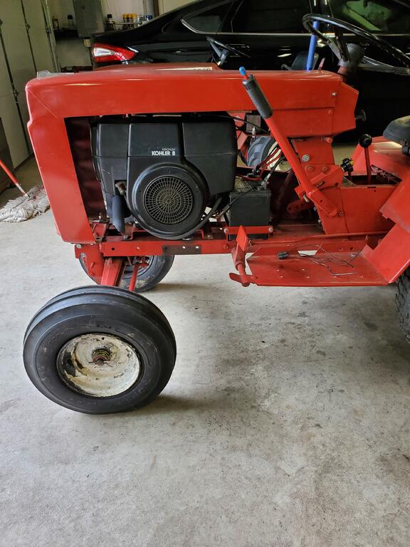

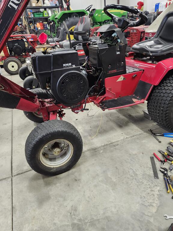

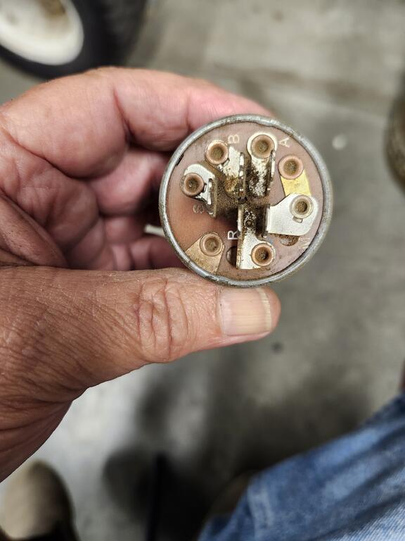

Moparfanforever 925 #1 Posted July 13, 2024 I took this Magnum engine and key switch out of a 312H that was running and driving, but the frame was cracked really bad. I swapped the engine and switch into this 520 that had a bad engine and hacked wiring. I rewired it using this switch from the 312,it is an Oregon 33 388 It starts and runs,but the problem is, when I turn the key to "start " ,I have to hold the key in start so it will stay running, unless I turn it to off ,then it will stay running in the off position. To shut it off, turn it to "start ". It sounds like I need to switch two wires, but I checked my wiring a half dozen times and it is right,I think. The switch worked fine in the 312. S to solenoid B to battery (30 amp fuse) R to rectifier (stator) M to mag Accessories is not wired yet, that doesn't matter, does it?? 1 Share this post Link to post Share on other sites

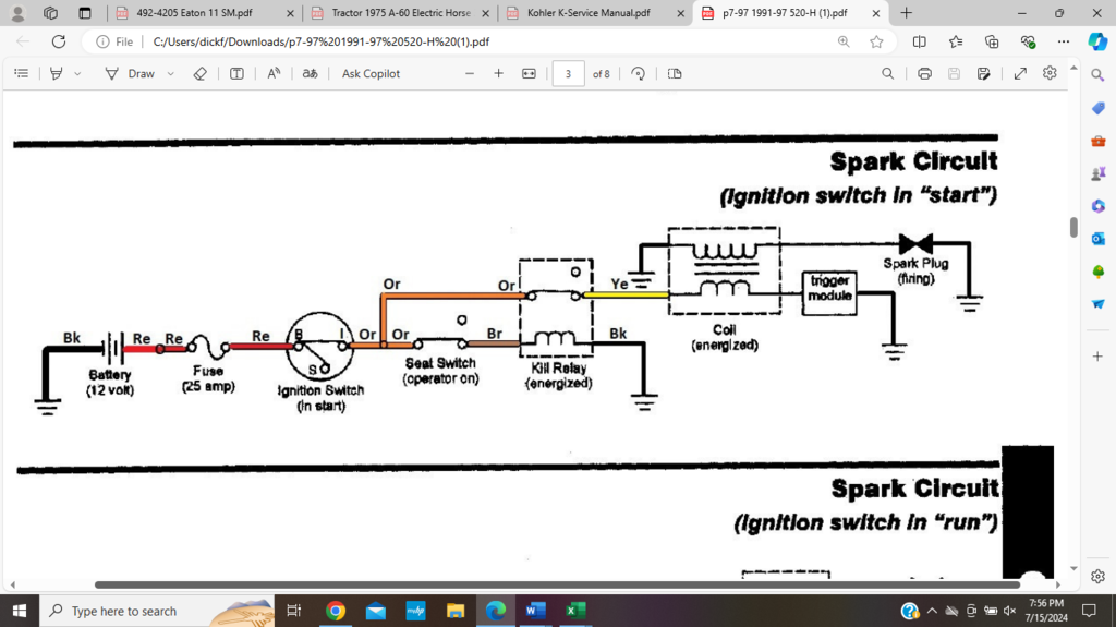

Moparfanforever 925 #7 Posted July 15, 2024 @953 nut I used the ignition switch from the 520 and a relay from the 520 and I only get fire at the plug when I turn the key to "OFF" ??? I wired it like in the link above, checked it three times and used two different relays. UGH!! My brain is hurting from this!! 1 Share this post Link to post Share on other sites

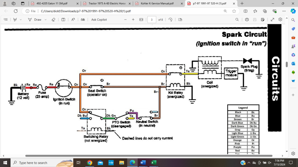

953 nut 64,636 #8 Posted July 16, 2024 should have taken a closer look at the 520 wiring first, seems your wiring system already has a kill relay. Looking at the wiring I am thinking the added kill relay will need to be attached to the yellow wirer from the installed relay rather 5than from the ignition switch. @gwest_ca, please take a look and see what you think. 1 Share this post Link to post Share on other sites

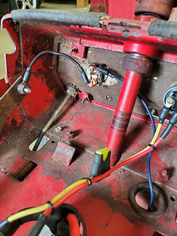

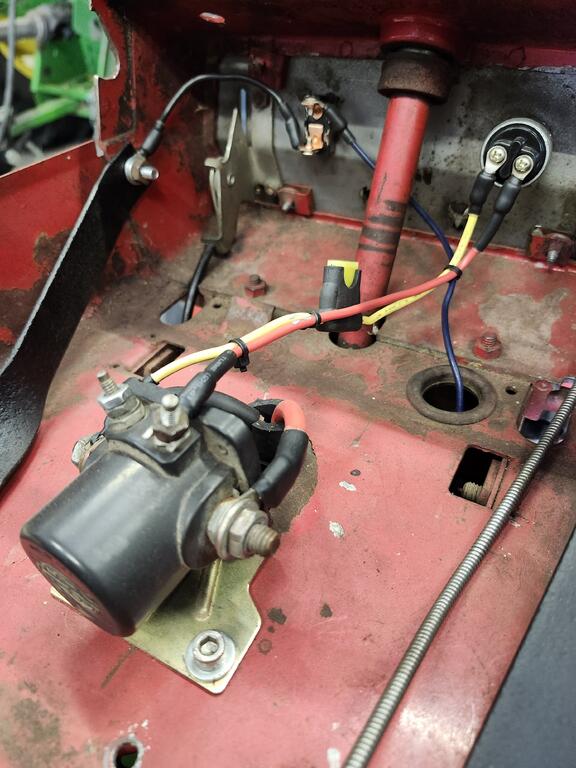

Moparfanforever 925 #9 Posted July 16, 2024 Not sure we are on the same page with the wiring?? The 520 wiring harness was butchered, so I took it ALL out and started from scratch, no safety switches either. I used new wiring, Packard connectors. Only used parts is the 520 key switch and the relay from the 520. Pretty simple to wire it, not sure what the deal is?? I am just about ready to pull the harness I made out and just use a push button switch for the starter and a toggle switch to kill the Mag. 1 Share this post Link to post Share on other sites

gwest_ca-(File Mod) 12,066 #12 Posted July 16, 2024 The 520 had battery ignition and the ignition circuit from the ignition switch powered the kill replay to supply battery power to the ignition coil. Shut ignition switch off and the relay contacts open. The terminal above the yellow on the kill relay is the one that would be connected to the magneto ignition. Yellow not used. Orange at kill relay needs to be disconnected from ignition circuit and grounded 1 1 Share this post Link to post Share on other sites
953 nut 64,636 #13 Posted July 16, 2024 7 hours ago, gwest_ca said: The 520 had battery ignition and the ignition circuit from the ignition switch powered the kill replay to supply battery power to the ignition coil. Shut ignition switch off and the relay contacts open. The terminal above the yellow on the kill relay is the one that would be connected to the magneto ignition. Yellow not used. Orange at kill relay needs to be disconnected from ignition circuit and grounded Thanks Gary, needed a second set of eyes on it. 10 hours ago, Moparfanforever said: Not sure we are on the same page with the wiring?? The 520 wiring harness was butchered, so I took it ALL out and started from scratch, no safety switches either. I used new wiring, Packard connectors. Only used parts is the 520 key switch and the relay from the 520. Pretty simple to wire it, not sure what the deal is?? I am just about ready to pull the harness I made out and just use a push button switch for the starter and a toggle switch to kill the Mag. Guess we don't need to look at the demassification drawings then. As long as you are the only one driving the 520 and are comfortable with simple is better that may be the way to go. Share this post Link to post Share on other sites
