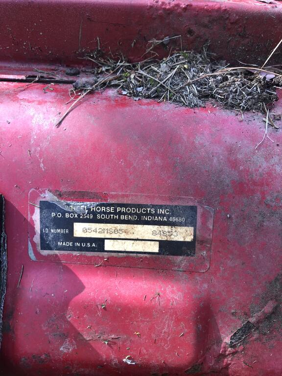

Ed Kennell 47,592 #2 Posted July 5, 2024 to the Brian. Can you tell us how the pulleys came to be misaligned? Did someone replace the center spindle with the wrong one? Pictures and the ID tag numbers will help is find the correct manual for your deck. 2 Share this post Link to post Share on other sites
Bryanmedic 0 #3 Posted July 5, 2024 I am not sure how they got misaligned but will investigate a little farther soon. I was hoping someone had a similar problem and maybe had some troubleshooting ideas. Share this post Link to post Share on other sites
Ed Kennell 47,592 #4 Posted July 5, 2024 Mower Rotary 42in SD 1986-1988 05-42MS05 3-400 OM IPL SN.pdf - Mower decks & reel - RedSquare Wheel Horse Forum Share this post Link to post Share on other sites

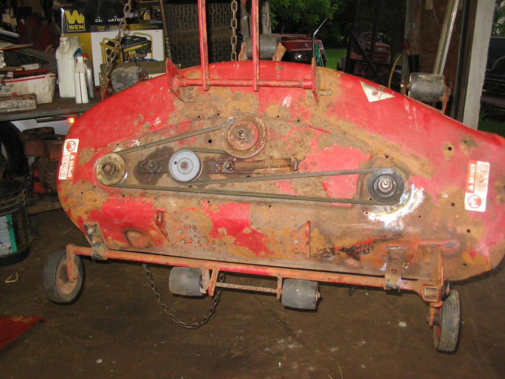

daveoman1966 3,884 #5 Posted July 5, 2024 This is the Spindle Belt on a 42" side disch deck... How it ought to be. No reason for belt shredding as mentioned. QUESTION: (1) are you sure the CENTER spindle pulley is NOT mounted upside-down? The correct belt for the 42" side deck is OEM #106125 (1/2 x 89") Q2: Does the FLAT TENSION idler bar wobble excessively? As for MIS-ALIGNED pulleys---that would have to be caused by a crooked-mounted spindle...possible from running into a stiff root or something. If you hit a root hard enough, it will bend the whole spindle back...twisting the deck shell in the process. Share this post Link to post Share on other sites
Bryanmedic 0 #6 Posted July 6, 2024 As far as the idler pulley bar it doesn't seem to wobble excessively. Im going to feel awfully silly if i put that center pulley on wrong because I replaced it earlier this year. Thank you for your response. It’s much appreciated! Share this post Link to post Share on other sites
Brockport Bill 2,480 #7 Posted July 6, 2024 (edited) The center double pulley is designed with large pulley on top...is yours correct....hard to tell from photo??? Suggest you go to Toro online or partstree.com to look at mower deck diagrams for respective correct installation of all relevant parts....also as an added maintenance suggestion for healthy belts be sure the slots the belt rides in on the pulleys is clean and smooth....I use wire wheel on my drill to buff them up and remove any rust or imperfections that will cause friction or irregular rubbing on belt.....especially if tractor is left outdoors the rain will cause corrosion in pulley slots causing friction. If you don't have specific mower deck manual suggest you download one..also although many people remove their pulley belt covers the covers can prevent debris twigs etc getting on top of deck and interference with pulley rotation of belts. I keep my covers on but use leaf blower to be sure the area under them is cleaned out after each mowing . Good luck....?? Edited July 6, 2024 by Brockport Bill Made info clearer 1 Share this post Link to post Share on other sites

Bryanmedic 0 #9 Posted July 7, 2024 The pulley was on correctly as it turned out. I will be repairing the deck this winter, I just need to get through this season. I will keep troubleshooting as of now and will keep everyone posted. Thanks! Share this post Link to post Share on other sites
