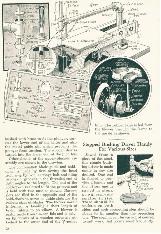

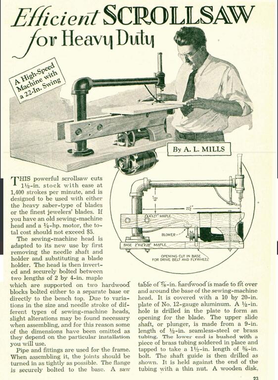

953 nut 70,389 #1 Posted July 5, 2024 Pipe dream scroll saw I came acrost an article for a home built electric powered scroll saw whose base is made from standard iron pipe and fittings. There was no date given but it was probably from the depression era. The powerful scroll saw cuts 1"+ stock with ease at 1400 strokes per minute, and is designed to be used with either the heavy saber type blades, or finer jewelers type blades. If you have an old sewing machine and a 1/4 HP motor, the total cost will be very low. 5 1 Share this post Link to post Share on other sites

Treepep 1,151 #4 Posted July 5, 2024 Has anyone ever built any of these machines? I do not have and old sewing machine, washing machine briggs or an old ford. Some of these I have seen in pictures or at shows (doodlebug). Surprising that otherwise I have never seen any of these homemade artworks. 2 Share this post Link to post Share on other sites
