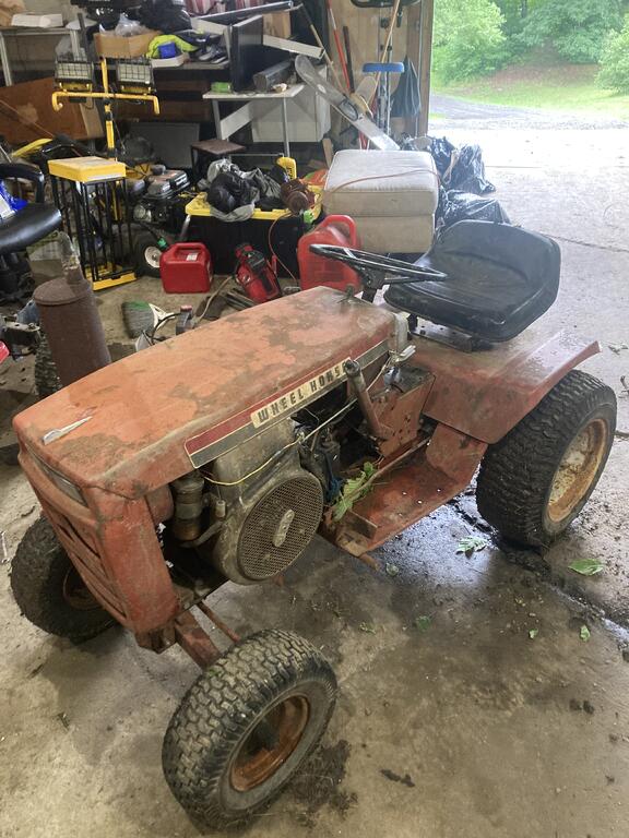

Craig.b 4 #1 Posted June 30, 2024 Hi everyone, new to forums in general so if I’m doing this wrong I’m sorry. I just bought a wheel horse 800 auto and I am blown away with the pulling power and overall just beast of a machine for in general. After doing some research I found this model has a lighter duty rear end then the non auto models but I live in a hilly area and was hoping there was a way to lock the rear end still? I find myself having the power to pull the load I’m pulling I’m just losing traction to the one wheel peel. Any information on locking the rear or even other upgrades to be an even better worker would be amazing. Thanks everyone! p.s I noticed these originally came with a Briggs but this one seemed to be swapped with a 12hp Kholer 2 Share this post Link to post Share on other sites

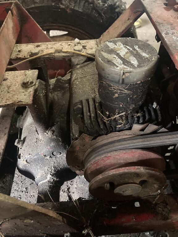

Ed Kennell 44,992 #10 Posted June 30, 2024 Your 800 has the early Eaton 6 hydro. Like stated above, do not attempt to lock the differential. To increase traction: 1. add chains in the existing turf tires preferably 2 link with vee bar 2. add weight filled tires with windshield washer fluid, wheel weights, rear weight box. This transmission only has a parking brake. Use the motion control lever to control motion including stop. 2 Share this post Link to post Share on other sites

ebinmaine 77,504 #12 Posted June 30, 2024 3 hours ago, Craig.b said: I have noticed the weak braking ability 55 minutes ago, Ed Kennell said: This transmission only has a parking brake. Use the motion control lever to control motion including stop @Craig.b This is a fully hydrostatic machine. There's no actual "brake". To slow down and/or stop use the motion lever to accomplish it. It's not at all abnormal for many hydros to pick up speed going down or lose it going up. When you set the speed control it was for the conditions in play at that second. ANY change requires you to adjust speed. @8ntruck thanks for the "mention". 1 Share this post Link to post Share on other sites
