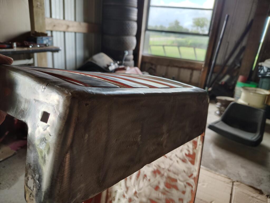

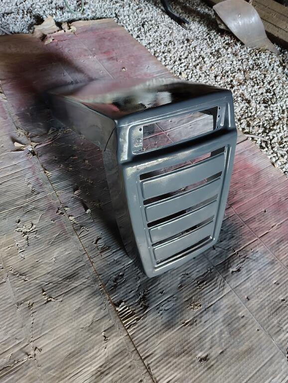

Retired Wrencher 7,027 #176 Posted August 24, 2025 (edited) 9 hours ago, AlexR said: I think I got the hood to a point I don't think it beating on it more is going to help. Before After Alexa you kinda remind me of me when I was a younger man I did all the sanding and stripping paint. It’s a lot of work. And having come out right. I hope you enjoy the project. And the Ride when done! Edited August 24, 2025 by Retired Wrencher 3 1 Share this post Link to post Share on other sites

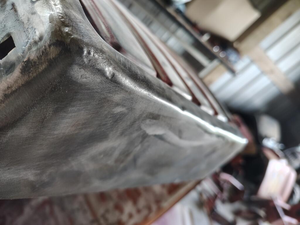

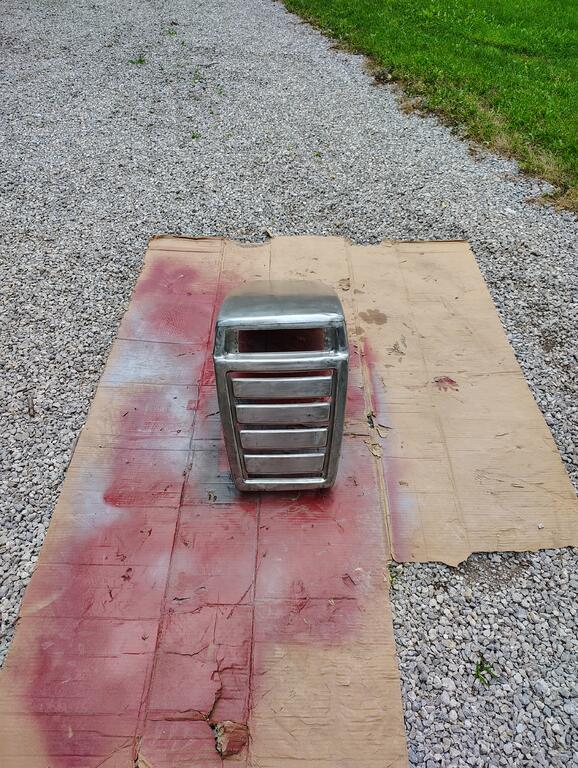

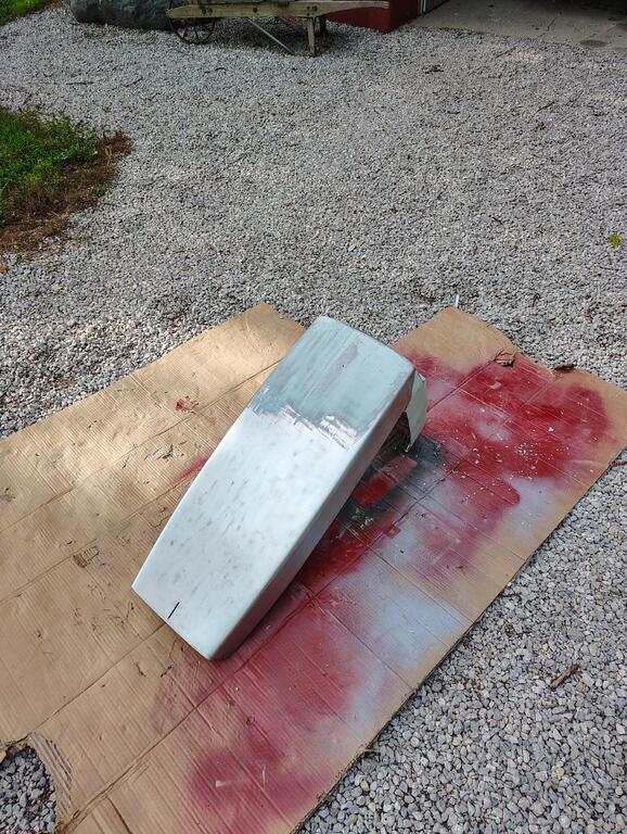

AlexR 3,136 #179 Posted August 24, 2025 Thanks for the positivity guys I appreciate it!! I am definitely spending more time on this hood, then I thought I would. But I also realize its the focal point of these tractors, it's also what has the most paint showing. So today got all of the paint stripped off, cleaned it really good and got some bondo on it. It's been a little while since I did bondo last, so it might take a little more sanding, but it's also hard to get it on the small curved areas as well. Shiny hood!!! I was slightly tempted to clear coat it and leave it as is, lol! 2 5 2 Share this post Link to post Share on other sites

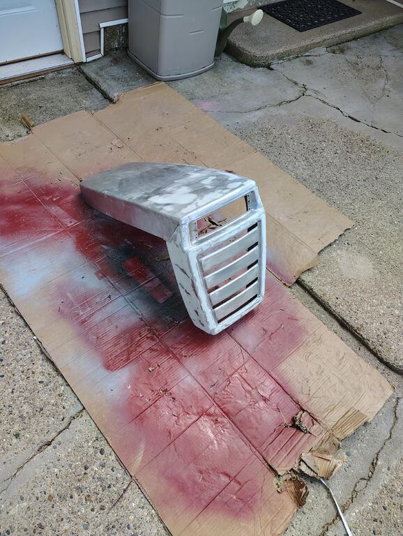

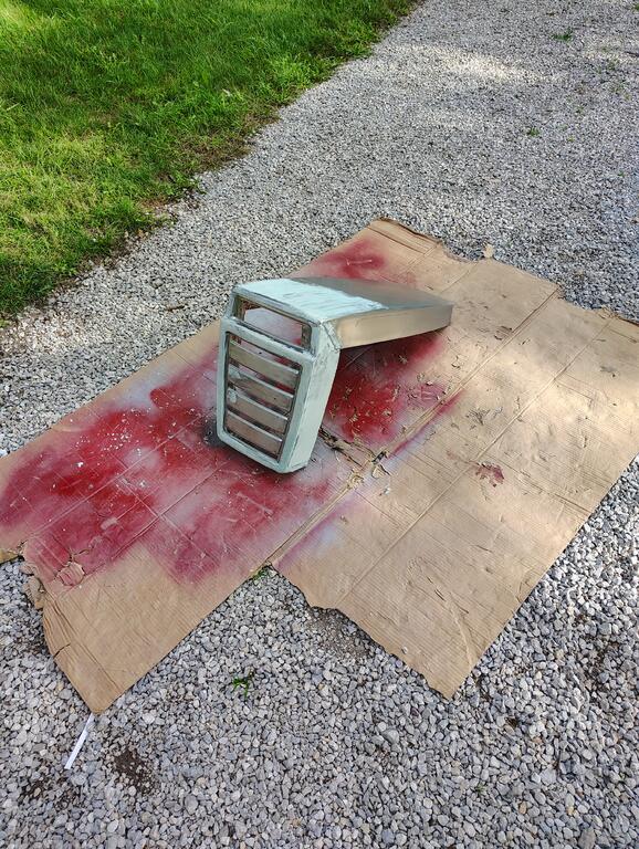

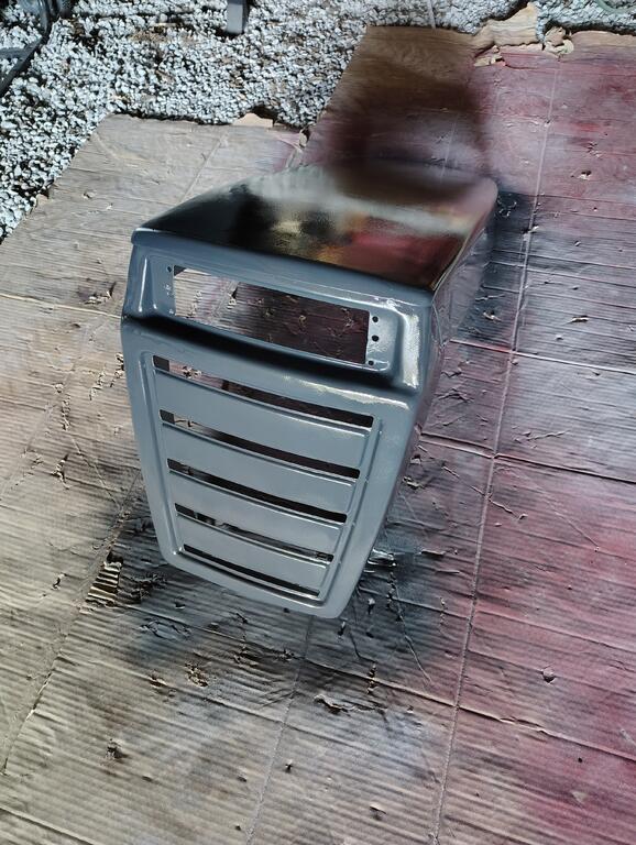

AlexR 3,136 #180 Posted August 25, 2025 I'm making a lot of posts and not much progress lol Got it sanded down. Gotta fill hopefully just one more time. 6 Share this post Link to post Share on other sites

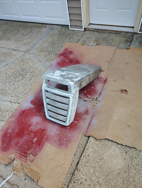

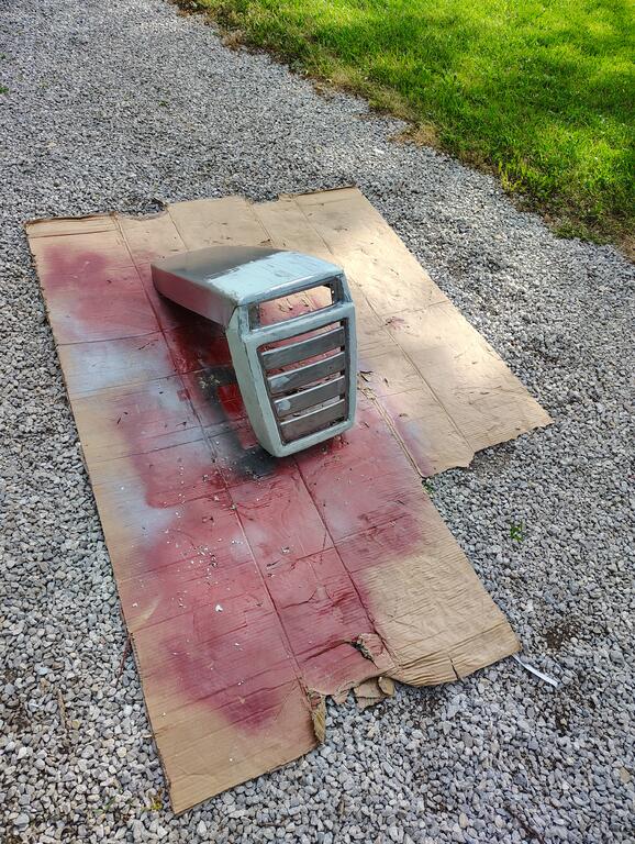

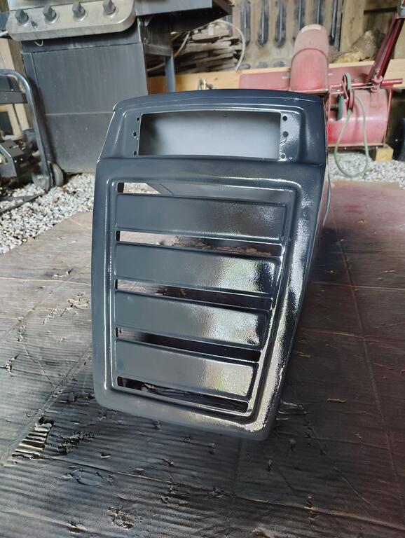

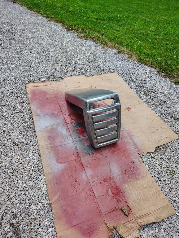

AlexR 3,136 #181 Posted August 29, 2025 Got some sandable primer on the hood. After I get it sanded down and a coat of regular primer it will get painted to cure for a while so it will be ready for decals when I get to that point. 5 4 Share this post Link to post Share on other sites

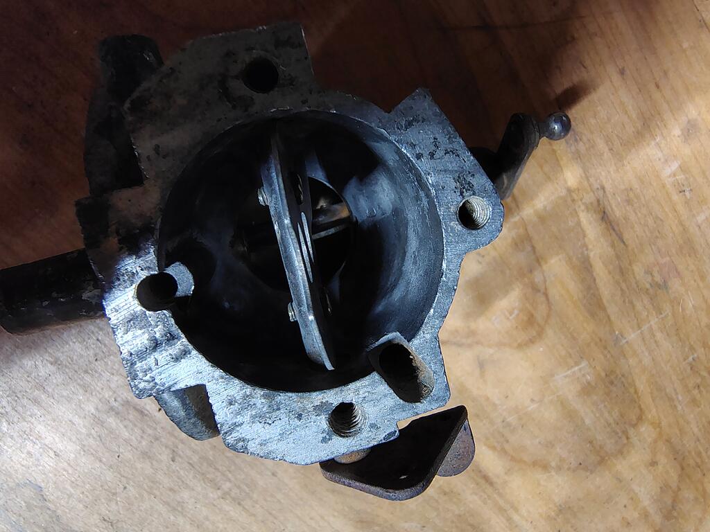

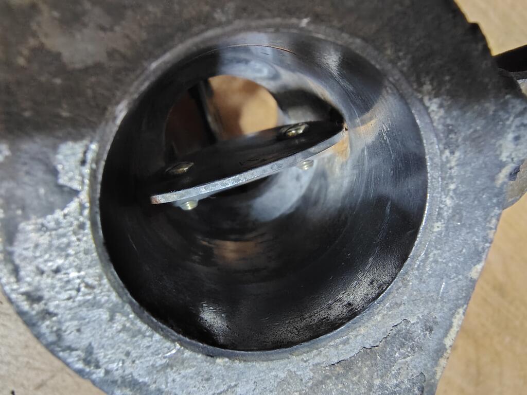

AlexR 3,136 #182 Posted September 4, 2025 Thanks to @ebinmaine got a "new" carb body still needs more cleanup I haven't ran it in the ultrasonic cleaner yet either. The shafts are also still pretty tight. 4 1 1 Share this post Link to post Share on other sites

Achto 32,889 #184 Posted September 4, 2025 On 8/29/2025 at 3:17 PM, AlexR said: Got some sandable primer on the hood. After I get it sanded down and a coat of regular primer it will get painted to cure for a while so it will be ready for decals when I get to that point. Should be no reason to re-prime it. Wet sand it with 400grit and spray your paint. 5 Share this post Link to post Share on other sites

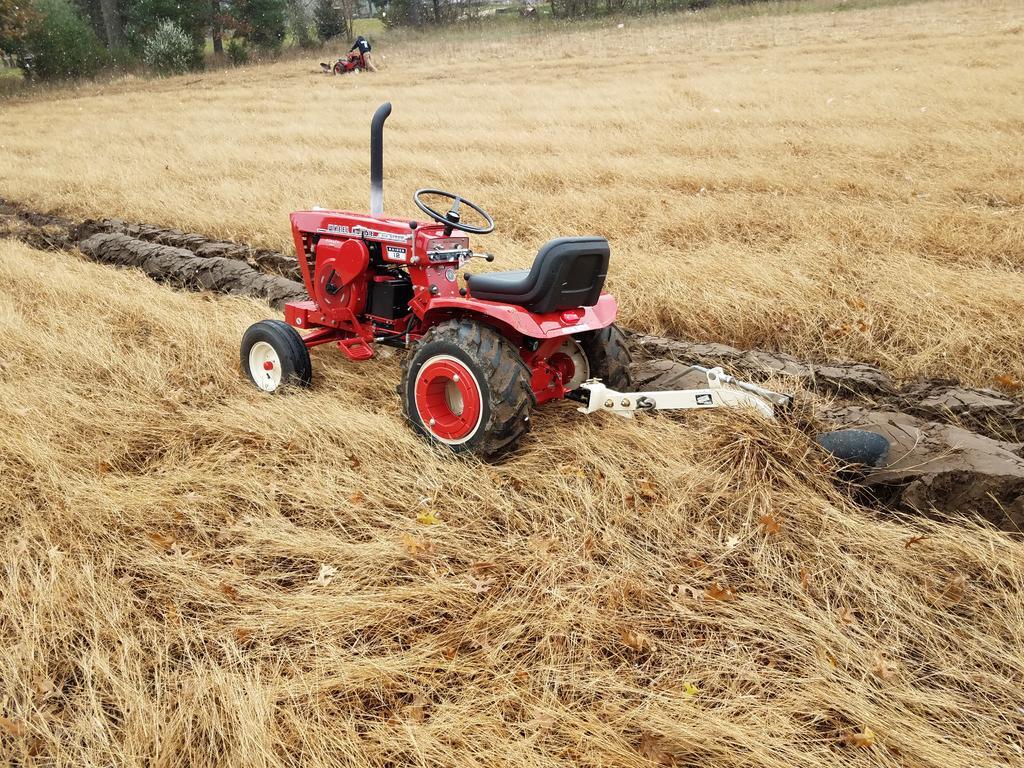

WHX?? 58,324 #186 Posted September 4, 2025 (edited) On 8/24/2025 at 11:48 AM, ebinmaine said: spend so much time restoring a tractor just to go get it scratched and dirty again. 4 hours ago, Pullstart said: Good thing @Achto never works his restorations, right @WHX?? Right?!?!? The first time Dan plowed with his '68 12 in 2017 it was a real POS. Wires hanging everywhere ... didn't charge ... crap falling off. But he laid the boots to it anyway ... Fact it was so bad he finally parked it. That next winter he did his magic built his own stack ... paint ... working hydraulics ...spit & polish. Even the plow looked like it just came from Brinly. Some where in here there is a thread on it. Brings it to plow day 2018 I says you aint's a gonna stick that in the dirt are ya??? Silly me ... Who's that clown in the back stuck?!?!? That was brutal plowing that year! Edited September 4, 2025 by WHX?? 7 2 Share this post Link to post Share on other sites

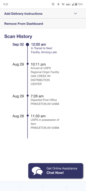

WHX?? 58,324 #187 Posted September 4, 2025 You get the package yet Alex? 1 Share this post Link to post Share on other sites
AlexR 3,136 #188 Posted September 4, 2025 39 minutes ago, WHX?? said: You get the package yet Alex? Not yet USPS is doing its thing haha 1 Share this post Link to post Share on other sites
WHX?? 58,324 #189 Posted September 4, 2025 So much for last Tuesday ... I suppose the holiday in there ... 1 Share this post Link to post Share on other sites
AlexR 3,136 #190 Posted September 4, 2025 2 minutes ago, WHX?? said: So much for last Tuesday ... I suppose the holiday in there ... Eb sent out the carb from Maine same day you send that out and his got to me Tuesday As long as it eventually shows up it's all good. 1 Share this post Link to post Share on other sites

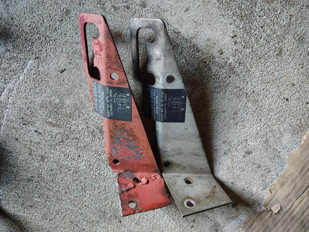

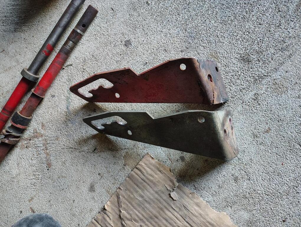

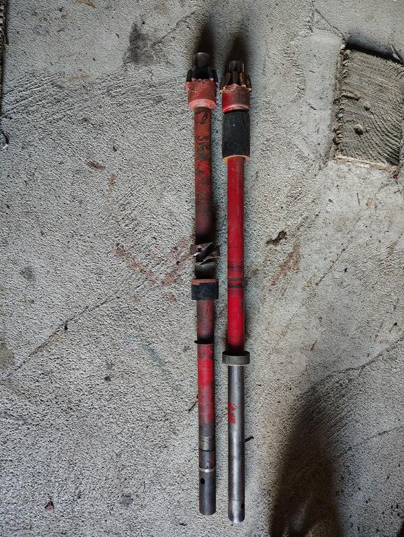

AlexR 3,136 #195 Posted September 5, 2025 Thanks to @WHX?? I got a steering shaft that will work with just cutting 1/4" off and drilling a new hole. And the PTO bracket is so much better!!! 6 Share this post Link to post Share on other sites
SylvanLakeWH 32,774 #196 Posted September 5, 2025 Make sure you clean off the cheese curd jits... 5 Share this post Link to post Share on other sites
ebinmaine 81,046 #197 Posted September 5, 2025 4 hours ago, AlexR said: cutting 1/4" off Likely you could leave it alone. Just have the steering wheel 1/4" higher. 3 Share this post Link to post Share on other sites
