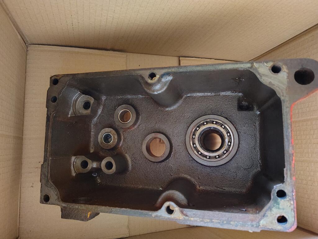

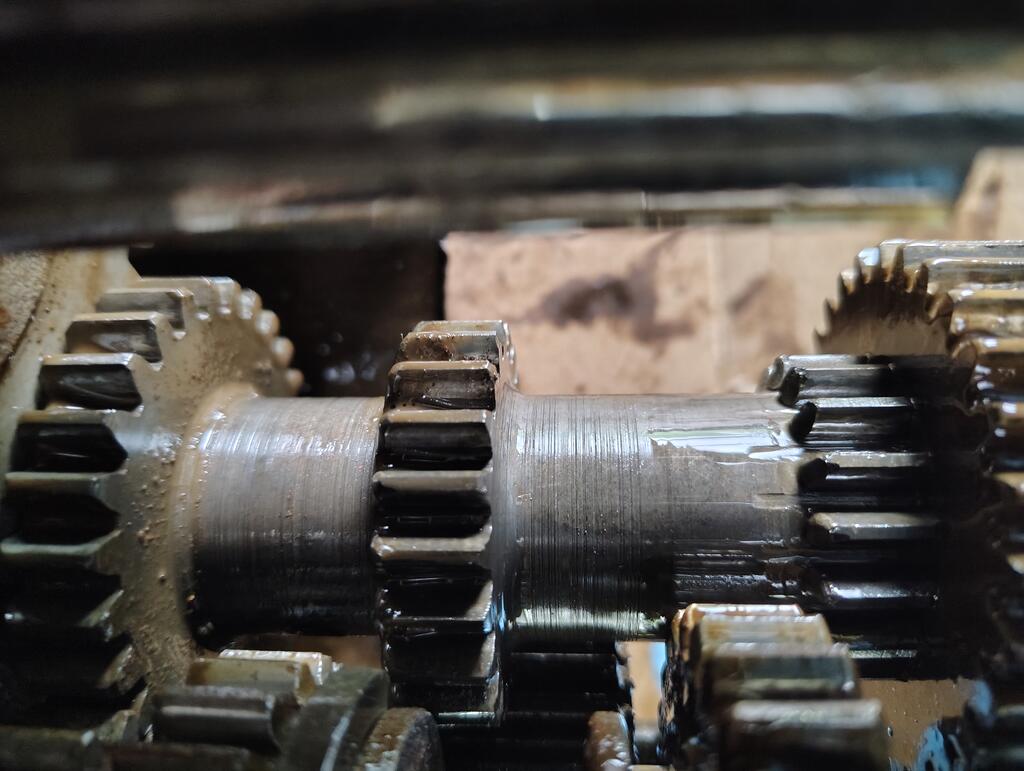

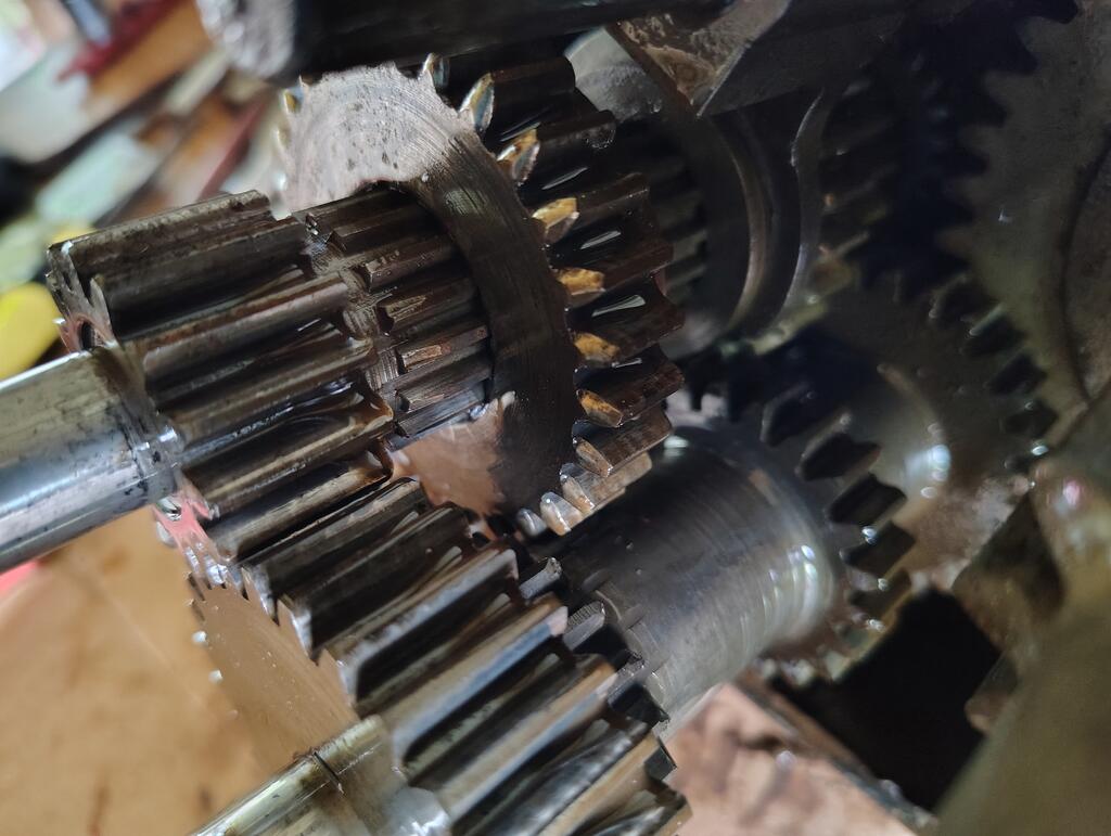

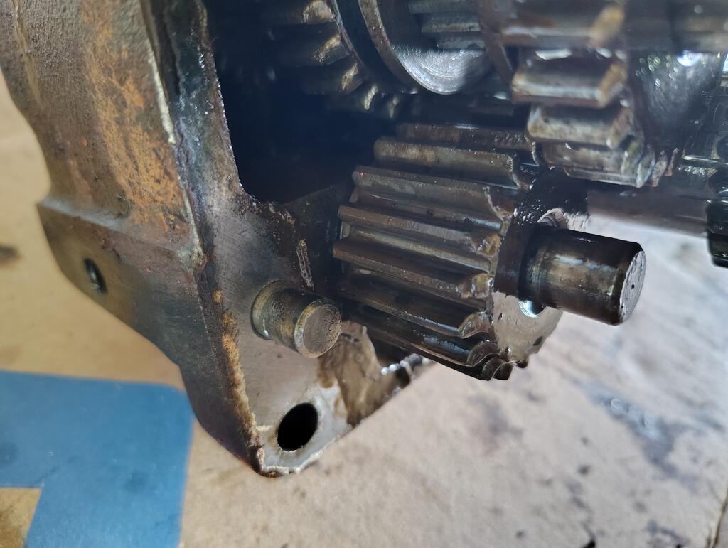

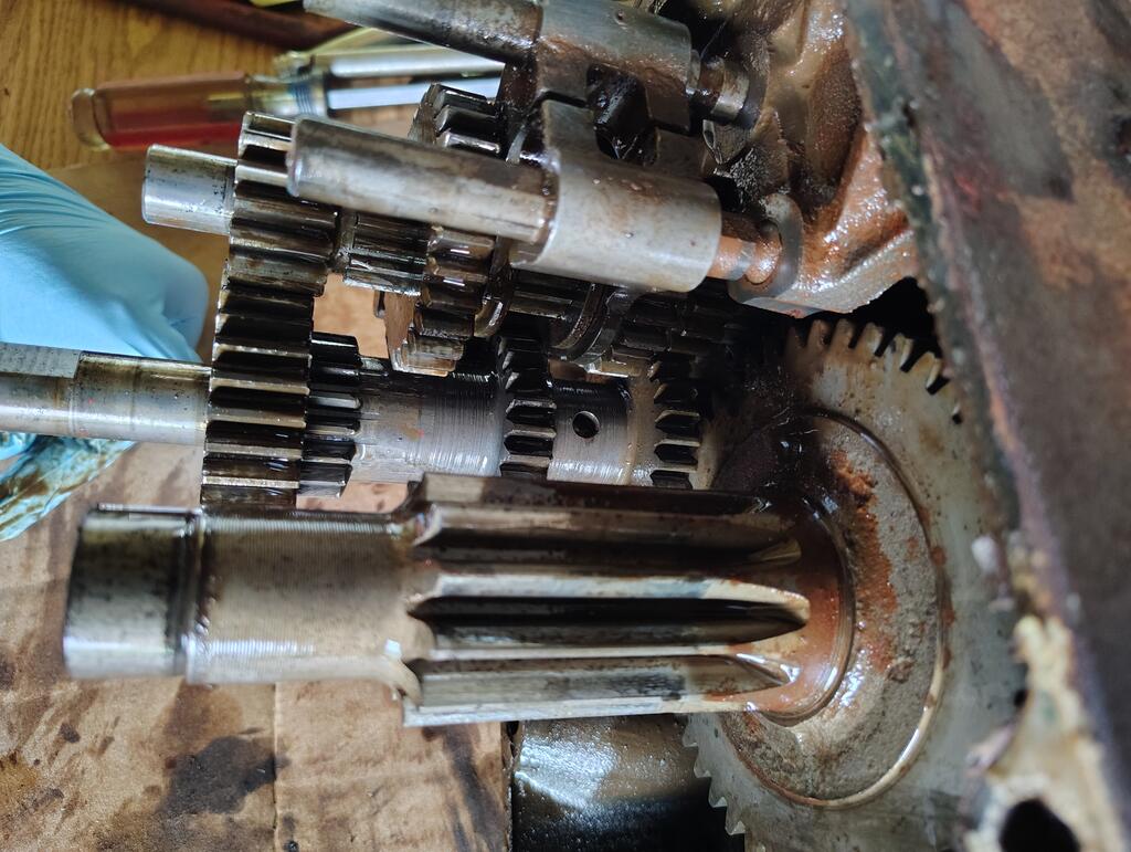

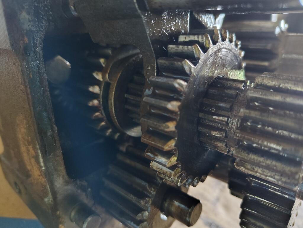

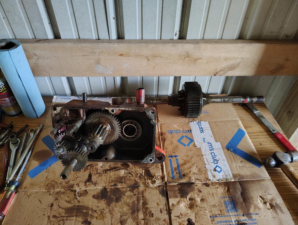

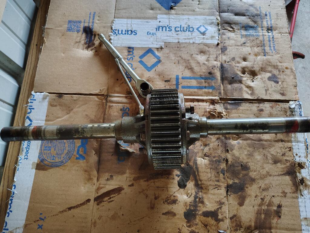

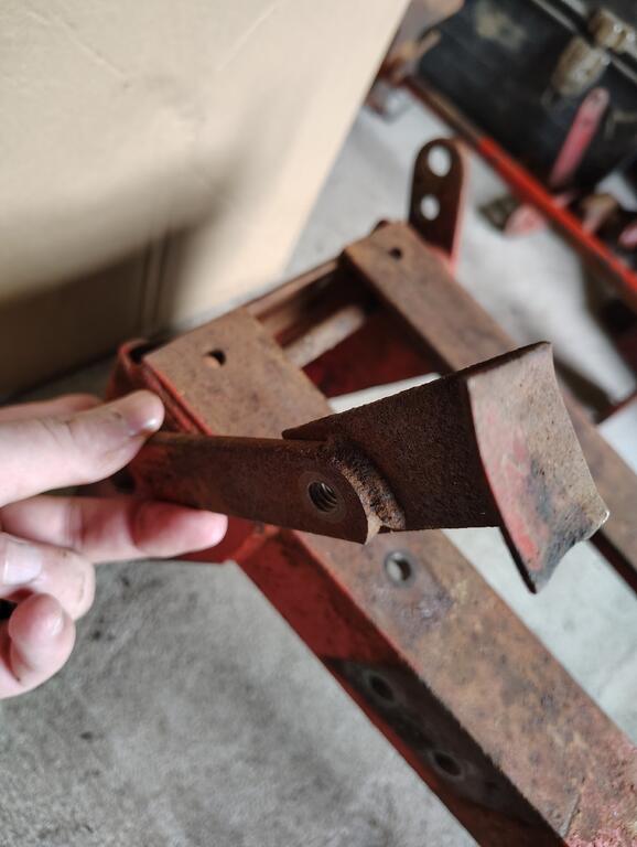

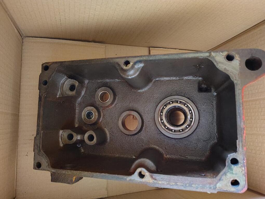

AlexR 3,139 #78 Posted July 27, 2025 Transmission is apart. Good news is no broken teeth, no metal chunks, and a couple of needle bearings fell apart as I was taking it apart, but no damage from that. But.... There are some teeth that got ground on. I'm guessing your guys solution to that is just file a little bit on the teeth and smooth them up. Put my order in since I don't need the extra bearings. And another question is this belt guide/brake suppose to be welded on? This is the arm the clutch idler pulley attaches to. 2 1 Share this post Link to post Share on other sites
Handy Don 17,735 #79 Posted July 27, 2025 (edited) 14 minutes ago, AlexR said: Some are bolted and some are welded. Only matters if once installed it is not a the proper angle to do its job. As for the front axle pin, I found that my axle was shifting fore and aft within its bracket. I got a pack of various-thickness shims to eliminate most of that play. Edited July 27, 2025 by Handy Don 4 1 Share this post Link to post Share on other sites

ebinmaine 81,281 #83 Posted July 27, 2025 58 minutes ago, AlexR said: There are some teeth that got ground on. I'm guessing your guys solution to that is just file a little bit on the teeth and smooth them up I don't see anything super worn out there. As long as that machine is destined for fairly easy work you'll likely be fine with a light wire brushing. I use a 6" wheel on an electric bench grinder. Just deburr them. I've used similar to those on Trina's lighter duty machines. If that was destined for heavier work like my C160s I'd get newer gears ⚙️. 1 Share this post Link to post Share on other sites
AlexR 3,139 #84 Posted July 27, 2025 4 minutes ago, ebinmaine said: I don't see anything super worn out there. As long as that machine is destined for fairly easy work you'll likely be fine with a light wire brushing. I use a 6" wheel on an electric bench grinder. Just deburr them. I've used similar to those on Trina's lighter duty machines. If that was destined for heavier work like my C160s I'd get newer gears ⚙️. I am planning on using it for some heavier work mainly plowing dirt. My thought is its just the edge of the gear that's worn a bit so once it's engaged it shouldn't effect it as far as working it. That would be quite a few gears to replace, I think I counted 6. 2 1 Share this post Link to post Share on other sites
ebinmaine 81,281 #85 Posted July 27, 2025 4 minutes ago, AlexR said: I am planning on using it for some heavier work mainly plowing dirt. My thought is its just the edge of the gear that's worn a bit so once it's engaged it shouldn't effect it as far as working it. That would be quite a few gears to replace, I think I counted 6. What you're seeing there is likely from previous owners not stopping COMPLETELY before shifting. I'd run it. 1 Share this post Link to post Share on other sites
AlexR 3,139 #86 Posted July 27, 2025 10 minutes ago, ebinmaine said: What you're seeing there is likely from previous owners not stopping COMPLETELY before shifting. I'd run it. Yep exactly! Any further wear should be preventable. And honestly probably would be cheaper buying another transmission then trying to replace all those gears. So if the transmission ever gave me issues in the future that's probably what I would do. 1 Share this post Link to post Share on other sites
ebinmaine 81,281 #87 Posted July 27, 2025 26 minutes ago, AlexR said: Yep exactly! Any further wear should be preventable. And honestly probably would be cheaper buying another transmission then trying to replace all those gears. So if the transmission ever gave me issues in the future that's probably what I would do. That's the standard 8 speed that's used all the way from 1970 to the mid 2000s. Finding a replacement would be easy enough. I may have at least 3 here..... 1 Share this post Link to post Share on other sites

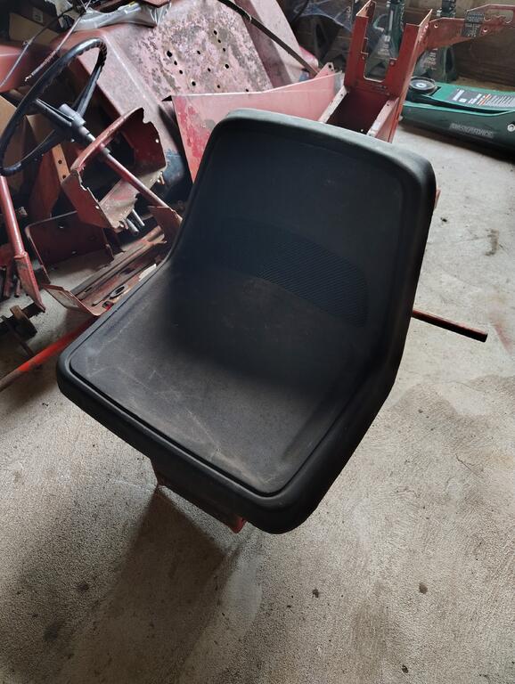

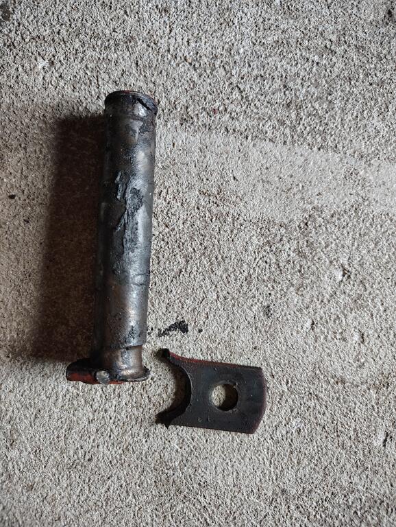

AlexR 3,139 #88 Posted July 27, 2025 Here is a picture of that axle pin. And I also got this seat for $10 it's the same one I got on my other plow horse the 73' and I like it on that one. 4 1 Share this post Link to post Share on other sites
Handy Don 17,735 #89 Posted July 28, 2025 14 hours ago, AlexR said: To paraphrase the kid who came home with a black eye...”if you think this is bad, you should see the other parts (i.e. the bracket and the axle)!" 2 Share this post Link to post Share on other sites
ebinmaine 81,281 #90 Posted July 28, 2025 Just now, Handy Don said: To paraphrase the kid who came home with a black eye...”if you think this is bad, you should see the other parts (i.e. the bracket and the axle)!" Is this the same size frame and axle hole as the larger models like a C series? 1 Share this post Link to post Share on other sites
Handy Don 17,735 #91 Posted July 28, 2025 4 minutes ago, ebinmaine said: Is this the same size frame and axle hole as the larger models like a C series? Good question! I’ve only ever seen ¾” -- 854, 310&312, and 518&520. 1 Share this post Link to post Share on other sites
AlexR 3,139 #92 Posted July 28, 2025 (edited) The bracket isn't to bad looks like the pin took the brunt of the wear. I haven't checked out the axle yet. I believe the Raiders at least the 12 and 14 are the same as the C series frames and axles. Edited July 28, 2025 by AlexR 2 Share this post Link to post Share on other sites

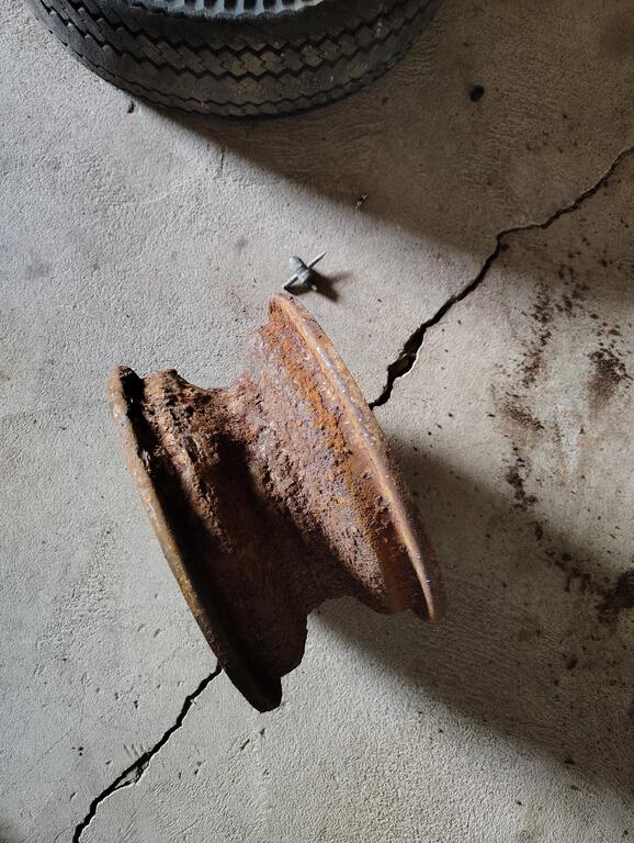

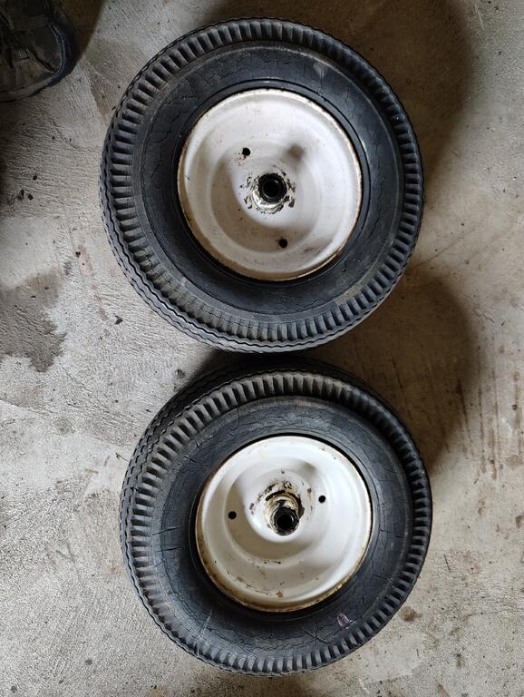

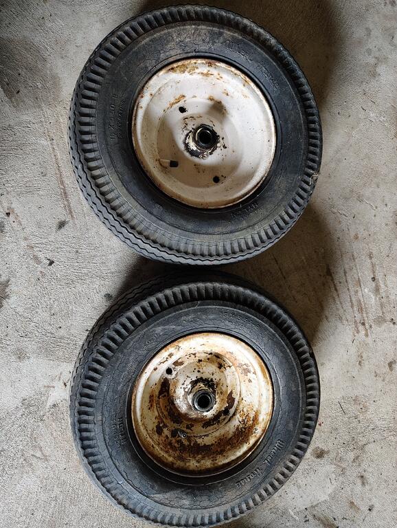

AlexR 3,139 #96 Posted July 30, 2025 (edited) Pulled the front tires off the rims to give to Pullstart. And the inside of the rims are a bit rusty... I know people have had worse much worse, but this is the worst of the tractors I have the outsides look fine. Outside of the rims Edited July 30, 2025 by AlexR 1 Share this post Link to post Share on other sites
ebinmaine 81,281 #97 Posted July 30, 2025 WOW!! Those are rough. Maybe someone did a calcium fill in the distant past? 1 Share this post Link to post Share on other sites
AlexR 3,139 #98 Posted July 30, 2025 25 minutes ago, ebinmaine said: WOW!! Those are rough. Maybe someone did a calcium fill in the distant past? Maybe.. they had tubes in them when I pulled them apart. I don't see this tractor having that life that someone would have filled the front tires, but who knows. The frame plate that attaches to the transmission is not cracked. And while the tractor is well worn I am inclined to think it was used as a mower most of its life. 2 Share this post Link to post Share on other sites
ebinmaine 81,281 #99 Posted July 30, 2025 Likely just good ole condensation then... 1 Share this post Link to post Share on other sites
AlexR 3,139 #100 Posted July 30, 2025 5 minutes ago, ebinmaine said: Likely just good ole condensation then... Probably that and the tubes were definitely put in at some point and they probably didn't clean it up and repaint when replacing or adding the tubes 1 Share this post Link to post Share on other sites
