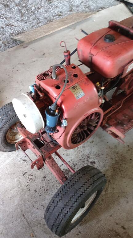

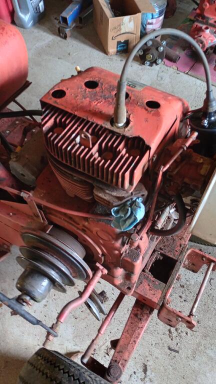

AlexR 3,139 #29 Posted July 21, 2024 Getting the engine back together from getting the exhaust valve unstuck and cleaned up, set the clearances on the valves. Got new coil, new spark plug, new air filter. New gas lines shutoff and filter. All that's left to get it started up is the wiring. I did get the exhaust out used bunch of pb blaster after that I heated it up, then I used a 10' galvanized 2" steel pipe on a pipe wrench. Just letting the weight of the pipe do the work. I am leaning towards doing a lowered custom the whole front axle spindles and steering are all loose. My other Wheelhorses aren't tight but this one is worse. So I am thinking of doing a custom front suspension and possibly front brakes. I'll see once I get it running, I'll drive it around a bit see how everything is doing as is. Then make a decision from there. 4 Share this post Link to post Share on other sites

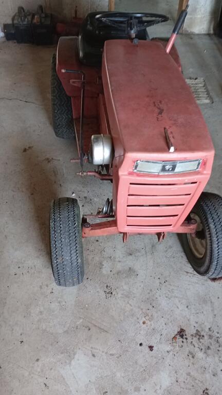

AlexR 3,139 #30 Posted July 23, 2024 Its a runner now. I neglected to take photos while it was out. I just did a quick wiring job to get it running. And got stainless steel pipe for the exhaust. Before I even tried starting it I cleaned and set the points at .020 But it wasn't starting checked the spark and no spark. Ended up changing out the points with another used set that I had and that fixed it. Tried starting again and it pretty much started right up. I have a little bit of sputtering, I tried adjusting the carb a little bit and got it better but I haven't touched the carb other then taking the bowl off to make sure it wasn't all cruddy and then blasted it with some carb cleaner. So that will need some more work. I had the belt come off the idler pulley when driving it around took the belt guard off and got that back on but everything is so shot on this machine the idler is bad, there is no lining on the brake band. But the brake pulley is shot too it has a bad lip on the outside of the brake. And the steering is awful too. The good is the transmission goes in all the gears (hi and low) and it seems smooth enough. And the engine seems to be ok as well. 5 Share this post Link to post Share on other sites

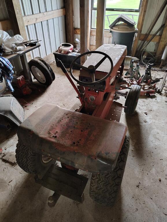

AlexR 3,139 #32 Posted November 19, 2024 (edited) This tractor has just been sitting this whole time, I haven't forgotten about it. But it will be sitting for a while longer at least until spring, but it is in a dry safe place. I have decided to do a restoration on it, instead of hot rodding it. Not a completely full blown one as I am still planning use it as a worker. I want to get it mechanically working well again and get a full repaint, I will try to do a fairly good rattle can job, might even sand the primer haha. We will have to see how carried away I get. I would love to get a loader for it, but it would have to be the right price which I know is hard to come by. I might build one but that is definitely a down the road project. So that might mean I do some different stuff to the front end since it's all pretty loose right now. Edited November 19, 2024 by AlexR 2 Share this post Link to post Share on other sites
AlexR 3,139 #33 Posted May 30, 2025 Still haven't forgotten about this tractor its in so much better of a place then it was before, dry and completely out of the elements. Been so busy with other things I just haven't been able to do anything yet. 2 1 Share this post Link to post Share on other sites

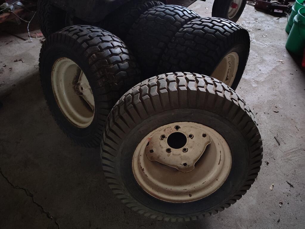

AlexR 3,139 #39 Posted May 31, 2025 Got some more rim options picked these 4 wheels and tires up today. These rims are a inch wider then what's on there. 3 1 Share this post Link to post Share on other sites

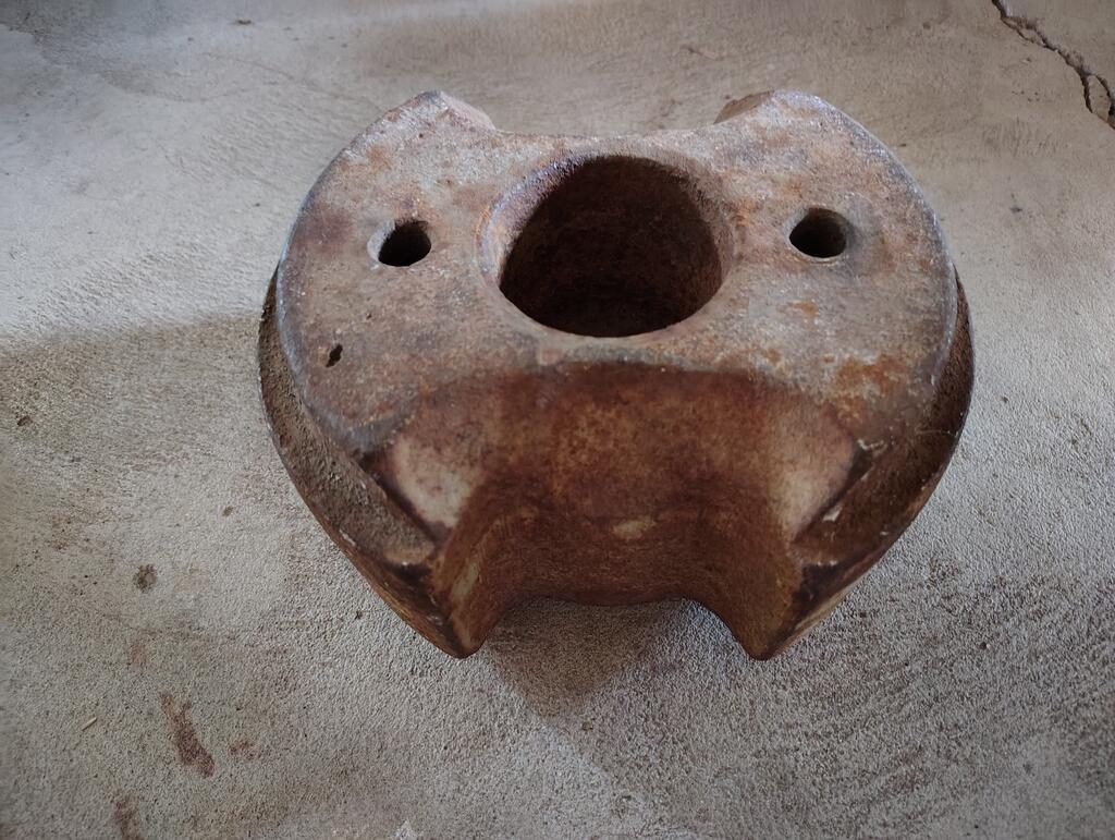

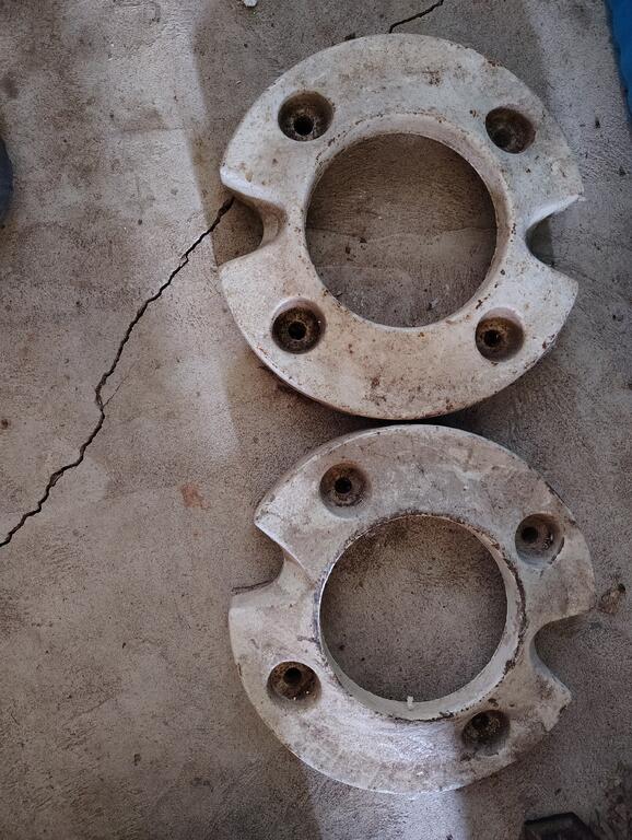

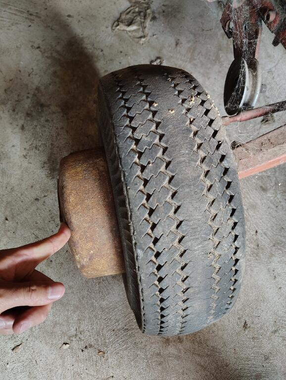

AlexR 3,139 #41 Posted July 15, 2025 I am getting closer to blowing this tractor apart just trying to fix a few things on the simplicity I got. But got these front wheel weights today feels like 25 pounds a piece maybe more 6 Share this post Link to post Share on other sites
ebinmaine 81,281 #42 Posted July 15, 2025 8 hours ago, AlexR said: these front wheel weights I have a set of those I picked up from @PWL216. They were the REAR weights on a Wheelhorse smaller model that had 10" wheels. I hadn't thought of seeing if they'd fit a front wheel. 1 Share this post Link to post Share on other sites
AlexR 3,139 #43 Posted July 15, 2025 1 hour ago, ebinmaine said: I have a set of those I picked up from @PWL216. They were the REAR weights on a Wheelhorse smaller model that had 10" wheels. I hadn't thought of seeing if they'd fit a front wheel. These seem to be made for the 8 inch front wheels, it fits well in the rim. 1 Share this post Link to post Share on other sites
ebinmaine 81,281 #44 Posted July 15, 2025 3 minutes ago, AlexR said: These seem to be made for the 8 inch front wheels, it fits well in the rim. That definitely makes sense because the ones I have were inside of a 10 inch wheel so they would set nice and even at the outer lip of an 8 inch wheel. Do the holes in your wheels line up nicely with the holes or notches in the weights? 1 Share this post Link to post Share on other sites

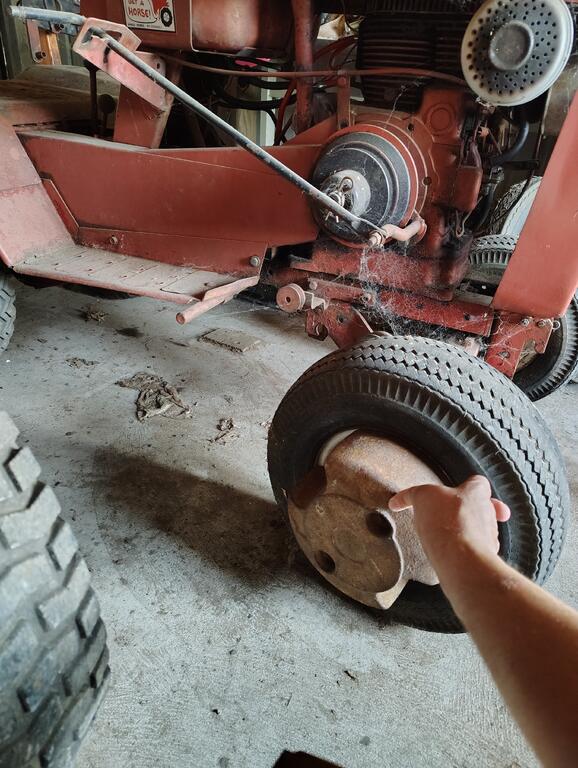

AlexR 3,139 #45 Posted July 15, 2025 9 hours ago, ebinmaine said: Do the holes in your wheels line up nicely with the holes or notches in the weights? Yes they line up perfectly with the holes in the weight. Here is a picture of the rear side of the weight. 1 Share this post Link to post Share on other sites

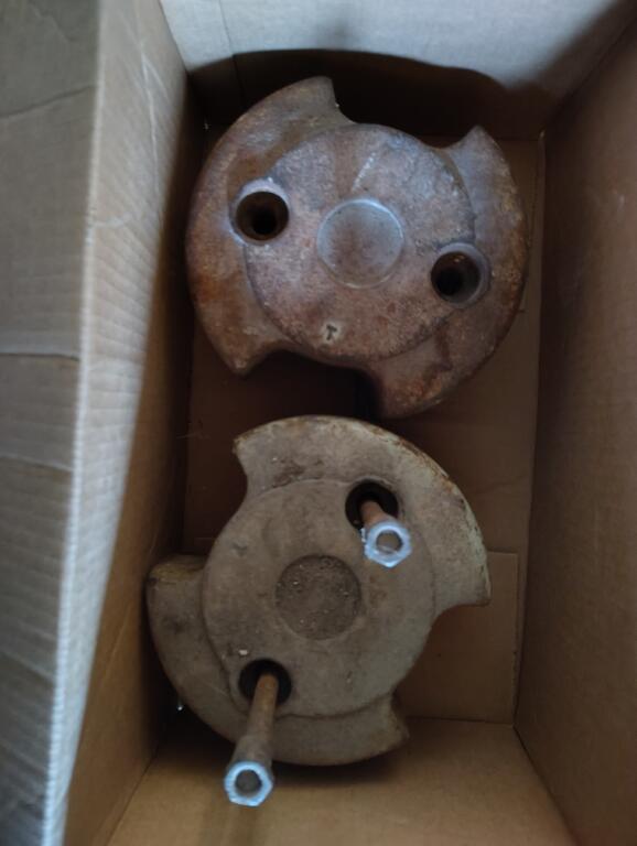

AlexR 3,139 #47 Posted July 16, 2025 So I have these rear weights that I got with the simplicity that look like Cub cadet weights. I think I will use those on the rear of the tractor. Not sure if I will double stack them on the left side or mount them on the inside the rims or one on each side.. So I will get deestone tri-ribs for the front of the tractor, I am trying to figure out what to do on the rear. I am having a hard time wanting to pay for the tru-powers, and I am thinking of getting the BKT TR-315 tires, but I would like some recommendations from you guys on some 23x10.5-12's that are actually 10.5 or close to it wide. I have the wider rims that I got, so I don't want to get the small deestones on this one. 2 Share this post Link to post Share on other sites
Handy Don 17,735 #48 Posted July 16, 2025 (edited) 1 hour ago, AlexR said: Do the holes like up with the mounting holes in the WH wheels? Edited July 16, 2025 by Handy Don 1 Share this post Link to post Share on other sites
AlexR 3,139 #49 Posted July 16, 2025 2 minutes ago, Handy Don said: These were for four-bolt wheels. You may need some sort of adaptor plate to get them secured to your WH. I can verify, but I believe these will bolt right up to the rear rims. 1 Share this post Link to post Share on other sites
ebinmaine 81,281 #50 Posted July 16, 2025 2 hours ago, Handy Don said: Do the holes like up with the mounting holes in the WH wheels? 2 hours ago, AlexR said: I can verify, but I believe these will bolt right up to the rear rims. Yes. Trina's Military Tribute Tractor has em. 1 1 Share this post Link to post Share on other sites
