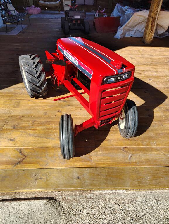

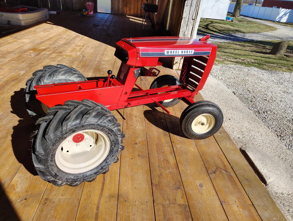

AlexR 3,084 #309 Posted March 8 She's a roller now, I got the next two days that will be really good for painting so I should get the rest of the parts painted, besides the engine block. 1 8 Share this post Link to post Share on other sites
ebinmaine 80,469 #310 Posted March 8 2 minutes ago, AlexR said: roller Always a great feeling during a restoration! 1 Share this post Link to post Share on other sites
AlexR 3,084 #311 Posted March 8 5 minutes ago, ebinmaine said: Always a great feeling during a restoration! Absolutely it does feel great! Get the feeling you actually might get it done soon until you realize how much more there is to do haha. 3 1 Share this post Link to post Share on other sites

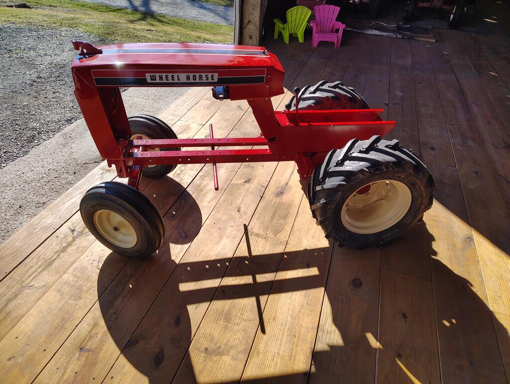

SylvanLakeWH 32,305 #312 Posted March 8 that'll work perfect for holding drinks at @Pullstart's plow day... er... I mean, um, plowing.... 1 5 Share this post Link to post Share on other sites

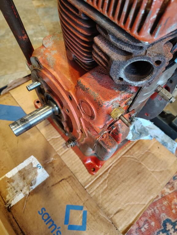

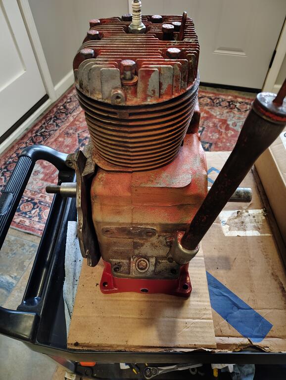

AlexR 3,084 #315 Posted March 16 I got that other balance gear out, I don't doubt you got yours out @Achto but there was no way I was going to get mine out without pulling the crankshaft or what I ended up doing like @Pullstart did and drove that pin out. I decided not to precut that pin I will just cut it flush with how far in I was able to drive it. Installed new crank seals and got it cleaned up as much as I could inside, it's very cold and windy outside today. I'm also pretty positive this is was a replacement engine because there is gray paint that wasn't ever painted over and the only red paint on it is that same chalky paint that I stripped off the rest of the tractor. 6 2 Share this post Link to post Share on other sites

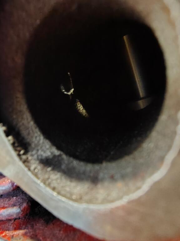

AlexR 3,084 #316 Posted March 22 Getting the engine put back together and discovered this, a hole in the side of the intake port. Really glad I found that, used JB weld to fix it. 4 1 Share this post Link to post Share on other sites

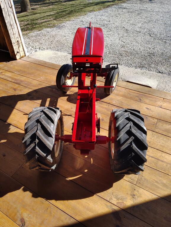

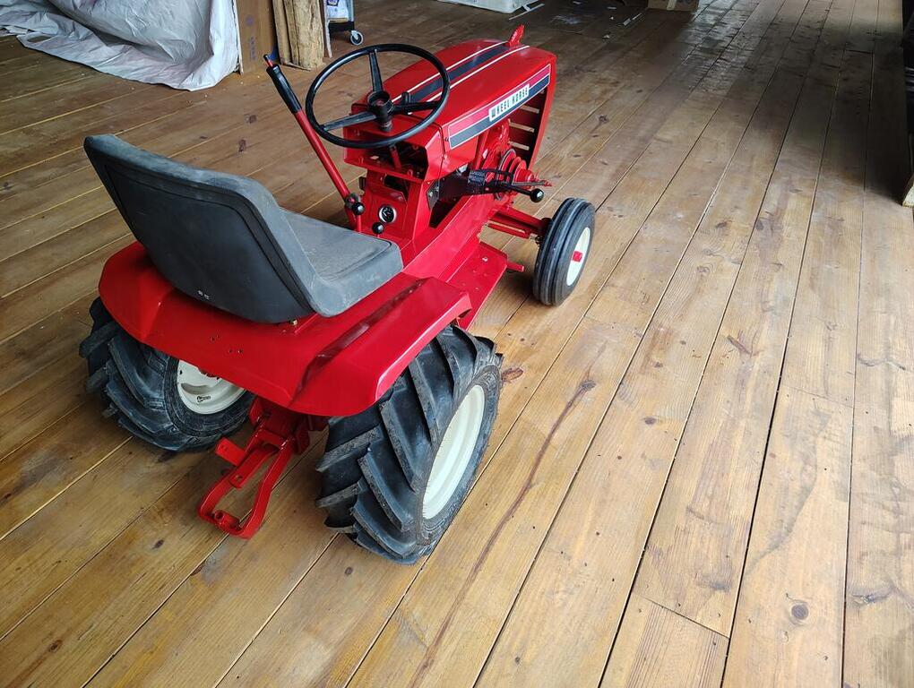

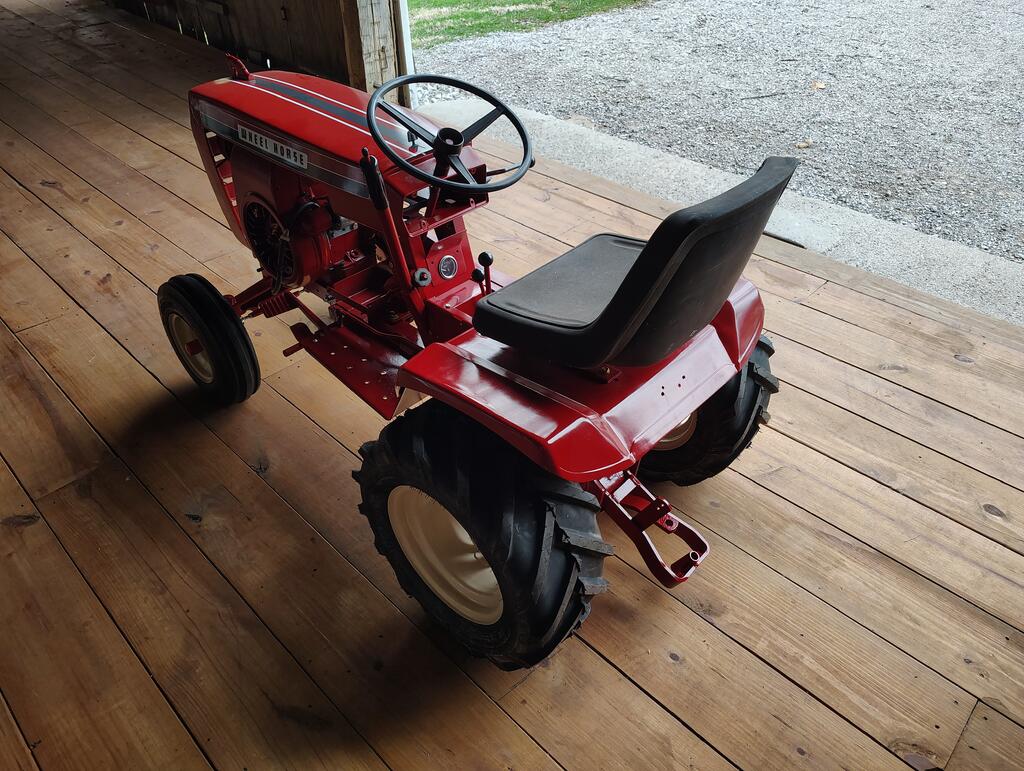

AlexR 3,084 #317 Posted March 22 Looking like a tractor now. Still a ways to go lots of little stuff 1 8 Share this post Link to post Share on other sites
Easton Rich 1,260 #319 Posted March 22 Man it would be hard to use it! 1 Share this post Link to post Share on other sites
AlexR 3,084 #320 Posted March 22 7 minutes ago, Easton Rich said: Man it would be hard to use it! I left a couple runs in the paint on the foot rests and have had a couple scratches because some paint hasn't cured long enough yet. And that's ok because it's going to be used. 1 3 Share this post Link to post Share on other sites
Achto 32,548 #321 Posted March 22 Looking great Alex !!! 1 Share this post Link to post Share on other sites
WHX?? 57,933 #322 Posted March 22 Now you know why I ain't afraid to give you parts ... 1 1 Share this post Link to post Share on other sites
SylvanLakeWH 32,305 #323 Posted March 23 Very nice!!! 1 Share this post Link to post Share on other sites
kpinnc 18,916 #324 Posted March 23 3 hours ago, AlexR said: Looking like a tractor now. That thing looks nice! I really like that headlight setup! Looks great! 1 Share this post Link to post Share on other sites

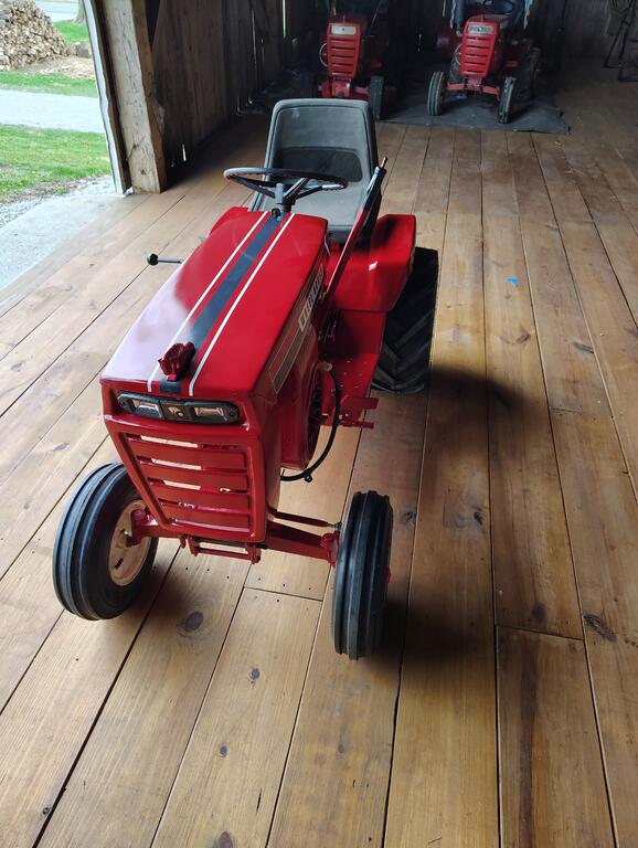

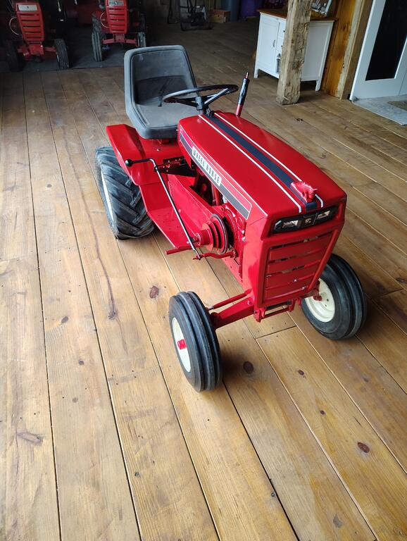

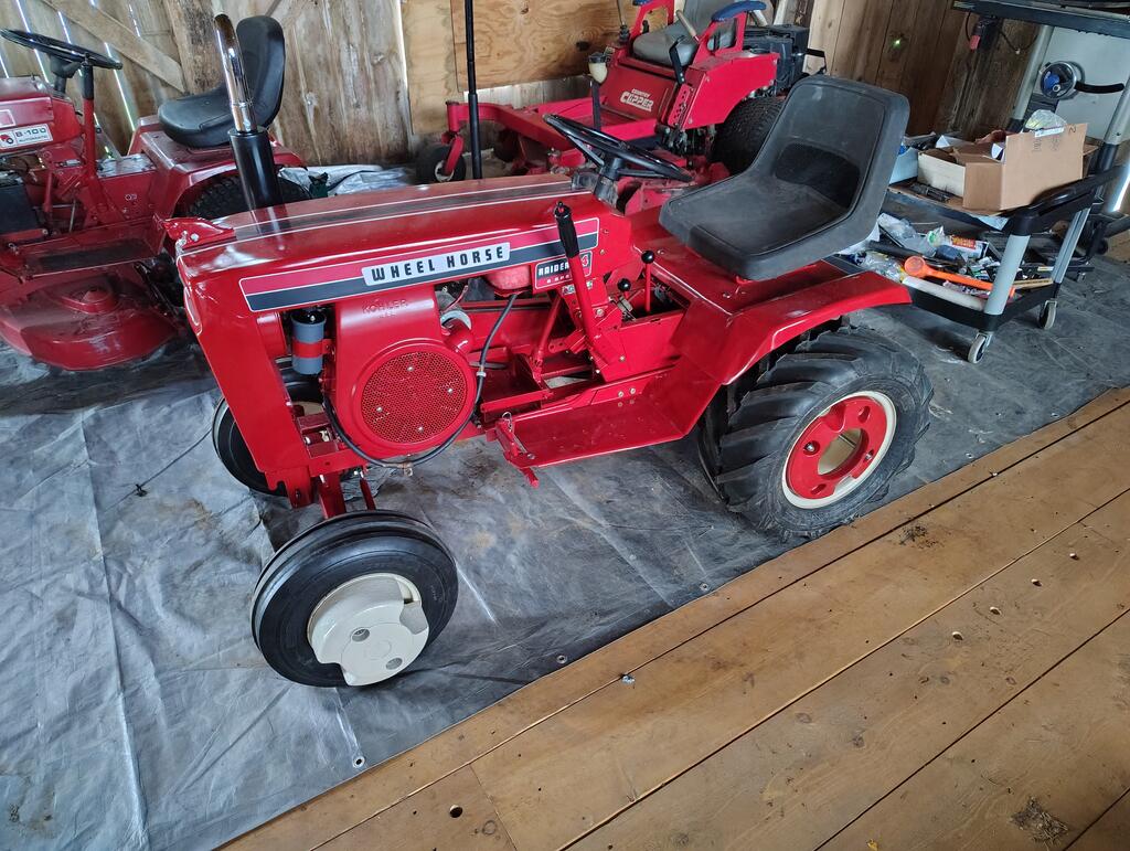

AlexR 3,084 #325 Posted April 6 One last photo before it's all completed. 1 3 3 Share this post Link to post Share on other sites
