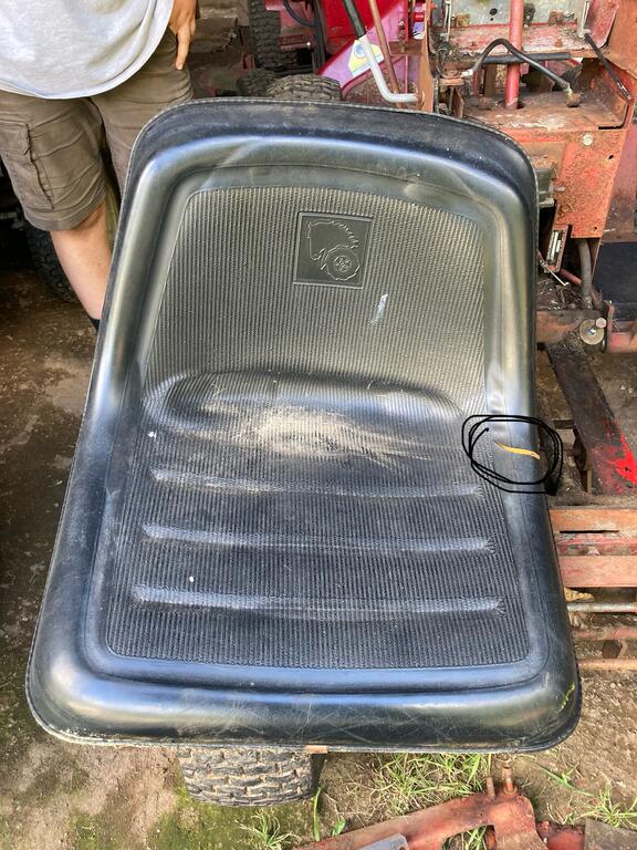

TonyToro Jr. 2,547 #54 Posted September 5, 2024 So I’m going to need your guys help with this one, This is the original seat to the tractor and I want to use it on the tractor, but it has one small tear or the right side. (See picture) How should I repair it or what should I do? And @ c series don how did you get your seat to look all shiny like that? 1 Share this post Link to post Share on other sites

c-series don 12,560 #56 Posted September 6, 2024 (edited) 10W-30 in the transmission unless the oil that you drain out is pink, indicating transmission fluid. Then use ATF. I believe the Sunstrand transmission used ATF, however I’m no expert on this so someone may correct me. I also think it can run on either one but just don’t mix them. As far as the seat goes I think I may have used that tire shine that I posted earlier in this thread. I used vinyl conditioner first to help soften it up and not be so brittle. The rip in the seat I don’t think is repairable? Maybe some black duct tape to try to stop it from spreading? Edited September 6, 2024 by c-series don 1 1 Share this post Link to post Share on other sites

Handy Don 17,591 #58 Posted September 6, 2024 (edited) 2 hours ago, TonyToro Jr. said: How should I repair it or what should I do? I’ve had good success with Gorilla Tape. The surface prep is important -- clean, clean, clean with no residue of the cleaner -- I use an alcohol wipe as the final Pay attention to layout to avoid folds or wrinkles in the tape--this may involve using pieces trimmed to size/shape with sharp scissors. Practice with some paper to figure out the layout of the tape. Also, where overlapping, pay attention to the direction of the overlap so that sliding onto or off of the seat won’t be catching the edge of the tape. I also have removed the edging on the seat before taping so that the edging holds the end of the tape--it is a bit of a job to get the edging back on, but it is doable. If you do remove the edging, you get the chance to put tape on the underside of the black plastic cover which majorly strengthens the patch. Go ahead and put some tape underneath vulnerable places where it hasn’t ripped yet! Know that the adhesive on Gorilla Tape (unlike inexpensive duct tape) cures once exposed to air. So after getting a piece off the roll, give it 10 or 20 seconds in open air before putting it on the seat and work hard to keep fingers out of the adhesive -- I use tweezers and forceps cleaned with alcohol wipes to handle the tape. Edited September 6, 2024 by Handy Don 3 1 Share this post Link to post Share on other sites
Tractorhead 9,217 #59 Posted September 6, 2024 (edited) 9 hours ago, TonyToro Jr. said: So I’m going to need your guys help with this one, This is the original seat to the tractor and I want to use it on the tractor, but it has one small tear or the right side. (See picture) How should I repair it or what should I do? And @ c series don how did you get your seat to look all shiny like that? https://www.quixx.com A friend gave me this Tip. He is a professional in repair and reconditioning of old Car Seats for Porsche and BMW. I asked him because of the Transit Seats what to Do on a cost effective site They have a vinyl repair set what should work perfectly. Until now i never tried myself, but he showed me a seat what he reworked with their Products. The result was very impressive. He told me you just have to Work exactly like their suggestions to get good results. maybe worth a try. edit btw: great work so far end edit Edited September 6, 2024 by Tractorhead 3 1 Share this post Link to post Share on other sites
oliver2-44 11,786 #60 Posted September 6, 2024 10 hours ago, TonyToro Jr. said: So I’m going to need your guys help with this one, This is the original seat to the tractor and I want to use it on the tractor, but it has one small tear or the right side. (See picture) How should I repair it or what should I do? And @ c series don how did you get your seat to look all shiny like that? 3m makes a vinyl repair kit. It includes adhesive and various colored material to mix with the adhesive. After you repair I concur with Don to use a vinyl conditioner. 2 2 Share this post Link to post Share on other sites

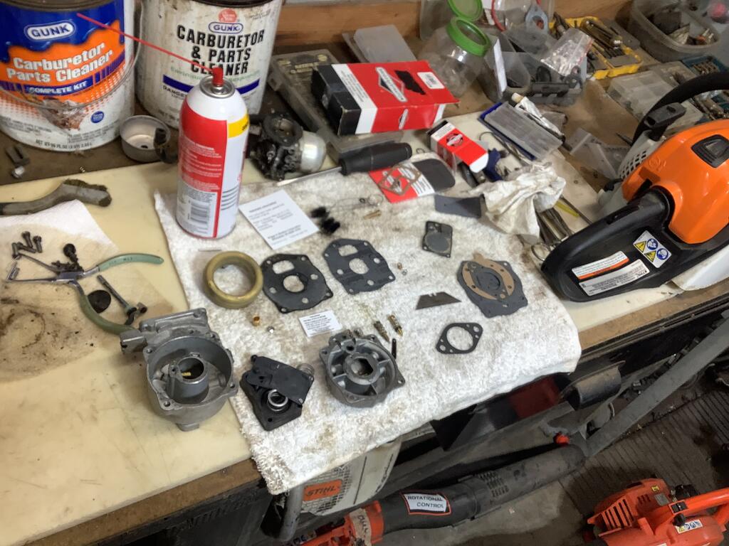

TonyToro Jr. 2,547 #61 Posted September 8, 2024 Day 13 (I think I lost count lol) Today got a couple things done. Rebuild the Carb at work with a OEM NOS Briggs carb kit one of our local power equipment shops had left. But the carb back on with everything fully rebuilt inside including the fuel pump, Replaced the vacuum line. Changed the spark plugs and bolted the engine fully down. Also attached the throttle cable IMG_9164.mov 8 Share this post Link to post Share on other sites

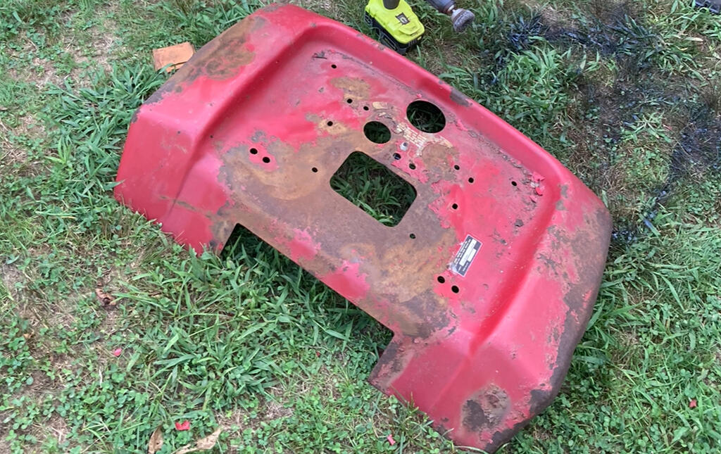

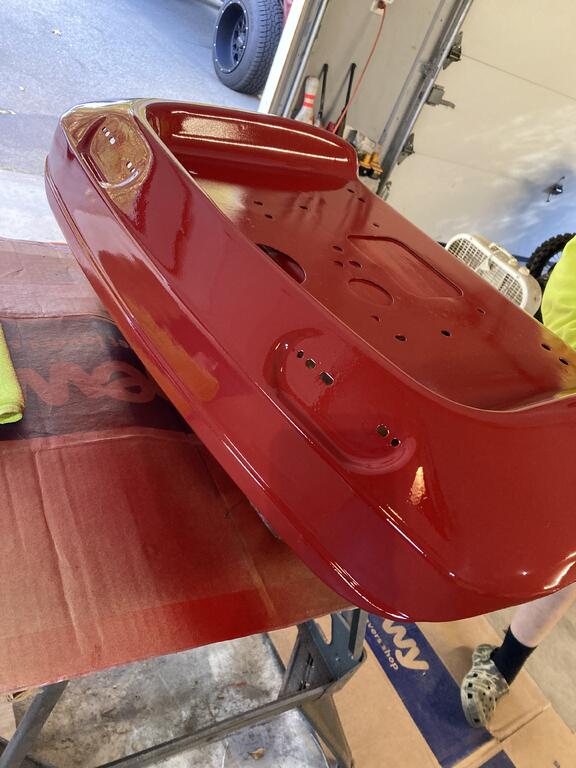

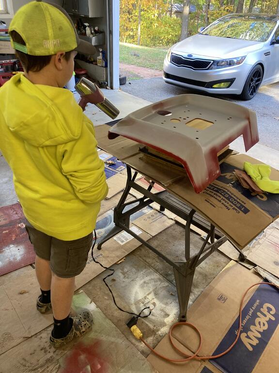

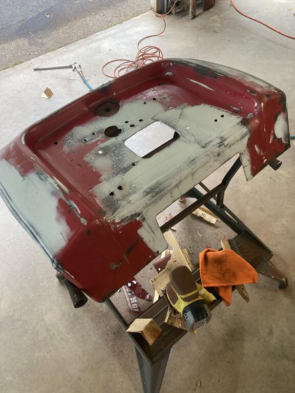

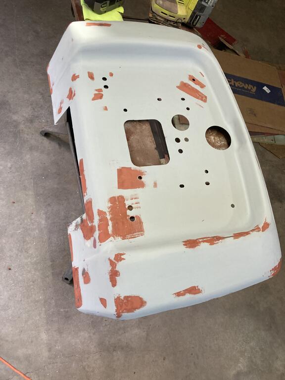

TonyToro Jr. 2,547 #65 Posted October 4, 2024 Sorry haven’t had a chance to work on this for the past few weeks. Back to back tractor pulls just about every Friday and weekend. Day 14 (But really over the course of a week and a half) : Been working on the fenders for a few days. Decided to put Metal ones on it since I hate the plastic ones. The fenders needed ALOT off sanding, filler, primer. But is now almost there, should be fully painted by the end of the weekend. I made myself a goal of getting it at least running by Sunday of next week. Doesn’t have to be driving but I wanna hear it live again. 6 4 Share this post Link to post Share on other sites
kpinnc 19,015 #66 Posted October 4, 2024 On 9/7/2024 at 8:55 PM, TonyToro Jr. said: Today got a couple things done. Really looks great! Well done! 2 Share this post Link to post Share on other sites

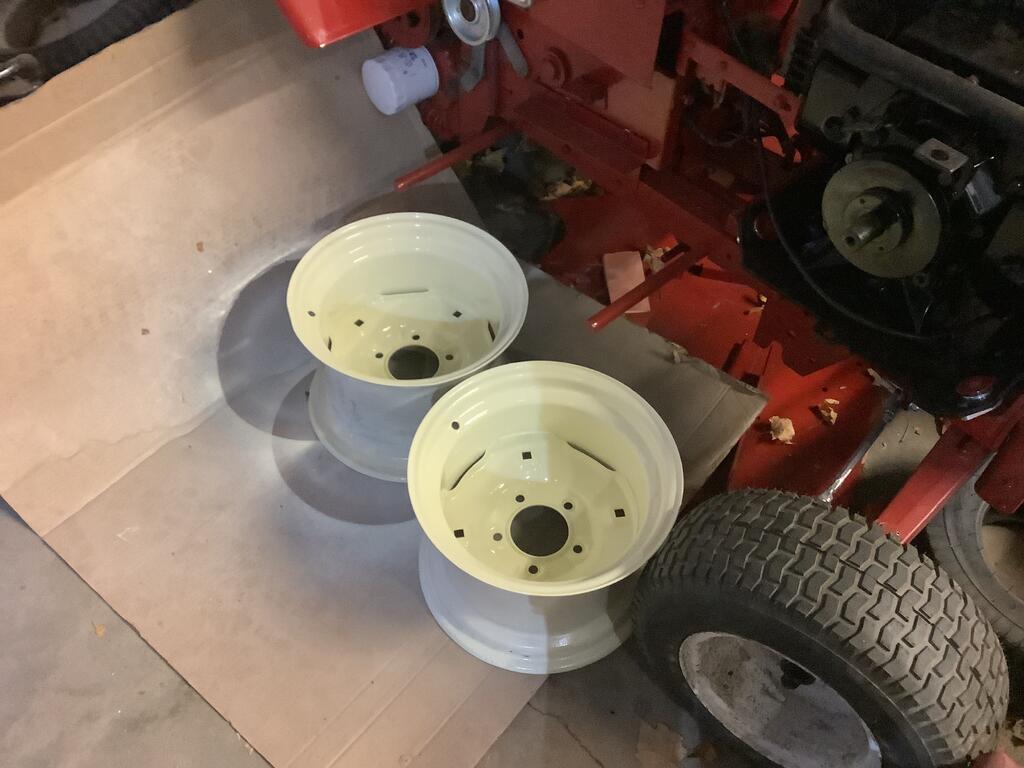

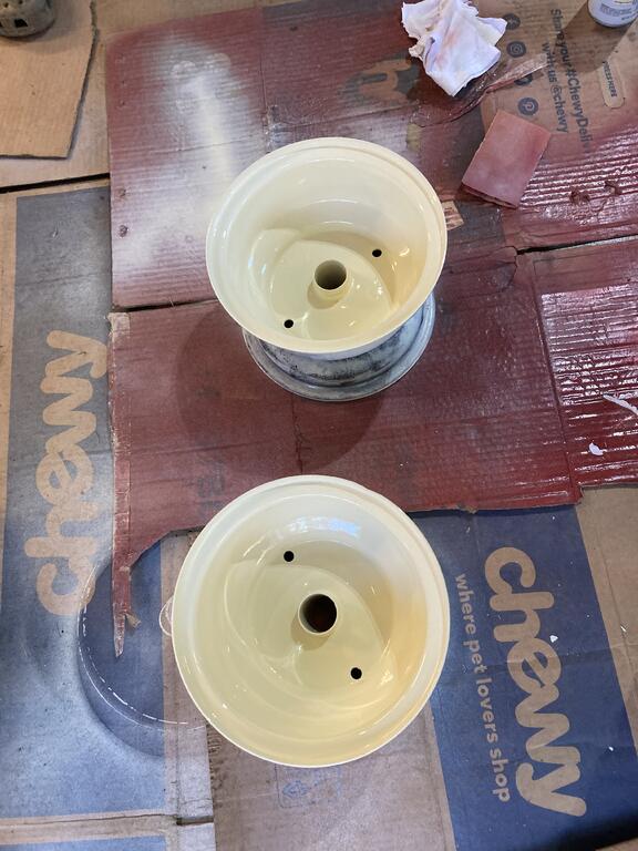

TonyToro Jr. 2,547 #67 Posted October 15, 2024 Day 15: (Well really Friday Saturday Monday and today (Tuesday) Got the fenders for one last time primed (Friday) and now Tuesday we gave it a quick light sanding and painted them red! Fenders are now complete just have to put stickers on it and the rear lights. Got the front rims sanded and cleaned on Friday and first coat of paint on. Today (Tuesday) got the front rims painted antique white let them sit for probaly 3 minutes went back to look at they were all cracked! My dad said the spots we didn’t get rid of all the power coating the paint got underneath it and lifted it all up. So going to let the rims sit out in the sun for a few days then sand where they cracked and hopefully paint them once again for all. Also since it’s now started to get cold and getting dark really early moved some stuff around in the garage and bought Mr.Kellys tractor inside of the garage. IMG_9430.mov IMG_9429.mov 10 1 Share this post Link to post Share on other sites

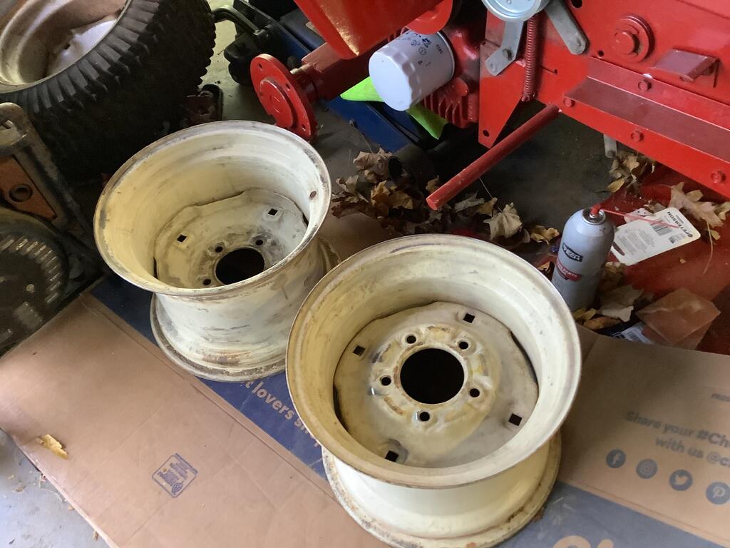

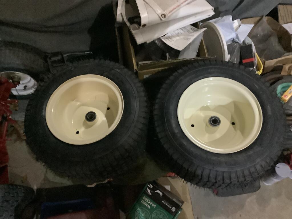

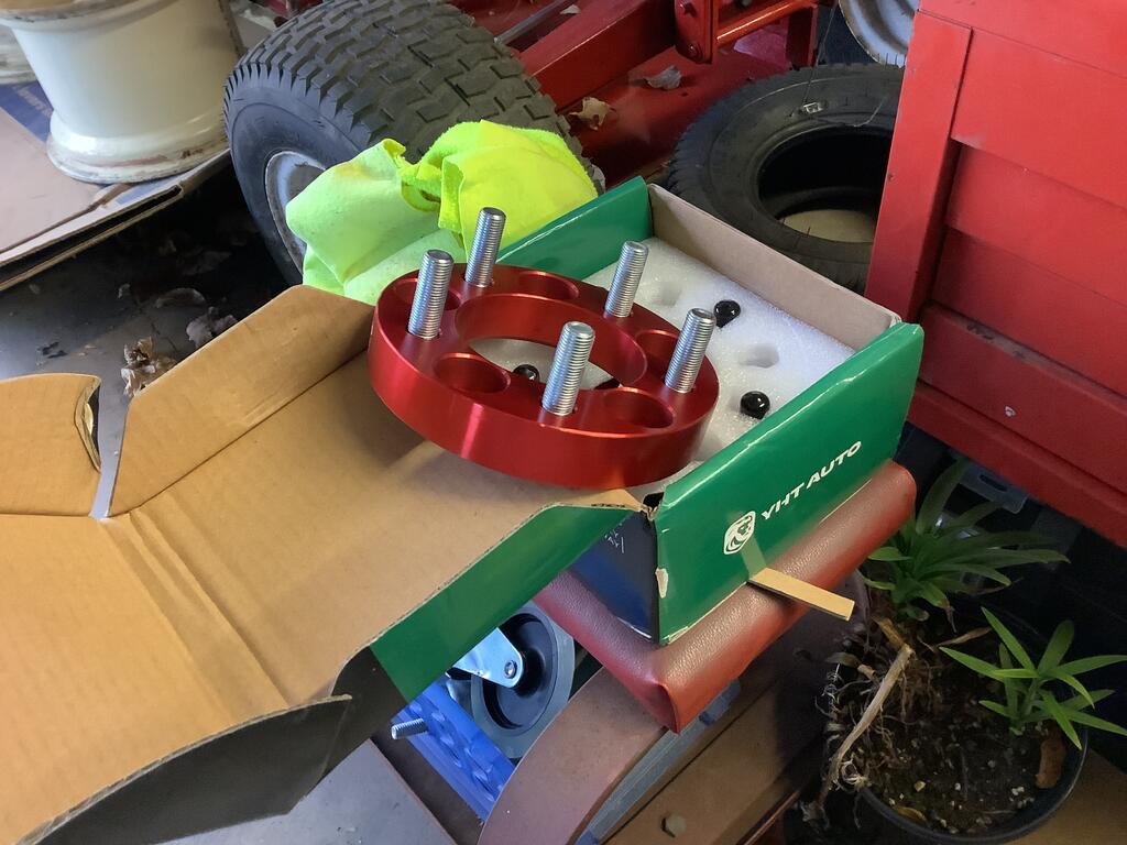

TonyToro Jr. 2,547 #69 Posted November 1, 2024 Day 16 (Well really all week) Got the rear rims sanded down and ready for paint. Also painted the belt guard hitch and right hand floor board. Also since I’m using the 23/10.5/12 ags got in the 1 inch wheel spacers. (Sorry there not very good pictures) 1 7 Share this post Link to post Share on other sites
TonyToro 1,190 #70 Posted November 4, 2024 On 11/1/2024 at 4:14 PM, TonyToro Jr. said: Day 16 (Well really all week) Got the rear rims sanded down and ready for paint. Also painted the belt guard hitch and right hand floor board. Also since I’m using the 23/10.5/12 ags got in the 1 inch wheel spacers. (Sorry there not very good pictures) Good choice with the red wheel spacers.. 😉 3 1 Share this post Link to post Share on other sites
TonyToro Jr. 2,547 #71 Posted November 4, 2024 Day 17 Thanks to the wonderful dad @TonyToro! Who while I was at school painted the rear rims and came out awesome! 5 1 Share this post Link to post Share on other sites

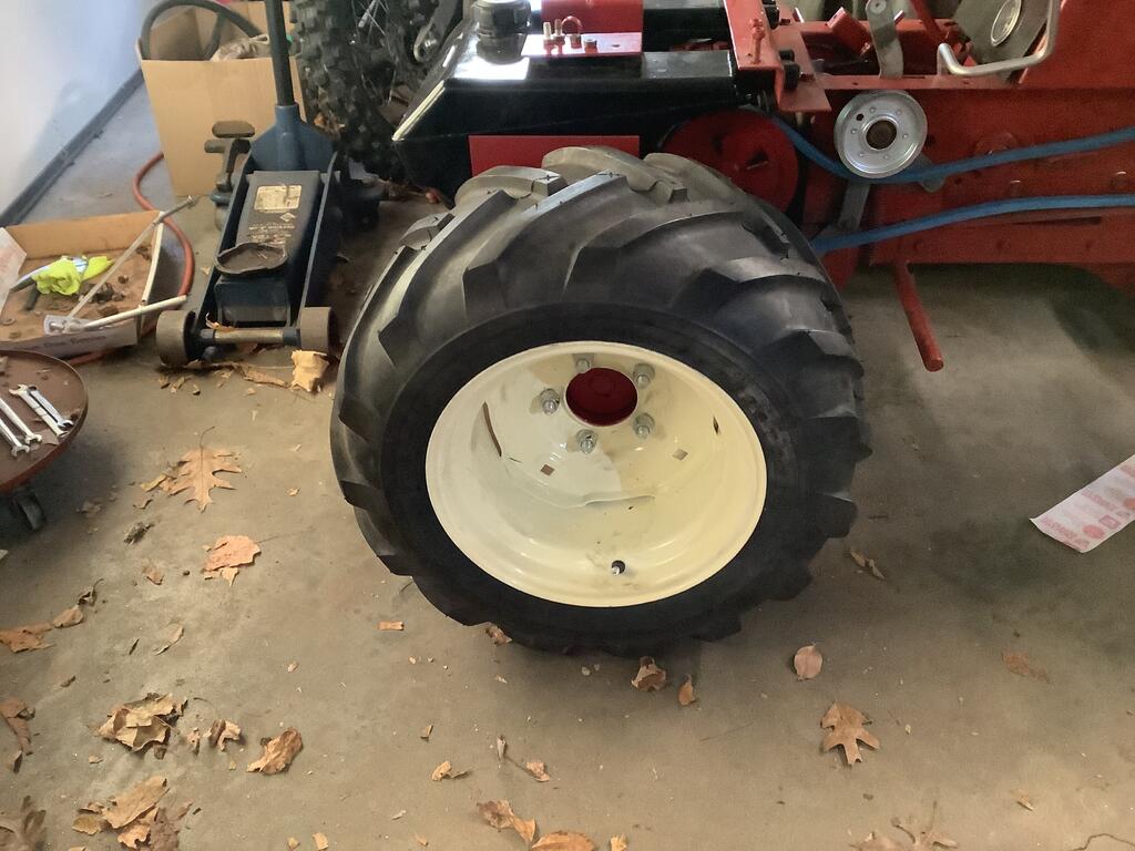

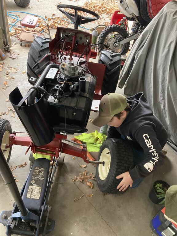

TonyToro Jr. 2,547 #73 Posted November 20, 2024 Day 18- Today we got the front rims and tires mounted and the bearings seated. Did what I think @ebinmaine said and took the inner seal from the bearings so I can continue to grease them. 3 1 Share this post Link to post Share on other sites
ebinmaine 80,999 #74 Posted November 20, 2024 20 minutes ago, TonyToro Jr. said: Day 18- Today we got the front rims and tires mounted and the bearings seated. Did what I think @ebinmaine said and took the inner seal from the bearings so I can continue to grease them. I might have repeated that removing the seal trick but I can't take credit. I learned that from this site too. 3 Share this post Link to post Share on other sites

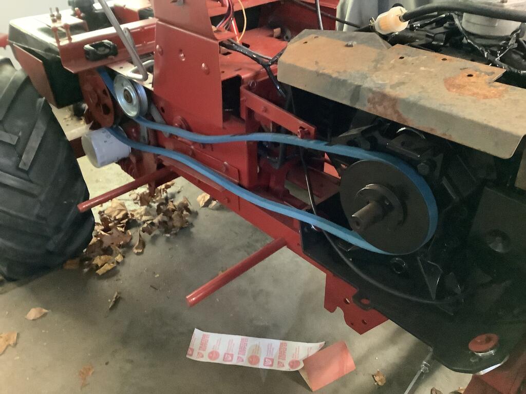

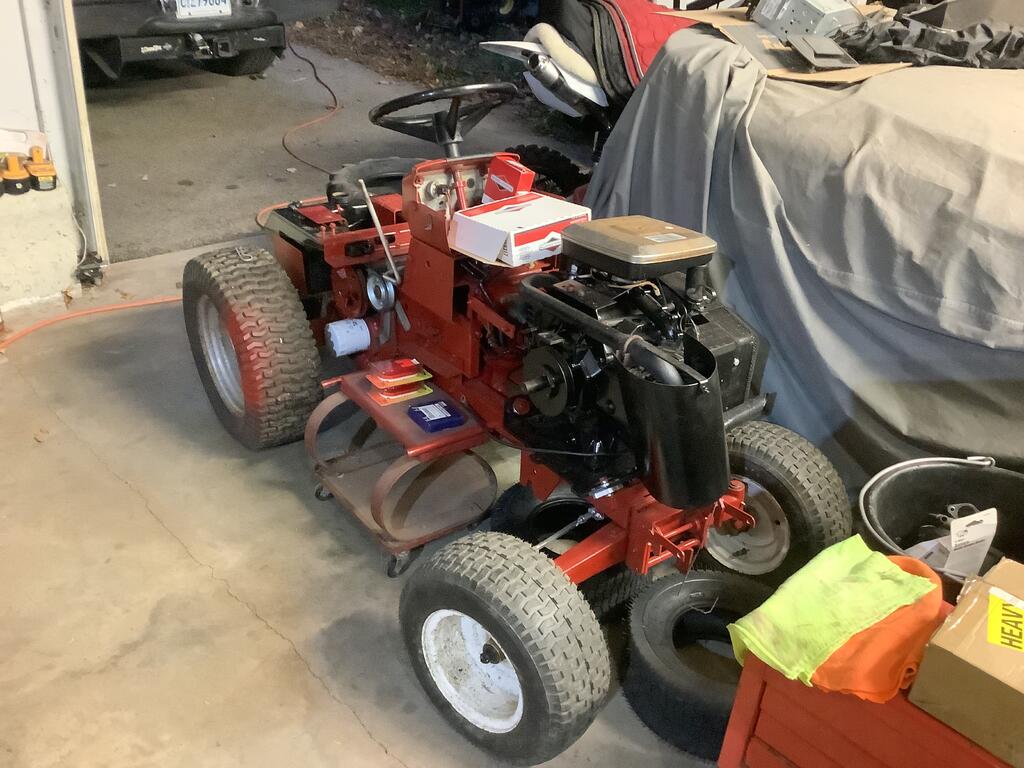

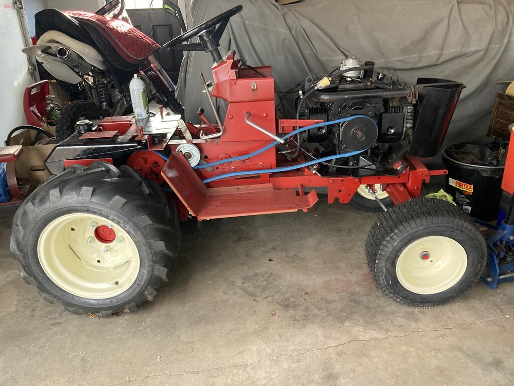

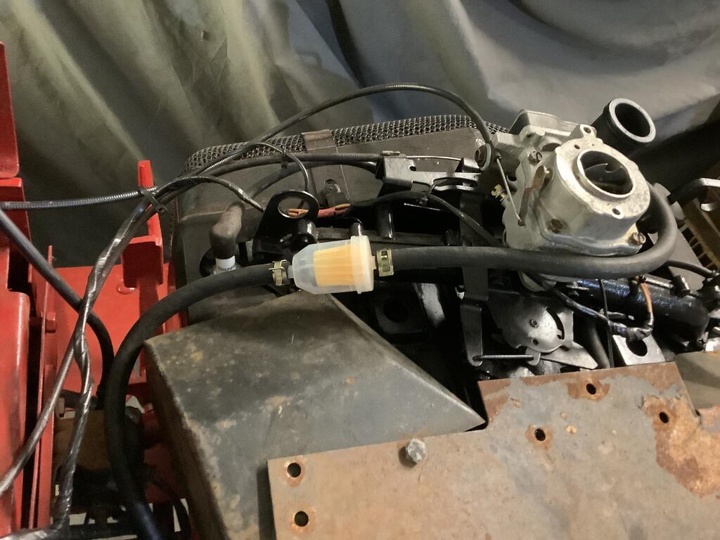

TonyToro Jr. 2,547 #75 Posted November 25, 2024 Day 19 All over the weekend got ALOT done! Getting to the final steps now. Over the week me and @TonyToro mounted fuel tank, ran fuel line and fuel filter, new gas cap, got all four tires mounted onto the tractor and the rear wheel spacers installed. Filled the tractor with oil, painted all the pto rods. Installed the pto mounting bracket by the battery. Got this metallic chrome color spray can from rust oleum at katz ace. That’s what we painted the pto rods with. Also did the air filter cover that too. Added some shims to the steering so it didn’t skip teeth anymore. Put on the rear hitch and ran a new belt on it and I also painted the hydraulic lift valve handle. AndI think that was everything. Trying to get it started for the first time this week! 11 Share this post Link to post Share on other sites
