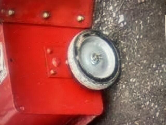

AHS 1,701 #35 Posted June 27, 2024 @rjg854 How did you put those wheels on there? Take off the shoes that were on the originally, did you use one of the holes that were for the shoes? 2 Share this post Link to post Share on other sites
ebinmaine 80,755 #36 Posted June 27, 2024 28 minutes ago, AHS said: use one of the holes that were for the shoes I've done this on a couple walk-behinds. Using that method. 1 Share this post Link to post Share on other sites
rjg854 13,370 #37 Posted June 27, 2024 2 hours ago, AHS said: @rjg854 How did you put those wheels on there? Take off the shoes that were on the originally, did you use one of the holes that were for the shoes? I used the skid plate as a pattern and had Bill, my welder guy, make a plate with the same bolt hole arrangement and added a post to attach the wheel. I can still adjust the wheels for up and down height adjustment. 1 2 Share this post Link to post Share on other sites
AHS 1,701 #38 Posted June 27, 2024 @rjg854 very nice!! Each wheel adjustable, kinda like a lawn mower? 1 Share this post Link to post Share on other sites
rjg854 13,370 #39 Posted June 27, 2024 3 hours ago, AHS said: @rjg854 very nice!! Each wheel adjustable, kinda like a lawn mower? Just like the snow blower Share this post Link to post Share on other sites
