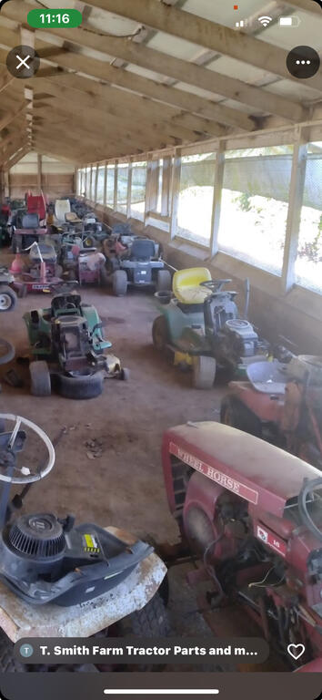

Horse Newbie 7,405 #1 Posted June 18, 2024 I found a pic of this tractor/ Wheel Horse while on the internet surfing used tractor parts places in my area. What can you guys tell me about it ? 1 Share this post Link to post Share on other sites
Mike'sHorseBarn 3,652 #2 Posted June 18, 2024 1973 No name model. Basically a C-160 honestly. 4 Share this post Link to post Share on other sites
ebinmaine 80,088 #3 Posted June 18, 2024 Mike and I were typing at the same time. 2 Share this post Link to post Share on other sites
Sparky-(Admin) 26,185 #4 Posted June 18, 2024 Yep, what Mike said. The motion control lever is between your legs, other wise it’s the same as a C-160 Auto 4 Share this post Link to post Share on other sites

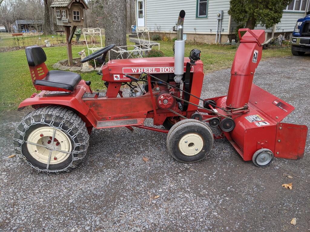

rjg854 13,269 #9 Posted June 18, 2024 Here's the one I have 1 5 Share this post Link to post Share on other sites

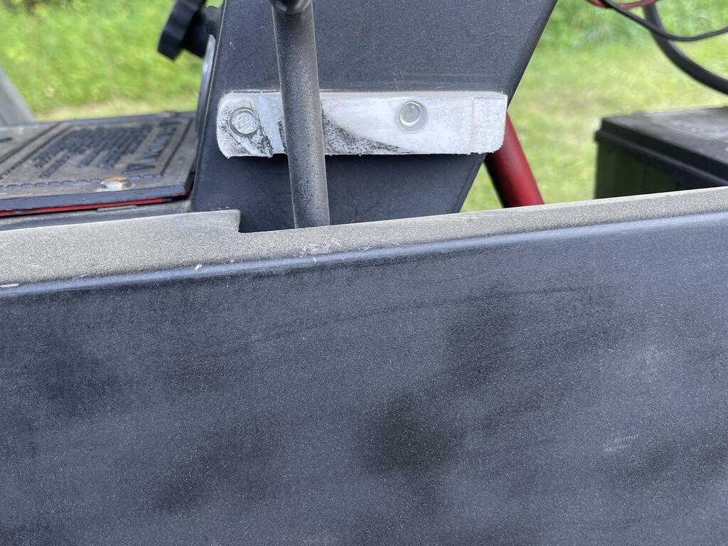

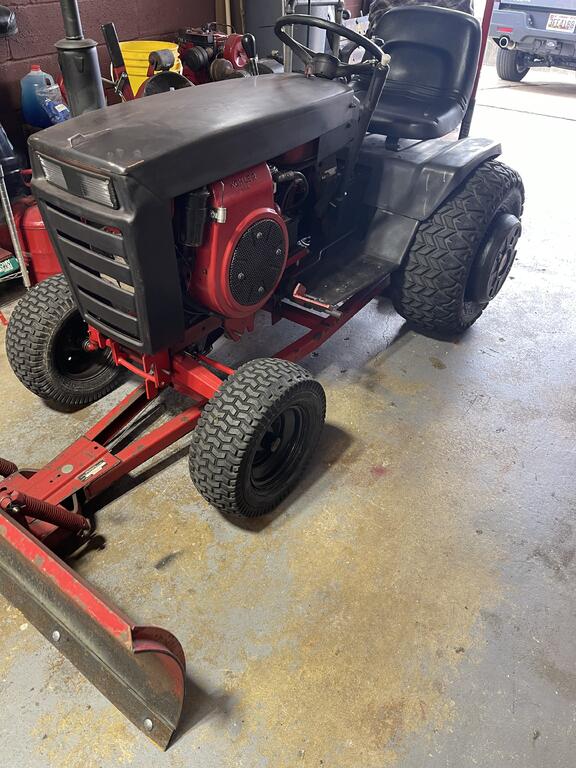

Wheelhorse#1 1,961 #10 Posted June 18, 2024 (edited) I have the 12 auto.Converted the motion control to the side.I found the control between the legs to be awkward. I may paint this one someday,great machine Edited June 18, 2024 by Wheelhorse#1 4 Share this post Link to post Share on other sites

Wheelhorse#1 1,961 #15 Posted June 22, 2024 Mine use to drift even after adjustment and worn parts on motion control,I believe worn out pump will cause this ? I added a notched block to keep control arm stationary. 2 1 Share this post Link to post Share on other sites

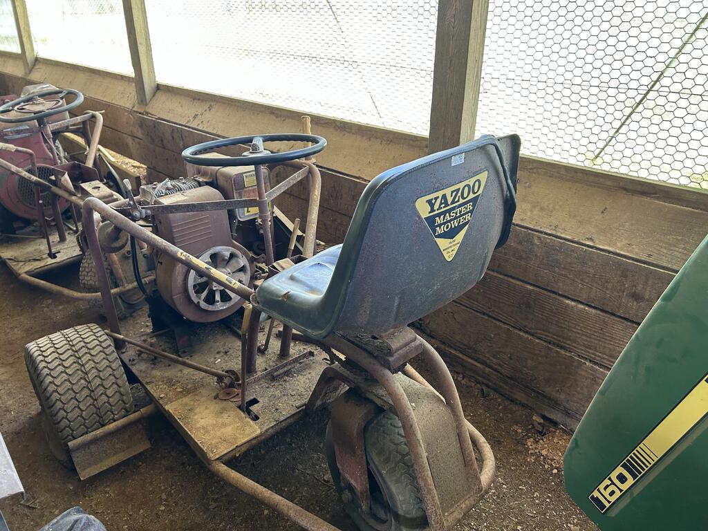

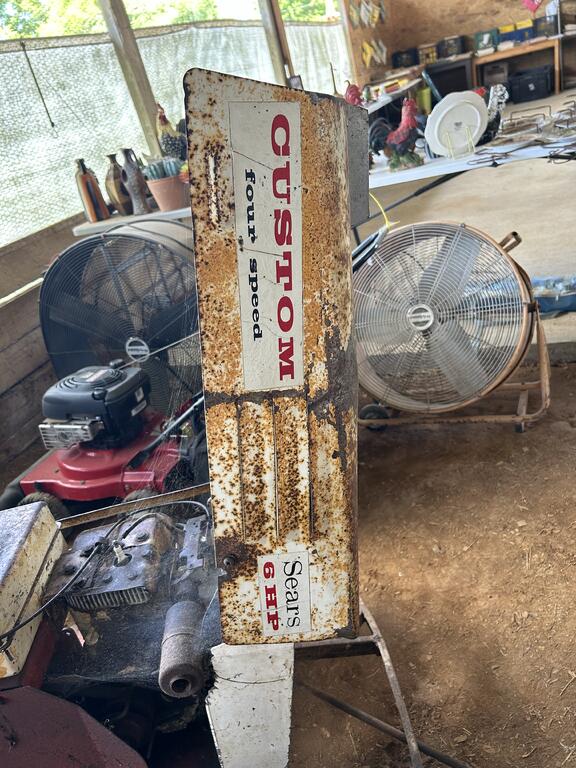

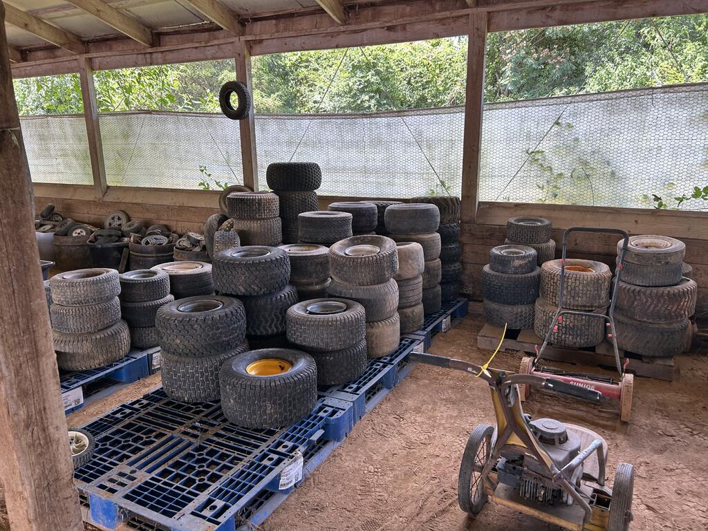

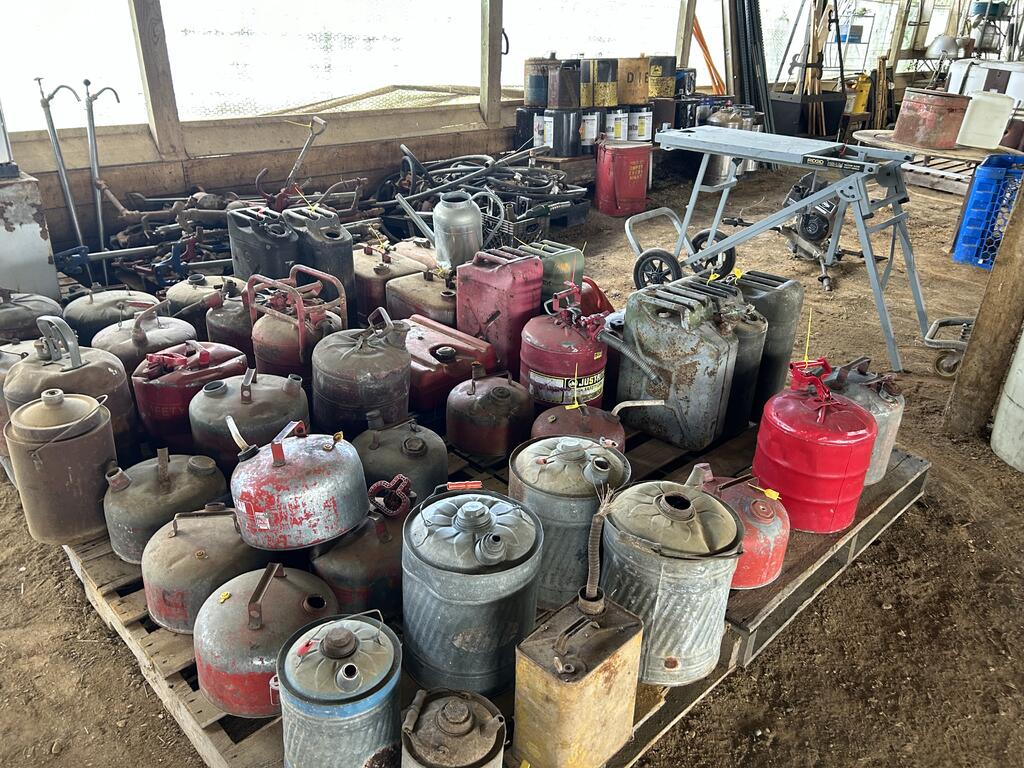

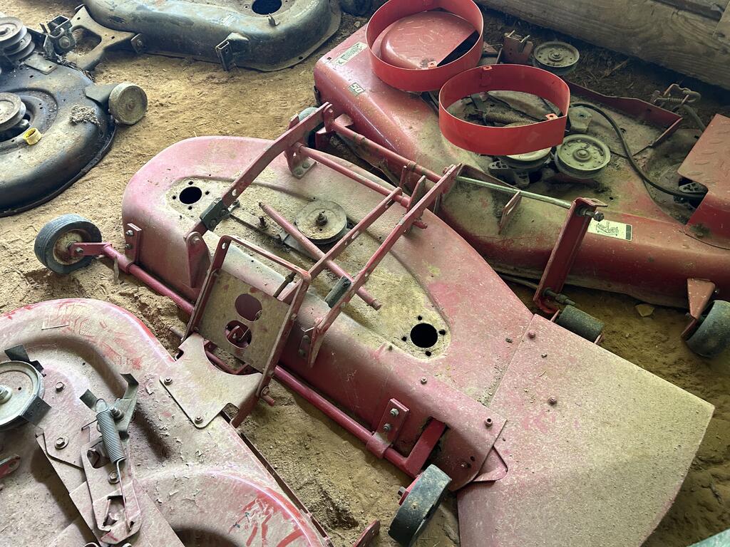

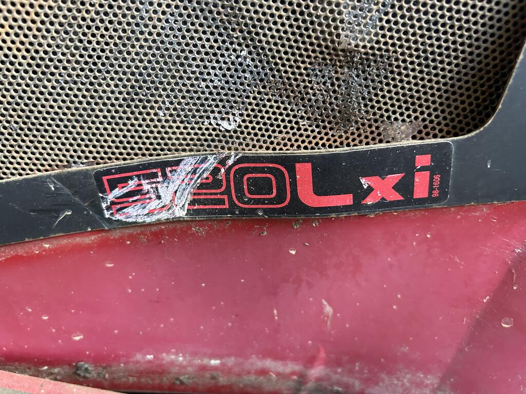

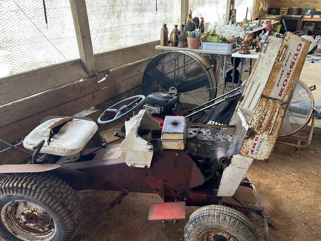

Horse Newbie 7,405 #17 Posted June 23, 2024 On 6/18/2024 at 12:36 PM, ebinmaine said: Please keep us posted. Always good to have another vendor of pre-owned Parts when possible. Not much to see as far as WH’s… have just about any other kind of jun… er “stuff” anyone might need… 2 1 Share this post Link to post Share on other sites

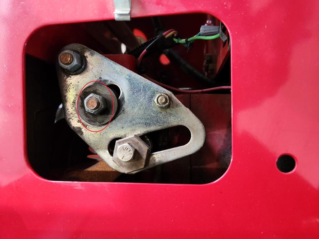

Racinbob 13,087 #21 Posted June 23, 2024 This is on a 1996 314H Eaton 11. Of course others may be different. The 6# was in the service manual. There's also an early and late Eaton 11. This one is a late. 1 Share this post Link to post Share on other sites
John c 214 #22 Posted June 23, 2024 thank you Bob so it's just a matter of tightening that bolt a bit to increase the drag on the plate huh ? Once upon a time I had a trigger pull gauge I'll have to see if I can find it, push comes to shove I'll ride around with socket wrench and tweek it as i go to find the sweet spot. thanks again 3 Share this post Link to post Share on other sites
Racinbob 13,087 #23 Posted June 23, 2024 38 minutes ago, John c said: thank you Bob so it's just a matter of tightening that bolt a bit to increase the drag on the plate huh ? Once upon a time I had a trigger pull gauge I'll have to see if I can find it, push comes to shove I'll ride around with socket wrench and tweek it as i go to find the sweet spot. thanks again That's it John. I don't see any reason an adjust by feel would be a problem. Just getting it past the drifting problem is all you're looking for. Share this post Link to post Share on other sites
rjg854 13,269 #24 Posted June 23, 2024 That adjustment has nothing to do with a 16 Auto or C160. Share this post Link to post Share on other sites
Handy Don 17,197 #25 Posted June 24, 2024 9 hours ago, John c said: thank you Bob so it's just a matter of tightening that bolt a bit to increase the drag on the plate huh ? Once upon a time I had a trigger pull gauge I'll have to see if I can find it, push comes to shove I'll ride around with socket wrench and tweek it as i go to find the sweet spot. thanks again Just don’t be tempted to put any kind of lubrication on that spot! It’s intended to run dry. 2 Share this post Link to post Share on other sites
