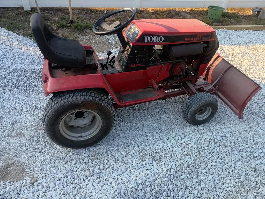

ByMistake 2 #1 Posted June 18, 2024 Hello all, new user here. Looking for more info on this wheel horse (89-90?) i recently purchased. Specifically attachments and/or interchangeable parts that i can use. The plow on it now doesn't seem to be made for it or missing some parts. Also some hub caps would be nice, not sure where i should measure from. Thank you 1 Share this post Link to post Share on other sites
Sparky-(Admin) 26,186 #2 Posted June 18, 2024 I bet you have a short frame plow, looks very close to the front wheels. I also don’t see the angling lever. How far are you from Biglersville Pa? The biggest Wheel Horse extravaganza is happening this Thursday/Friday/Saturday. Every known attachment you could ever want will be there! 3 Share this post Link to post Share on other sites

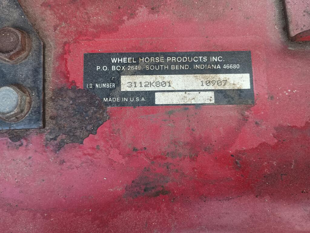

Sparky-(Admin) 26,186 #5 Posted June 18, 2024 FYI… 31-12K801 1990 312-8 Garden Tractor 8 Speed KohlerM12S-471527 1 Share this post Link to post Share on other sites

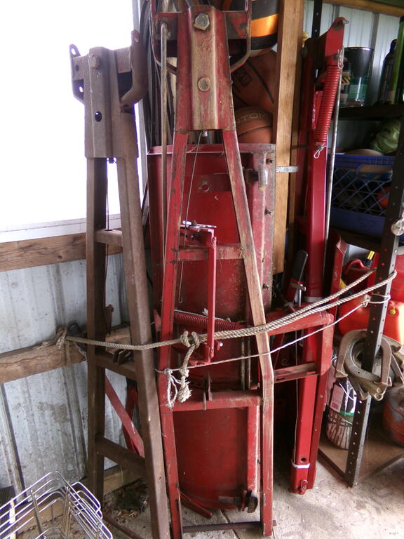

Ed Kennell 46,798 #9 Posted June 18, 2024 Yep, like Mike said. That VEE shaped plow frame is for a short wheel base tractor. The long frame that you need will have parallel sides and be about 3" longer. You will also need the blade angle control lever. You may also need the new style axle bracket if you have the old style. Short frame on the left and long frame on the right. The rear wheels take 12 hub caps. Not sure on the fronts, some 312s had 6" and some har 8" wheels. All implements from C series, 300, 400, and 500 series tractors will fit. Mowing decks, dozer/snow plows, grader blades, snow blowers, tillers, etc. 3 Share this post Link to post Share on other sites
WHX?? 57,644 #10 Posted June 18, 2024 Definitely short frame plow. Gotta like them custom trip springs. 2 Share this post Link to post Share on other sites
Handy Don 17,202 #11 Posted June 18, 2024 16 minutes ago, WHX?? said: Definitely short frame plow. Gotta like them custom trip springs. I didn’t notice those low-elasticity models until you pointed them out! They could provide some “shocking” plowing experiences, for sure. 1 Share this post Link to post Share on other sites

peter lena 9,993 #16 Posted January 4, 2025 @ByMistake agree with @Ed Kennell on the short vs long frame , and the opportunity to set it up for smooth easy function , on 2 milk crates ,https://www.wheelhorseforum.com/search/?q=plow hardware &quick=1 those frame / blade set ups , work like magic , with functional detailing , whatever you change / improve up on crates , for ease of improvement function , thats exactly you hook up on the tractor . every set up step , can be improved , finish with an oil rubbed front blade , for snow slide off , lucky you , pete 1 Share this post Link to post Share on other sites
