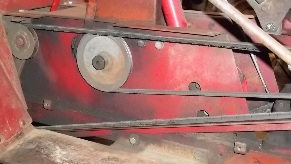

953 nut 69,726 #9 Posted June 17, 2024 The shifting problem is why I went to an 83" belt. If memory serves me right I had to trim some metal to allow the clutch arm to swing a bit further. There is an arm mounted on the right fender that will hold the belt on the transmission pulley (sorry, no pictures) and there is one on the engine to keep the belt on the engine pulley. 2 1 Share this post Link to post Share on other sites
Dave E 37 #10 Posted June 18, 2024 38 minutes ago, 953 nut said: The shifting problem is why I went to an 83" belt. If memory serves me right I had to trim some metal to allow the clutch arm to swing a bit further. There is an arm mounted on the right fender that will hold the belt on the transmission pulley (sorry, no pictures) and there is one on the engine to keep the belt on the engine pulley. Good pics, I'll post some tomorrow. I got it working much better tonight, moved the guide up as far as it will go and it's not touching but close. I didn't mess with the back one but I did see that it's more than the called for 1/16" to 1/32", will probably try that tomorrow. Still a little grinding sometimes but much better. If you want another 83" I have one with about 50 turns on it. 1 Share this post Link to post Share on other sites

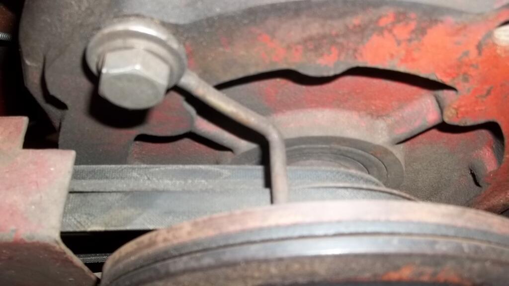

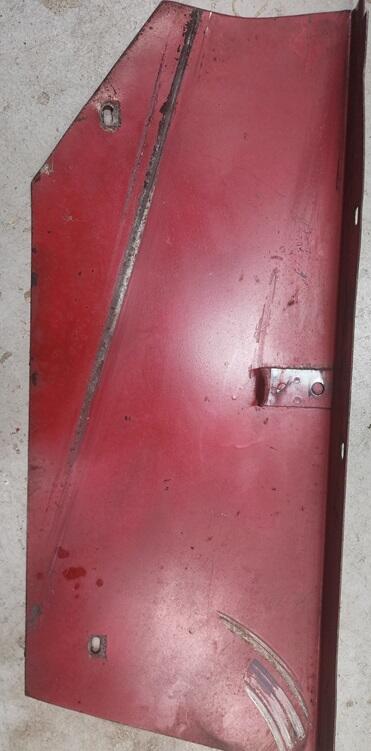

WHX?? 58,290 #13 Posted June 18, 2024 (edited) 1 hour ago, 953 nut said: If you got it at Tractor Supply they will take it back. I get the size I think I need from TSC and one either side. Take back the ones that don't work as long as they are not damaged or full of grease. @Achto and I both had problems with TSC belts on 953s until they wore in and left blue dust all over... 82" right Dan? After that no issues. The arm Richard showed is what some guys call a tab. Some model belt guards have it built on. Edited June 18, 2024 by WHX?? 2 Share this post Link to post Share on other sites
Dave E 37 #14 Posted June 18, 2024 1 hour ago, WHX?? said: I get the size I think I need from TSC and one either side. Take back the ones that don't work as long as they are not damaged or full of grease. @Achto and I both had problems with TSC belts on 953s until they wore in and left blue dust all over... 82" right Dan? After that no issues. The arm Richard showed is what some guys call a tab. Some model belt guards have it built on. I have a tab. Will post pics tomorrow from PC. Look forward to belt wearing in, guess I need to work it more and wrench it less for a while ... Share this post Link to post Share on other sites
Dave E 37 #15 Posted June 18, 2024 Adjusted belt spacing last night, the manual shows 1/16"-1/32", there's not nearly enough adjustment to have it that close up front but further back on the belt guide I got it in tolerance. Pretty much means the belt is 2 hair widths off the guide. It's working much better now, hoping as the belt breaks in it will improve more. As for the guide hanging off the fender in the rear, I didn't touch it but I think I will so see if it makes any difference though it seems it is there more to keep the belt on the pulley. Here's a picture up front: The belt cover does include a guide which sits above the belt, here's a picture of that: Thanks for the advice on that, seems like I am in decent shape on the belt side of things. Dave 3 Share this post Link to post Share on other sites

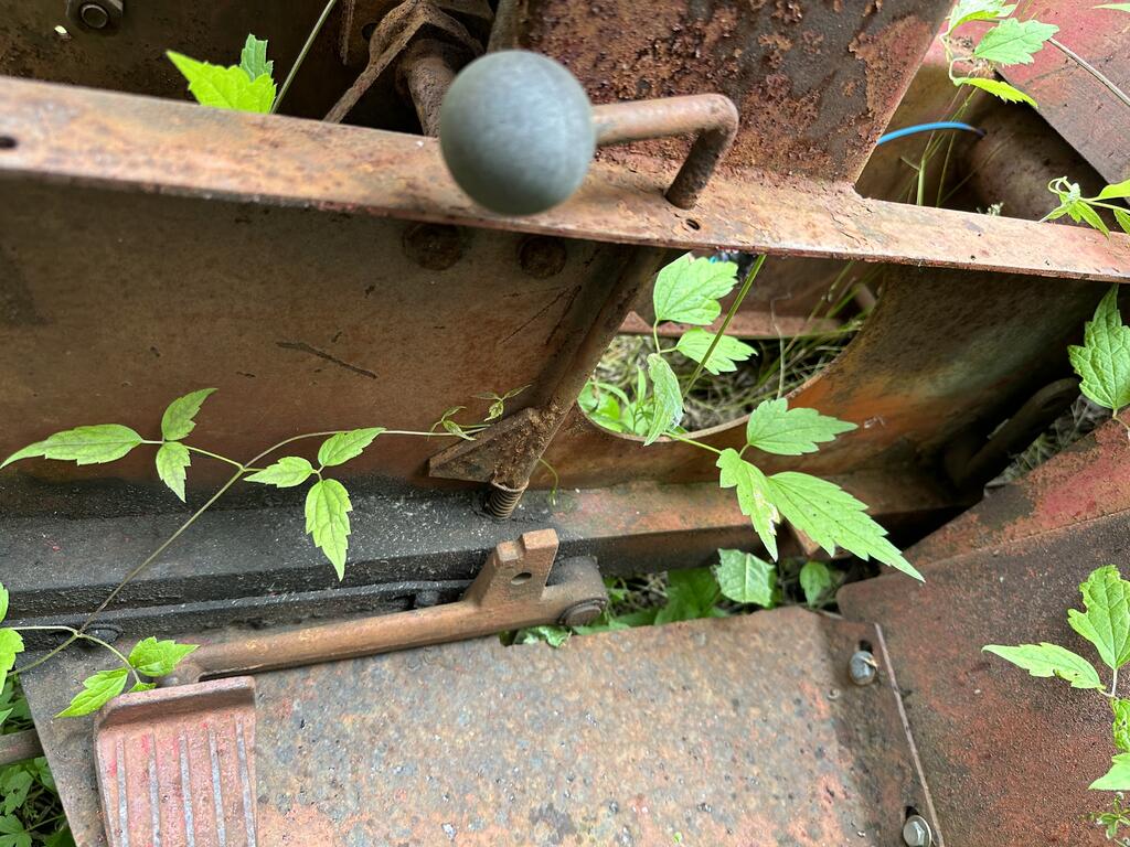

Pullstart 71,350 #16 Posted June 18, 2024 The parking brake is on the left side of the tractor. Do you have this? You can see without the left side cover the clutch/brake lever is depressed, and the parking brake handle is rotated into position. 1 Share this post Link to post Share on other sites
Dave E 37 #17 Posted June 18, 2024 (edited) 4 hours ago, Pullstart said: The parking brake is on the left side of the tractor. Do you have this? You can see without the left side cover the clutch/brake lever is depressed, and the parking brake handle is rotated into position. Yes, mine was out of adjustment so I put a wrench on it pretty much expecting it to twist off and of course I willed it to do so. Found one on A-Z Tractor that has the same part number as in my manual (2830) but with a -U on the end and ordered it for $15. If it's the wrong part I will just put my D-/F+ welding skills (but I get a C- in grinding) to work and make one I guess. Just logged in and it looks like it shipped, so I wait... Edit: A-Z tacks a -U on the part number of anything that is a used part - so looks like it's the right part. Maybe somebody will see this down the road and be wiser for it. Edited June 18, 2024 by Dave E 2 Share this post Link to post Share on other sites
