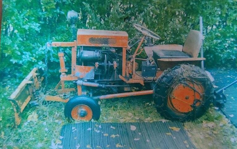

raye321 8 #26 Posted June 20, 2024 (edited) It is cool. They should have named it Work Horse. The Raider 12 has been through a lot through the decades. Never been to the shop for any type of repairs. I have changed plugs, oil etc, gas line and filter, normal stuff. Had to replace one front tire, the other tires are original. The drive belt is original. Recently I noticed it would start out slow when in 2nd or 3rd gear like a clutch slipping and found the drive belt was quite worn. In the mid '60s my Father built a tractor from scratch using a 1940's truck transmission and rear end from a salvage yard. Cut it down to make it smaller size. Made the back fenders from 55 gal. steel barrels. designed a clutch to fit. Bought a new Tecumseh 12 hp motor. Hydraulic controlled front blade for plowing snow and a tiller for the back to plow gardens in the spring. As a kid, I made a few bucks plowing snow and tilling gardens around the area. It was a beast. With a positraction rear end and gear ratio from motor to trans., You couldn't stall in. I have a pic of it. If I can find it, I'll post it here. Somewhere in the '90's, it broke a rear axle, had to retire it and I bought a snow blower attachment for the Wheel Horse and used it for several years before buying a walk behind. On the Wheel Horse, I thought about cutting the weld on the idler bracket, move it back and reweld. But I don't think the replacement belt I bought is the right one. Right measurements but maybe angle degree is wrong and it just seems too short. The clutch pedal is almost all the way down when I put the belt on. I'm a bit stubborn, I can't see spending $70 on a belt on a 53 year old tractor; unless I absolutely have too! Edited June 20, 2024 by raye321 Share this post Link to post Share on other sites

raye321 8 #30 Posted June 21, 2024 (edited) I found the photo of my Father's homemade tractor he made in the 1960's. The picture was taken close to it's retirement sometime around 2012. Edited June 21, 2024 by raye321 3 Share this post Link to post Share on other sites
ebinmaine 81,283 #31 Posted June 21, 2024 That's ridiculously awesome. Share this post Link to post Share on other sites
