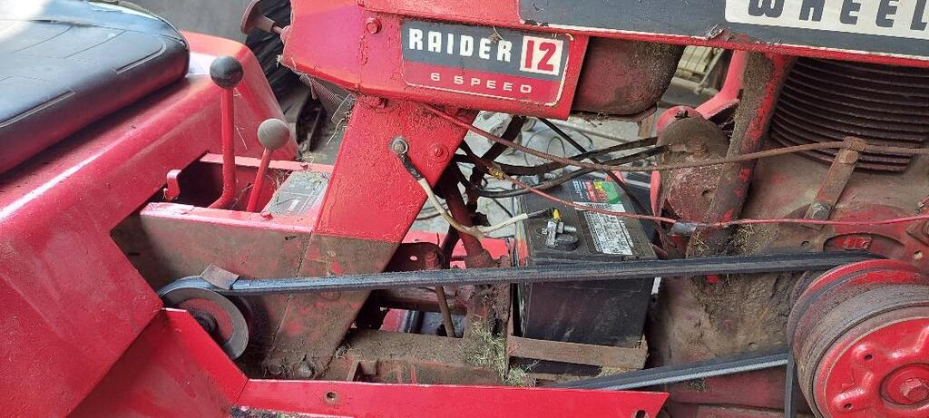

raye321 8 #1 Posted June 16, 2024 Hi, I have a 1971 Raider 12. I replaced the drive belt (the original belt !) which calls for a 5/8" x 82" belt and is D&D PowerDrive B79/5L820 V Belt, 5/8" x 82" brand. It went on okay but is tight. I hardly have any pedal. The smaller upper pully that moves with the brake pedal is at about at the 1 o'clock position and the guide above the pully touches the top of the belt. I haven't tried it yet because I'm waiting for a mower belt to pto and a bearing for the tension pulley on that belt to arrive that I ordered from ebay. Wandering if there is another belt size or brand that would be a better fit. Thank you Ray 2 Share this post Link to post Share on other sites

raye321 8 #4 Posted June 18, 2024 (edited) Seems like it's a bit wide at 5/8". In the attached pic is the new belt. 5/8" x82". The top guide scraped the top of the belt off. Can't get it into gear. I think the problem with the after market belts is the angle of the V and or belt depth. Doesn't fit into the pulley properly. I can't seem to find the oem wheel horse 7473 or gates 6982. Edited June 18, 2024 by raye321 Share this post Link to post Share on other sites

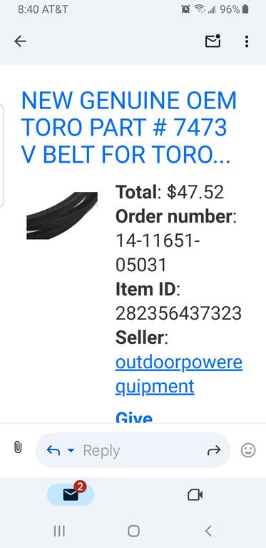

ebinmaine 80,755 #6 Posted June 18, 2024 7 hours ago, raye321 said: I can't seem to find the oem wheel horse 7473 Just gotta know who to poke for the right answer... There are a couple vendors on Redsquare that may have it. 4 hours ago, daveoman1966 said: A little pricey, Dave, they wanted almost $70 (with shipping) to here. I've been paying about $40, $45. from "Bill's Place/ Outdoor Power Equipment" Here's an item number for the OE Wheelhorse/ Toro belt: 282356437323 Or try searching on ebay: NEW GENUINE OEM TORO PART # 7473 V BELT FOR TORO TRACTORS ; REPLACES 78-7100 Share this post Link to post Share on other sites
squonk 48,133 #7 Posted June 18, 2024 I use aftermarket belts all the time. They work fine. That plate on the idler is bent too far forward. It should not have scraped the belt. I'm sure it's too late to double check the number on the belt. Take it off and measure the outside of the belt with a tape measure. Belts are in the wrong package all the time. If you have a Tractor Supply near by try another 5L820 Share this post Link to post Share on other sites

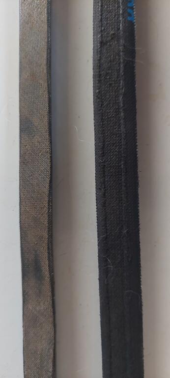

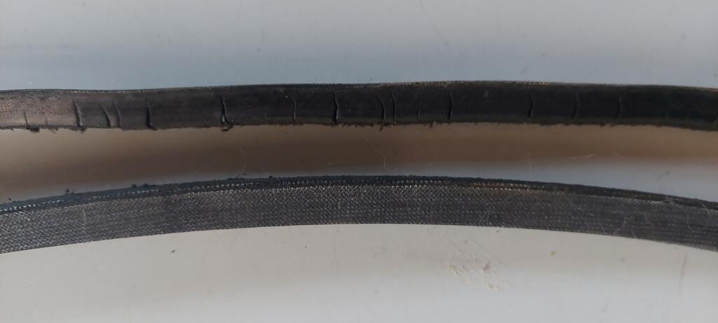

raye321 8 #11 Posted June 18, 2024 I replaced the mower to pto belt with after market brand with no problem. Cost $10 & free shipping from ebay. Pictured here is the top of new belt- right and old belt. Other pic; side of belts. Old belt at top. I measured the old belt at about 1/2" width, new belt 5/8". Sides, old belt about 3/8", new belt 7/16". It's hard to tell if the old belt was same measurements as the new belt and worn down that much. Share this post Link to post Share on other sites
squonk 48,133 #12 Posted June 18, 2024 The belt is supposed to be 5/8" From you picture the belt sits in the pulleys fine. That worn out belt is either really worn down or the wrong one to begin with. Either go to Tractor Supply or go to Napa. Napa # is 5L820W (Gates brand belt) And move this guide back so it's not contacting the belt when tight. Share this post Link to post Share on other sites
ebinmaine 80,755 #13 Posted June 18, 2024 4 minutes ago, squonk said: this guide contacting the belt There should be a hole in the back of that belt guide so you can pivot it on the bolt that holds the pulley in place. I've seen a couple of those guys that were welded onto the arm instead, and wrong. I've had to use a monkey wrench or whatever to "convince" the front of it up a little bit. You folks take a look at the front of that guide. Looks like it's got a bit of a point on the outside which may indicate that a belt or the pulley or both has been rubbing on it in the past. Share this post Link to post Share on other sites
Handy Don 17,482 #14 Posted June 18, 2024 25 minutes ago, ebinmaine said: Looks like it's got a bit of a point on the outside which may indicate that a belt or the pulley or both has been rubbing on it in the past. Yes, and since the belt is rotating toward the downward sharpened edge of the flange, it will get eaten. Share this post Link to post Share on other sites
raye321 8 #15 Posted June 18, 2024 I bent the belt guide a little trying to get it off the belt. I can straighten it out. I took the belt off but I'm going to put it back on and pivot the belt guide back, see if that works. Although, I think when I first installed the new belt, it pulled the pulley forward to where you see it in the pic. If it should be 5/8" wide, 7/16 depth, the belt should work. I have seen some with the 7473 replacement that measures 21/32 wide and 3/8" depth. Share this post Link to post Share on other sites

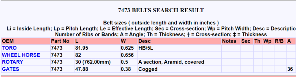

daveoman1966 3,884 #18 Posted June 18, 2024 For any belt sizes, go here: Just enter the OEM belt number up front and it'll tell all you need to know: https://outdoorpowerinfo.com/belts/#result 2 Share this post Link to post Share on other sites

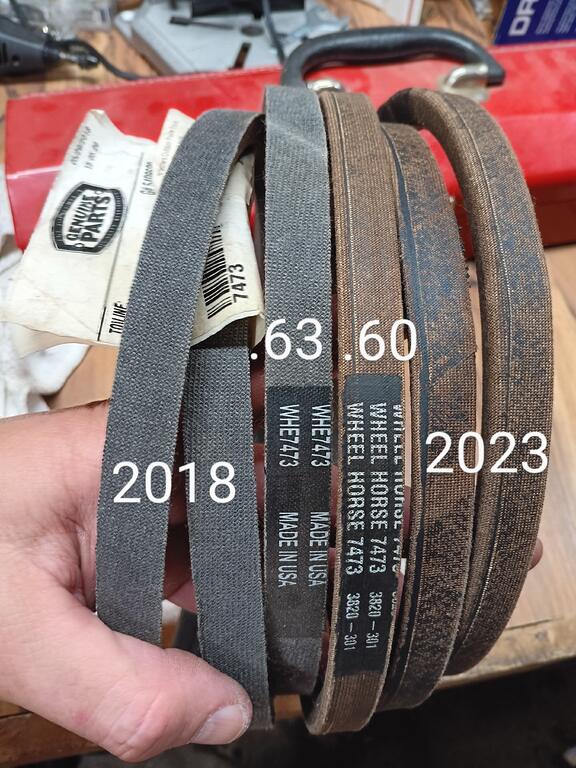

ebinmaine 80,755 #22 Posted June 20, 2024 7 hours ago, raye321 said: ebinmaine, are any of the belts you pictured of that size? The NOS Toro is .63 The new last year Wheelhorse belt is narrower at .60 Maybe I measured a thin spot just by luck. Maybe it's that width all around. I'm wondering if something on your tractor has been changed by a previous owner? Maybe a pulley size? I too, have had to pull up & back on that idler bracket mounted guide. Your belt appears to be setting at about the right depth. Is there a decent parts store nearby you that has an ACTUAL belt measuring tool AND knows how to use it? Not a tape measure. Share this post Link to post Share on other sites
