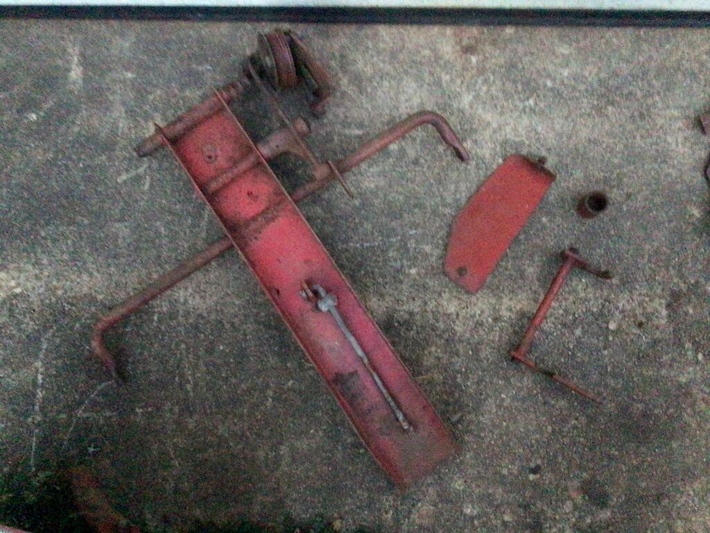

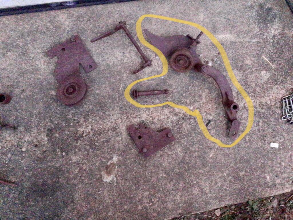

Rattlecan 68 #1 Posted June 15, 2024 Good morning all. These are the parts that I have left out of the box that came with the a1067, painted red and other parts from a box of parts from somewhere else, primer painted. Are these parts exclusively for a mower deck drive belt or are they like the later attachamatic and front mule drive but older version. I am having difficulty figuring where the tractor parts and the attachment parts separation is. In the red painted stuff picture there is a piece of sheet metal that I do not see in any diagrams that I have found. Thanks again guys Share this post Link to post Share on other sites

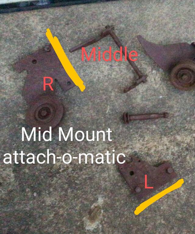

ebinmaine 81,282 #2 Posted June 15, 2024 Yellow lines are where the frame would be. 2 Share this post Link to post Share on other sites

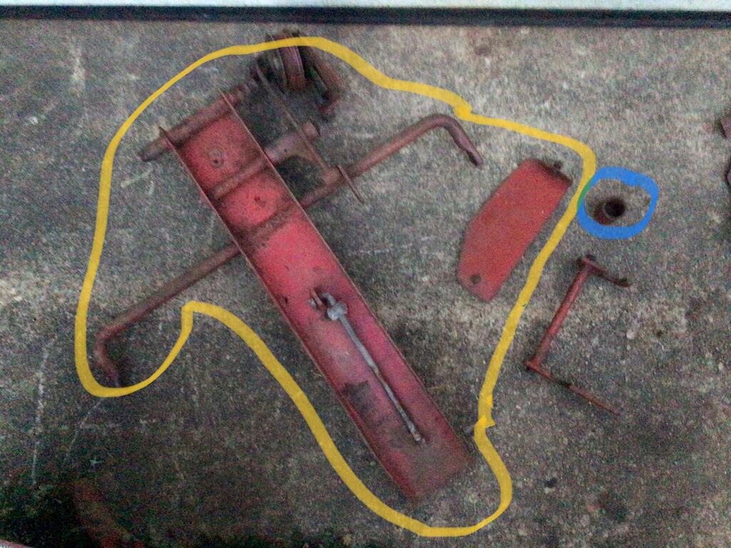

Rattlecan 68 #3 Posted June 16, 2024 Thanks. So the things in yellow are just for a mower deck including the little shaft with what looks like a little pulley on the end and the sheet metal guard thing? How about the thing in blue. It looks like a spacer of some kind about an inch long piece of pipe basically. Thanks again i spent about a half an hour figuring out how to draw on pictures. 1 Share this post Link to post Share on other sites

Pullstart 71,564 #5 Posted June 16, 2024 Other than the attach-a-matic EB pointed out, these are all parts that are mounted to a deck. They only have that one function, but they are period correct for the 1067. 6 Share this post Link to post Share on other sites
adsm08 5,247 #6 Posted June 16, 2024 10 hours ago, Rattlecan said: Thanks. So the things in yellow are just for a mower deck including the little shaft with what looks like a little pulley on the end and the sheet metal guard thing? How about the thing in blue. It looks like a spacer of some kind about an inch long piece of pipe basically. Thanks again i spent about a half an hour figuring out how to draw on pictures. The uncircled part is for deck mounting. The front bar on the deck sits up the slot on the plate at the bottom of the first picture and a mirrored on for the other side, then this par swings back and is pinned in place to lock the deck to the tractor. 2 Share this post Link to post Share on other sites
WHX?? 58,388 #7 Posted June 16, 2024 2 hours ago, Pullstart said: Other than the attach-a-matic EB pointed out, these are all parts that are mounted to a deck. They only have that one function, but they are period correct for the 1067. '67 thru 70 deck parts. Don't scrap guys are looking for those every now and then. The cast piece that hangs from the foot rest bar is cast and snaps. 2 Share this post Link to post Share on other sites
