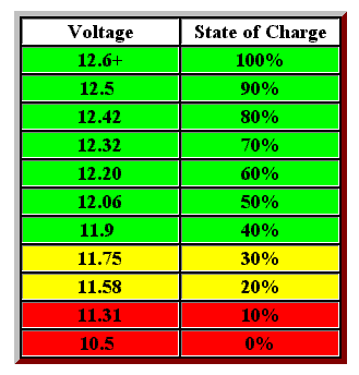

Toolmanbill 44 #1 Posted June 15, 2024 Bought a new starter from AJ electric in April.although it started the tractor it never seemed quite right.sometimes cranked slowly but then cranked ok.now it won’t crank at all except with a jump. I noticed the amp gauge was charging extremely low. The battery checked out at 11.4 volts.Does the starter work to generate the battery or would this be a voltage regulator issue?Any advice would be appreciated greatly! Thanks. 1 Share this post Link to post Share on other sites

lynnmor 8,970 #4 Posted June 15, 2024 6 hours ago, Toolmanbill said: Bought a new starter from AJ electric in April.although it started the tractor it never seemed quite right.sometimes cranked slowly but then cranked ok.now it won’t crank at all except with a jump. I noticed the amp gauge was charging extremely low. The battery checked out at 11.4 volts.Does the starter work to generate the battery or would this be a voltage regulator issue?Any advice would be appreciated greatly! Thanks. ' 11.4 volts is a dead battery. 3 Share this post Link to post Share on other sites
ebinmaine 80,080 #5 Posted June 15, 2024 3 hours ago, Toolmanbill said: also put in a new ignition switch,seat switch and pto saftey switch. Why were these switches installed? 1 hour ago, lynnmor said: ' 11.4 volts is a dead battery. Agreed. 1 Share this post Link to post Share on other sites
