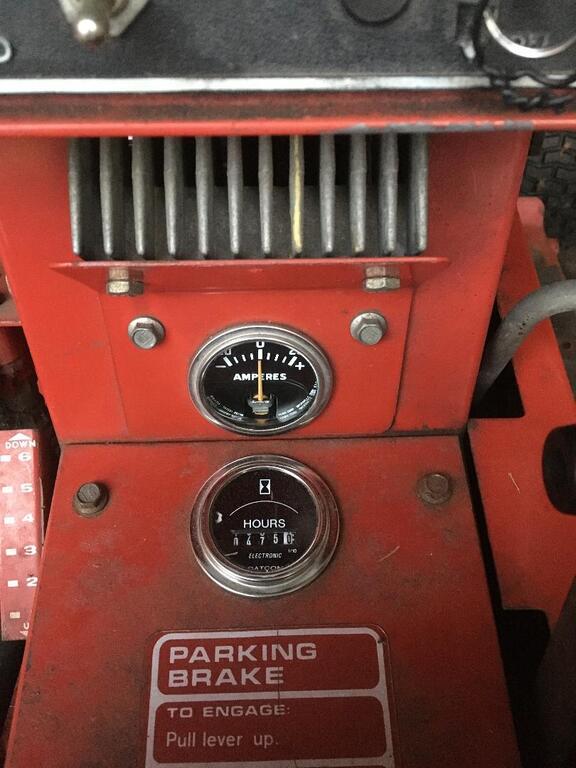

Condor 9 #5 Posted June 13, 2024 Here is the picture 1 Share this post Link to post Share on other sites
ebinmaine 80,755 #6 Posted June 13, 2024 3 minutes ago, Condor said: Here is the picture Nothing unusual or non-factory on the outside. Do you have an electric fuel pump behind any of that? Share this post Link to post Share on other sites
