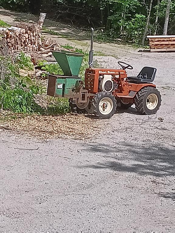

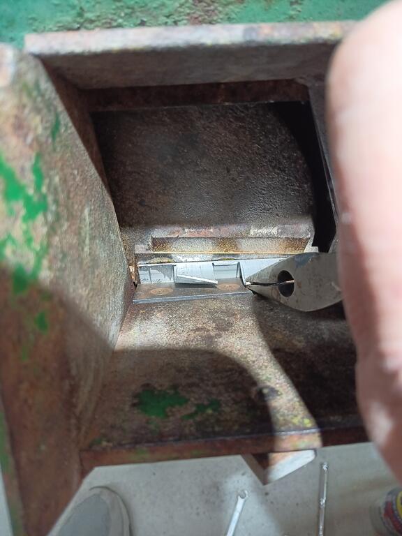

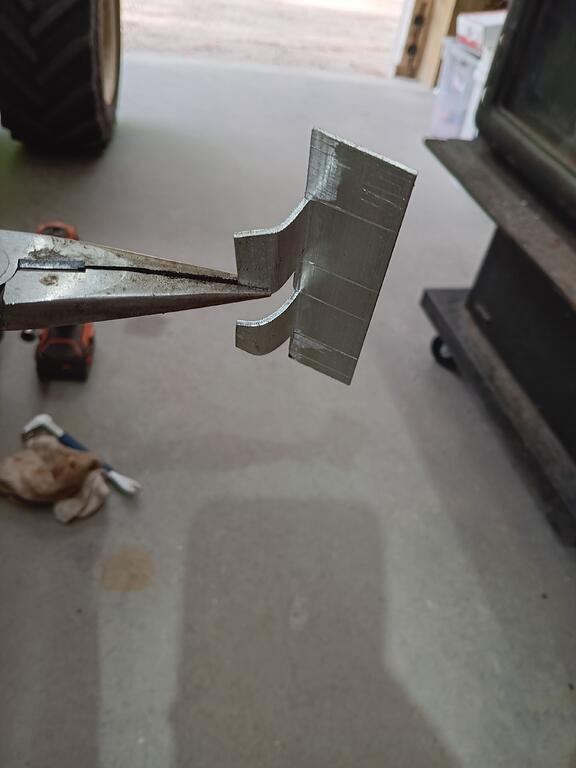

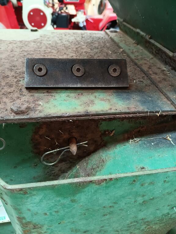

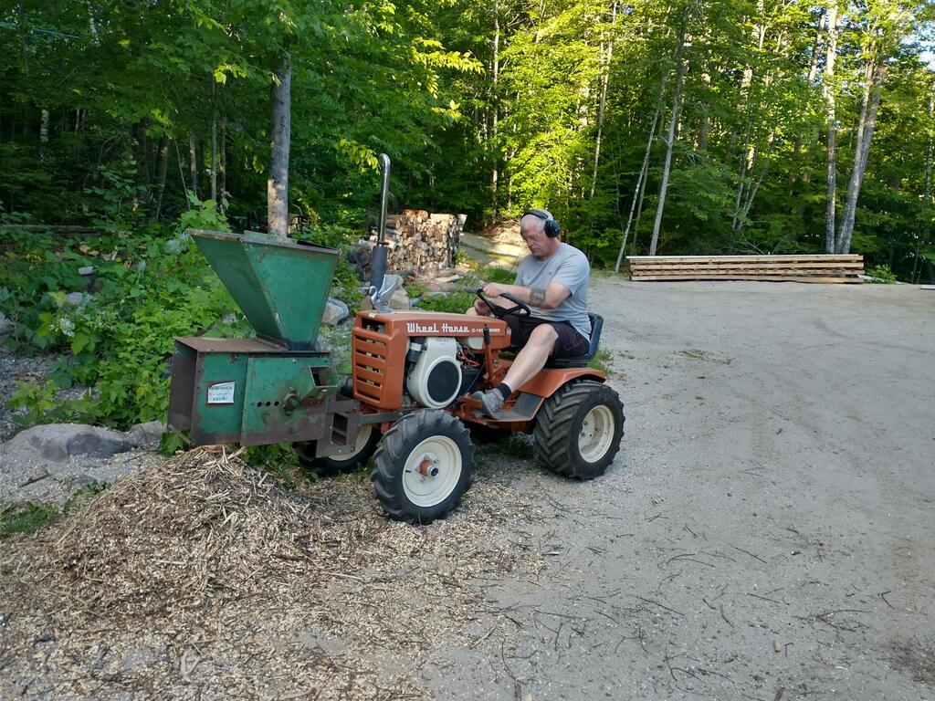

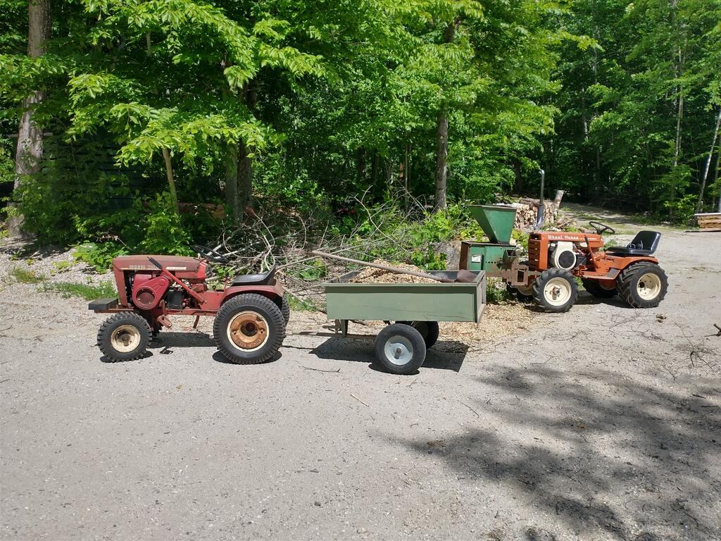

ebinmaine 79,512 #1 Posted June 8, 2024 @Stepney has been a great supplier of many things Wheelhorse for me over the years. My first Wheelhorse tractor was his. The chassis for my Cinnamon Horse C160-8 was. My first hydro. More things than I could name. Well... a few weeks ago Spenser mentioned that it would be neat if he had a "parts" GT14. Don'tcha know maybe 2 or 3 days later @PWL216 Paul, also a great supplier to me, said he had some tractors to rehome. I bought 3. One was Spenser's desired GT14. Well we done some swapping and trading and bartering. I ended up with this Mackissic chipper shredder model 12P. The side of this one is slightly different from my other one (currently in restoration) because it has 3 small holes to access the knife. @gwest_ca mentioned in another thread that may make it an earlier model. Well today I spent some time getting it hooked up to my Cinnamon Horse C160-8 and trying it out for the first time. I swapped the belt tensioner flat pulley. I only had a belt that was technically too long (several actually) so I drilled a new hole for the tensioner to bolted through. It seemed to work well. Needed the anvil to knife clearance adjusted. Here's the first load in Trina's trailer. Note that there's a fair amount of longer sticks on the ground AFTER they've gone through the machine. I wasn't using any screen. I removed the anvil. Cleaned it up. Here's where it mounts. For installation I used a home shop made tool to get the 1/16" spacing correct. This is the second pile. MUCH better with the screen and proper knife clearance. 6 1 Share this post Link to post Share on other sites

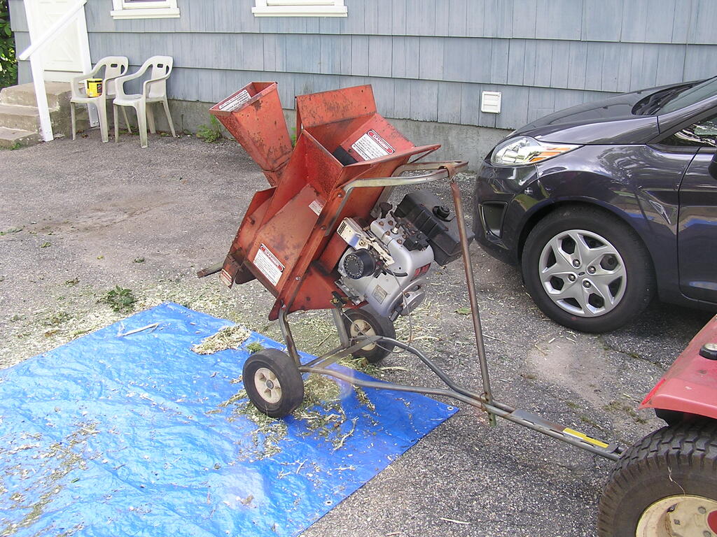

ri702bill 12,399 #3 Posted June 9, 2024 Eric - The keys are a good sharp blade with proper clearance, and the screen to hold the larger processed parts for recutting. When we got the tow behind Gard-N-Way chipper / shredder, it did not have a lower screen. Made one up and what a difference.... 1 Share this post Link to post Share on other sites

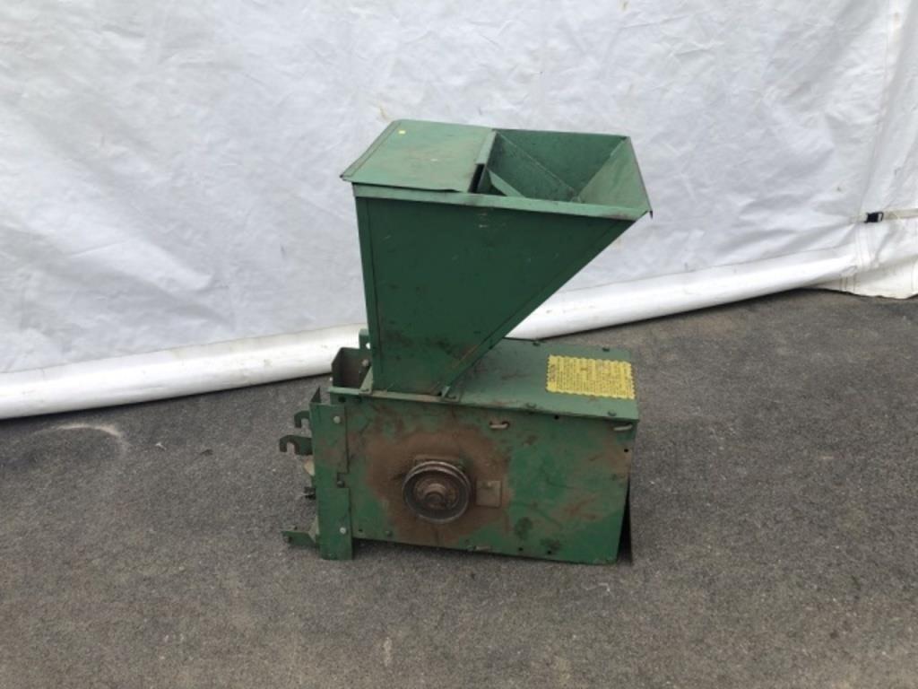

OoPEZoO 605 #14 Posted June 10, 2024 Just found another one of these up for sale on a local auction site that ends tonight at 8pm......current bid is $2 with no reserve Really don't have a need for a 2nd one, but seriously thinking about making a run at it. Even if its junk (which it doesn't look like junk), the few spare parts I could pull of it would be well worth the effort. Share this post Link to post Share on other sites
ebinmaine 79,512 #15 Posted June 10, 2024 15 minutes ago, OoPEZoO said: Just found another one of these up for sale on a local auction site that ends tonight at 8pm......current bid is $2 with no reserve Really don't have a need for a 2nd one, but seriously thinking about making a run at it. Even if its junk (which it doesn't look like junk), the few spare parts I could pull of it would be well worth the effort. I'd go for it for sure! You could resale it for $200 or $300. You could pull the parts out of it and keep it for yours. You could set up another one. Lots of options there. If you turn that into a parts machine, I'd buy the screen from you. Share this post Link to post Share on other sites
OoPEZoO 605 #16 Posted June 10, 2024 I think I will. I've passed on a few due to them being the models on the cart with bad motors. I didn't want to deal with all the extra scrap just to get what I would potentially want, but this one is the tractor mount version and still has the chipper side mount attached. Mine is currently mounted on a chopped up plow frame. It works, but its big and heavy. Getting the mounting brackets alone would be a step up in storage space and convenience. I'll let you know if it works out. 1 Share this post Link to post Share on other sites

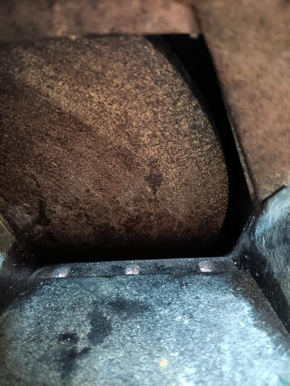

ebinmaine 79,512 #20 Posted June 11, 2024 26 minutes ago, OoPEZoO said: Kicking myself........got busy last night and forgot about the auction. It sold for $25 DOH! There's always next time. I started using mine last night. Got just a few minutes into it and the flywheel stopped turning. I have not done proper Diagnostics yet but it looks like the main cross shaft is broken just inside of the flywheel. I'll get a hold of Mighty Mac and check with a couple machine shops to see what can be done with it. Share this post Link to post Share on other sites
OoPEZoO 605 #21 Posted June 11, 2024 oh man.....thats a bummer. You would know better than me, as you have had your other one apart already, but it looks like there is some sort of bushing and set screw that goes between the main shaft and flywheel. I suppose its possible that something is buggered up there? I doubt the keyway stripped out and I don't see anything resembling a shear pin. Fingers crossed its not the main shaft Share this post Link to post Share on other sites
ebinmaine 79,512 #22 Posted June 11, 2024 5 minutes ago, OoPEZoO said: oh man.....thats a bummer. You would know better than me, as you have had your other one apart already, but it looks like there is some sort of bushing and set screw that goes between the main shaft and flywheel. I suppose its possible that something is buggered up there? I doubt the keyway stripped out and I don't see anything resembling a shear pin. Fingers crossed its not the main shaft I was harboring the key way as a hopeful thought but then when I touched the flywheel it wobbles back and forth at a very interesting angle that matches what the end of the shaft does. One could consider it a plus side that the other unit is still disassembled. I'm hoping I can pop this one apart without too much drama and swap the other whole unit back into place. The other option of course would be to put the restoration of my original one back up towards the top of the list Share this post Link to post Share on other sites
