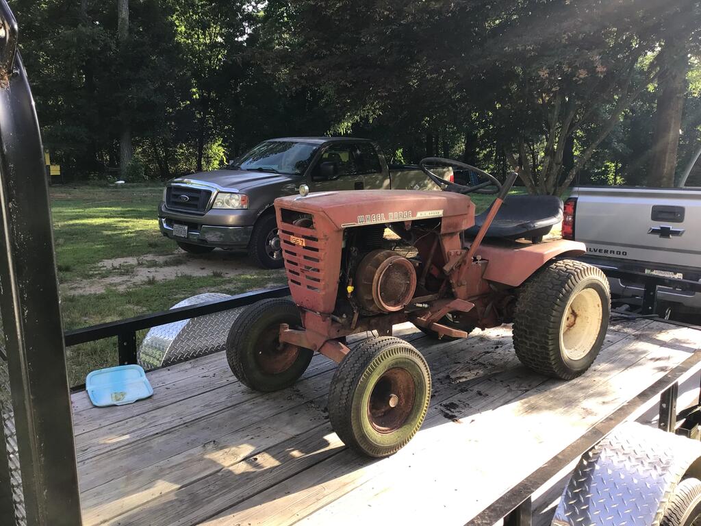

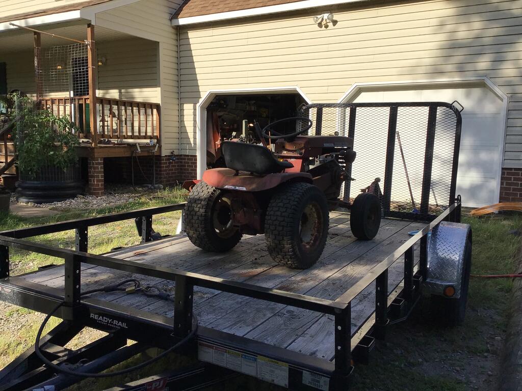

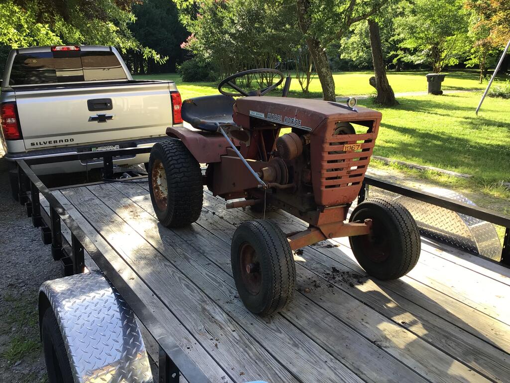

Rattlecan 68 #1 Posted June 2, 2024 Found this one fairly close to the house. Four hour round trip. Purchased the tractor, 6 old implements, roller, cickle bar only I think it’s for a farm all, no shaker box, dozer blade, 6 tire chains but I do not think any of them are a pair, a gas can, mower deck parts, and a push single row planter and a partridge in a pear tree. The owner had taken some of it apart 3 hrs ago to restore it but stopped. It had been inside til then but out in the weather for last 3 hrs. I spent this afternoon getting the critter stuff out of the motor fins. It has very little compression turning the flywheel by hand and I think the exhaust valve is stuck open. I have looked thru all the parts and I believe most of it is in the boxes. I put some mystery oil in the plug hole this afternoon. The engine oil is very clean. I have not tried to evaluate the transmission yet. Any suggestions are welcomed and thanks in advance. 6 7 Share this post Link to post Share on other sites

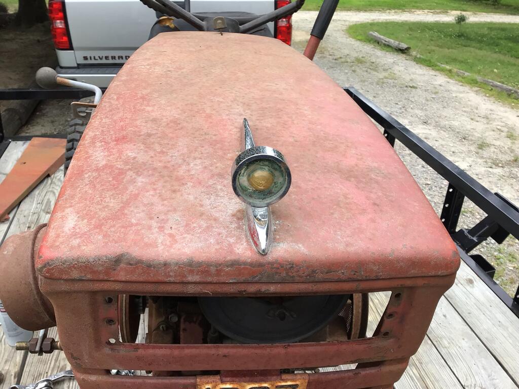

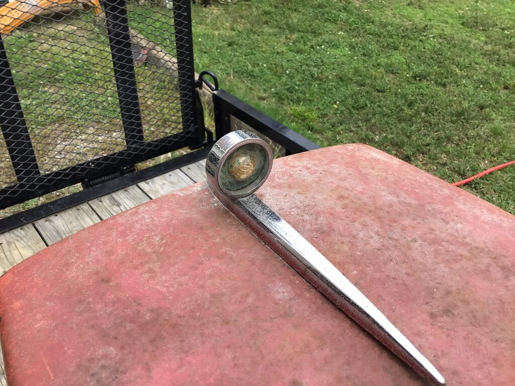

wallfish 20,001 #2 Posted June 2, 2024 Nice find. The hood ornament, interesting. What's on there? Verify if the valve is stuck, Had an 8hp Kohler with a stuck exhaust valve from sitting. Between lightly tapping down and prying up at the valve spring area in order to get it to move back and forth, plus some lube spay as well, it freed up. This is the same engine running in my 654 tractor for about 6-7 years now, still plowing snow every winter. I could care less if it blows a little smoke on start up and acceleration or not. Fires right up instantly every time and still has plenty of power to pile it up and push full loads. It's a worker not a trailer queen. So IMO a stuck valve isn't necessarily the end of the world and requires a complete rebuild. A full blown restore, that's different. 4 Share this post Link to post Share on other sites
Rattlecan 68 #3 Posted June 2, 2024 Do not know what is on the hood. I’m still trying to find something to stump you guys. 1 4 Share this post Link to post Share on other sites

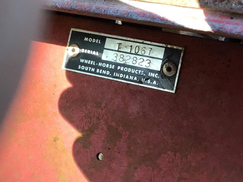

Retired Wrencher 6,693 #4 Posted June 2, 2024 @Rattlecan I guess this must be a 1067 month! I as well have one. These are the first year of the Six speed I think. Just take your time with it as I am doing because you do not see these every day for sale. I hope you enjoy getting yours in good running order like I am doing. Enjoy the ride when it is done. 2 Share this post Link to post Share on other sites
ebinmaine 79,012 #5 Posted June 2, 2024 1 hour ago, Retired Wrencher said: These are the first year of the Six speed I think. Correct. 1967, 68, and 69. All 6 speeds had Limited Slip Differential. 8 hours ago, Rattlecan said: Do not know what is on the hood. I’m still trying to find something to stump you guys. Post some pics from a couple different angles. I'd bet someone on here can ID that cool piece. Excellent catch on that tractor!! 2 Share this post Link to post Share on other sites
8ntruck 8,916 #6 Posted June 2, 2024 I'd guess an early 50's Buick. Seems to me that they had that 'gunsight' theme for a few years. Share this post Link to post Share on other sites

Treepep 1,135 #8 Posted June 2, 2024 hood ornament looks like its always been there. Share this post Link to post Share on other sites
Sparky-(Admin) 25,380 #9 Posted June 2, 2024 I like that hood ornament…if it was mine it would stay 1 Share this post Link to post Share on other sites
squonk 46,665 #10 Posted June 2, 2024 Ornament is not Buick. It's similar but Buick had what looked like a missile in the center of the circle. Share this post Link to post Share on other sites
ebinmaine 79,012 #11 Posted June 2, 2024 23 minutes ago, Sparky said: I like that hood ornament…if it was mine it would stay I'll second that. 1 Share this post Link to post Share on other sites
oliver2-44 11,496 #12 Posted June 3, 2024 (edited) 7 hours ago, Rattlecan said: When I went out this morning the exhaust valve was unstuck, I guess the mystery oil helped. Thanks to whoever told me about that before, I can not remember who. I turned by hand every once in a while and compression seems to feel much better each time. Seems to have more bounce when rotated backwards?.? Spent most of the morning trying to free up the inner race on the pto assembly and free up the brake clutch pedal assembly. They both moved about two hours ago. One rear wheel was walking on the shaft. The square head set bolt was not tight, I pulled it off and the key and hub did not look too bad. Put it back on and tightened bolt and lock nut. Is there a “easy” way to give a basic check on the transmission without it running. Going to drain it shortly and see if it is mud or not. Does only one know the belt length that goes on the generator/starter and the drive belt. It is missing both. Thanks in advance again. so. It is not the original hood ornament. Now I have to find one!! here are some closeups. figured out it is easer to work with it on the trailer. I can sit on the rail. That's a fender ornament from a 59 Ford Fairlane, Galaxy and Thunderbird.. Very Cool Dibs if your really going to remove it! Edited June 3, 2024 by oliver2-44 1 Share this post Link to post Share on other sites
Rattlecan 68 #13 Posted June 3, 2024 1 hour ago, oliver2-44 said: That's a fender ornament from a 59 Ford Fairlane, Galaxy and Thunderbird Maybe three possible names for the tractor? How do you guys figure out what everything is? 1 Share this post Link to post Share on other sites

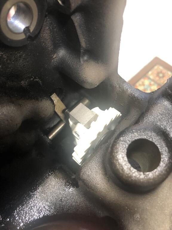

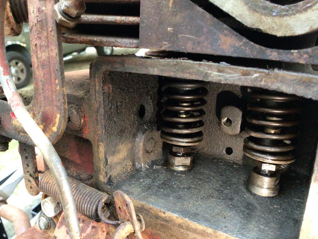

Rattlecan 68 #16 Posted June 3, 2024 Pulled the carb off and the valve cover, don’t know if that is what it is called or not, checked the valve clearance was .004 on intake and .019 on exhaust. I also found an extra hole under the valve cover. See pictures. It looks like it was knocked in from the other side. It is not very thick and I think I can see a gear turning thru the hole. I assume this is not good news. 1 Share this post Link to post Share on other sites
ebinmaine 79,012 #17 Posted June 3, 2024 13 minutes ago, Rattlecan said: extra hole May be bad. Maybe not. Was there any sign of the piece? Do the gears appear to move correctly? 1 Share this post Link to post Share on other sites
Rattlecan 68 #18 Posted June 4, 2024 No there was a little sludge and I wiped it out there was no cast pieces in there and I thought that was odd. I don’t know for sure that I am the only one that has been in there. The hole is probably 1/4 inch I can’t see a lot but I see what looks like gear teeth going by the hole. Thanks Share this post Link to post Share on other sites
ebinmaine 79,012 #19 Posted June 4, 2024 7 hours ago, Rattlecan said: I don’t know for sure that I am the only one that has been in there That's what I was wondering. Perhaps there was an "event" in the past that caused it. And perhaps that was repaired by a PO. 1 Share this post Link to post Share on other sites
Rattlecan 68 #20 Posted June 4, 2024 What does the gear I am seeing do? I’m assuming it has something to do with the governor. I have never been inside of one of these motors before. I guess the hole is not a problem since there is already a vent hole to the inside, am I correct in that thinking? My concern is what caused it. Thanks again Share this post Link to post Share on other sites
ebinmaine 79,012 #21 Posted June 4, 2024 8 minutes ago, Rattlecan said: What does the gear I am seeing do? I’m assuming it has something to do with the governor. I have never been inside of one of these motors before. I guess the hole is not a problem since there is already a vent hole to the inside, am I correct in that thinking? My concern is what caused it. Thanks again I don't have a lot of personal familiarity with these engines but there's a few others that do. @richmondred01 @Achto 1 Share this post Link to post Share on other sites
Handy Don 16,683 #22 Posted June 4, 2024 28 minutes ago, Rattlecan said: What does the gear I am seeing do? I’m assuming it has something to do with the governor. I have never been inside of one of these motors before. I guess the hole is not a problem since there is already a vent hole to the inside, am I correct in that thinking? My concern is what caused it. Thanks again I believe the gear you are seeing is on the camshaft being driven by the crankshaft (it turns in the opposite direction, if you are curious). I don’t see any particular harm for having that hole, since there isn’t any debris and any oil splashed in there will lube the valve stems and exit back to the crankcase via the regular drain hole. Of course, having the breather and cover properly installed is important! 1 Share this post Link to post Share on other sites

richmondred01 2,372 #25 Posted June 4, 2024 That’s a governor gear. 3 1 Share this post Link to post Share on other sites
