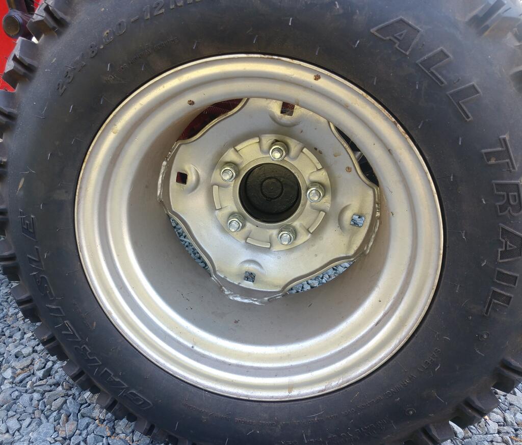

kpinnc 18,884 #7 Posted June 2, 2024 Yes 7/16 x 20 are correct. I use 1 and 3/4 bolts with lock washers and regular lug nuts. This pic has spacers, but still the same thing. 3 Share this post Link to post Share on other sites
