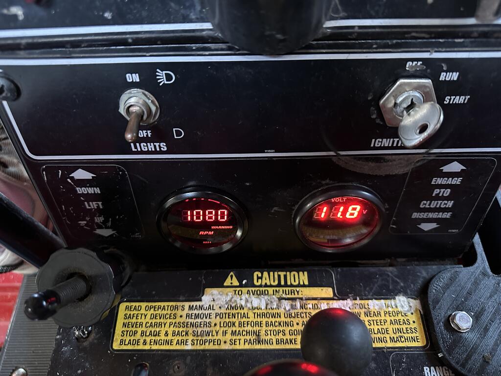

Steve Janninck 152 #5 Posted July 25 I finally found a digital dash mounted tachometer that works with a single cylinder engine. Very accurate when compared with an optical tach. I figured that digital might be better to handle the tractor vibrations than a needle style. It marries up nicely to the digital volt meter I installed a few years ago. 3 4 Share this post Link to post Share on other sites

Bill D 1,819 #7 Posted July 25 (edited) 3 hours ago, Steve Janninck said: I finally found a digital dash mounted tachometer that works with a single cylinder engine. Very accurate when compared with an optical tach. I figured that digital might be better to handle the tractor vibrations than a needle style. It marries up nicely to the digital volt meter I installed a few years ago. Could you please tell us where you bought it, and maybe share a link. Thanks. I have a timing light with a built-in tachometer. I like the idea of adding one on the tractor, especially with the Onan's and their governor issues. Edited July 25 by Bill D 1 Share this post Link to post Share on other sites
Steve Janninck 152 #8 Posted July 25 (edited) 3 hours ago, Handy Don said: This is a nice add. I’ve been sporadically looking for a digital ammeter that can display current in both directions (i.e. “+” and “-“). Everything I’m finding is one-way only. Don, I have installed a 2 inch round Volt / Amp gauge in an RV that was pretty nice. It had a remote shunt that I mounted out at the battery, and there was a harness that went from the shunt to the gauge. I probably should have bought one of those because it displayed Voltage, + and - Amps, and Battery percentage. Would work great if you were wanting a combined indicator. I think it was like 30 bucks. Steve Digital AMP / Volt 2 Inch with Remote Shunt Link added. Edited July 25 by Steve Janninck adding Link Share this post Link to post Share on other sites
Steve Janninck 152 #9 Posted July 25 45 minutes ago, Bill D said: Could you please tell us where you bought it, and maybe share a link. Thanks. I have a timing light with a built-in tachometer. I like the idea of adding one on the tractor, especially with the Onan's and their governor issues. Bill, I purchased though Amazon, it was the cheapest there. Single Cylinder 2 Inch Tach The Tach can be set from 1 to 8 cylinders, so should work on twin cylinders also. Three connections. 1. for the Positive (Red) 1. for the Negative (Black) 1. for the Points Side of the Coil (Green) Unit programs with a push button on the back, once it set, it retains its setting. If you go to the customer reviews on this tach, you will see my video of the Tach in operation. Hope this helps! Steve 1 1 Share this post Link to post Share on other sites

Bill D 1,819 #12 Posted July 25 1 hour ago, Steve Janninck said: Bill, I purchased though Amazon, it was the cheapest there. Single Cylinder 2 Inch Tach The Tach can be set from 1 to 8 cylinders, so should work on twin cylinders also. Three connections. 1. for the Positive (Red) 1. for the Negative (Black) 1. for the Points Side of the Coil (Green) Unit programs with a push button on the back, once it set, it retains its setting. If you go to the customer reviews on this tach, you will see my video of the Tach in operation. Hope this helps! Steve Very nice. Thanks for the info. Share this post Link to post Share on other sites

Steve Janninck 152 #16 Posted July 26 On 7/25/2024 at 3:21 PM, ebinmaine said: I've ordered one of these tachometers as well. I've held off putting one on a tractor for several years for a few different reasons but I've recently discovered that the RPM on one of mine has slowly decreased over the 5 years it's been in service. Might be nice to know what it really is most of the time. For 17 bucks I'll give it a shot. The tach is definitely more purposeful on the high end. I really like to know the high end RPM, because when operating it lives there. I have to say I have made a governor adjustment since installing. I found as the K321 14HP warms up, the rpm increases about a 150 rpm. I would have never caught this. Easy to dial it back so when she if full bore warmed up she is right at max designed RPM. As far as using for idle, might be useful at a carb replacement but they all idle somewhere around a 1000 rpm give or take. Steve 1 Share this post Link to post Share on other sites
ebinmaine 66,130 #17 Posted July 26 5 minutes ago, Steve Janninck said: As far as using for idle, might be useful at a carb replacement but they all idle somewhere around a 1000 rpm give or take. Steve I'm definitely more interested in the RPM range of around 2800 to 3600. The idle is a bit of a moot point anyway because these engines shouldn't even be at idle unless just before shutdown. I tend to set our machine's idles by ear more than tach. Trina's smaller 8 HP engines are happier lower RPM than my K341s. My Cinnamon Horse C160-8 likes to idle more around 1300. 1 Share this post Link to post Share on other sites

Steve Janninck 152 #21 Posted August 1 9 minutes ago, ebinmaine said: Steve do you recall what the setting is to get a single cylinder reading? Just keep pushing the button on the back until it reads right? Eric, If you have a single cylinder, let the engine idle and press the button until you see the highest reading. Depending on your idle setting it’s going to be north or south of at a 1000 RPM. The smallest number would be for 8 cylinders. The largest number for 1 cylinder. Once set take the engine to full throttle and if set correctly should be north of 3000, my governor is set at 3350 RPM as an example. Hope this helps! Steve 1 1 Share this post Link to post Share on other sites
