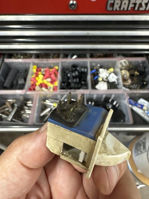

PWL216 1,262 #1 Posted May 18, 2024 Howdy! Anyone have a source for the PTO safety switch pictured? I checked K&B and WPAM and didn’t see anything. Thx! 1 Share this post Link to post Share on other sites

gwest_ca-(File Mod) 12,416 #4 Posted May 19, 2024 What is the original part number of the switch? I believe there is more than one version. 2 Share this post Link to post Share on other sites
wallfish 20,380 #5 Posted May 19, 2024 If you can't find one, or in the meantime until you do, can you just solder a tab on the broken piece or solder the wire directly to it? 3 Share this post Link to post Share on other sites

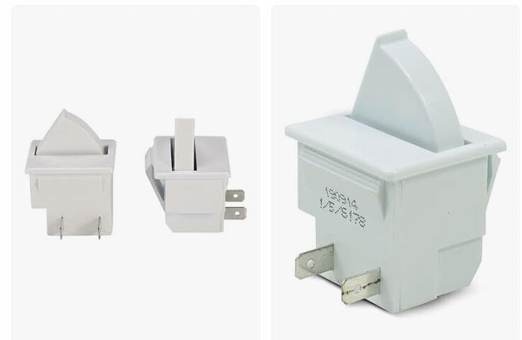

lynnmor 8,970 #6 Posted May 19, 2024 Google appliance door switch. images You may find the one you need that way or do some searching here on the forum. The part you need is an appliance part. 3 2 Share this post Link to post Share on other sites

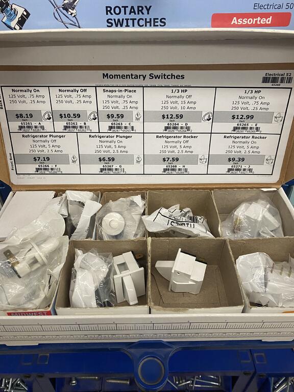

PWL216 1,262 #7 Posted May 19, 2024 1 hour ago, lynnmor said: Google appliance door switch. images You may find the one you need that way or do some searching here on the forum. The part you need is an appliance part. @lynnmor I found the ones pictured below online. They are for a refrigerator. So I thought, now that I know what I’m looking for, I’ll stop at my local hardware store and see if they have any. And they did. Would you happen to know if this is a normally open or normally closed switch? 2 2 Share this post Link to post Share on other sites

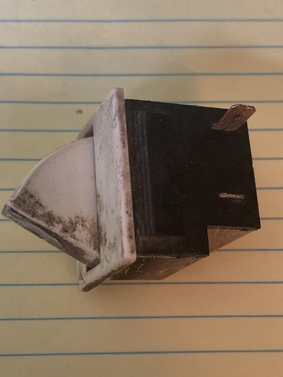

PWL216 1,262 #8 Posted May 19, 2024 3 hours ago, wallfish said: If you can't find one, or in the meantime until you do, can you just solder a tab on the broken piece or solder the wire directly to it? @wallfish The tab is broken internally, I believe. It’s tests as an open circuit with the switch lever in or out. 2 Share this post Link to post Share on other sites
8ntruck 9,174 #9 Posted May 19, 2024 Just an educated guess here, I think that it would be a normally open switch. My sketchy memory says the PTO switch is between the ignition switch and the starter relay. 3 Share this post Link to post Share on other sites
