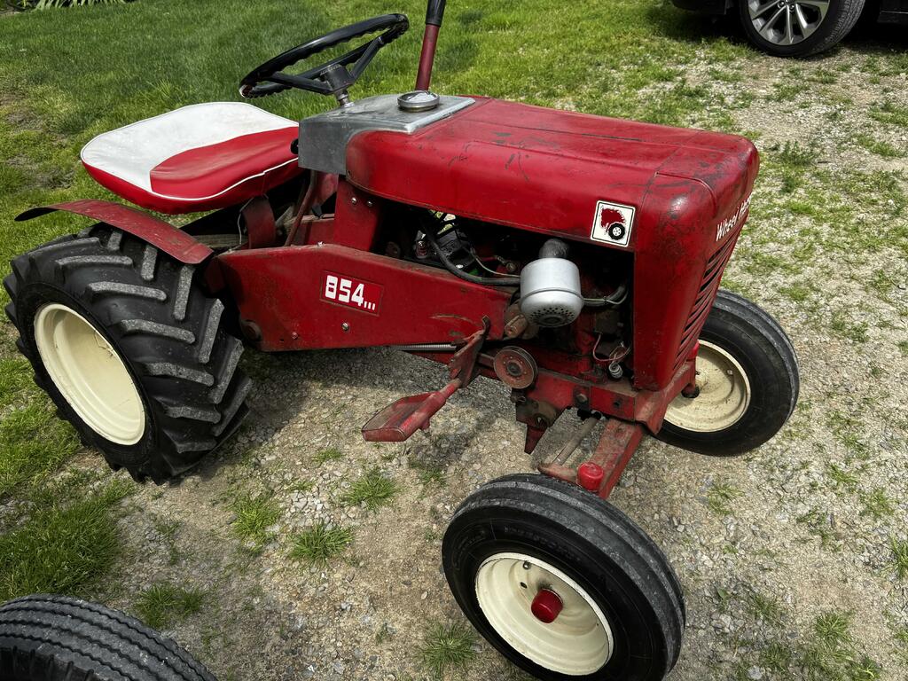

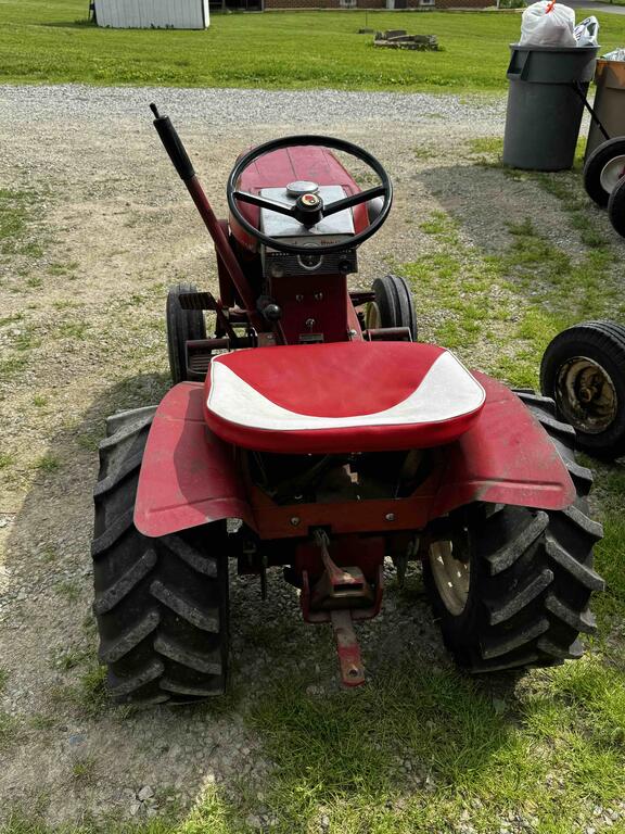

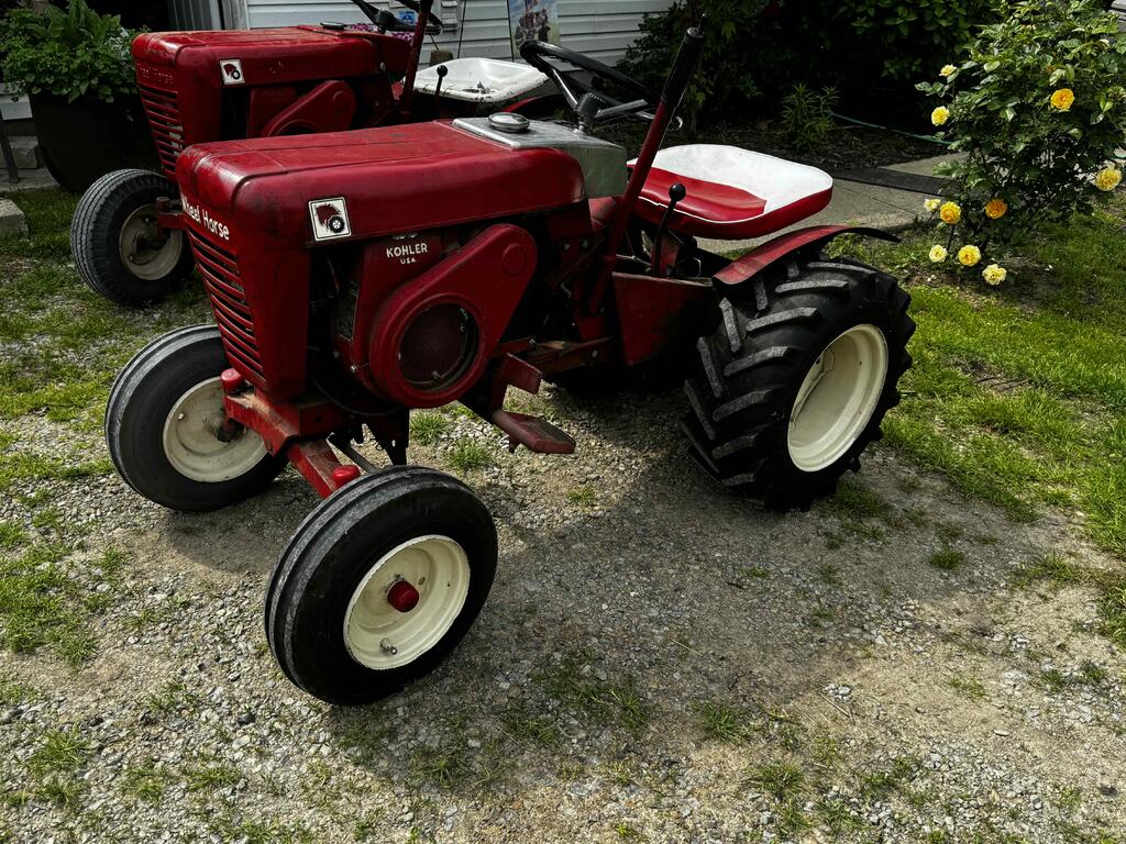

WH1618speed 543 #1 Posted May 15, 2024 Hello, after having this tractor for a few years, it is time for a restore. This will be my 5th complete restore and hoping to make this one my best. This tractor is really straight and runs like a top. Perfect candidate for a restore. 2 11 Share this post Link to post Share on other sites

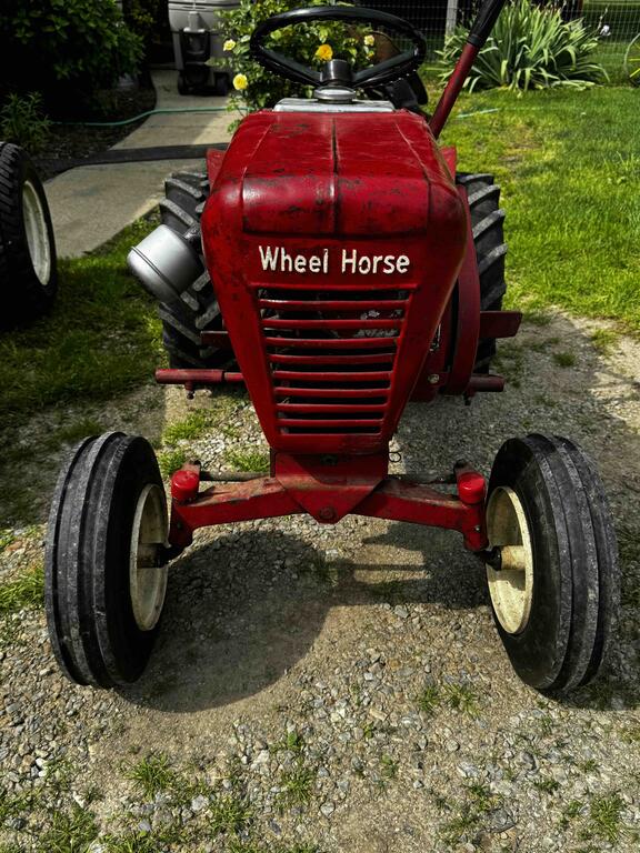

ri702bill 13,394 #2 Posted May 15, 2024 (edited) Nice! One of my favorites. If you are going with the "correct" 1" showerhead muffler, that could be upwards to half the cost of the entire process.... Are the engine and Unidrive coming apart??? Judging by the front wheel toe-out, there may be worn parts there... A nice new set of adjustable Heim end tierods is a nice upgrage... Edited May 15, 2024 by ri702bill 1 Share this post Link to post Share on other sites
WH1618speed 543 #3 Posted May 15, 2024 (edited) 1 hour ago, ri702bill said: If you are going with the "correct" 1" showerhead muffler, that could be upwards to half the cost of the entire process. Already a step ahead of ya! Picked this one up at the Big Show. The threads need retapped, possibly welded. The engine runs absolutely perfectly; Unidrive may come apart at some point. Good suggestions on the tie rods. Edited May 15, 2024 by WH1618speed 1 Share this post Link to post Share on other sites
ri702bill 13,394 #4 Posted May 15, 2024 (edited) Nice - but the raspy "bark" can be annoying - kind of like the noise an ex-wife makes when the check is late....... Why not just weld it all around to a close nipple??? Edited May 15, 2024 by ri702bill 1 3 Share this post Link to post Share on other sites

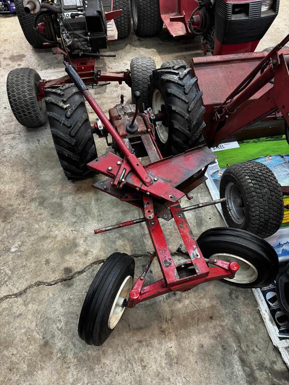

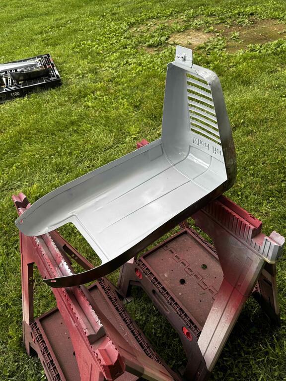

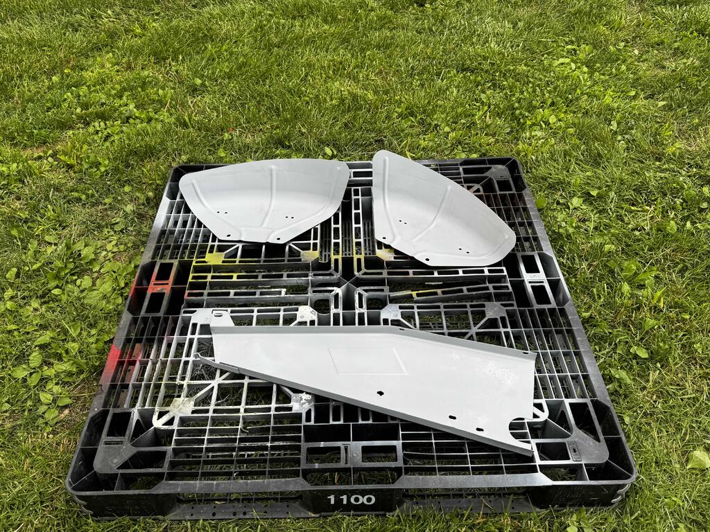

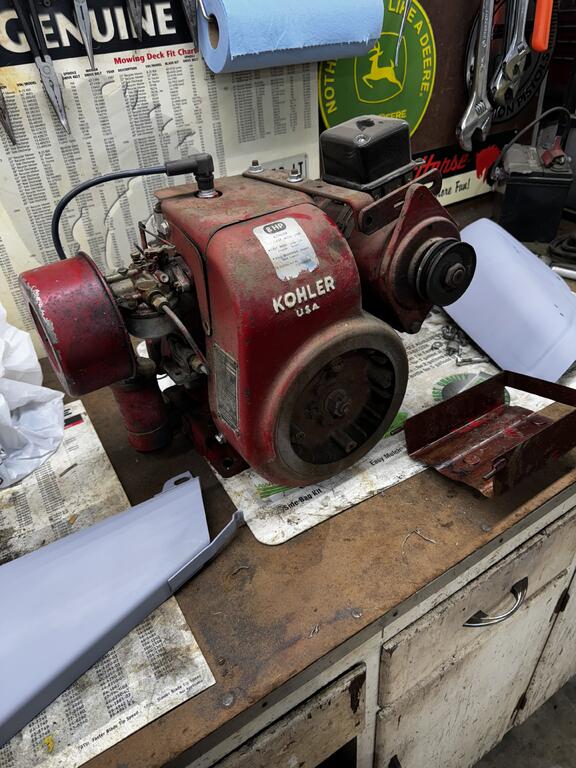

WH1618speed 543 #10 Posted May 19, 2024 (edited) I made some more progress today. I primed the sheet metal, and the tractor was mostly torn down and washed. The goal is to have the whole thing primed by the end of next week. I also ordered all-new 304 stainless hardware! I plan on tearing it the rest of the way down on Monday and sandblasting the frame and cast parts (pedals, foot rest etc.) Hopefully I'll get it done before the Big Show! Pretend that John Deere sign isn't there 😬 Trace Edited May 19, 2024 by WH1618speed 3 5 Share this post Link to post Share on other sites
Pullstart 71,563 #11 Posted May 19, 2024 Might wanna add an alignment to the list of things to do! 1 3 Share this post Link to post Share on other sites

WH1618speed 543 #13 Posted May 19, 2024 6 hours ago, Pullstart said: Might wanna add an alignment to the list of things to do! Yep looks like it needs adjustable tie rods lol 1 Share this post Link to post Share on other sites

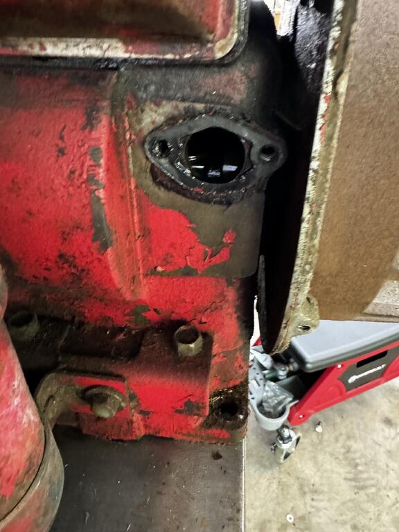

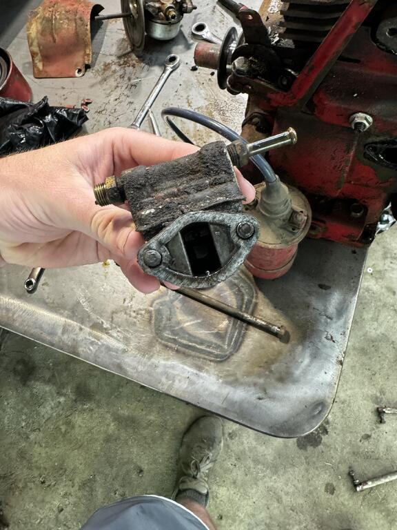

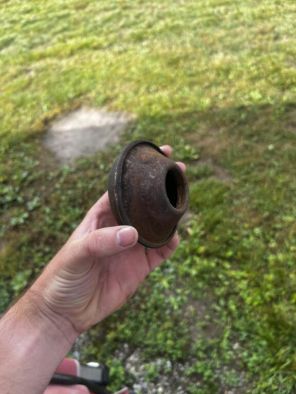

WH1618speed 543 #14 Posted May 20, 2024 Has anyone ever seen this? Is this one of those new bluetooth fuel pumps?? I've never seen one without a push rod for the pump. I am just hoping it didnt fall apart when I took it out. Just want to make sure this is normal. My 702 with the K161 has the pushrod type. Share this post Link to post Share on other sites
rjg854 13,454 #15 Posted May 20, 2024 (edited) That's a pulse fuel pump, common on 8hp engines of that time period. My 854 has one. My 68 Commando 8 has one also. Edited May 20, 2024 by rjg854 Add 3 1 Share this post Link to post Share on other sites
WH1618speed 543 #16 Posted May 21, 2024 2 hours ago, rjg854 said: That's a pulse fuel pump, common on 8hp engines of that time period. My 854 has one. My 68 Commando 8 has one also. Thank goodness lol, I am glad its normal then. Do you know i can get a gasket for it? This one looks different than the mechanical pump. Share this post Link to post Share on other sites
rjg854 13,454 #17 Posted May 21, 2024 I don't believe it's any different than the one with the arm. Share this post Link to post Share on other sites
squonk 48,428 #18 Posted May 21, 2024 Same gasket.Cam has the eccentric if you need to replace the pump with a lever style. Small block Kohler's use an offset lever. Big blocks use a straight line lever. Share this post Link to post Share on other sites
953 nut 70,659 #19 Posted May 21, 2024 13 hours ago, WH1618speed said: Thank goodness lol, I am glad its normal then. Do you know i can get a gasket for it? This one looks different than the mechanical pump. If you are talking about the gasket between the pump and engine block they are all the same. If you are talking about the diaphragm in the pump then they are different. https://www.then-now-auto.com/product/ac-4s-vac-kohler-vacuum-pump-kit/ Share this post Link to post Share on other sites
rjg854 13,454 #20 Posted May 21, 2024 The diaphragm you can get from @buckrancher Share this post Link to post Share on other sites
WH1618speed 543 #21 Posted May 21, 2024 4 minutes ago, 953 nut said: If you are talking about the gasket between the pump and engine block they are all the same. If you are talking about the diaphragm in the pump then they are different. https://www.then-now-auto.com/product/ac-4s-vac-kohler-vacuum-pump-kit/ Alright thanks! 1 Share this post Link to post Share on other sites
953 nut 70,659 #22 Posted May 21, 2024 1 minute ago, rjg854 said: The diaphragm you can get from @buckrancher That is true but if you are going inside a pump you may as well replace the valves too, they tend to accumulate junk and not seat over time. 1 Share this post Link to post Share on other sites

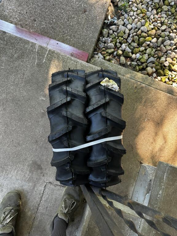

WH1618speed 543 #25 Posted May 31, 2024 Got some new rubber in for the rear! 2 2 Share this post Link to post Share on other sites
