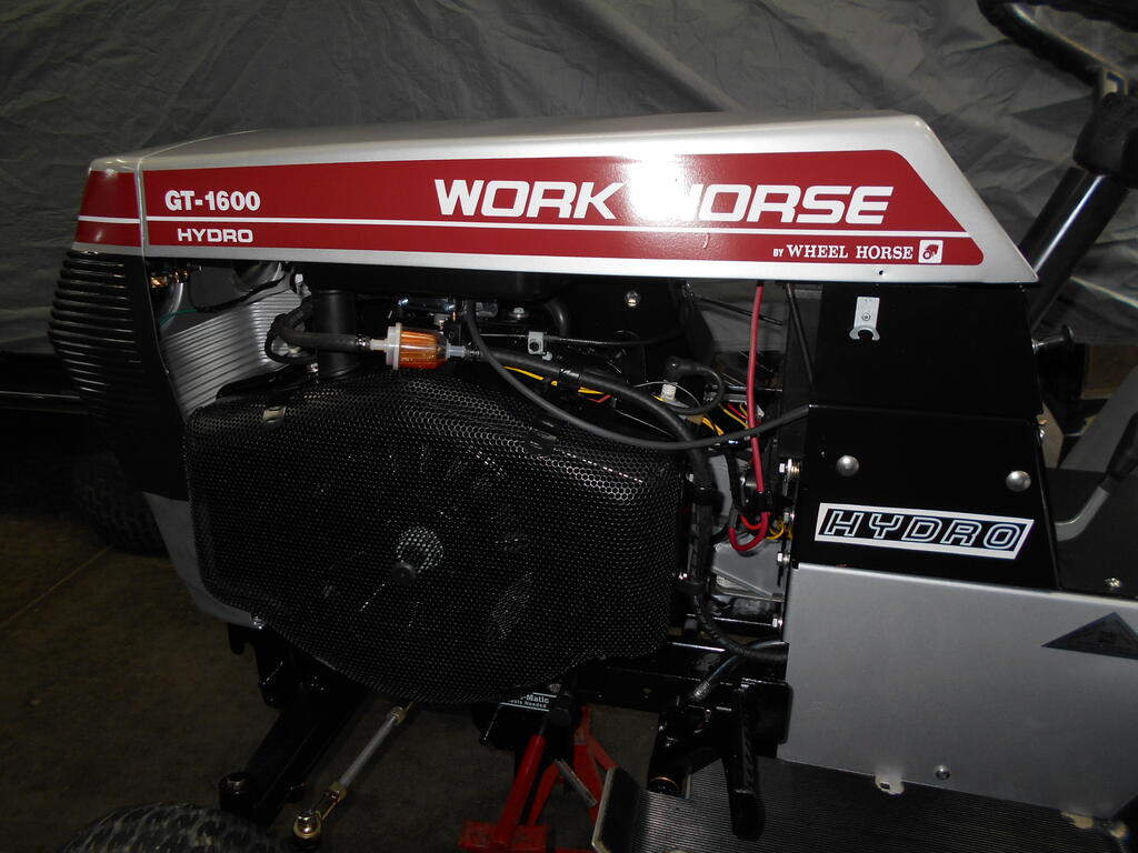

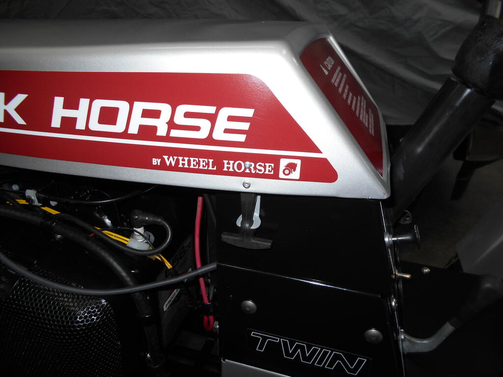

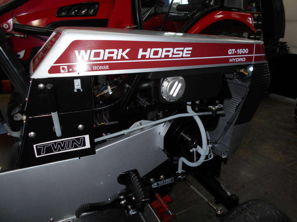

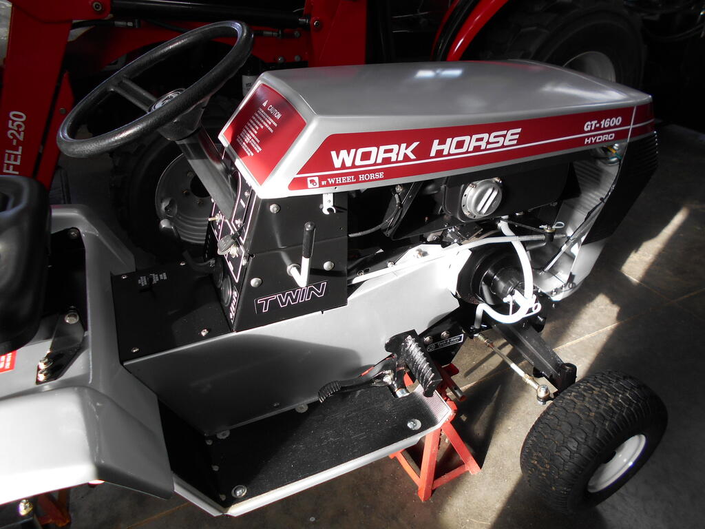

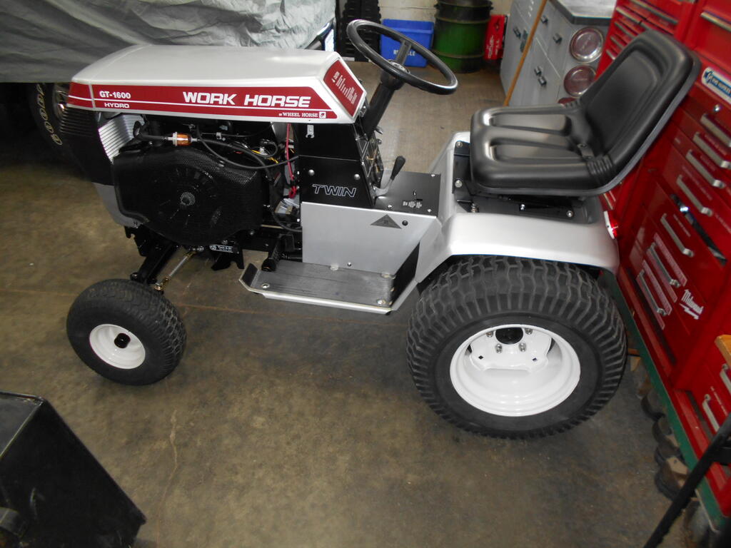

davem1111 2,416 #426 Posted January 7, 2025 12 minutes ago, cleat said: One more vote for all you Work or Wheel Horse experts. Should I use the period correct "TWIN' decal or slightly newer "HYDRO" decal. Keeping in mind the hood decal already says HYDRO I'm no "expert", but everything I've seen has the "TWIN" decal, so I vote for that. 1 Share this post Link to post Share on other sites
SylvanLakeWH 32,710 #427 Posted January 7, 2025 I vote "Twin"... But redundancy experts may disagree... But redundancy experts may disagree... 1 2 Share this post Link to post Share on other sites

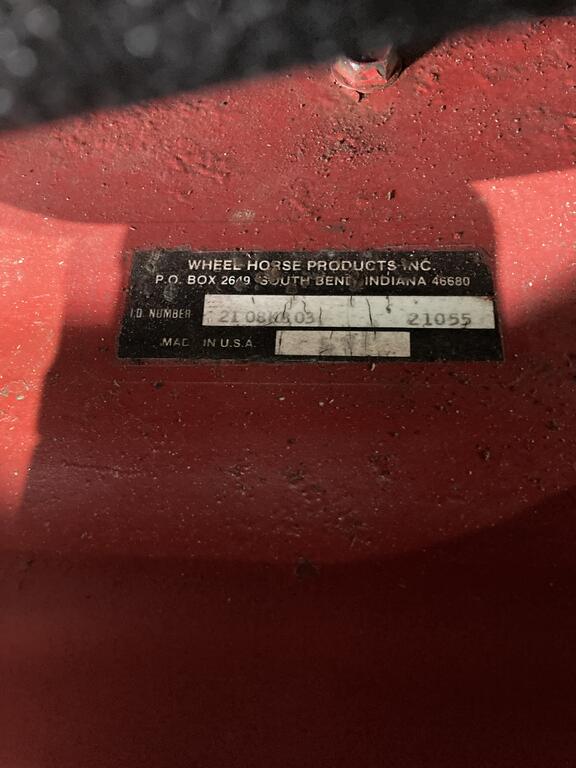

JCM 11,419 #428 Posted January 7, 2025 Checked out the VIN tags. 520= solid with a clear overlay, 312= solid with clear and 417 solid no overlay. There is No space after the first two numbers on all three tractors. Hope this helps @cleat 1 1 Share this post Link to post Share on other sites
Ed Kennell 47,640 #429 Posted January 7, 2025 Twin or single doesn't matter to me. I need HYDRO. 1 1 Share this post Link to post Share on other sites
MainelyWheelhorse 3,146 #430 Posted January 7, 2025 18 hours ago, ebinmaine said: @JCM @MainelyWheelhorse. you got 80s rigs. Thoughts? If your going for originality the bottom one seems more “assembly line” than the top. My 87 308 looks like this. It seems like it’s in between both. 1 Share this post Link to post Share on other sites

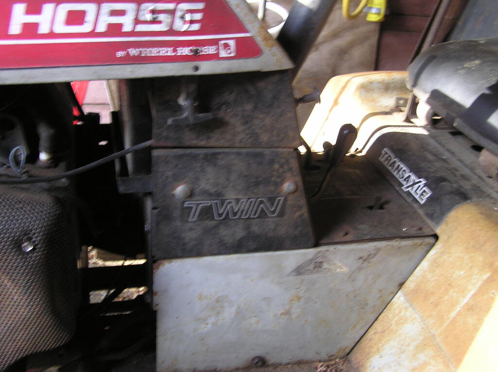

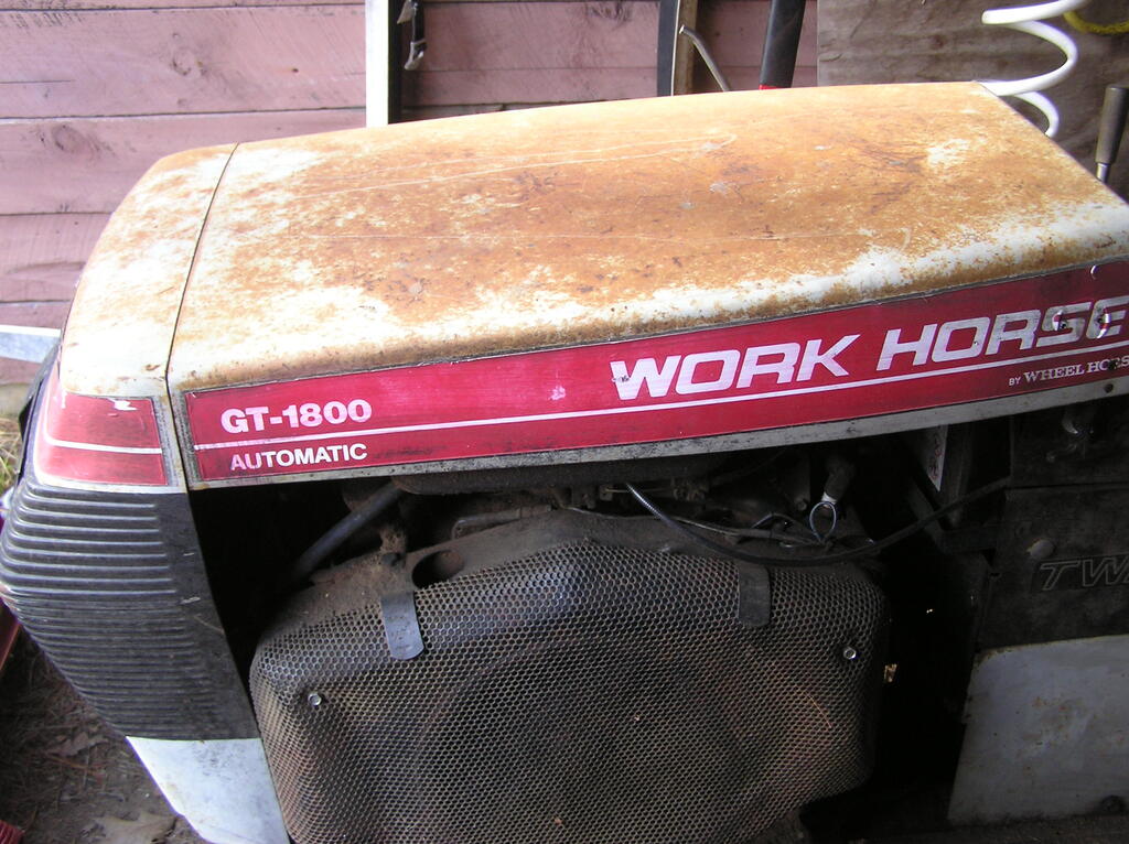

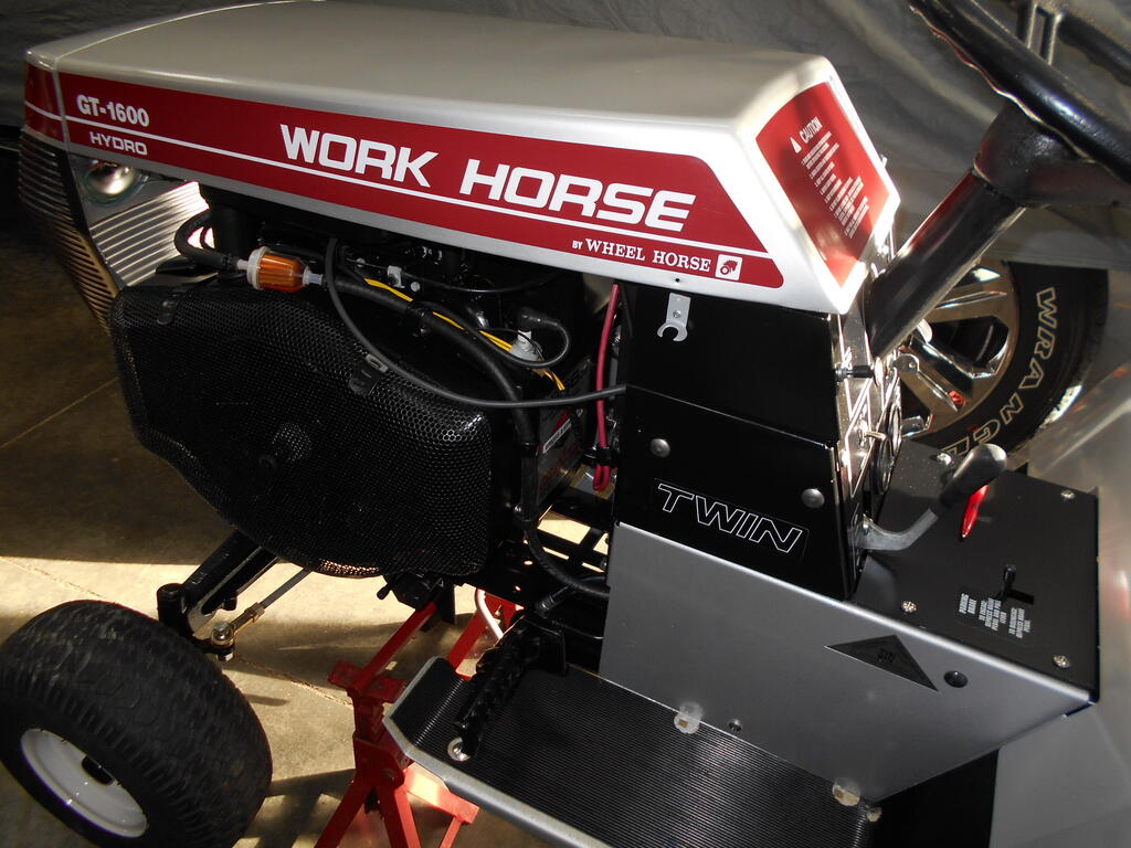

Wayne0 1,659 #431 Posted January 7, 2025 3 hours ago, cleat said: One more vote for all you Work or Wheel Horse experts. Should I use the period correct "TWIN' decal or slightly newer "HYDRO" decal. Keeping in mind the hood decal already says HYDRO. Ole' Rusty says "Automatic" and "Twin" 2 1 Share this post Link to post Share on other sites
cleat 9,389 #432 Posted January 7, 2025 1 hour ago, MainelyWheelhorse said: If your going for originality the bottom one seems more “assembly line” than the top. My 87 308 looks like this. It seems like it’s in between both. Originality isn't really important as this machine is far from original. My wife likes the dotted one VS the solid. I am still unsure. Share this post Link to post Share on other sites
cleat 9,389 #433 Posted January 7, 2025 Well, between general consensus, my opinion, and my wife's vote I decided on the TWIN decals. 4 Share this post Link to post Share on other sites
MainelyWheelhorse 3,146 #434 Posted January 7, 2025 (edited) 15 minutes ago, cleat said: Originality isn't really important as this machine is far from original. My wife likes the dotted one VS the solid. I am still unsure. You could always put one on and see how you like it. If you don’t, try the other and see how that looks. Edited January 7, 2025 by MainelyWheelhorse 1 Share this post Link to post Share on other sites
cleat 9,389 #435 Posted January 7, 2025 48 minutes ago, Wayne0 said: Ole' Rusty says "Automatic" and "Twin" Yes, TWIN it is. Thanks for the great pictures of ole rusty. 4 Share this post Link to post Share on other sites

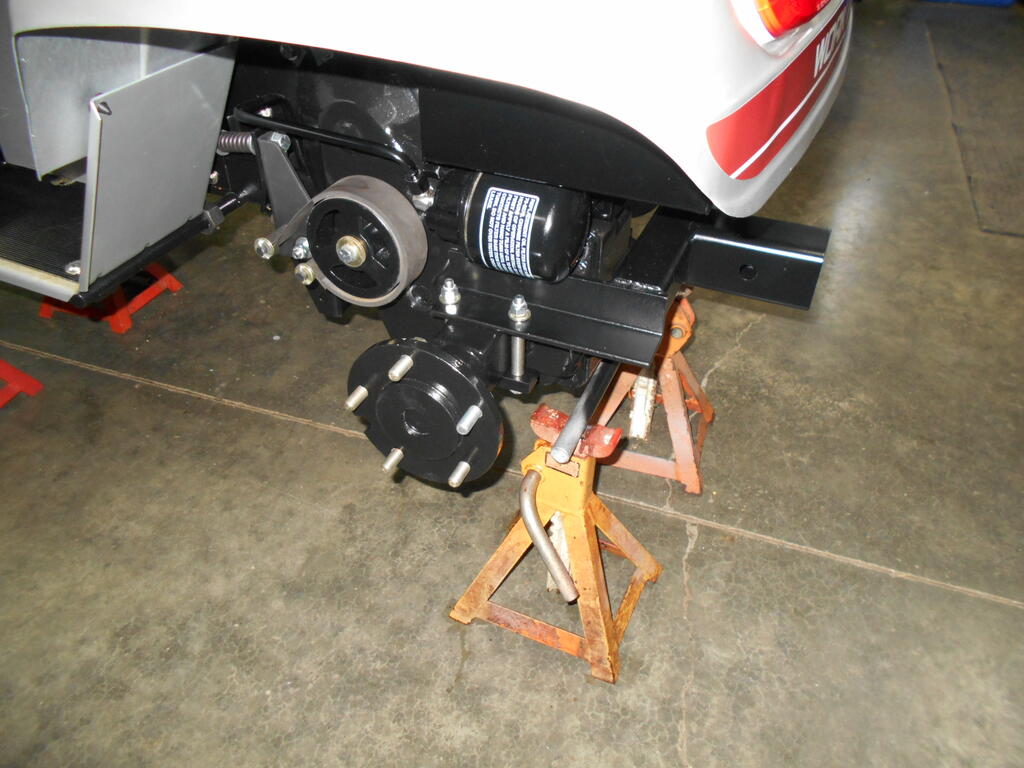

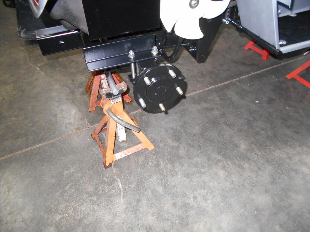

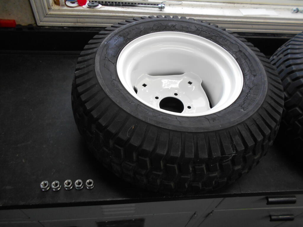

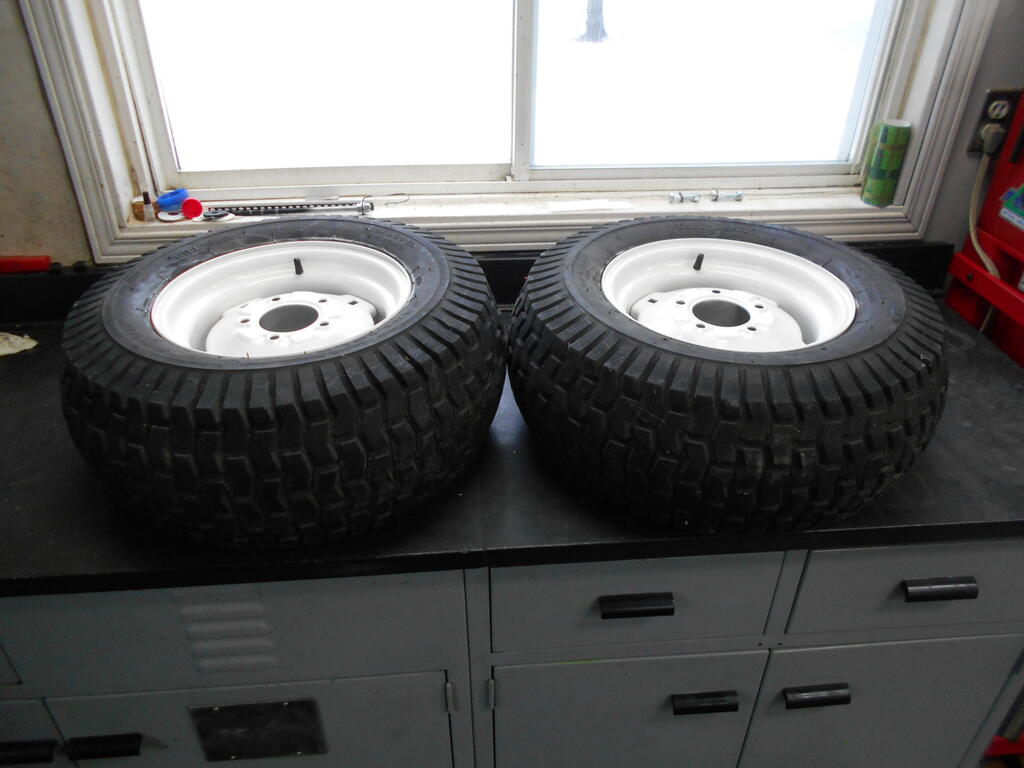

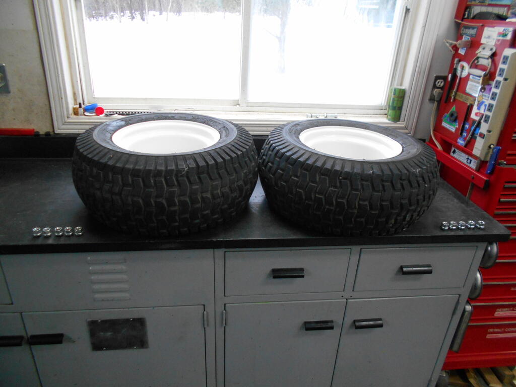

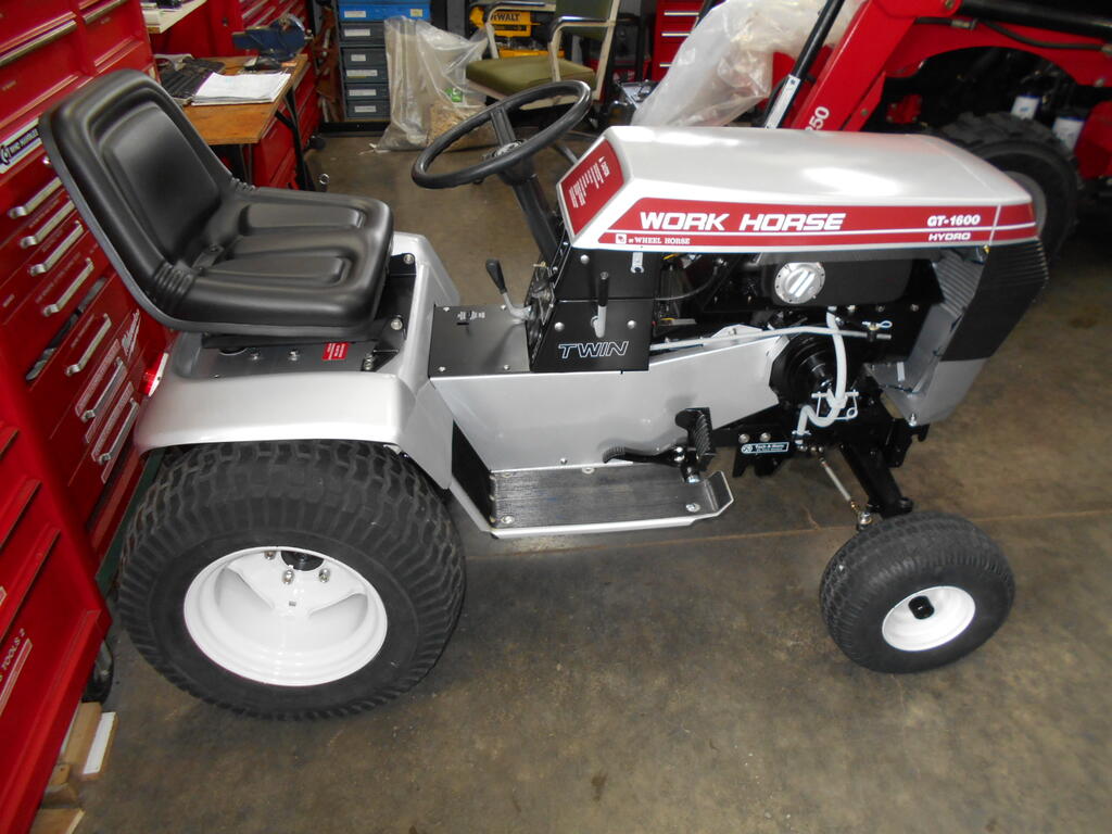

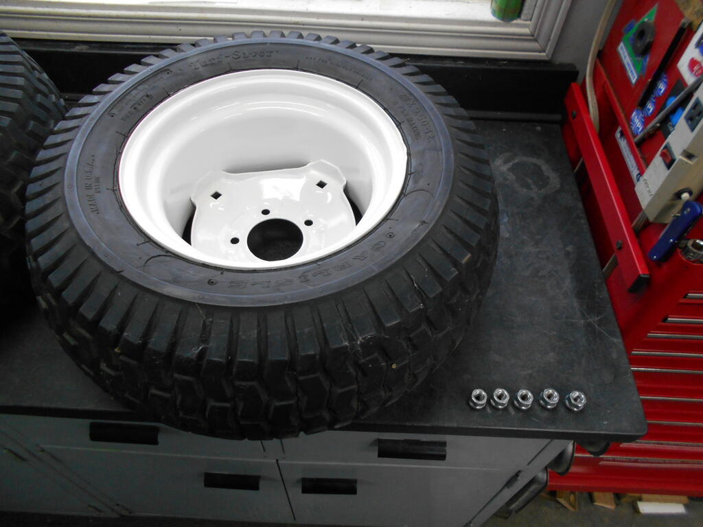

cleat 9,389 #436 Posted January 8, 2025 Rear wheels ready to install. Rear hubs ready for wheels to be installed. 3 2 Share this post Link to post Share on other sites

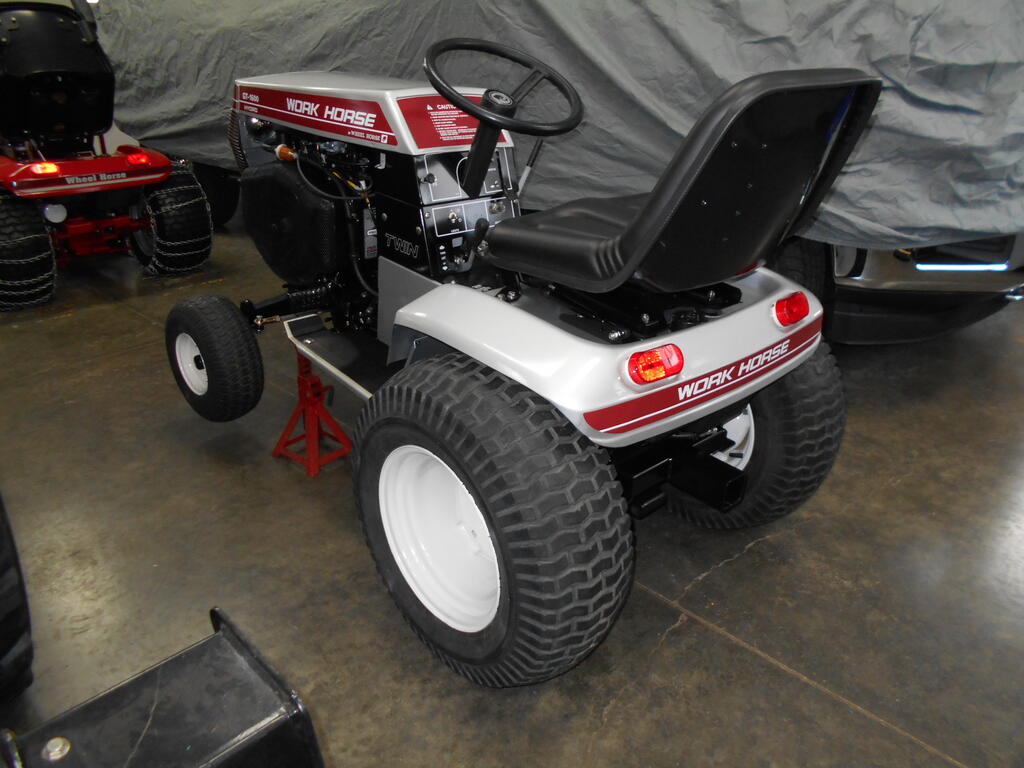

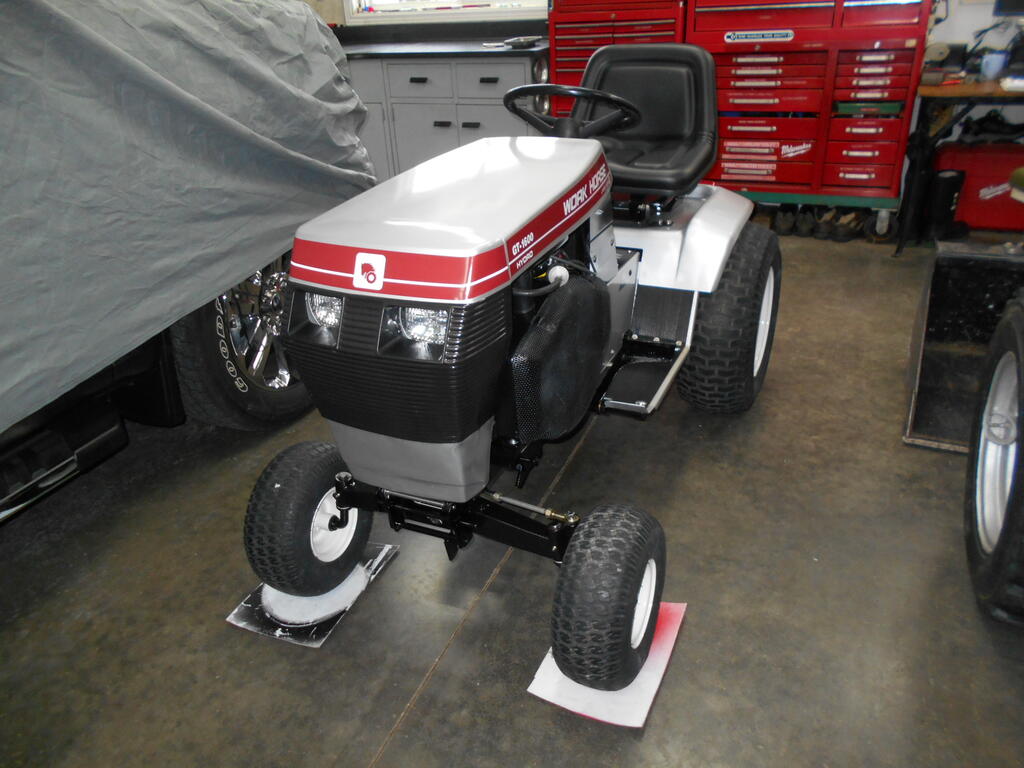

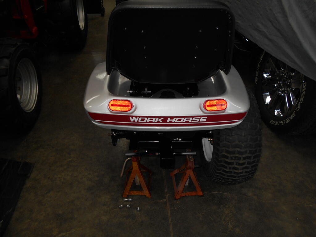

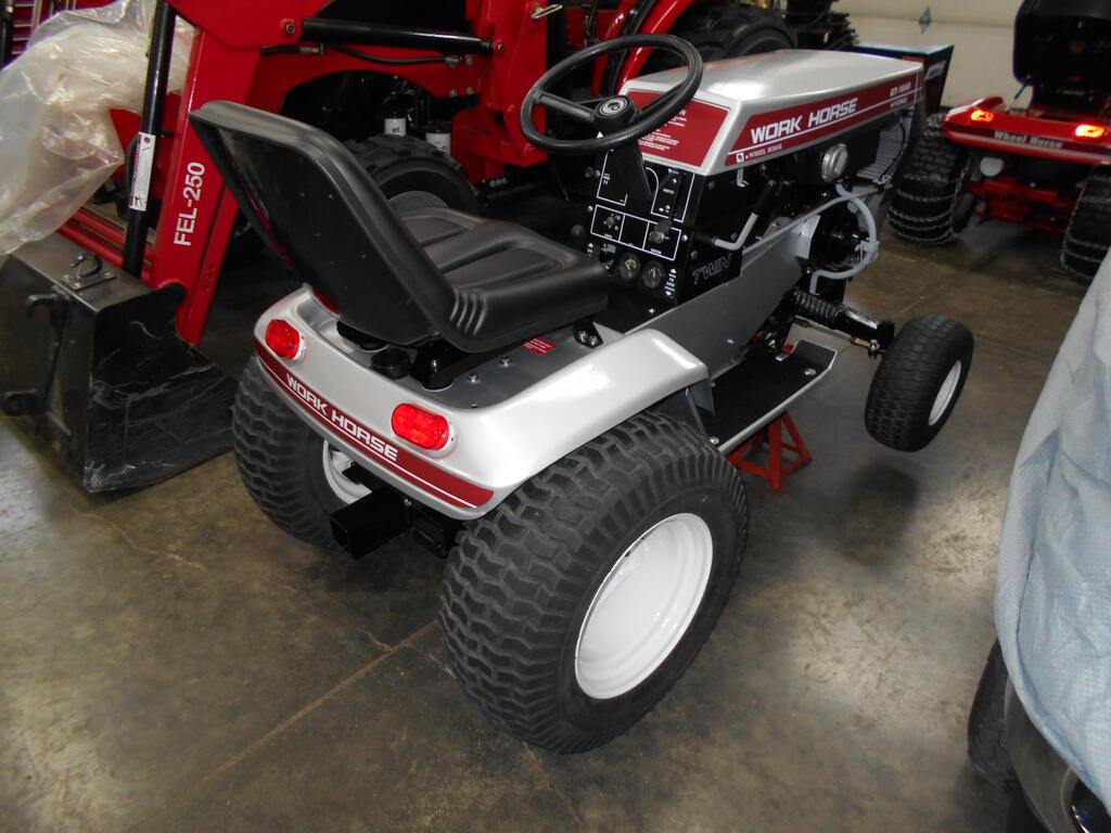

cleat 9,389 #437 Posted January 8, 2025 One rear wheel installed. Rear wheels both on the ground. Front end down. Tractor is officially a roller ! Front tires are sitting on pieces of Teflon to aid in front end alignment that is coming next. 3 4 Share this post Link to post Share on other sites

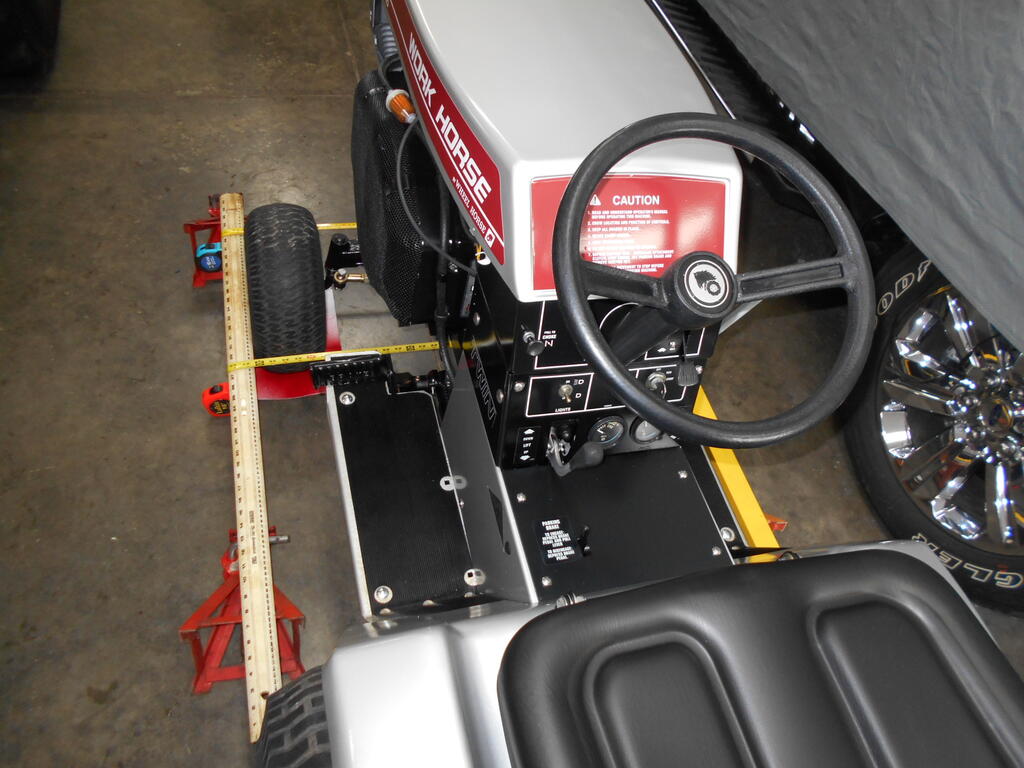

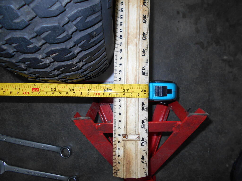

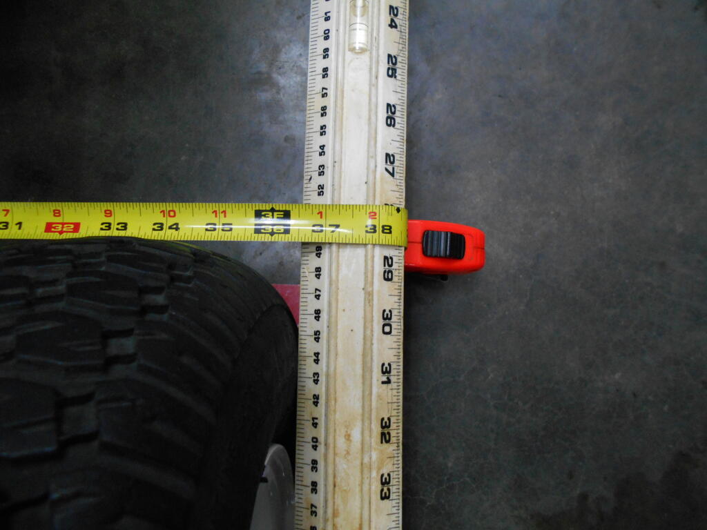

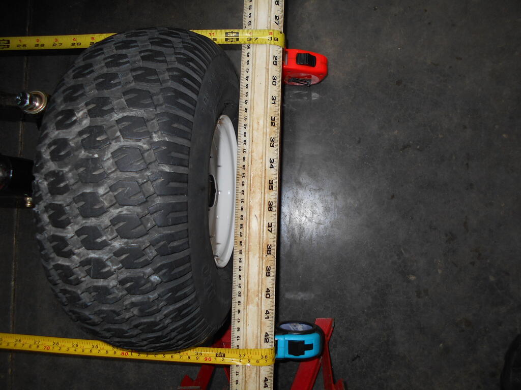

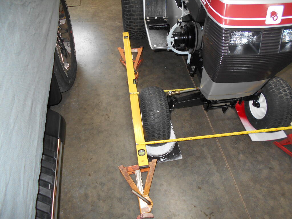

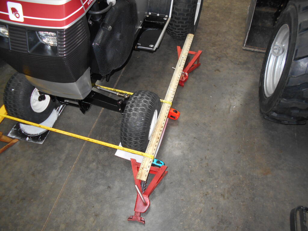

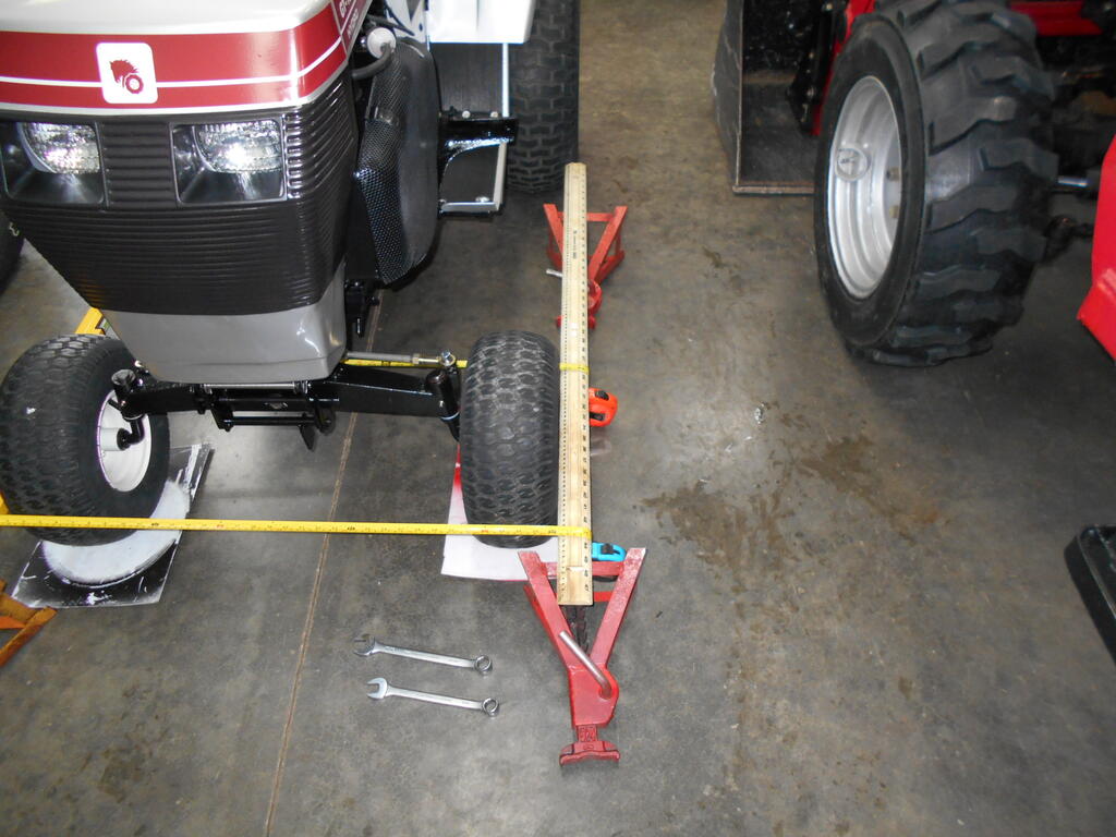

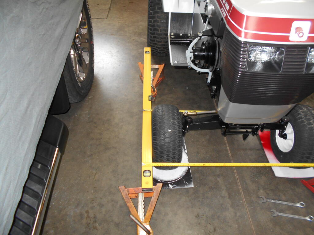

cleat 9,389 #438 Posted January 8, 2025 Set up to do front end alignment. Two straight edges set up at mid-point of front wheels extending almost back to rear wheels. Steering wheel set straight and two measuring tapes (verified to have the same measurements) set up on straight edges. Front end alignment complete at least for now. Steering wheel is straight, there is around 1/4" toe from front to rear of tires which should be close to 1/8" at wheels as the manual states. Also, straight edges are in about the same amount at the rear wheels. A test drive on a flat surface will verify tractor tracks straight and steering wheel is also straight. Tractor looks like this now. 1 11 Share this post Link to post Share on other sites
cleat 9,389 #439 Posted January 8, 2025 A quick before and after pic. 1 8 Share this post Link to post Share on other sites

cleat 9,389 #444 Posted January 8, 2025 My Wife Krista took these pictures of me posing with my newest baby. 1 12 Share this post Link to post Share on other sites
SylvanLakeWH 32,710 #445 Posted January 8, 2025 Outstanding job!!! Thank you for the meticulous detail! 2 1 Share this post Link to post Share on other sites

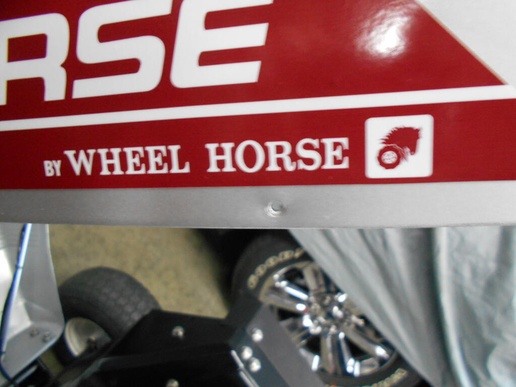

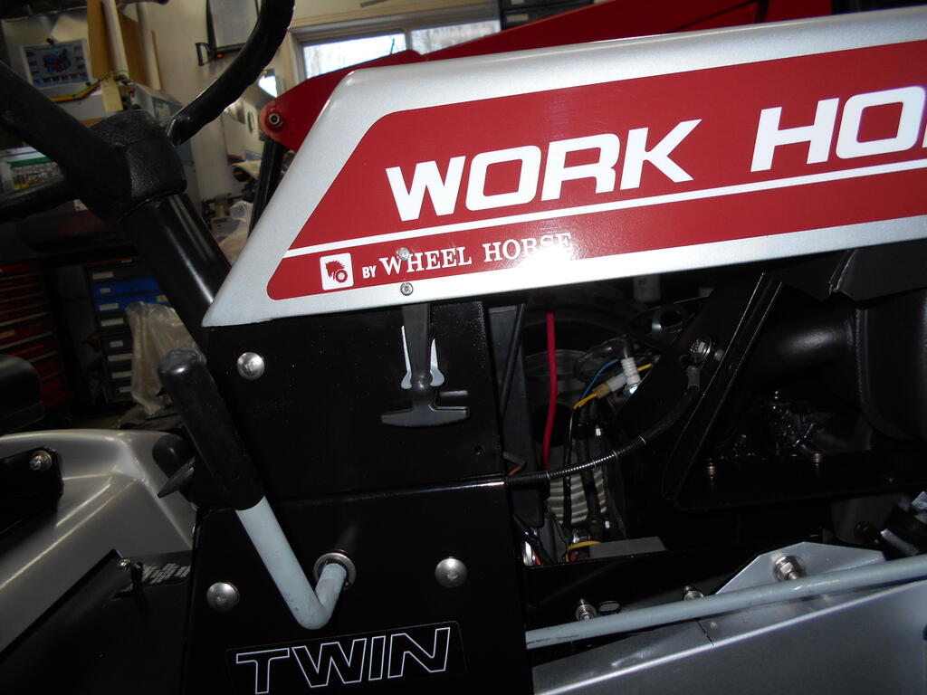

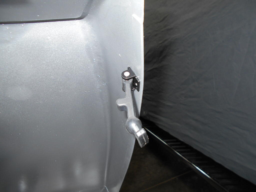

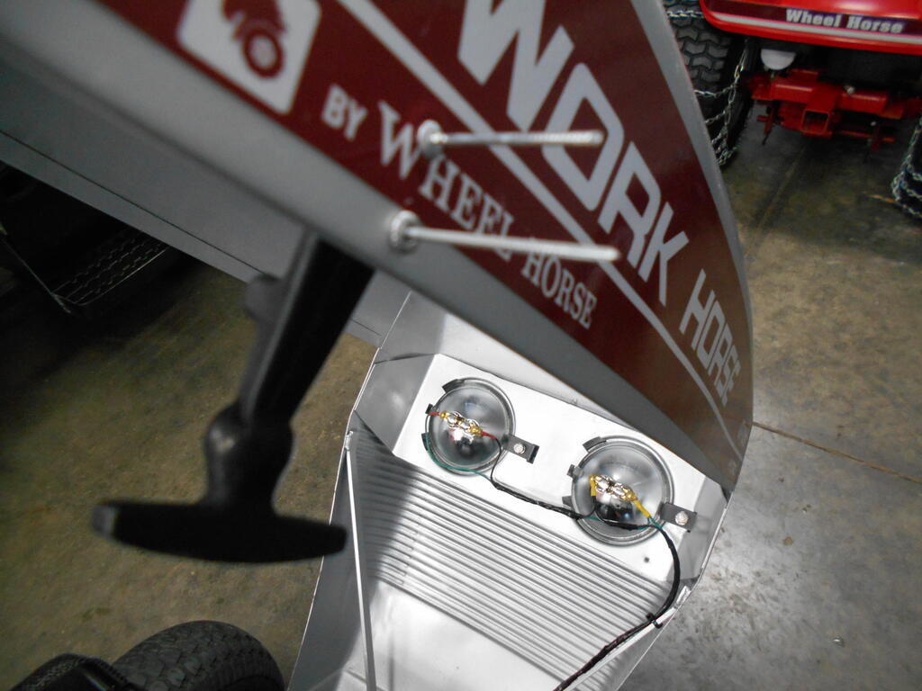

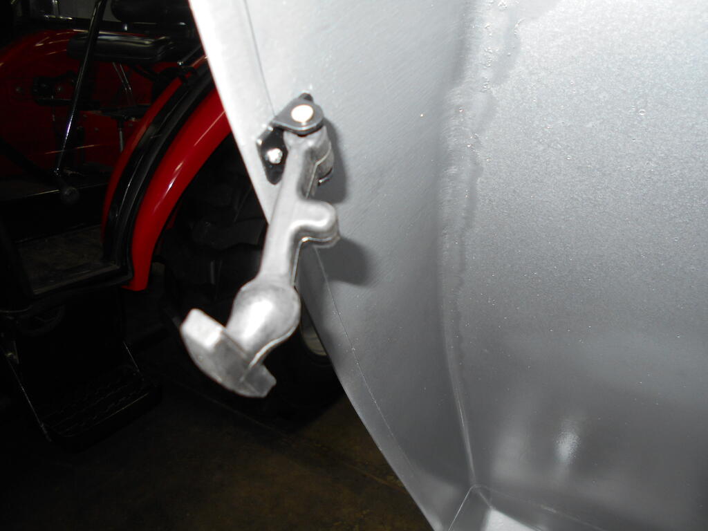

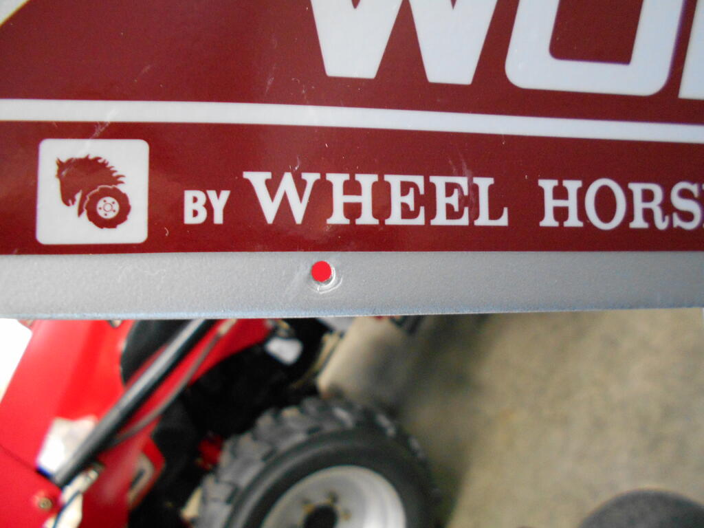

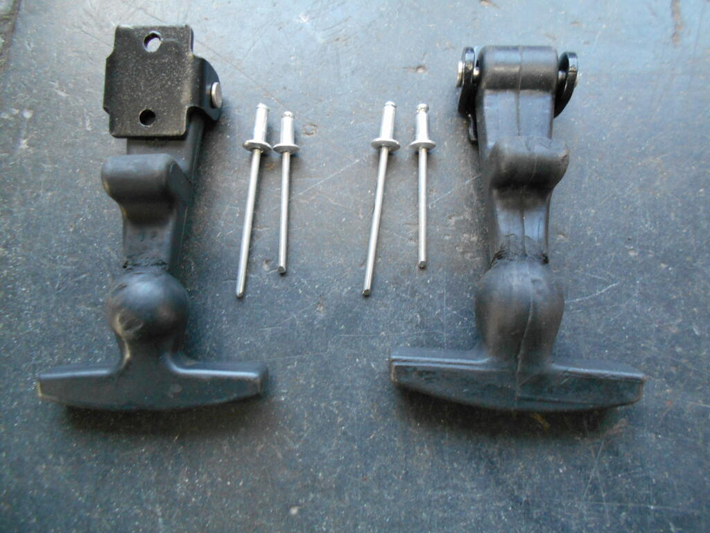

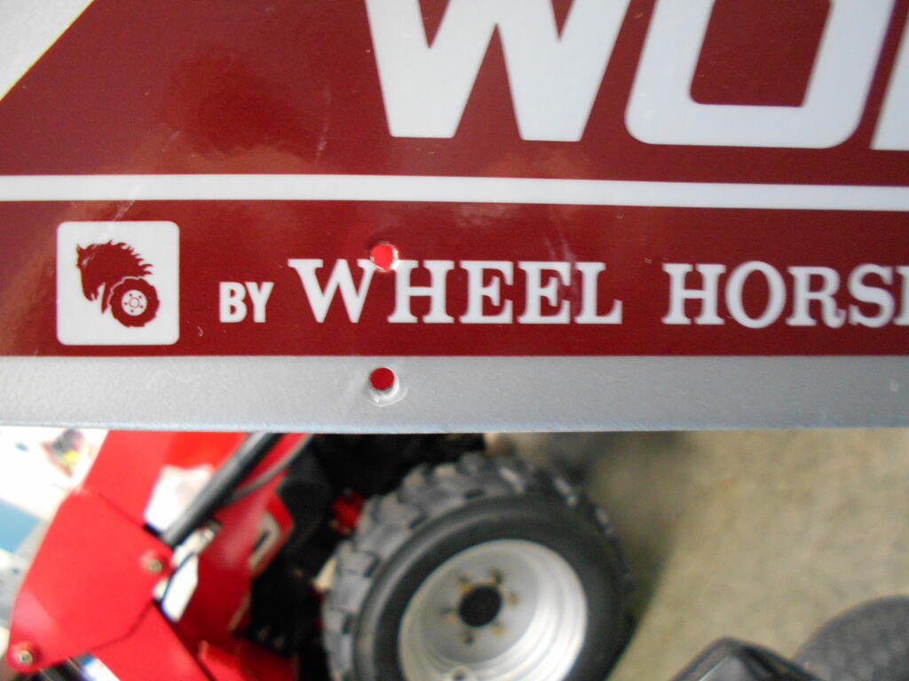

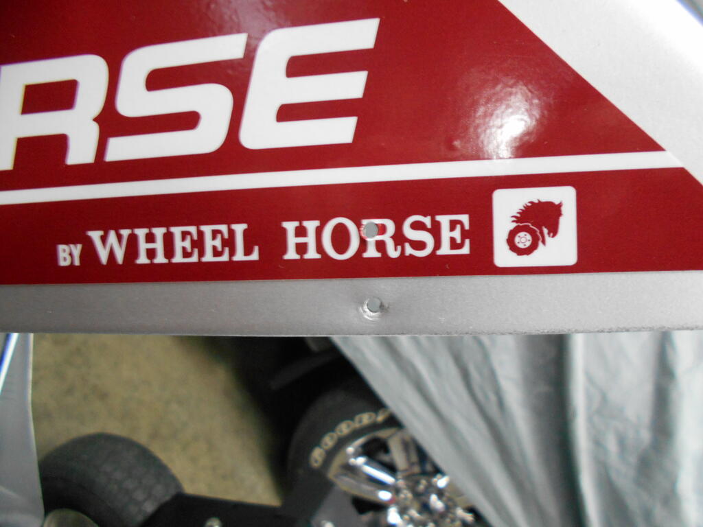

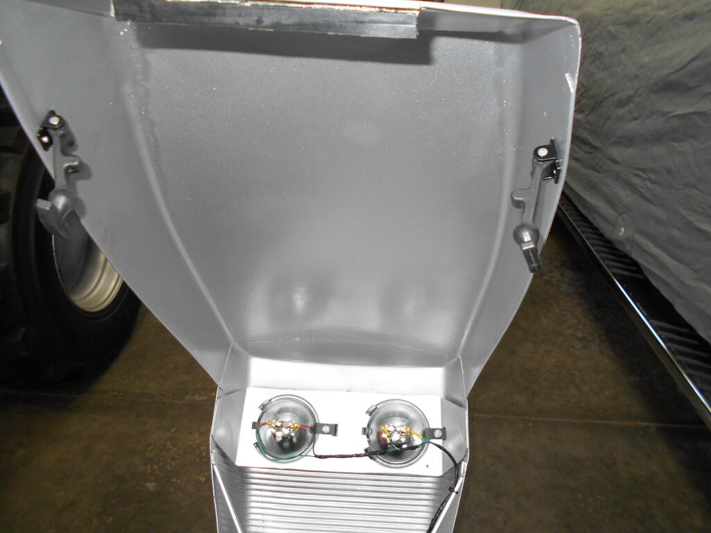

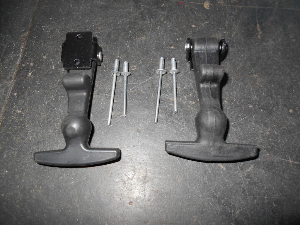

cleat 9,389 #450 Posted January 9, 2025 (edited) Hood latches ready to install. Upper rivet is 0.232" long and lower rivet is 0.294" long. This is from the manual. Hood showing lower rivet hole. Upper hole is covered by the side decals. Upper rivet hole punched out by a sharp awl. A flashlight behind the hood shining through the hole made it easy to locate. Right side hood latch partly installed. I get both rivets just partly tightened to ensure proper alignment then fully tighten and "pop" them. Right side hood latch complete. Left side hood latch complete. Both hood latches installed. Edited January 9, 2025 by cleat 3 Share this post Link to post Share on other sites
