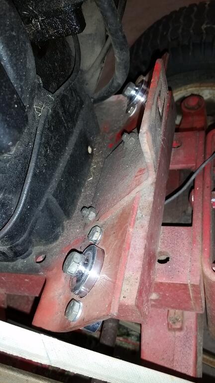

Retired Wrencher 6,449 #1 Posted May 13, 2024 I have the shaker plate now, but I have known people converting them to standard mount for the engine block. I do have a blown engine with a standard oil bath that I would like to convert. Do you think if it bolts up you are good or is it in the depth of the oil pan depth and withed or how wide it has to be? And maybe mounting holes are different? Worse thing Kohler ever came up with. Thanks for any info. Again I have herd this done before. Share this post Link to post Share on other sites

WHX?? 54,980 #5 Posted May 14, 2024 (edited) Not sure if you can use a eared base on a shaker plate small block frame either. Pull the shaker plate mounting V blocks and see if a eared block has mounting holes in the frame that line up. I can get you the dims for the eared small block base if you need them. Sounds like you have the eared base motor tho. Solid shaker plate mounts are always an option. Edited May 14, 2024 by WHX?? Share this post Link to post Share on other sites
wallfish 19,299 #6 Posted May 14, 2024 8 hours ago, Retired Wrencher said: John I pick this C81 up from Tony last week as an inexpensive project and been going thru it and he also had a blown engine I also bought from him for spare parts. Just thought maybe I could switch oil pans? Thanks for the reply. If the depth of the oil pans are the same, it will work. The issue with changing oil pans would be the oil dipper on the bottom of the rod. If the depths are the same the oil dipper will work to splash and not make contact with the pan. Share this post Link to post Share on other sites

Retired Wrencher 6,449 #8 Posted May 15, 2024 18 hours ago, WHX?? said: Not sure if you can use a eared base on a shaker plate small block frame either. Pull the shaker plate mounting V blocks and see if a eared block has mounting holes in the frame that line up. I can get you the dims for the eared small block base if you need them. Sounds like you have the eared base motor tho. Solid shaker plate mounts are always an option. @WHX?? Thanks for the post. I think I am just going with the solids and be done with it. I will keep the blowen engine for parts.. 1 Share this post Link to post Share on other sites

WHX?? 54,980 #10 Posted May 15, 2024 1 hour ago, Retired Wrencher said: @WHX?? Thanks for the post. I think I am just going with the solids and be done with it. I will keep the blowen engine for parts.. Your welcome ... two sources for mounts. @Shynon makes them and sells them through https://wheelhorsepartsandmore.com/product/engine-mounts-for-wheel-horse/ and Kirk machine. If you want to really keep the price down @Ed Kennell uses stacks of washers which works too. 1 1 Share this post Link to post Share on other sites

Lee1977 7,553 #12 Posted May 15, 2024 (edited) I think the holes are there for the big base WH Kohlers 10.12, 14 ,and 16 HP to bolt down.. But then I have never seen the frame of 79 thru 84 frame. The frame number is the same for the 1979 C-81 and C-121 ( frame number 106229 ) The hole between where the shaker plate strips are the ones for the big base Kohlers. The holes on flywheel sife are ferther apart then the one that come up from the bottom. Edited May 15, 2024 by Lee1977 Share this post Link to post Share on other sites
