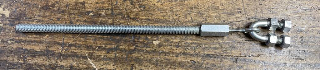

formariz 12,381 #27 Posted May 14, 2024 7 hours ago, ebinmaine said: How do you attach at the ends? One easy way is as per photo below. Just to illustrate the types of fasteners not having the correct sized ones at hand. One half illustrated the left end of rod having a turnbuckle preferably a long one. U bolt should be long enough to allow unobstructed tightening of turnbuckle. Mount u bolt with legs across shelf grain and not along it using nuts and washers on both sides. In this system shelf should be loosely resting on end supports so it does not restrict flexing. I usually only screw it loose on predrilled oversized holes just so shelf cannot be brought forward accidentally. 2 1 Share this post Link to post Share on other sites
