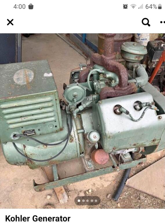

RetroMower 350 #1 Posted May 10, 2024 I've wanted a wisconsin air cooled 4 cylinder engine for a while for a hairbrained project and I found one that's not 5 million dollars. It's a Kohler generator powered by a wisconsin 4 cylinder but it's running off propane. My question for you fine folks is were these dedicated propane specific engines or were they converted and if they were converted, how difficult is it to make them a gasoline engine again? Share this post Link to post Share on other sites
ebinmaine 75,740 #2 Posted May 10, 2024 Food for thought. Not to discourage, but to encourage plenty of research. If you're considering removing the generator from the engine you should be aware that ~some~ generator sets use the engine crankshaft as the mainshaft. One continuous piece. Others have a two piece main shaft but will NEED to be balanced by a professional engine shop or it will destroy the engine. Because it's a Kohler generator powered by a Wisconsin engine one would think it was separable. Personally, I find it interesting and odd that a manufacturer who made their own engines would use that of the competition. If there's a way to get a Spec number from the ENGINE then maybe you could determine if the original build was for gasoline, propane, or flex. That was common even then. 3 Share this post Link to post Share on other sites
Pullstart 68,521 #3 Posted May 10, 2024 @Achto… Propane runs a higher compression. The heads have smaller chambers generally. You can run LP heads in gasoline applications, but you may find you need higher octane fuel. Timing may be set differently, but it is able to be changed. In high school, I had an S10 Blazer mud truck with a 366 tall deck big block Chevy that ran on propane. I read that I could get 15% more power by converting it to gas. I had it blown up within a day or two of my “conversion” by tosssing a 4 bbl carb on and running it. 3 Share this post Link to post Share on other sites
RetroMower 350 #4 Posted May 10, 2024 Hmm engine crank and genny might be one piece... Never considered that but that why I brought this question here to folks that know their stuff. I sent a message for the motor ID plate before I get my hopes up further. 1 Share this post Link to post Share on other sites
Pullstart 68,521 #5 Posted May 10, 2024 (edited) 10 minutes ago, RetroMower said: Hmm engine crank and genny might be one piece... Never considered that but that why I brought this question here to folks that know their stuff. I sent a message for the motor ID plate before I get my hopes up further. Many times whoever, the crank is a tapered end shaft and a snug (press like) fit. I tagged Dan, and he’ll get here eventually. He works at a big genny manufacturer blowing up new ideas in the R&D lab. He’ll know. Edited May 10, 2024 by Pullstart 3 Share this post Link to post Share on other sites

Achto 30,191 #8 Posted May 10, 2024 (edited) Being that this is a Wisconsin engine mated with a Kohler generator, the likely hood of the crank & gen shafts being one piece is low. I would venture to say that it will have a tapered end on the crank shaft. Don't know for sure without taking it apart. Also not a big issue thanks to adaptors from taper to keyed shafts. A far as converting it to gasoline - It looks like they simply plumbed the LP into the intake and used the original carburetor to meter the air. Simple task when you only plan to run the engine at one speed, as you would do with a generator. The original carb might still work if you plumbed gas to it. The timing may have to change but they might have just left it as it was. We used to convert Vanguard engines to LP, all we did was add a plate under the carb to give a place to plumb the LP in. Did not change anything else on the engine. Kohler LP engines came with different heads & flywheels. The different fly wheel was to change the timing. The heads had harden valve seats & higher compression, but still used a basic plate under the carb to get LP in. Design variables on the Wisconsin are unknown to me, sorry. Edited May 10, 2024 by Achto 4 Share this post Link to post Share on other sites
