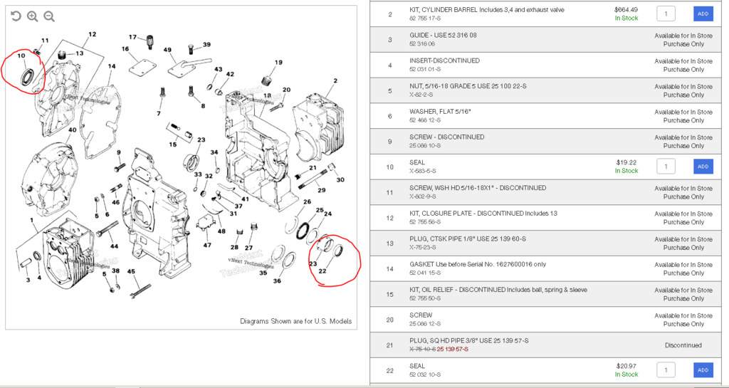

greyhound 7 #1 Posted May 9, 2024 Hello, Having big trouble trying to find the crank oil seal for me 1987 wheel horse. model M18 QS 24510. Seal number is 52 032 12S. Not available. nice. Took off the fly wheel and the seal says singapore BE1177E. Have not found it any where. Napa gave me a number 14768 cant find it either. Seen a guy with cub cadet M20 and he was searching for same number of a seal also. Go to jacks small engines and a few other websites and they have a part number 22 and it comes down to 52 032 10S. Went to amazon and a guy sell oil seals. sent him my info and said OUT of production. So that means I am out of luck again. I have 3 M18s and wont be able to get oil seals. Any ideas people? Any cross reference numbers any where? Thanks Rick Share this post Link to post Share on other sites

Wild Bill 633 884 #4 Posted May 9, 2024 According to the SEPW website, the Kohler M18-24510 crank seal is P/N 52 032 10-S, $18.13. 1 Share this post Link to post Share on other sites
JoeM 8,870 #5 Posted May 9, 2024 Looks like both seals are available Kohler. and on ebay too 2 Share this post Link to post Share on other sites
