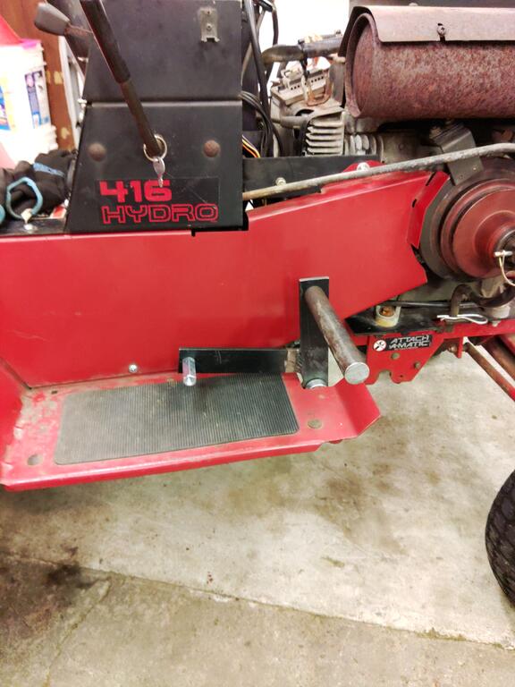

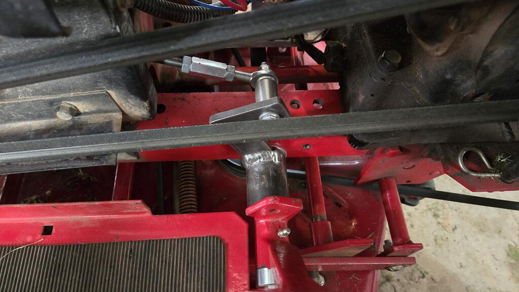

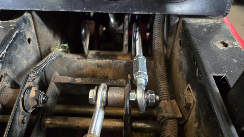

davem1111 2,314 #9 Posted May 8, 2024 11 hours ago, HVYTWR said: Otherwise I'll try to build my own, I already have a brake pedal from an 8 speed on hand. Welcome to the forum! I have managed to build my own pedal motion control, as a few others here have. It still needs some adjustments (mainly that my leg is too short so I need to add a block or something to the pedal...) but it works (admittedly, it's not pretty ). Using an actual WH brake pedal from an 8 speed would look much nicer, for sure. You would need to make some modifications to your belt guards to do it the way I did though, at the least. I'll probably post some newer pictures here soon, when I have some more time to mess with it: 11 hours ago, HVYTWR said: My tractor also had a tiller on it which I'm not sure am going to keep so that might be coming up for sale soon! Wish you were closer - I'd love to get one of those.... Share this post Link to post Share on other sites

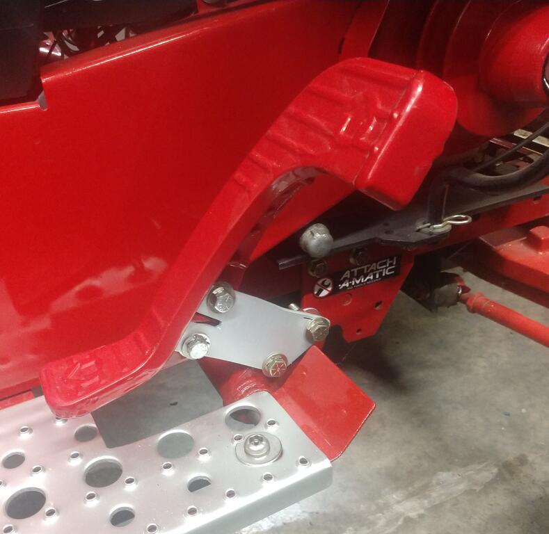

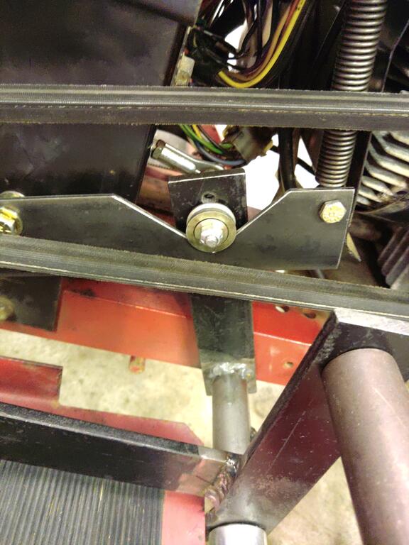

Bill D 3,099 #14 Posted May 8, 2024 I've built two different styles of foot pedal control for my hydros. The build threads should be in the modification section. I'm not sure how to add links. I definitely prefer the foot pedal control. I built mine with automatic return to neutral. 2 1 Share this post Link to post Share on other sites

kpinnc 18,884 #18 Posted May 8, 2024 2 hours ago, Bill D said: I built mine with automatic return to neutral I did not. The left pedal will return the pedal to neutral. Also, if you drop the friction on the cam plate to a comfortable level, the hydro returns to neutral by itself. It's a preference, and I certainly understand that. Bill's design for it is likely the nicest you will find. Share this post Link to post Share on other sites

Bill D 3,099 #20 Posted May 8, 2024 2 hours ago, kpinnc said: I did not. The left pedal will return the pedal to neutral. Also, if you drop the friction on the cam plate to a comfortable level, the hydro returns to neutral by itself. It's a preference, and I certainly understand that. Bill's design for it is likely the nicest you will find. Thanks for the compliment! 1 Share this post Link to post Share on other sites

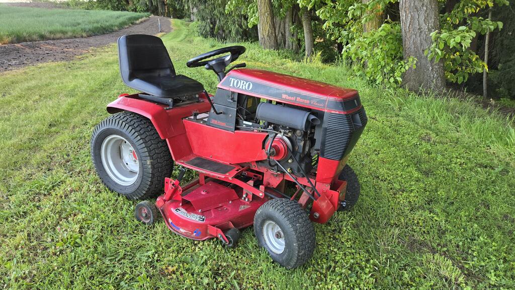

HVYTWR 15 #21 Posted May 9, 2024 Thank you all for the condolences, I wasn't expecting that. This just shows the kind of thoughtful people that are on this forum and I feel honored to be part of it. Here's a photo I just took today after cutting some grass. These are some of the coolest tractors I've seen, I love the simple, rugged design! There's not a lot of these out here on the west coast. 1 1 2 Share this post Link to post Share on other sites
