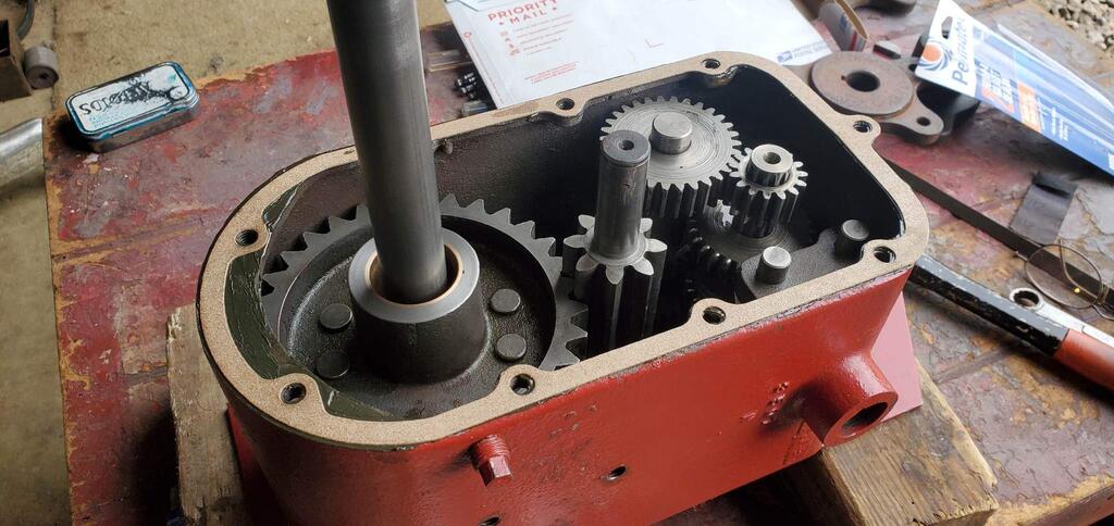

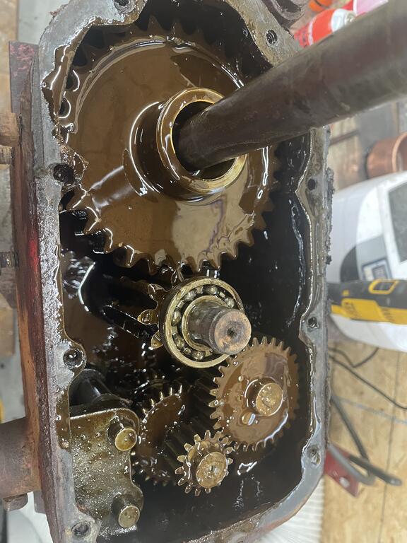

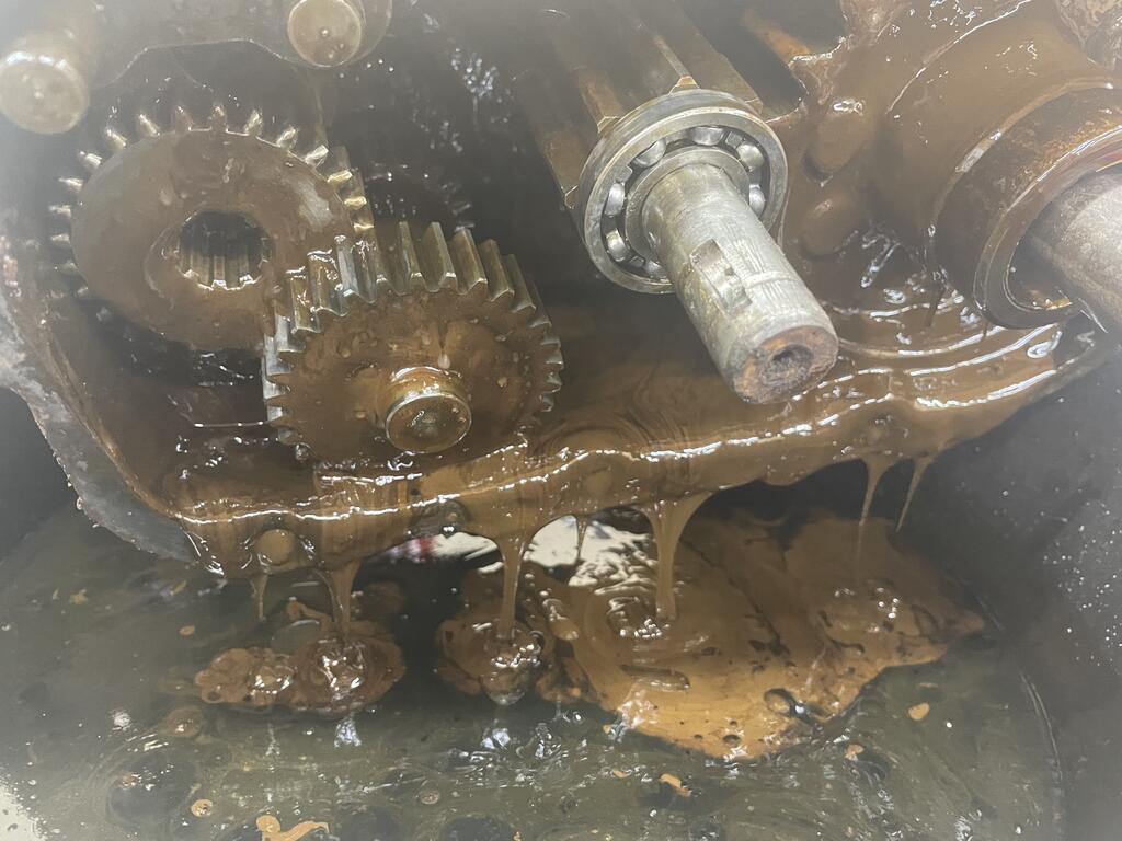

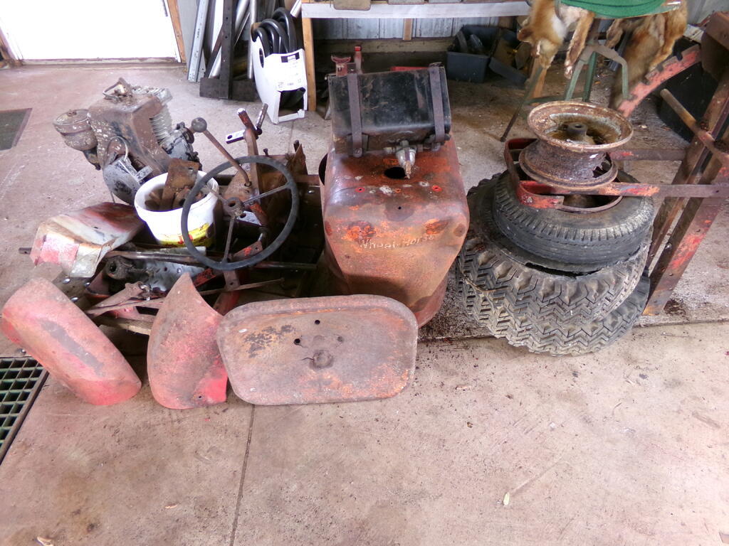

OoPEZoO 632 #1 Posted May 6, 2024 Its gonna be a ballad.....because he's been neglected, needs quite a bit of attention, and I'm assuming its going to take me just about forever to get him rolling again. I don't know much about RJ's other than I always thought they looked great and I wanted to pick one up at some point. So this is very much a learning experience for me trying to research what is original, and what has been modified on it. That being said, I'm committed and in it for the long haul. He has been hacked up just enough that I don't feel obligated to keep him 100% original, but will do my best to keep from making any permanent modifications. A few links to get everyone up to speed. Sir Wally was dropped at Ed's house by a friendly neighbor Ed decided he had too many projects, but decided to do the hard part of disassembling him. Once again....THANK YOU Ed!!. It made picking him up easier, and also meant that I could immediately start to assess what he needed instead of getting shoved to the back of the garage waiting for a rainy weekend. Here is how he looked when I picked him up I had a little free time last week, so I decided to tear into the Briggs motor that was included. It was in rough shape, but I believe I can make it run again. I'm not sure if it will end up back on Sir Wally, but it was/is something fun to tinker with. I currently have it all torn down, case split, and trying to figure out if I want to try replacing the rings as I have no idea on the actual identification of the motor. Here is that adventure The next step I thought should be the transmission. My thought process here was that if the transmission was completely shot, I might as well cut my losses and part him out. As luck would have it, the transmission spun freely, shifted into all the gears, and didn't appear to be sloppy. I also wanted to get on it ASAP due to the big show looming and it being the best chance of sourcing transmission parts if I need them.......AND it turns out that I do. So here we go, I wanted to put it all here so I can document things as best I can. The transmission. It has no casting marks next to the shifter, so I believe that makes it an "early" 58 5003? I started off by swearing at this roll pin for the clutch/brake for about 4 hours......broke a few punches, but eventually got it out I also had to work on the rear hitch quite a bit, as it was rusted solid in place. That took some heat, AeroKroil, and patience, but I got it out. The side bolts all came out easily and all of the threaded bosses are still intact, so that's a bright spot. Popped the side cover and got met with the wonderful combo of water and milkshake I turned it over and let it drain over night to get as much gunk out as possible It was pretty nasty, but I was initially encouraged that I didn't see any obvious damage. That changed once I get things completely torn down an cleaned up You can see the axle wear/scoring in the pic above. They could possibly be flipped, drilled, and reused, but It may be a smarter decision to source replacements. There are a few chipped teeth on the axle gears you can see in the pic above as well. There are a few broken off, and a few more with cracks that look ready to break off 6 2 Share this post Link to post Share on other sites

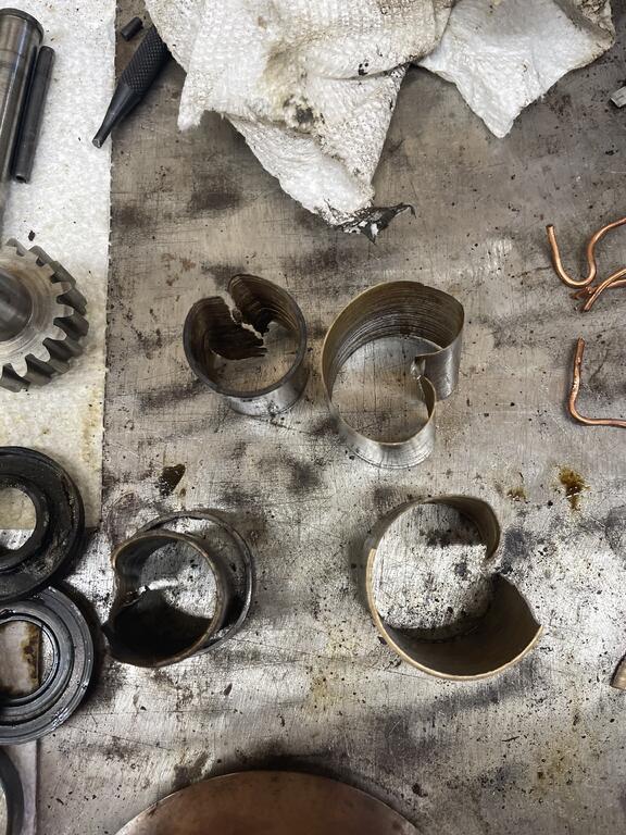

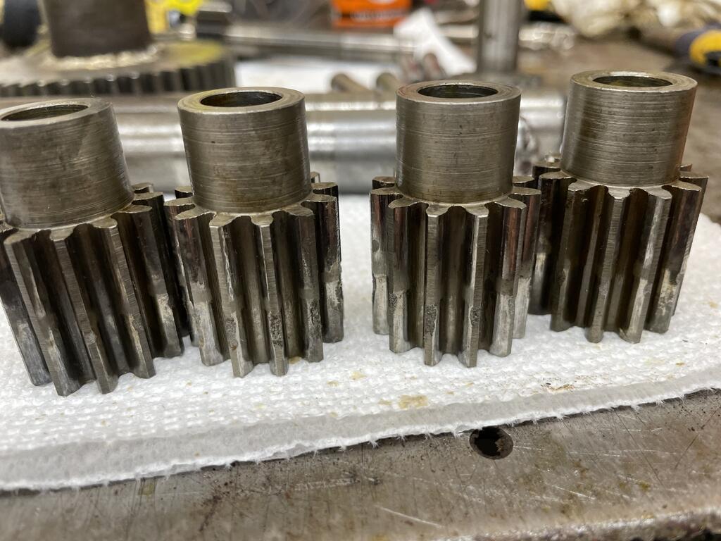

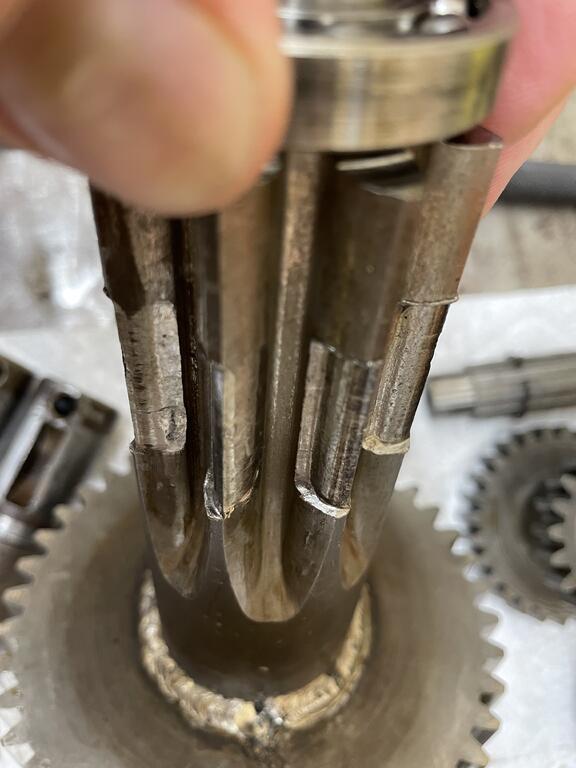

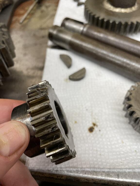

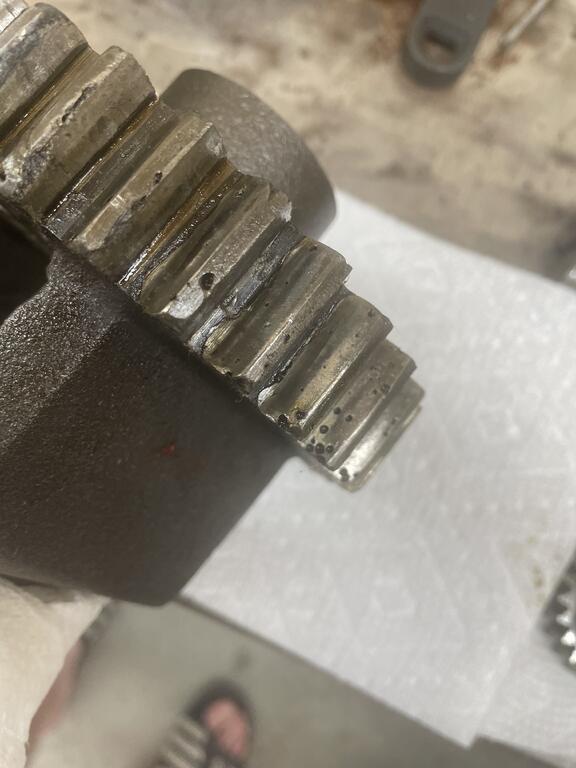

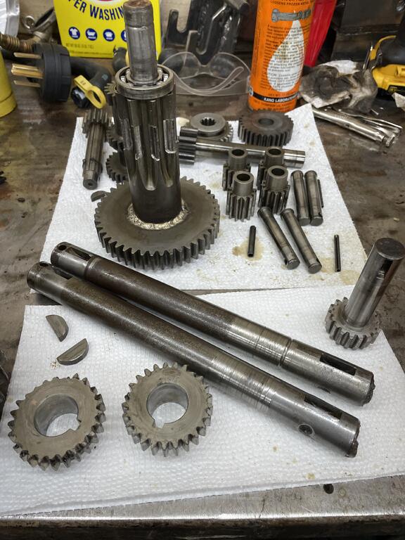

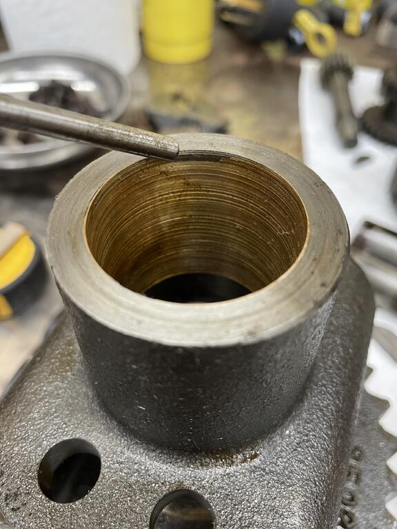

OoPEZoO 632 #3 Posted May 6, 2024 I also saw a little damage on the spider gears. I think these are "OK", but through researching it appears I can replace all 4 with newer ones for a reasonable price. I'll probably go that route, but not sure yet The brass bushings/bearings in the side plates and center hub are all shot. The outer ones are severely scored, and the inner ones are worn all the way to the carrier Of course, the worst of the damage is on the bull gear and mushroom gear. I don't think I could bring myself to put this back in a transmission unless it was going to be stationary the rest of its life The bull gear has a bunch of weird wear on it as well. It almost looks as it was "repaired" at one time by someone who can't weld and then ground down. There is a lot porosity in the teeth, along with what looks like poor penatration and undercut. This is the only one I've ever looked at, so I have nothing to compare other than pictures. It still looks like it may be usable, but I have this idea bouncing around in my head that this "repaired" bull gear is what tore up the mushroom gear so much. Hard to say, and I will never get any proof either way. So that's where I'm at currently. Still assessing and looking at what my options are to get this transmission back together.....and that is the desired result. I think it is definitely in good enough shape and worth a rebuild, especially since its not on a timeline. 6 1 Share this post Link to post Share on other sites

OoPEZoO 632 #6 Posted May 6, 2024 Thanks....I've read that 4-5 times in the past week, plus a few others. It was great being able to tear into this thing and not being surprised by anything. That was only possible because of the people who took the time to document the work they have done on these transmissions in the past and I'm very grateful for having access to that info. All of the pics and videos posted in the past have been fantastic. I'm currently trying to collect all possible part numbers and combinations of parts that I can find that will work together, Then make a plan of action 2 1 1 Share this post Link to post Share on other sites
Lane Ranger 12,167 #7 Posted May 6, 2024 OoPEZoO when you get the list of gears you need for your redo I know two Red Square members you should check with. Jake Kuhn in South Haven , Michigan and Keith Jones in Sunbury, Ohio. Ratpack on EBay makes RJ parts ( or at least he did). For new axles, spindles, etc. i have redone four or five of these RJ transmissions with new bearings, bushings and oil seals. Wheel horse parts and more sells the RJ rebuild kit and the transmission side plate paper gaskets. i have had two of those RJ transmission cases with no date code. I like to think that those were RJ’s Mr pond gave to new dealers to sign up to be a Wheel Horse dealer . 3 2 1 Share this post Link to post Share on other sites
stevasaurus 23,892 #8 Posted May 6, 2024 (edited) Excellent project !! In looking at the pictures, I would try to find the newer style mushroom gear (11/44 tooth) and the coresponding differentiial gear that goes with that. Your trans will thank you and run much better. Those parts interchange. I would also change out the spyder gears in the differential...get the ones that fit the 5025 trans. I (without looking at the above thread) think they are 11 teeth spyders. They fit fine as long as you replace all 4. Edited May 7, 2024 by stevasaurus 4 Share this post Link to post Share on other sites
OoPEZoO 632 #9 Posted May 7, 2024 Thanks to both of you…..I’ve read through both of your rebuild threads, watched your videos, and learned just enough to pretend I might know something. Wheel Horse parts and more was already on my list. I haven’t given the side plate bearings a good look yet, but at a glance, they look clean and un damaged. Either way, I will pull them and check them out individually once I get my next few minutes of free time. Of course, looking at the condition of the rest of the tranny, I should probably just toss the original bearings in the trash and pony up for the whole rebuild kit. I’m assuming Jake is Jake’s small engines? I’ve seen him have a ton of good used parts for sale over the years. I’m not familiar with Keith or Ratpack. I do see a guy currently selling reproduction axles and heat shields for RJ’s right now. Goes by the name Johnisawesome69. I think that’s my only option that makes sense for axles. New repros are about the same cost as “ok” used ones. This thing will only ever be babied after this, but I don’t want to open it again. I appreciate all the advice, please keep it up. Gonna be quiet for a few days with work and crazy kids sports schedules. 1 4 1 Share this post Link to post Share on other sites

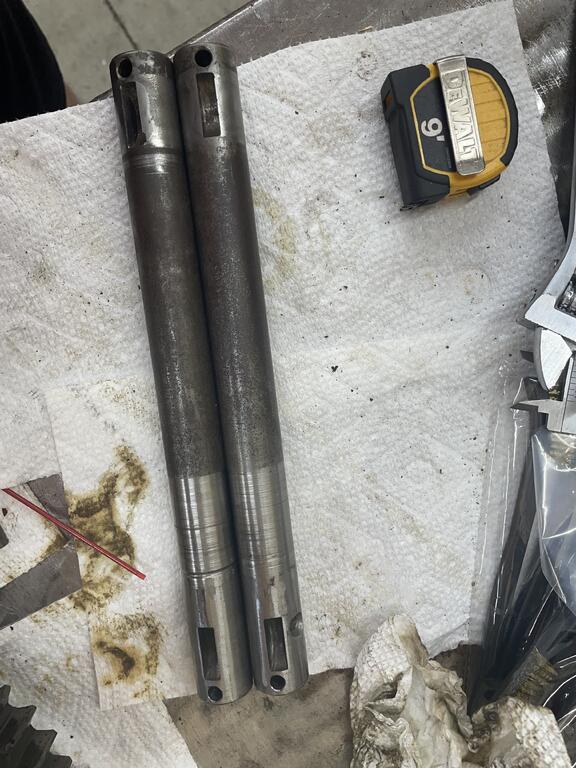

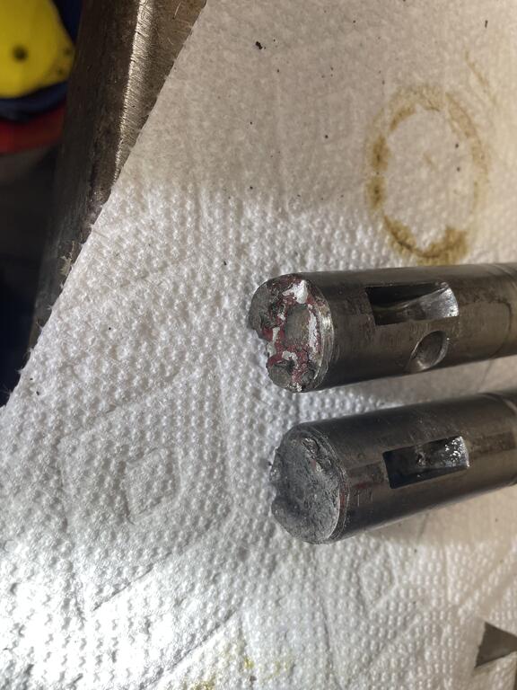

oliver2-44 11,848 #12 Posted May 7, 2024 On 5/6/2024 at 12:24 PM, OoPEZoO said: You can see the axle wear/scoring in the pic above. They could possibly be flipped, drilled, and reused, but It may be a smarter decision to source replacements. T Clean up the other end of those axles. Give them a little polish and they are very usable. I've flipped 3 sets. 1 1 Share this post Link to post Share on other sites

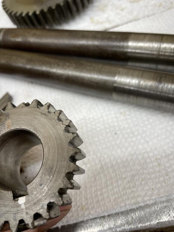

OoPEZoO 632 #14 Posted May 10, 2024 Its Friday, and pouring down rain.....so, tractor time. I've been off and on figuring out what I need this week, and at least nailed down what I have here and what can stay and go. This is my current situation 3530 25T Axle Gears - Mine are shot. Too many broken/cracked teeth to consider putting back in. Replacements look relatively easy to get 3502 31T Diff Case/gear - Mine is pretty chewed up and I want to replace it 3559 8/44T Brake shaft - VERY worn on the 8T side and needs to be replaced 3532 Axle - After cleaning up, I do think they look good enough to flip, drill, and reuse. Going to give that a try. It I don't like the outcome, I'm going to get reproduction axles 3531 12T Spider gears - These look "ok" There are some marks on them and a little material missing, but think they should be ok if I get decent axle gear replacements I'm hoping to source the newer 7243 differential gear with 3559B brake shaft gear, but they don't seem readily available right now. Gotta go beat the bushes a little and see what I can dig up. It looks like at some point, someone did some welding to the end of these axles, so I need to clean that up first. Then I'll fixture them up and give a go at drilling them. Think I'm going to head out to the shop and do that now. Then maybe start setting up the E-tank to try clean up those side plates. 2 1 Share this post Link to post Share on other sites

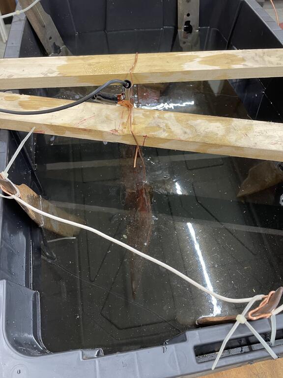

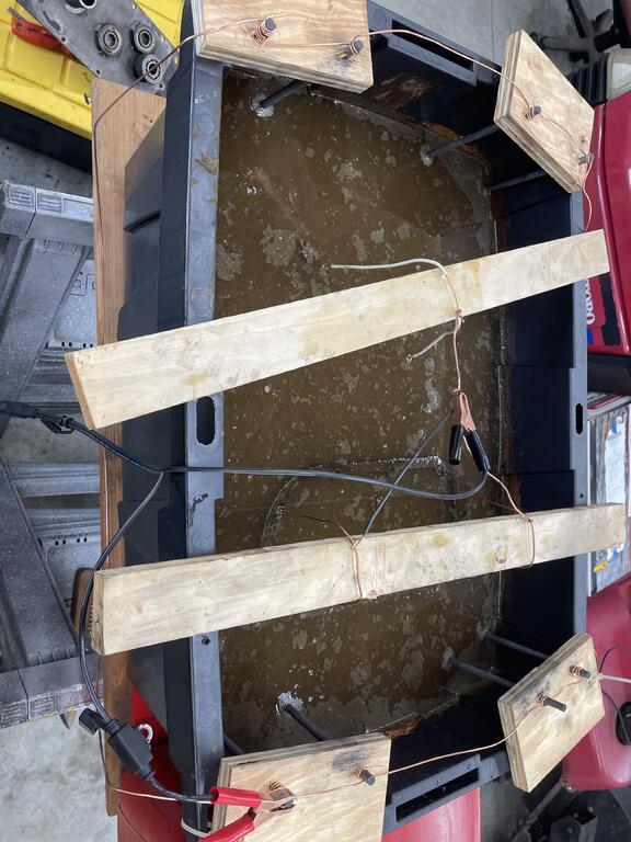

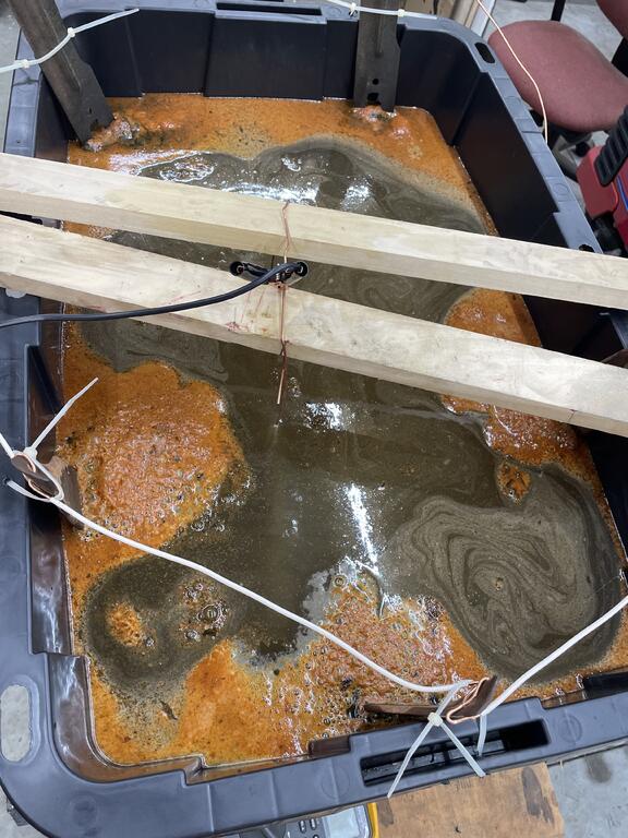

OoPEZoO 632 #15 Posted May 13, 2024 First side plate is in the wash......bubble bubble bubble Using a few old mower blades as anodes and an old laptop charging brick as a supply. The brick is rated for 20V @8.5A. Its getting toasty 5 Share this post Link to post Share on other sites

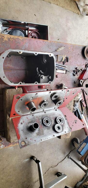

OoPEZoO 632 #16 Posted May 20, 2024 (edited) Parts are slowly starting to come out of the E-tank and getting cleaned up as time allows. I have one side plate clean (you can see it in the top left of the pic below). I love the E-tank for cleaning old rusty parts. I tried for a bit to remove the bearings, but wasn't getting anywhere. I decided I should order a blind hole bearing puller instead of screwing around with rigging something up, so that's on the side burner for a few days. I also made a change to my E-tank yesterday. You can see from the pic above that I was using some old mower blades as the sacrificial anodes and the orange sludge is disgusting.....as are the mower blades when I pulled them to scrape the rust off. I had read that graphite rods work better as the anodes as they are highly conductive and won't leave a sludgy mess. So I bought a set off the jungle site and rejigged the E-tank to get the mower blades out and graphite rods in. This is the result after a few hours. Bubbling like crazy, yet still nice and clean. I should have dumped the tank and started with a fresh solution, but I was being lazy and reused what was in there. I'm very curious to get out there at some point today and see how things went overnight and see what the graphite rods look like. I have read that they will deteriorate like any sacrificial anode, but at a much slower rate. I guess time will tell. Edited May 20, 2024 by OoPEZoO 2 1 Share this post Link to post Share on other sites
OoPEZoO 632 #17 Posted May 20, 2024 Good news, bad news........the graphite rods appear to be working excellent as far as removing rust and crud. The bad news, they are almost completely gone in less than 24hrs. Looks like I'll be going back to lawn mower blades and/or scrap steel. The rods were not "expensive", but I won't be buying more. If you have a cheap supply of graphite, I would say this is the way to go, but I'm not about to drop a bunch of cash on something labeled as sacrificial. I'm going to milk it as long as I can, and then I'll take some pics as I tear it apart to go back to steel. 4 1 Share this post Link to post Share on other sites
kpinnc 19,107 #18 Posted May 20, 2024 Usually the orange sludge is from something being galvanized. Still works, but yeah it's messy. Share this post Link to post Share on other sites

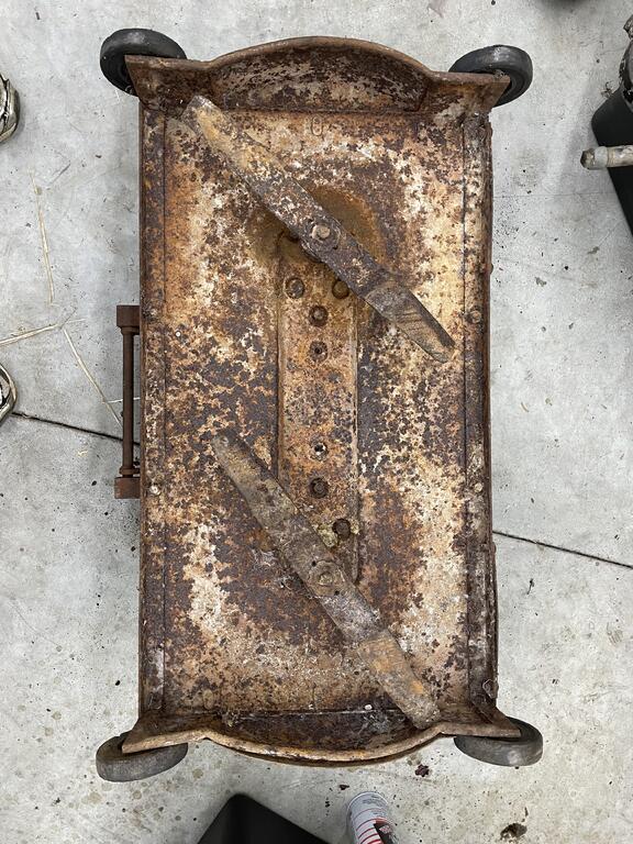

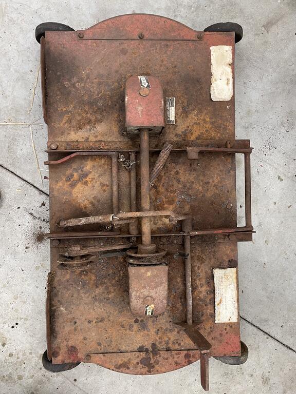

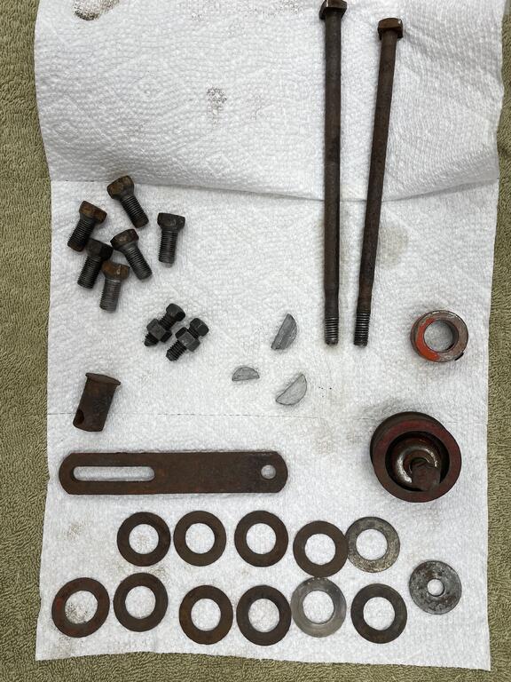

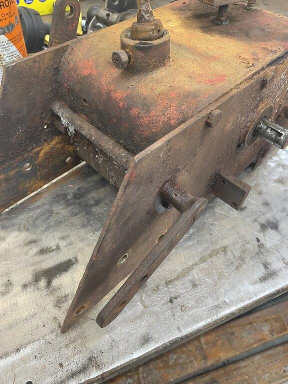

OoPEZoO 632 #20 Posted June 3, 2024 Speaking of the RM 3261 deck. I'm still not sure what I want to do with it. At this point, I haven't touched it other than to confirm that all once moving parts on it no longer move. It appears to all be there and in salvageable shape, but even if I cleaned it up and rebuilt it, I would never use it. I don't even think I would ever put it back on the tractor. It might just have to get listed as trade bait for the big show and try offset the purchase of Wally and his tranny rebuild I'm open to thoughts or opinions on what you think I should do with it 3 Share this post Link to post Share on other sites

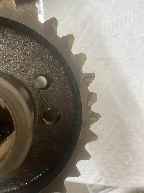

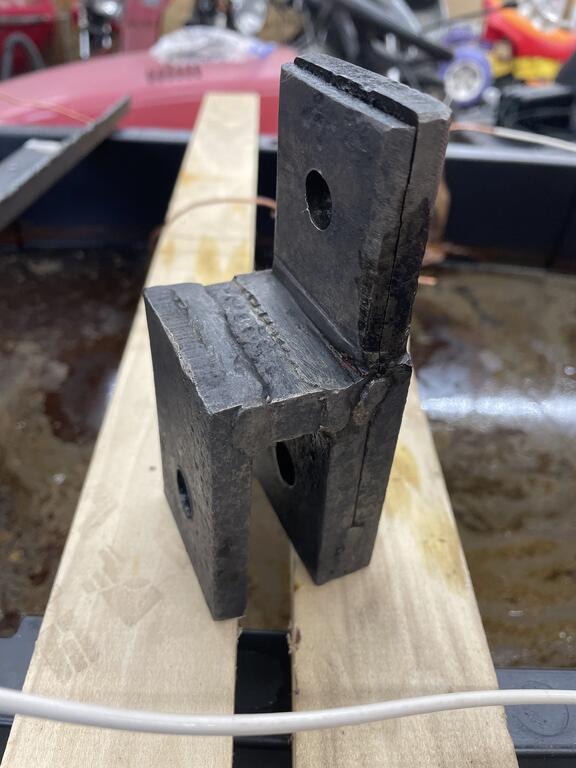

OoPEZoO 632 #21 Posted June 3, 2024 Oh yeah.....one other thing. Before buying replacement axles, I decided to try and drill these so I could flip and reuse them. If anyone ever had reservations about it, just go ahead and do it. It was very easy. The shafts are not hardened, and it took longer to fixture up the drill press than it did to drill the new holes. Line it up, shoot a little cutting fluid on it, and the bit went right through the axle. If you look at the earlier pics of the axles, I first had to grind off the sloppy welds on the end of the axles. I'm assuming a previous owner attempted to weld the end of the axles to the hubs, but did a pretty crappy job of it. I hit the shafts with some emery cloth and they cleaned up nicely. I really need to get a small metal lathe at some point. It would make all of this stuff a lot easier. 2 1 Share this post Link to post Share on other sites

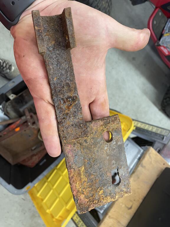

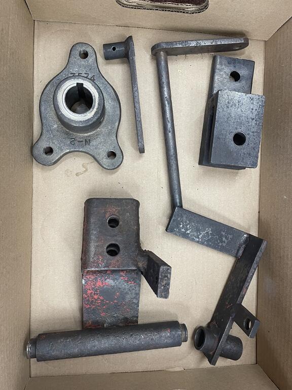

Ed Kennell 47,953 #22 Posted June 3, 2024 Lookin good Keith. Pretty sure this was an adapter for the slot hitch. I don't remember the other part. There were no loose parts though, so it must have been bolted on someplace. Share this post Link to post Share on other sites
OoPEZoO 632 #23 Posted June 3, 2024 Ahh....that would make sense. I'll bet you are right about it being a hitch adapter. As far as the other part. The frame has a height adjust bracket on it, but all of the ones I've seen have been bolted onto the frame and are removable. This guy has his welded on, so it very well could be part of a home brew height adjustment system. I don't see the mystery part anywhere on the tractor or deck part diagrams, so that's my best guess right now. When I get to the frame, I will most likely remove that welded on adjustment bracket anyway......so eh, it will work itself out one way or another. Share this post Link to post Share on other sites
OoPEZoO 632 #24 Posted June 3, 2024 Ahh ha!!!! I just went back and looked at your original pics. Look at the left side of the pic, just above the slot hitch. I'll bet that's the mystery piece. It looks like some sort of support bracket that attached to the hitch. Cool, so its scrap metal. One less thing to clean and paint. BTW....the "set screws" on this hub were hilarious. Those suckers must have been 5" long and completely encased in crud. 1 1 Share this post Link to post Share on other sites
