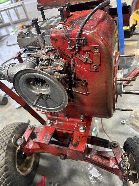

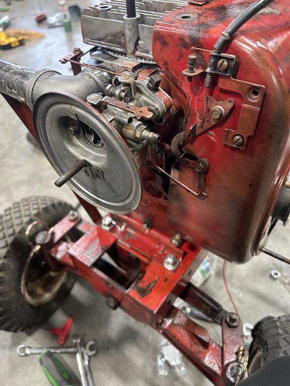

Keaton 466 #1 Posted May 3, 2024 I was got it all hooked up and pulled the throttle out and the spring stretched and the govner and throttle did not move at all I got pics, is that spring warn out, it was sitting fully open for most likely 20+ years any help is appriacted- thanks, keaton Share this post Link to post Share on other sites
8ntruck 9,216 #2 Posted May 3, 2024 Are all of the linkages between the spying and throttle shaft free to rotate? Share this post Link to post Share on other sites
Keaton 466 #3 Posted May 3, 2024 yup and I put pennatrating oil on them to help move freely, the govner feels a little resistant it moves with a bit of resistance , I am guessing that Is normal this is my first time taking the govern compoinents all off Share this post Link to post Share on other sites
Keaton 466 #4 Posted May 3, 2024 anyone else got any ideas on this I don't know what to do, I have tooked back through the pictures I have taken and it is all togher the right way. so I am not Shure if I need a new spring or what I would need. Share this post Link to post Share on other sites
Pullstart 71,098 #5 Posted May 3, 2024 Try removing the throttle cable, and manually operate the throttle shaft. The governor should fight you as it revs up. Share this post Link to post Share on other sites
Keaton 466 #6 Posted May 3, 2024 @Pullstart I still don't have it running yet I am waiting on a recoil spring I was just getting it back togher and hooking it up Share this post Link to post Share on other sites
Pullstart 71,098 #7 Posted May 3, 2024 Oh, ok. The governor will only be felt when the engine is running. There is a way to set it, but not a way to verify it without spinning. Share this post Link to post Share on other sites
Keaton 466 #8 Posted May 3, 2024 but without the govver moving the engine will only stay at idle, because how their setup, I might need a spring to go there but I am not Shure but thanks for the advice Share this post Link to post Share on other sites
rmaynard 17,527 #9 Posted May 3, 2024 What engine is that? Read the engine manual on how to properly set the governor. Don't guess at it. You need the governor to work correctly or you risk over revving the engine. Share this post Link to post Share on other sites
Keaton 466 #10 Posted May 3, 2024 I don't ever normally run my engines at full throttle cause I'm not pulling mutch, and it is a tecumpseh 5.5hp engine Share this post Link to post Share on other sites
