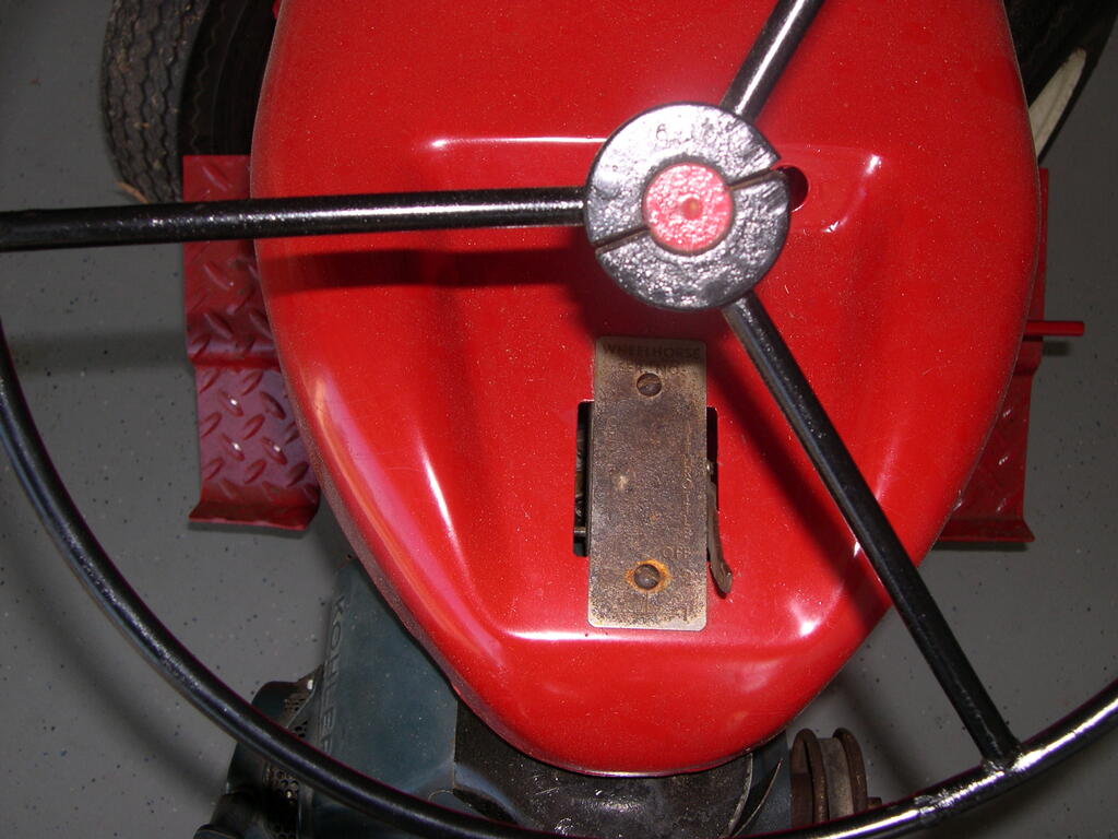

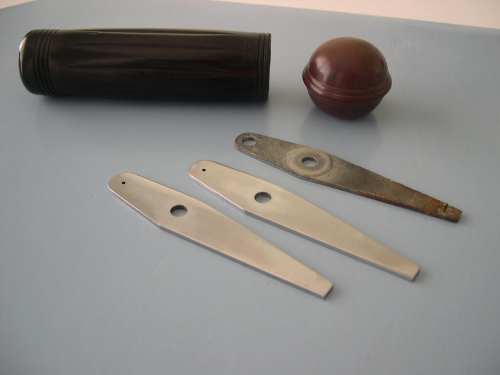

Racinbob 12,993 #4 Posted April 28, 2024 Do you have any of the pieces that you could save? It really isn't difficult to make but having parts sure helps. I was lucky to start with this: I had one lever, the top plate and the bottom bracket which would be the hardest to make. : I made a jig to copy the levers, cleaned up the bracket, flipped the top plate over and the magic of Terry's decals: He put 'Suburban 400' where the missing serial # should be. If I did it again I would have removed the 'OFF' on the decal. I simply forgot. That was Wheel Horses not so good at killing the engine at the time. 2 2 Share this post Link to post Share on other sites

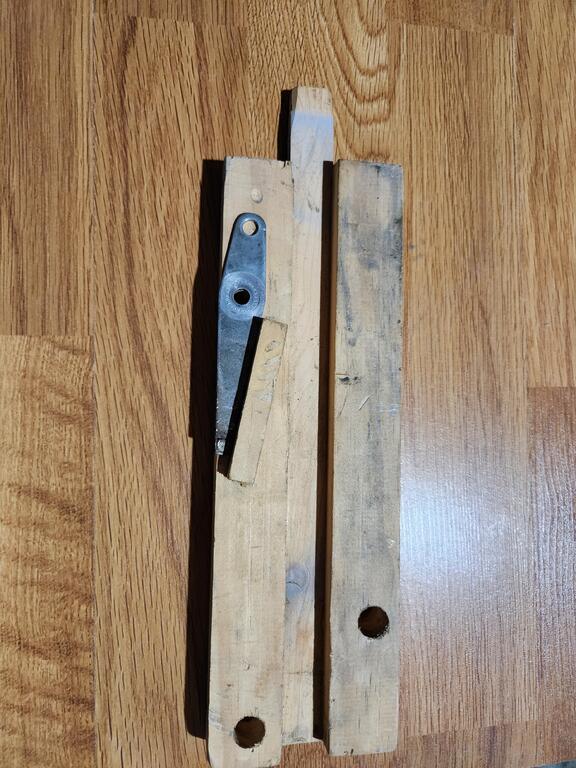

oliver2-44 11,515 #13 Posted April 29, 2024 23 hours ago, Racinbob said: I had one lever, the top plate and the bottom bracket which would be the hardest to make. : I made a jig to copy the levers @Racinbob Any pictures of your jig would be appreciated Share this post Link to post Share on other sites
Racinbob 12,993 #14 Posted April 29, 2024 2 hours ago, oliver2-44 said: @Racinbob Any pictures of your jig would be appreciated I don't know Jim. It's pretty high tech. The hard part was holding them (hot!). This allowed me to bolt them together in the center only and keep the new steel lined up with the one original I had. The holes in the block clear the bolt. I'm sure there's better mousetraps to be made but this did the trick for me. Share this post Link to post Share on other sites
