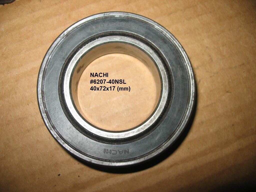

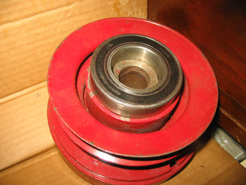

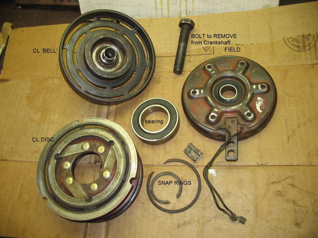

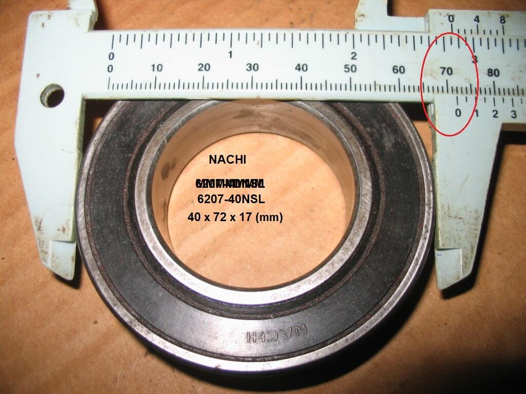

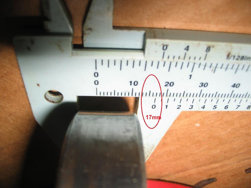

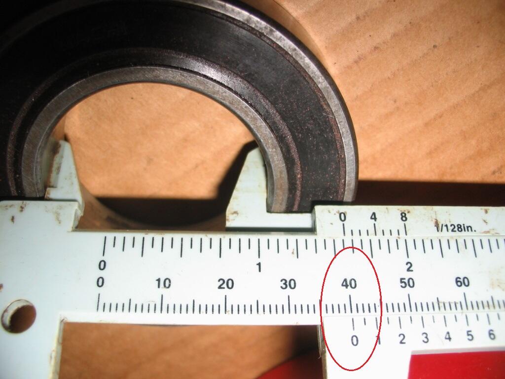

daveoman1966 3,884 #7 Posted April 27, 2024 Two bearings for this E-PTO clutch. The smaller one for the field winding is #6204-2RS. I have the BIGGER bearing in my shop---used but NO DRAG or WOBBLE--- very smooth with slight resistance---as it should be. The number on it is: NACHI 6207-4DNSL (or 4ONSL) iT IS: 40mm ID x 72mm OD x 17mm W I will put this one in the mail to you for $67 paypal (as money to friends). (I've spent an hour looking for it on-line...with no luck.) Another mfg is WEB BEARING # 166-0144. From Warner Electric...the OEM bearing $110 1 Share this post Link to post Share on other sites
